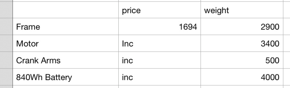

COSTS:
The frame set, battery and motor costs, including U.K. Shipping and duties had a total cost £1,694.44
Current total build cost, even including tyre sealant is £3888.55. This could further be reduced by ‘downgrading’ fork to a Lyrik, the Shock to a Select, and the wheelset to a H1900 set from DT Swiss. With that kind of setup it’ll be around £3400.

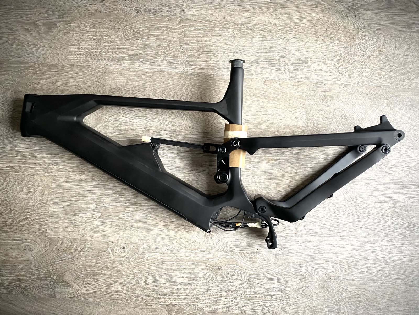

Frame has arrived and so far it seems great. Finish is good quality, cable runs seem decent. Includes headset bearings, seat tube clamp, steerer tube expanding head doctor thing (bit like Hope's version), battery release key, wheel axle, bottom battery cover that can be removed with hex keys (x4 bolts).

Can you weigh all the components as you go ?
For starters the motor and the battery ? I know these things are often shown on sites, but it doesn't mean they're accurate.

I'm reading that to mean that frame, motor. crank arms and battery were £1694 all in, is that correct?

Here is the frame. Called the Dengfu E10.
the entire process is pretty drawn out. You have to email them (contact on that page) and that starts the process.
what follows is a rather sketchy feeling process, where you must PayPal a large sum of money to a random PayPal address.
I did a bit of due diligence before I proceeded including a fair amount of research on Dengfu, as well as google-fu on the PayPal ID. It all checked out OK.
As an individual purchase the process, as you may expect, is hardly Bezos style Amazon shopping. But at this price I guess it’s kind of expected.

Today's build questions :
How is the battery cover held in place ?
How is the battery held in place ?
Is the complete wiring loom pre-installed in the frame ?
I take it the rear brake line runs internally then externally on the bottom side of the rear triangle ? Where does this exit the frame ?
Where does the gear cable run ?
Where does the wheel sensor mount and the cable run ? Is it possible to modify this to a brake disk variety if it's not already ?
The angles make it appear as if there would be almost no limit to dropper post length ?
Are all the bearings factory marked with torque numbers ? (can't tell from the image)
Whats size rear rotor is it setup for without adapters ?
Does it come with any guides/advice for painting/finishing ?
Are there any manual finishing jobs you have to perform to the frame ?
Does the rear axle hole have steel/aluminium/something inserts ?
Does it only come in black ? ;)
