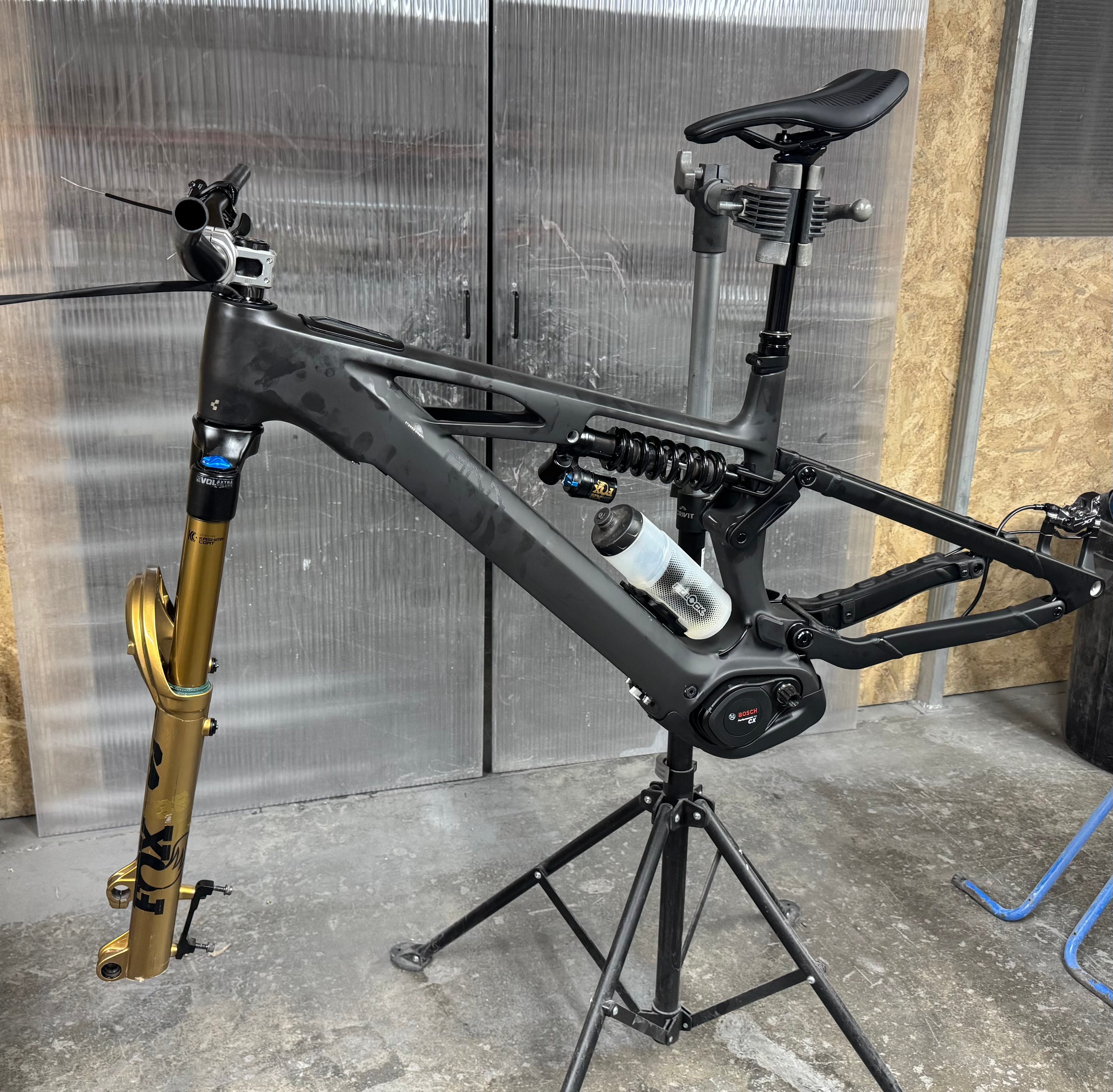

Finally I’ve received my One77 and I’ve already completely disassembled it! I’m going to customize it with the parts from my previous bike…
Unfortunately, the stem height I like doesn’t allow me to use the stock top cap, so I modified a regular one.

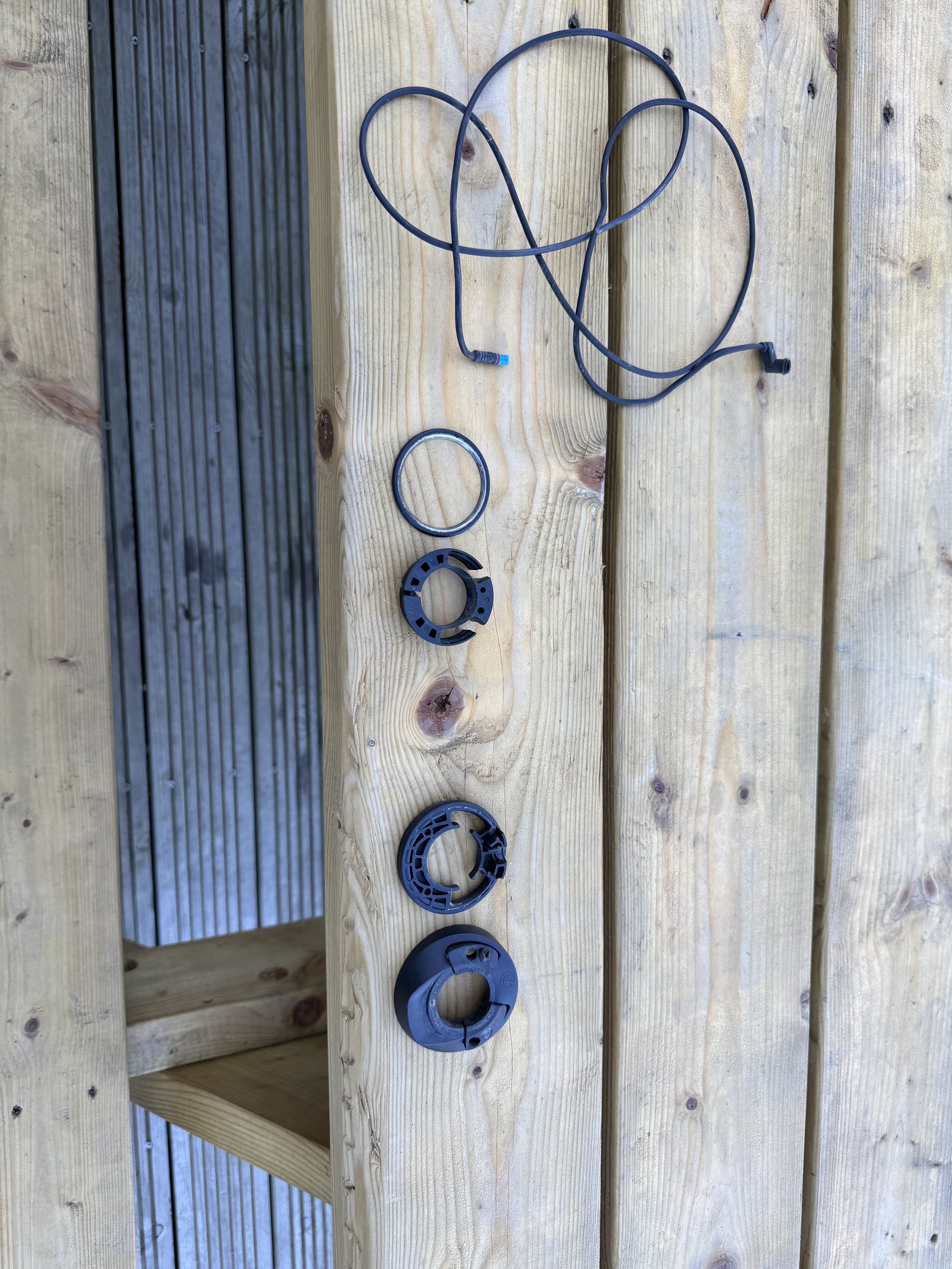

There’s a cable with a connector at the front that I don’t recognize— is it for plugging in a light? I wrapped it up and hid it inside the frame.
I’d like to know if it’s possible to remove the Abus lock cylinder that holds the battery so I don’t have to depend on a key. I’d rather use an Allen key or something similar… has anyone done this?
This week I hope to finish the assembly and test it out.
View attachment 168410 View attachment 168411 View attachment 168412 View attachment 168413

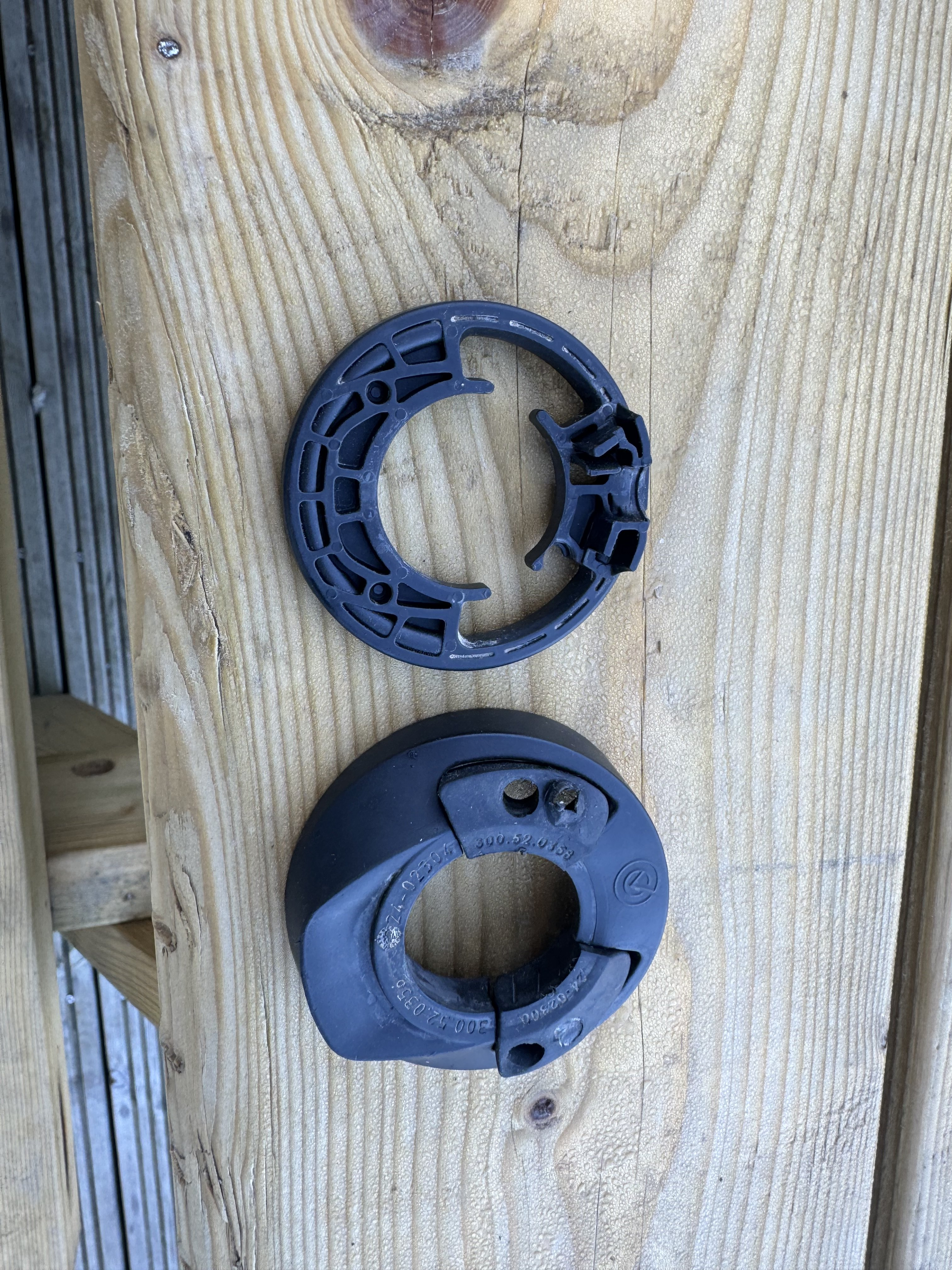

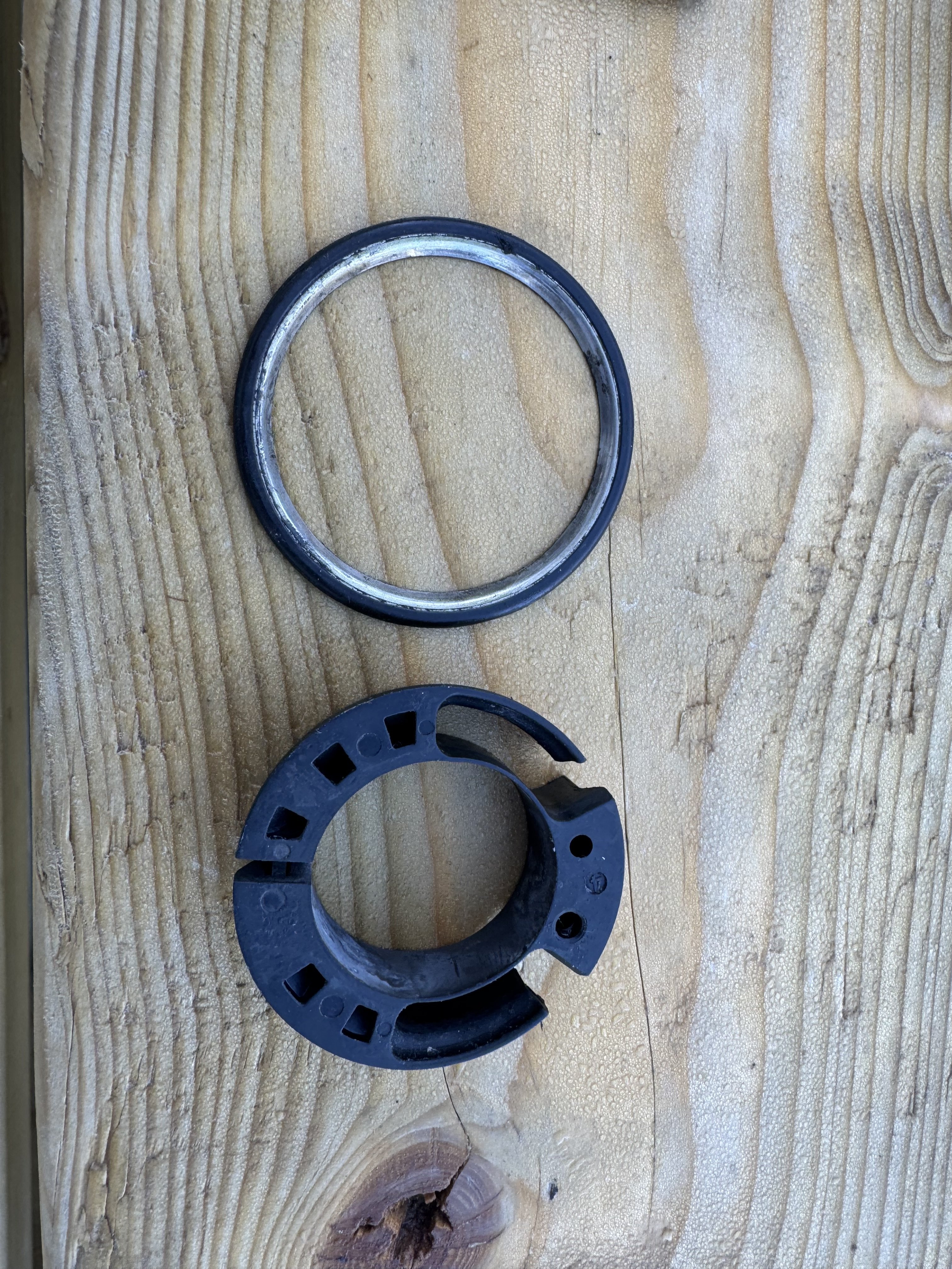

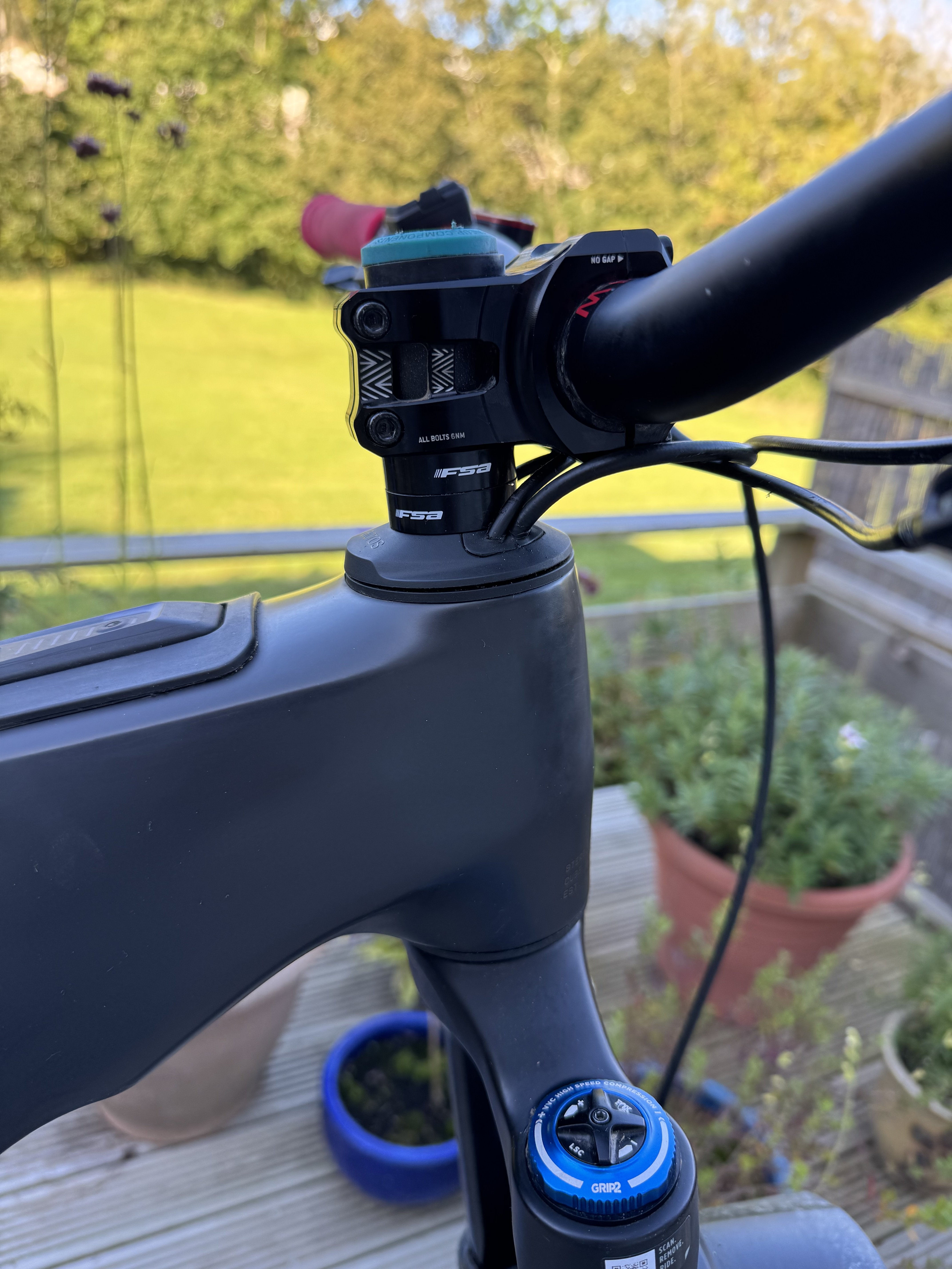

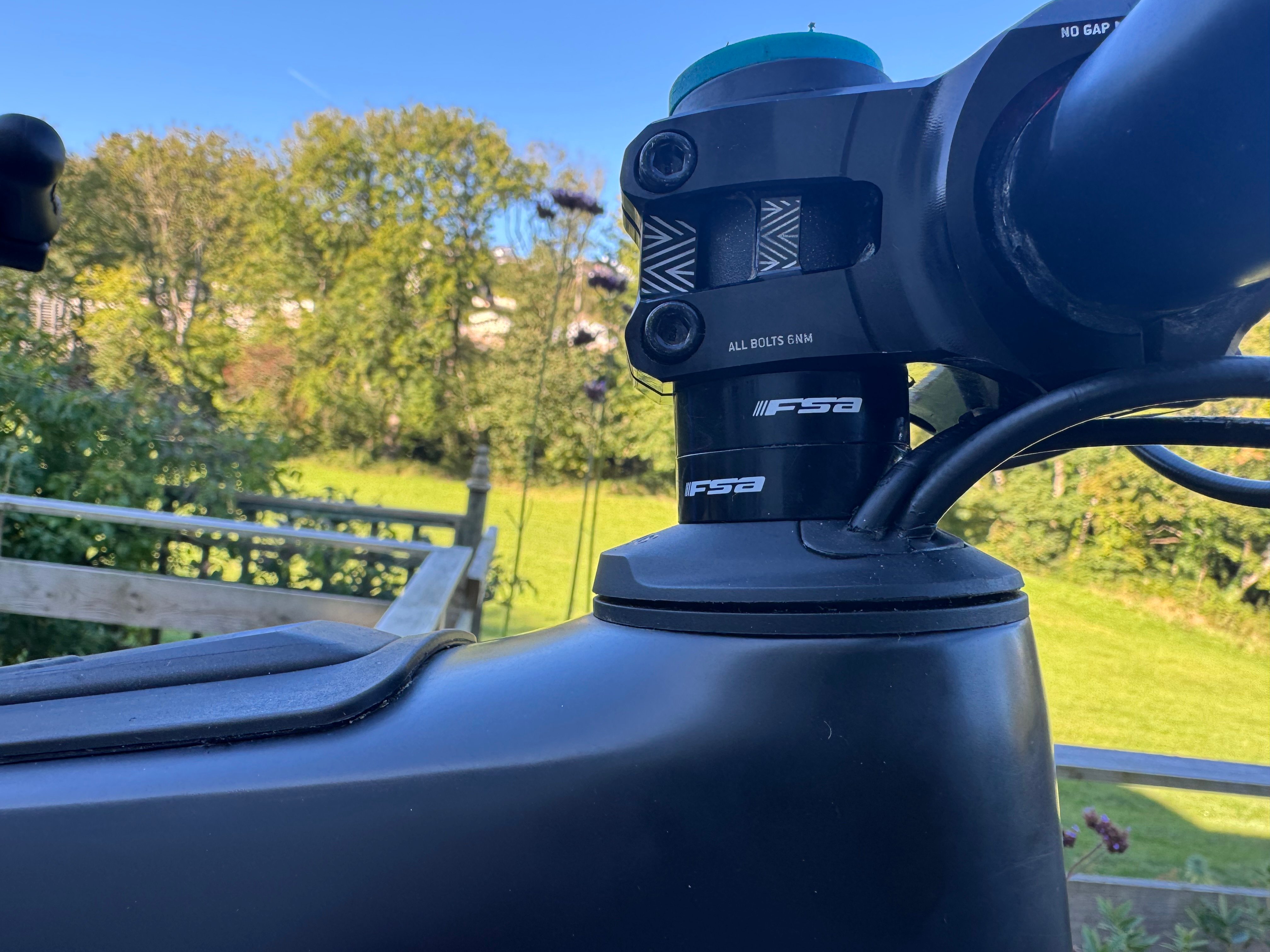

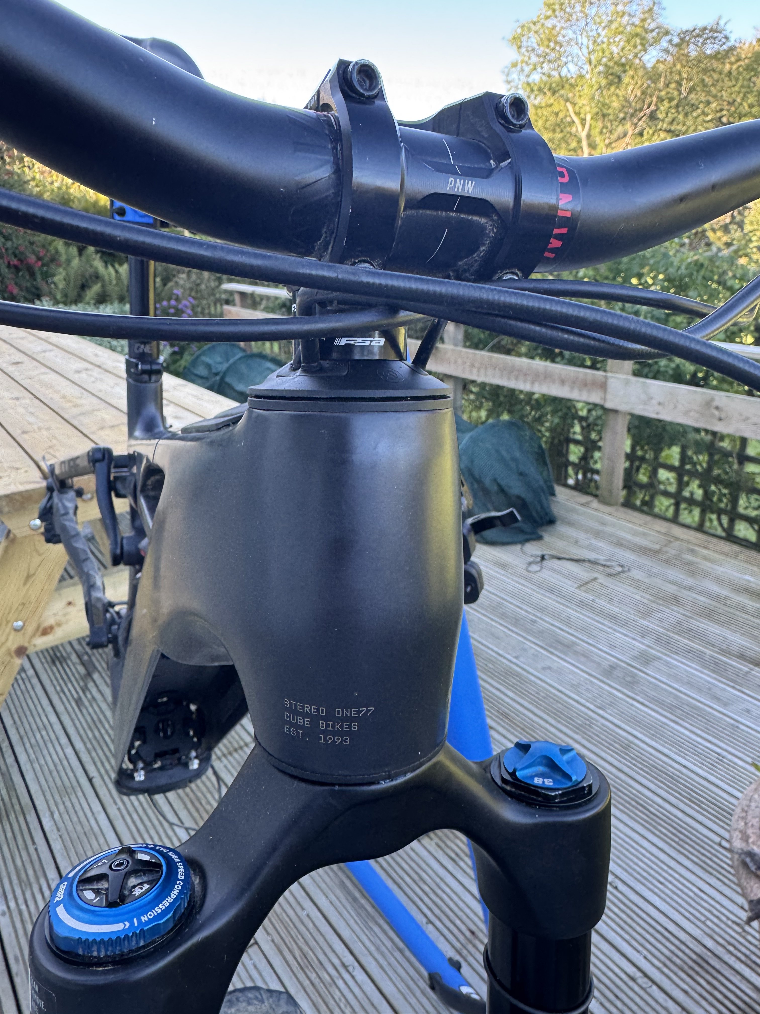

Hi there, if you want the bike to look/function better the only part you need is Acros 32.52.107R1 AM. I’ve just done this modification and also removed the light cable, which I’ll never use! Only £15 / €12 so not crazy!
I did change the compression ring too to the aluminium model, but that was unnecessary, but I didn't know what parts I needed to clean up the headset. Integrated is the worst, but this is much better.

You've removed the head angle part of the stem?
What is the HA now without it?
No. The angle adjust part of the headset are the cups that seat in the frame headtube - still present and correct!
All I did was remove that top cover monstrosity and the plastic frame that holds the light cable plug, these parts:
You swap these two parts for the lower profile £15 part Acros 32.52.107R1 AM.
You can still adjust the headset/headtube cups.

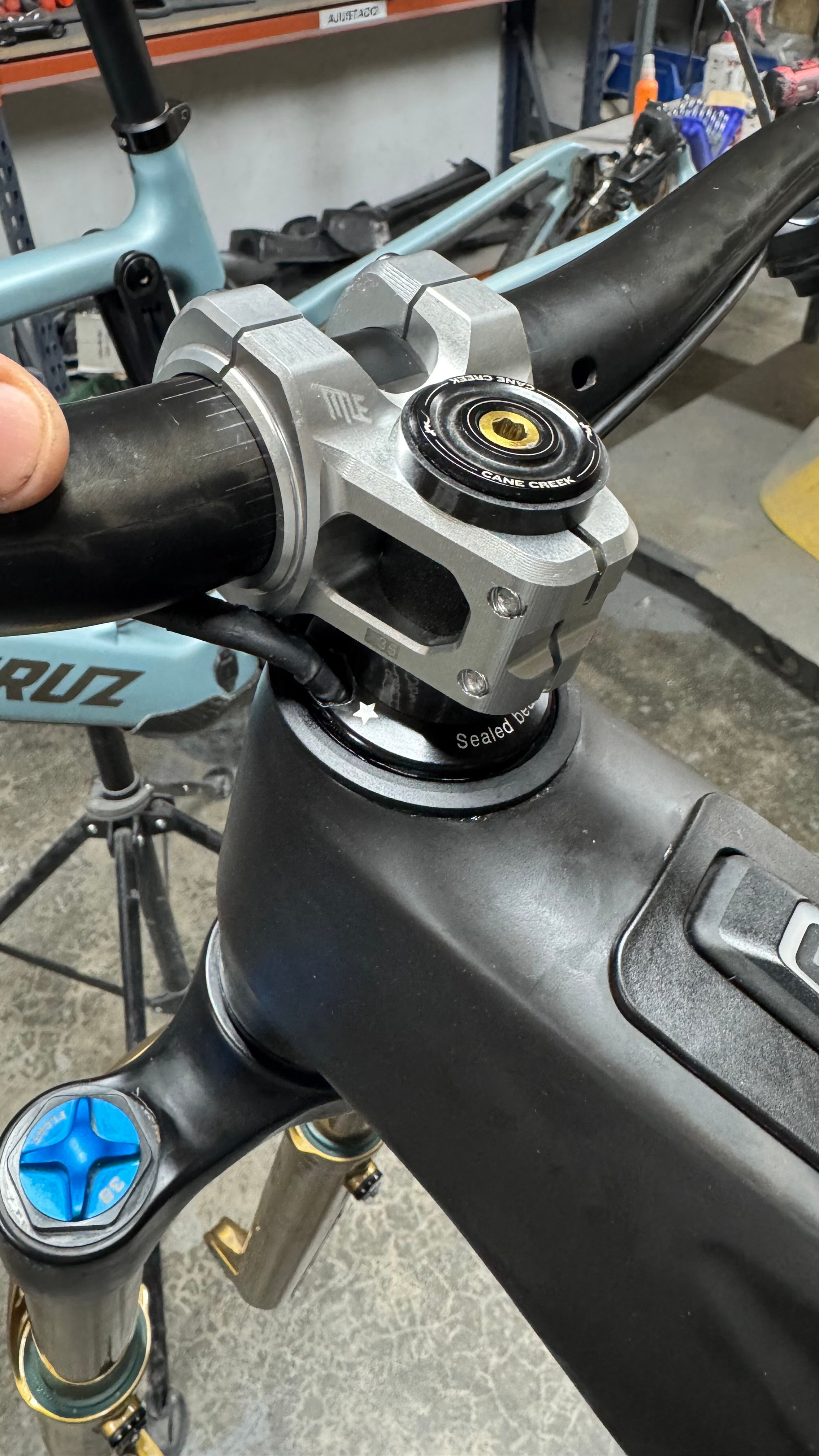

I would say no.
The replacement cap I referenced has two locating pins for the compression ring that sits on the top bearing.
The likelihood is that the Nukeproof headset has different bearing so they won't seat in the frame cups either.
At £45 for the NP headset it's not worth trying, the £15 mod I've done is pretty clean and works perfectly.
I’m all over this, parts ordered

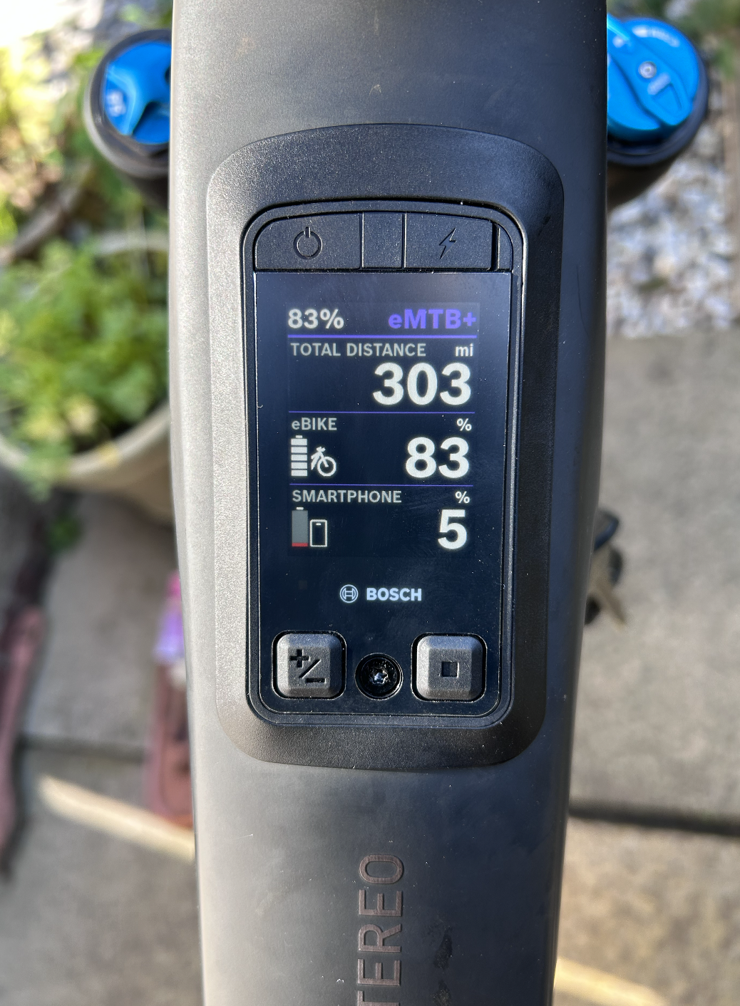

Kiox 400c installed!
I had trouble doing it myself and needed to take the bike to my LBS so they could hook it up to some Bosch diagnostic software.
After that was done the Flow App would not connect back to the bike.
All that needed to be done was delete the app and download it again.
When I logged in had to put the bike in Bluetooth Pairing mode (hold down the on/off button for 3 secs).
I was then promoted to select the Kiox 400c from a list.
It connected and then it was all done.

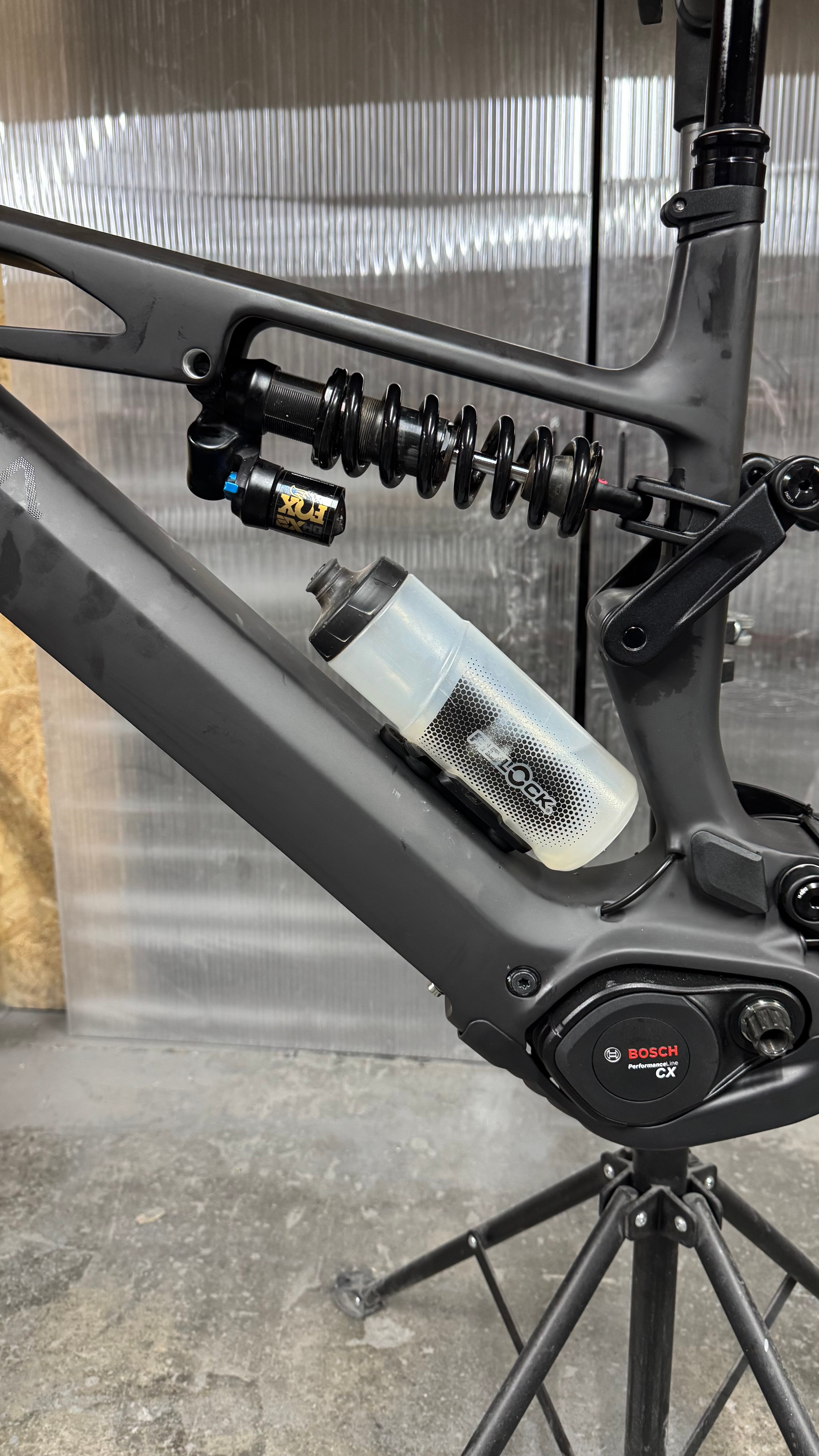

Fitting a coil to my bike has transformed it. The DHX might not be the most expensive thing but jeez it’s like a magic carpet now, can only imagine what it would be like with a top of the line shock on it. Bikes been rattle free since I put those motor bolts in.

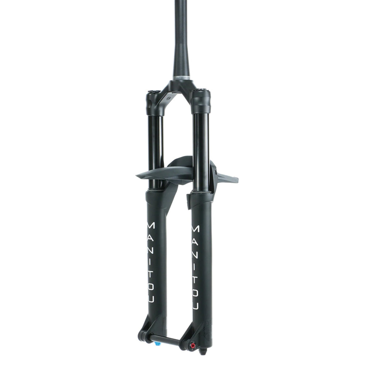

Thanks for the replies , anyone any info on these manitou mezzers ?

Well I've had no rattling, creaking or noise from my bike in 5 rides now... its epic that i can finally enjoy it. The 38 factory and the DHX coil has made this bike a monster on the downhills. Got the 400c working now as well and im finally enjoying the riding instead of wondering what thats noise etc...
