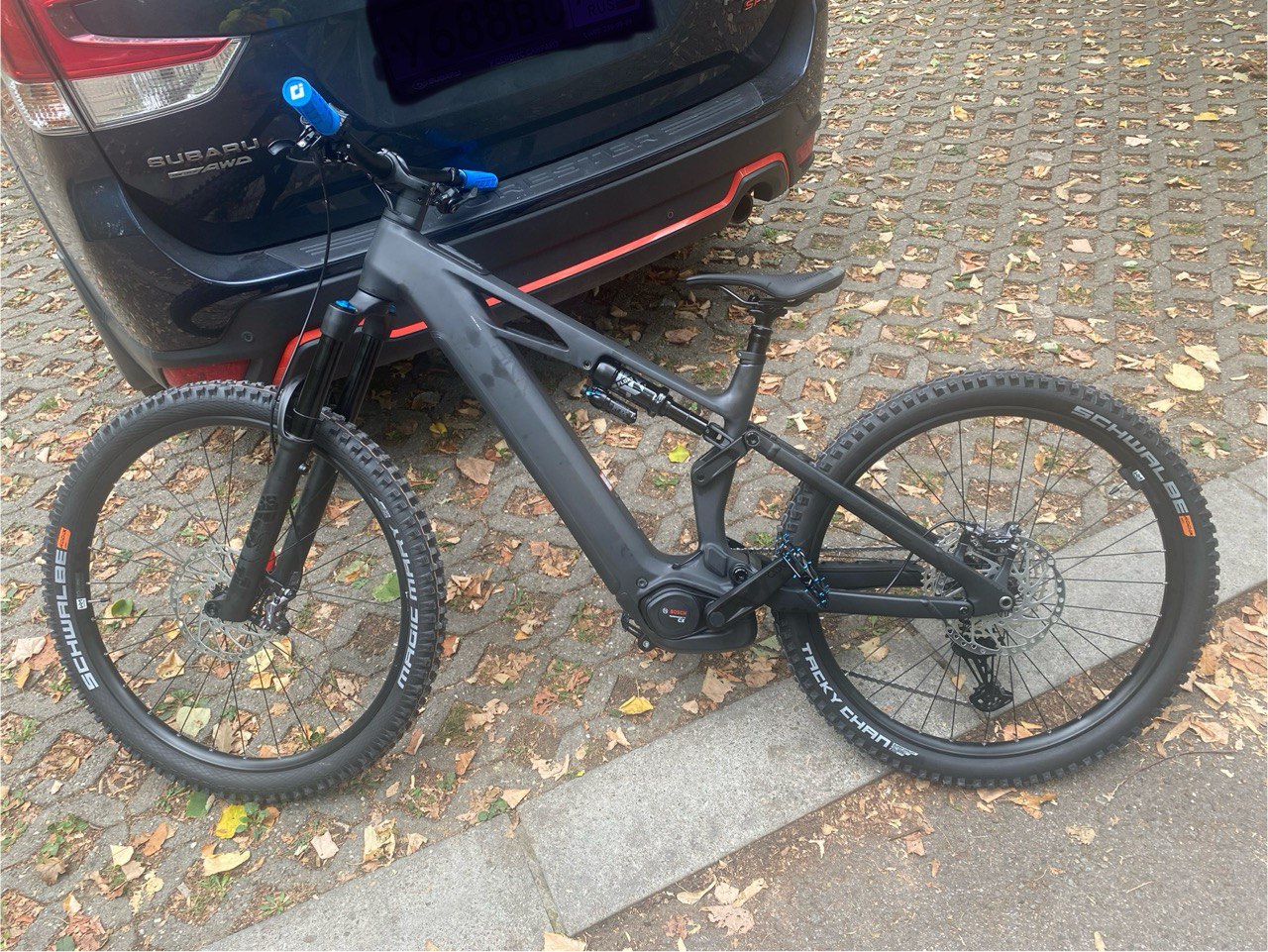

View attachment 161176Done mine today, changed almost all the parts for itbut got it lowest pces becauseof that. Question: anyone know what size rear shock bushings do i need ? I want to change because removed from stock one just want to get newones for ohlins coil, just need to play with setup had first ride rear felt a bit flexing not sure if i like that, but definitely jumps better and more playfull than my old trek rail, well tomorrow proper of piste ride will put it to the proper test. So far i like it. Nonoises from battery or frame maybe because i just rebuild it :D
Hi there, what top cap did you replace the original Acros one with? Cheers

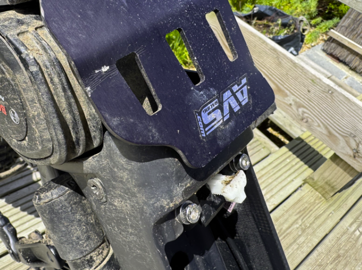

Somewhere between leaving the house and arriving at the trail head the battery cover fell off my bike (whilst on the towbar bike rack) including the white battery tab near the motor:
Of course no one in the UK has the cover in stock AND the button at the top is a separate part too. So I've lost the cover, the white tab and the buttons.
I've ordered the cover and one half of the button from Ridewill in Italy, so fingers crossed their website stock was accurate.
I can't find the part number for the white tab in the exploded diagram.
Does anyone know this part and where I could get one?
In the meantime I've bought some 1.5mm thick Kydex (I love this stuff) and will fashion a temporary replacement so I can continue to ride.

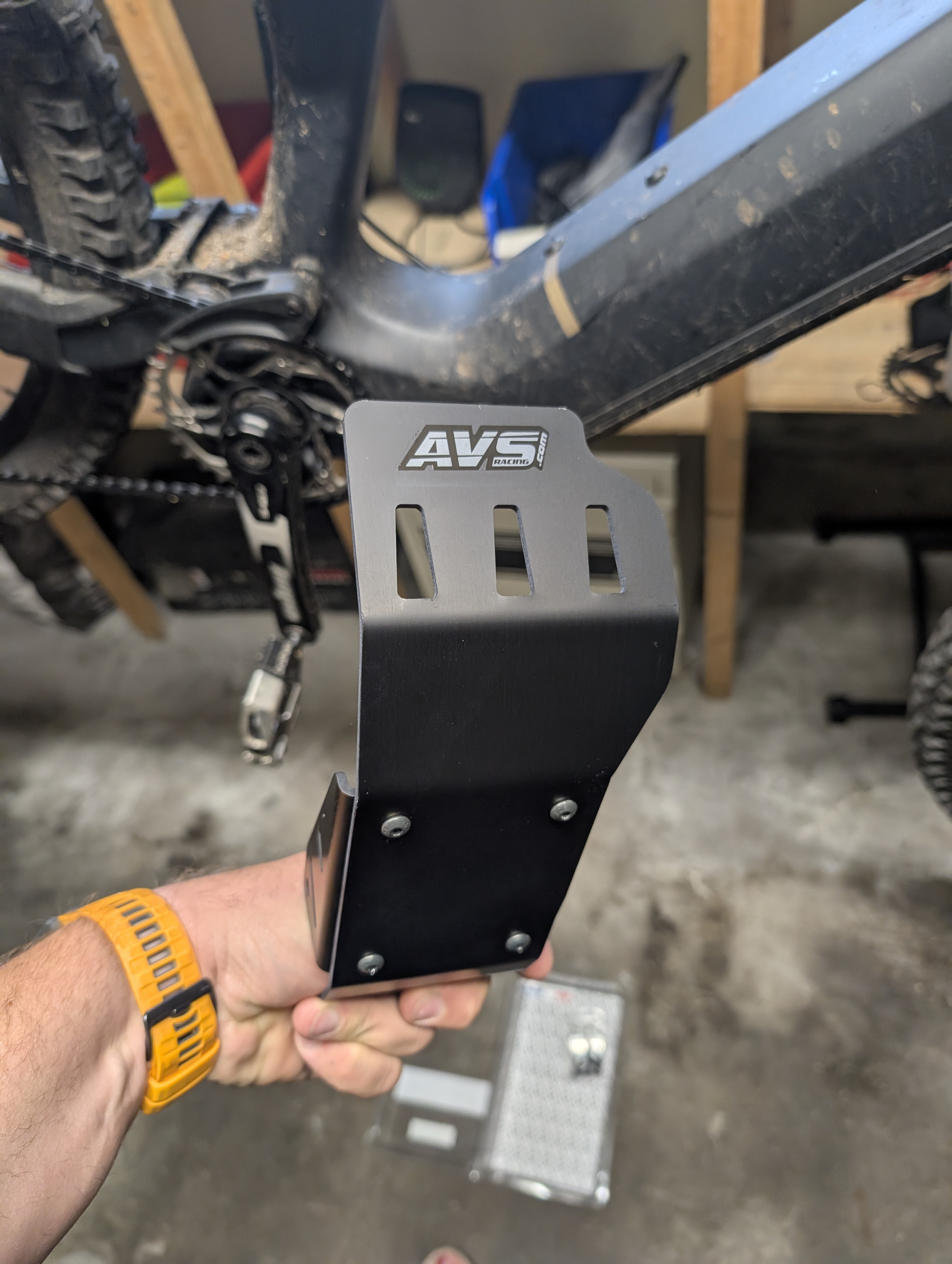

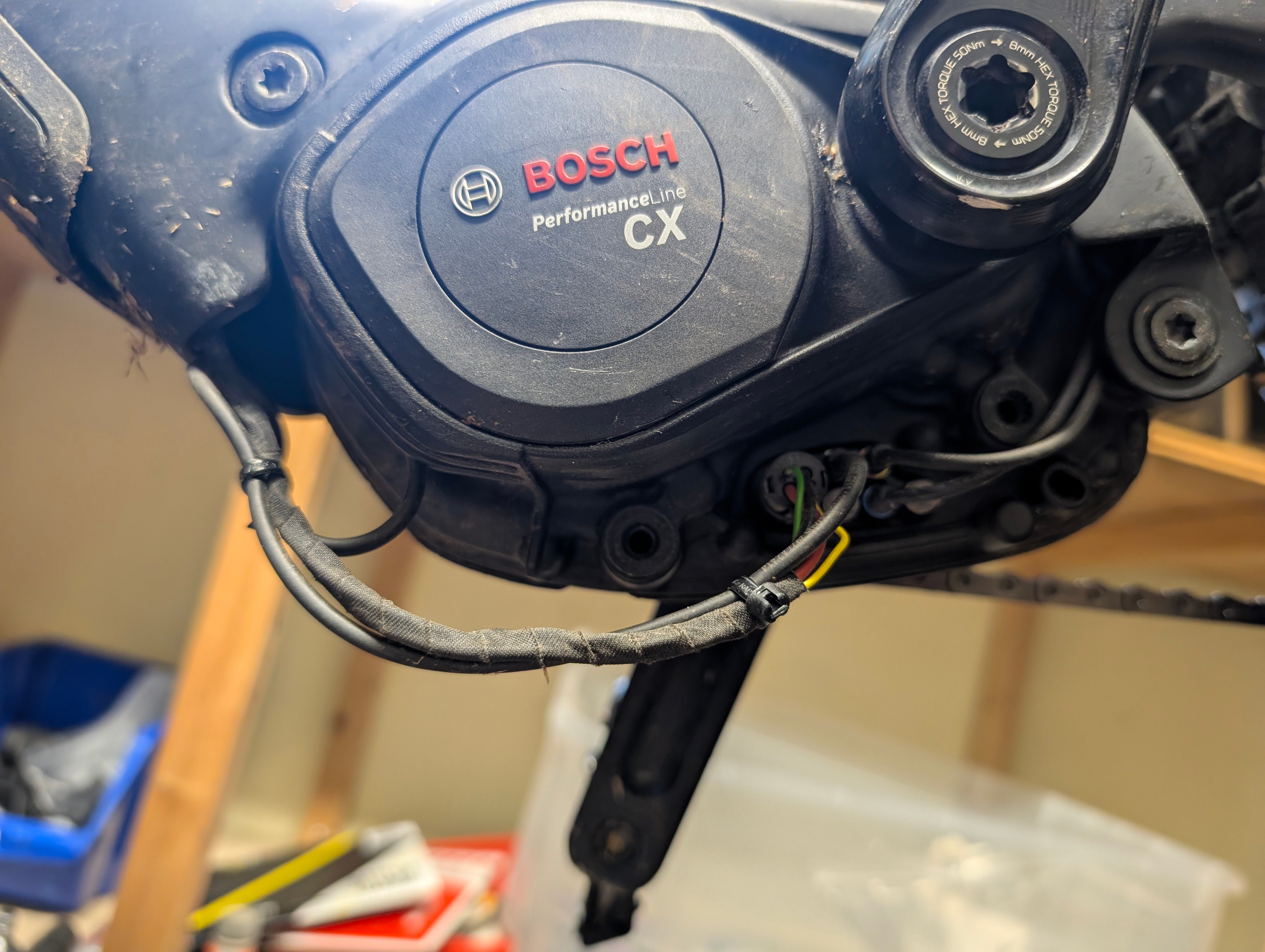

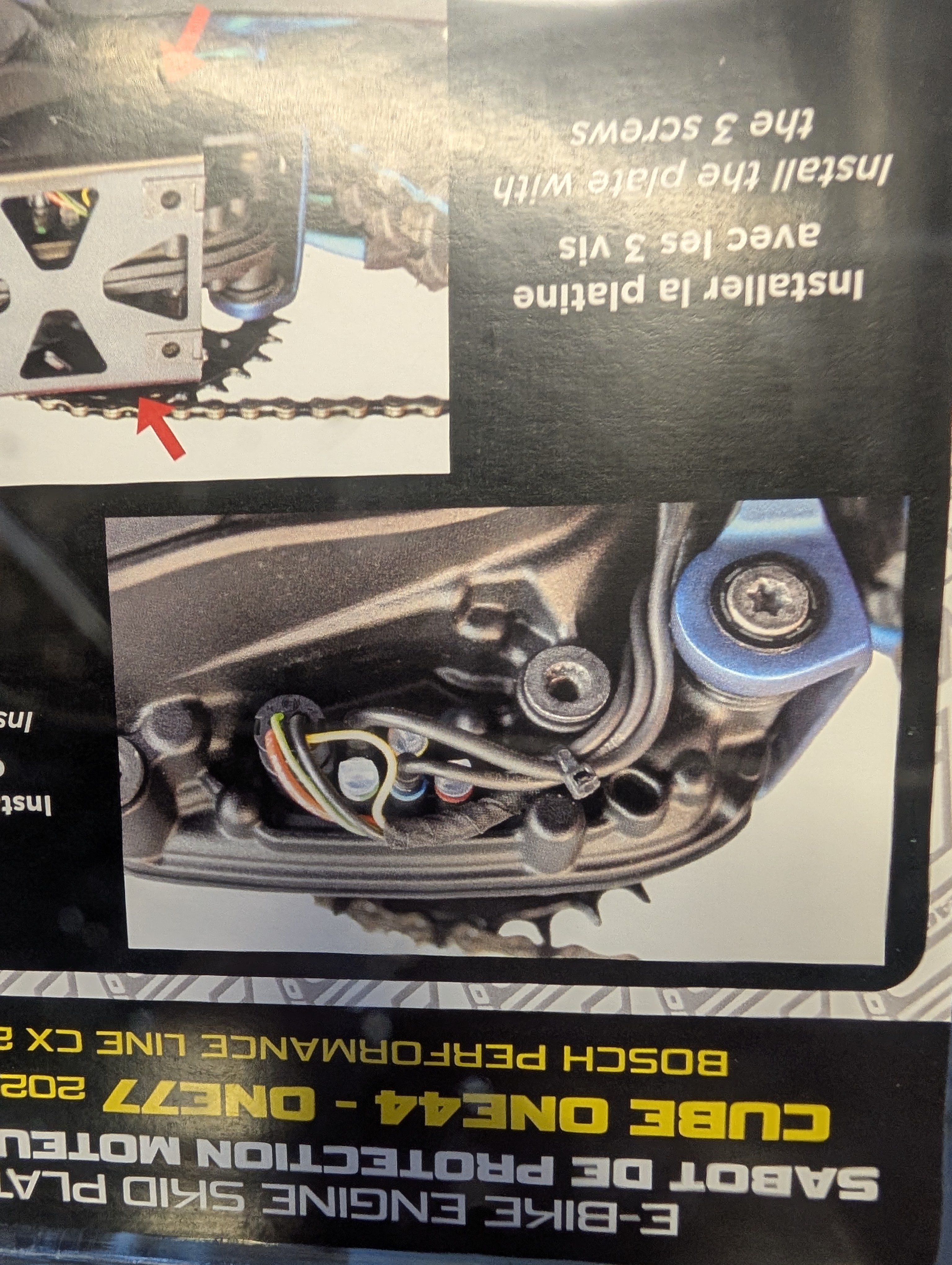

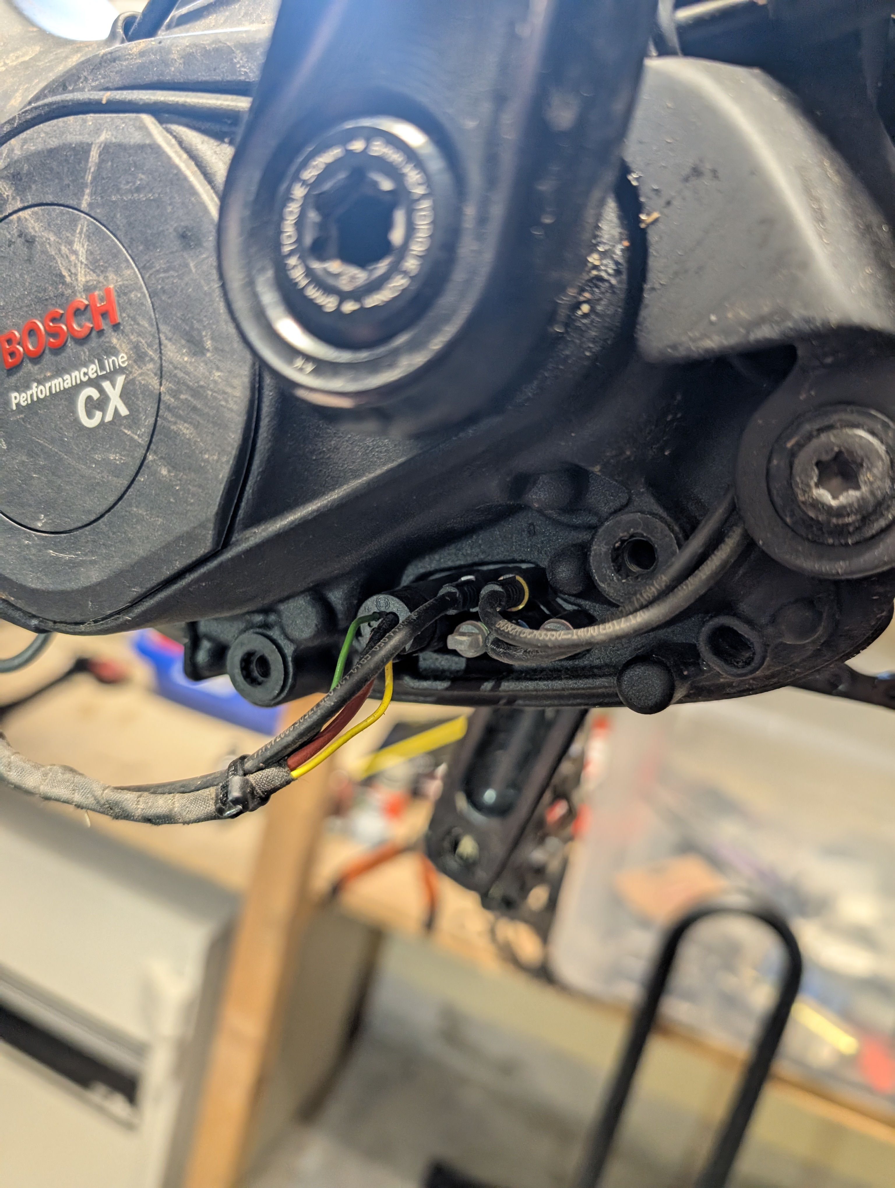

About to install this Alu plate and find my wiring routed on the front side of engine can anyone check there bikes and se if this is correct. Or do I need to drop engine and relocate?
PXL_20250913_071842557.jpg PXL_20250913_071827469.jpg PXL_20250913_071822490.jpg PXL_20250913_071150350.jpg
I’d move that so it’s over the top and comes round from the rear. It should all tuck into the space where the plugs are
Thank you, have not dropped engine before but should not be to much worried I guess, engine bolts blue loctight and 30Nm right?

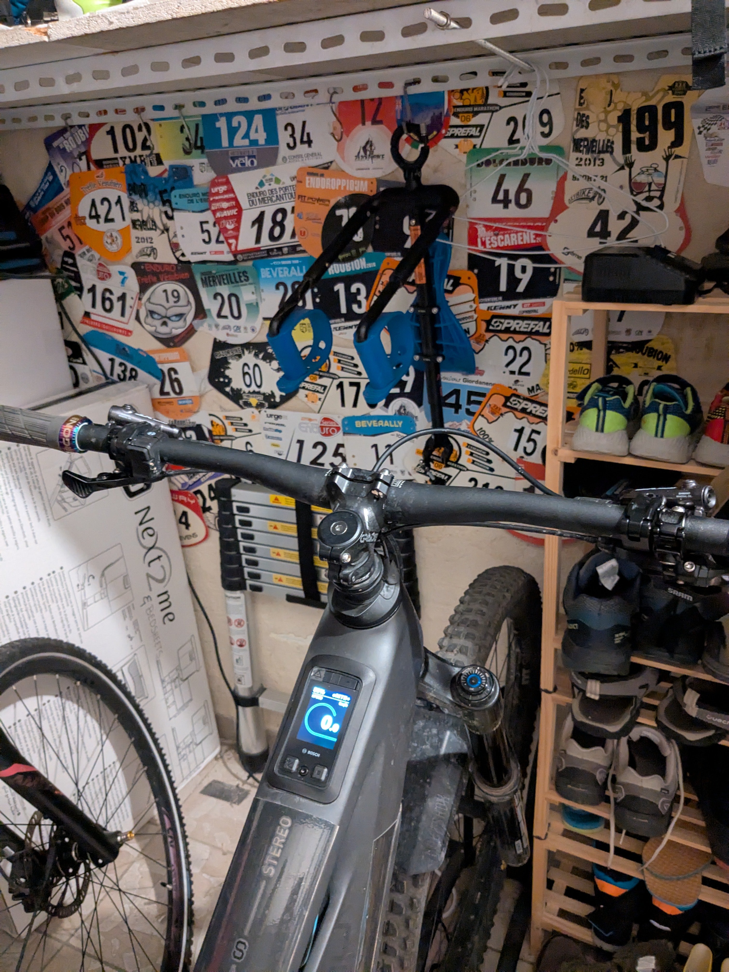

Looks good that. Did it come with everything you need to fit it? I know there’s been some confusion as to what mounting plate is needed.
Did you have to remove the Purion wiring completely as well?

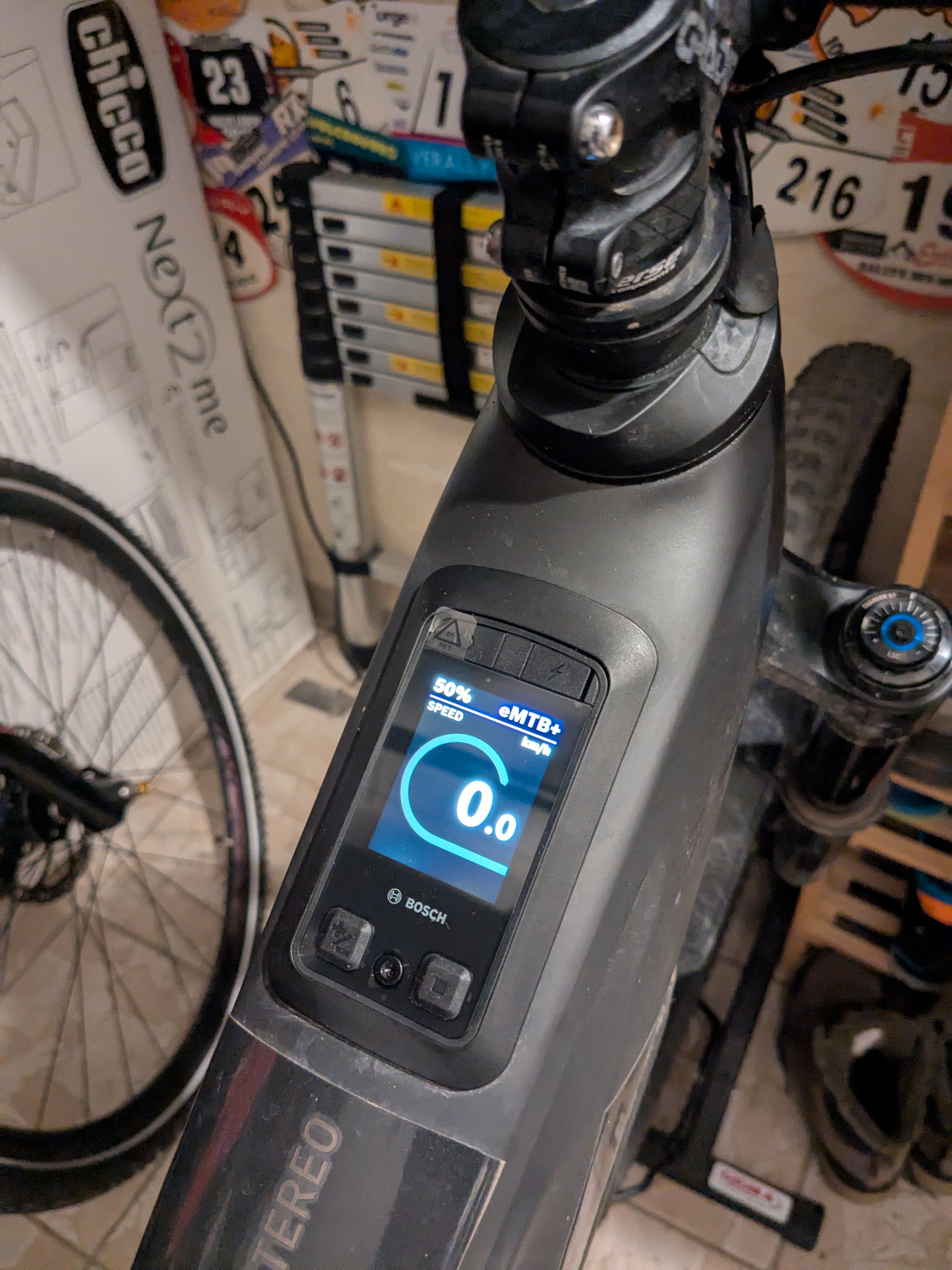

I got the complete kit (kiox+plate) from bike24 specific to the bike, it's linked on the previous page.
No instructions in box.
I unscrewed the old one, unclipped wire, clipped wire in new one, popped new one in, screwed... Had to connect the app at some point.
My wireless mini controller isn't pairing as I didn't unpair it from the old system ahead of time, so not that smooth a process.
If anyone makes the same mistake as me: pop the battery out of the controller for 30s, then when you put it back in immediately hold the - button for 5 seconds, this resets the pairing mode (flashing blue). You need to do this while the phone app is looking for a new device, in options-"ebike pass"

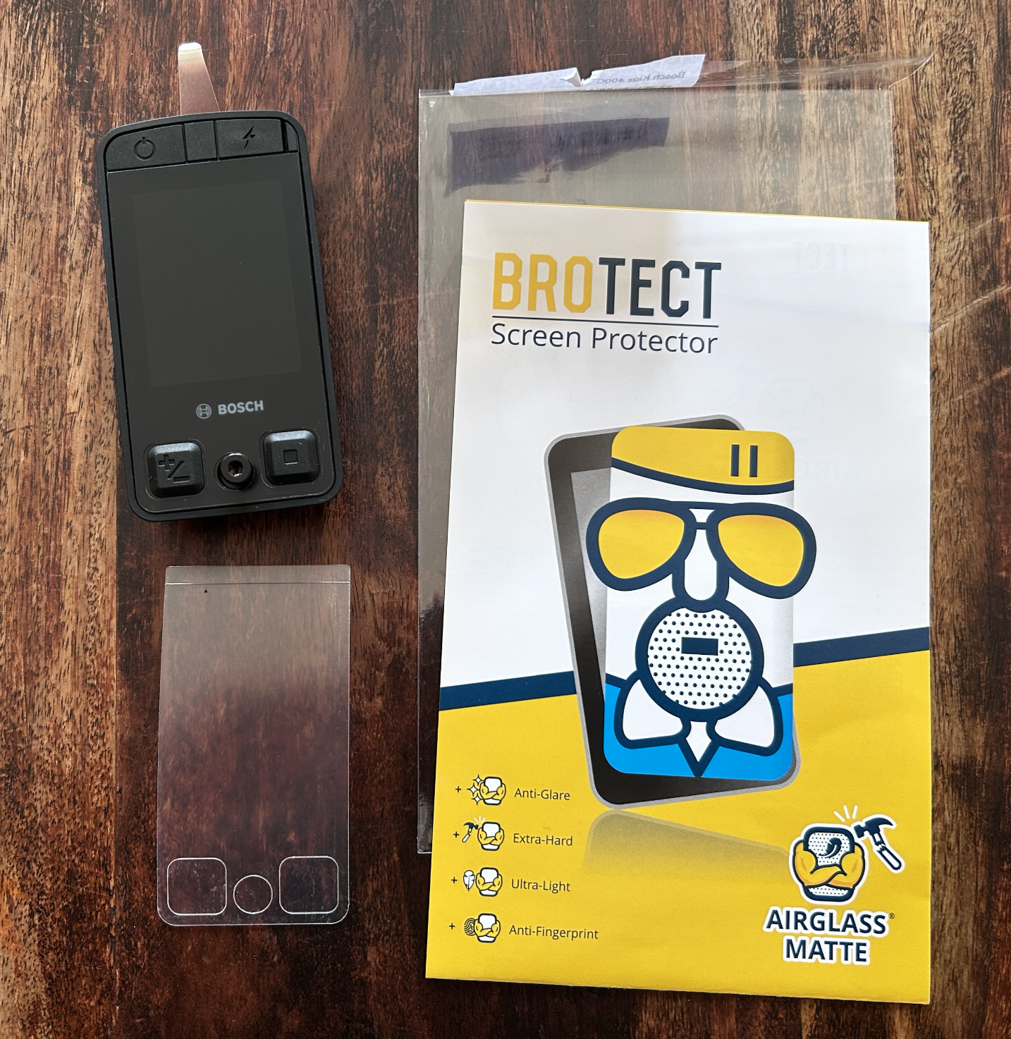

Although I have yet to get my adapter plate (hopefully by next week) I have fitted a matte anti scratch and anti-glare screen protector to the my Kiox. I got them on Amazon if anyone else wants to do the same: search
brotect Anti-Glare Glass Screen Protector Matte compatible with Bosch Kiox 400C (3 Pack) - Anti-Scratch 9H Protection Film​
