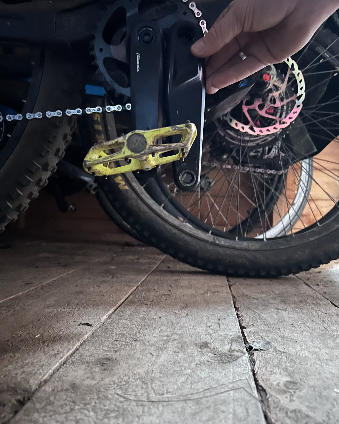

This helped me alot from pedalstrikes, went deep into suspension tuning and found that I had to much sag and now bike is alot higher when riding, this have bit not made any negative impacts on my riding ability or comfort.
I found the front shock setting to be important. I was having pedal strikes and found the bike to be almost unrideable on uphill technical single track with the rear shock setting closer to 30 than less than 20 mm sag. I now keep it <= 20mm
Interestingly the Fox Manual recommend a lower than average setting if you have the Fox 38 Rhythm grip, as follows:
Fox 38 Rhythm is designed around 15-20% sag

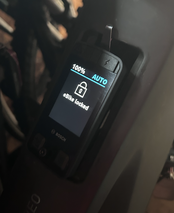

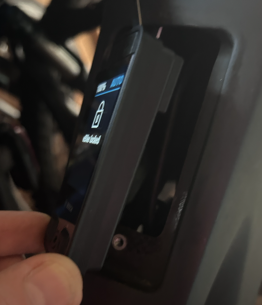

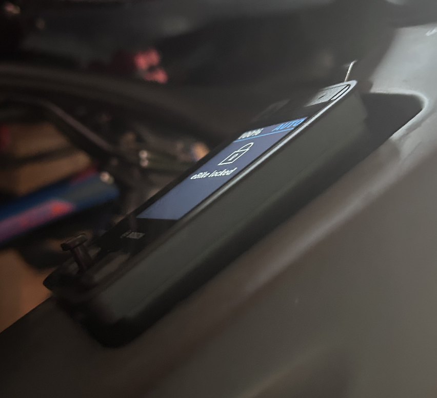

If anyone is curious. This is what the Kiox 400c looks like in situ without the adaptor plate. My theelectricbikeshop will have the adaptor plate in stock in a week or two, so will fit and update here.
Apparently I am one of the first to get the display (from their shop in Cardiff) and very hard to get hold of at the mo.

I got my display the other day. Just waiting on mtb monster to send me the bracket in next 2 weeks. Does look smart with the screen but it should have been like the Santa Cruz where no bracket is needed.
100%. They knew about it, like Santa Cruz, but didn't make the hole the correct size ready to retrofit the display. Disappointing. We'll possibly be the first two to get them on!
