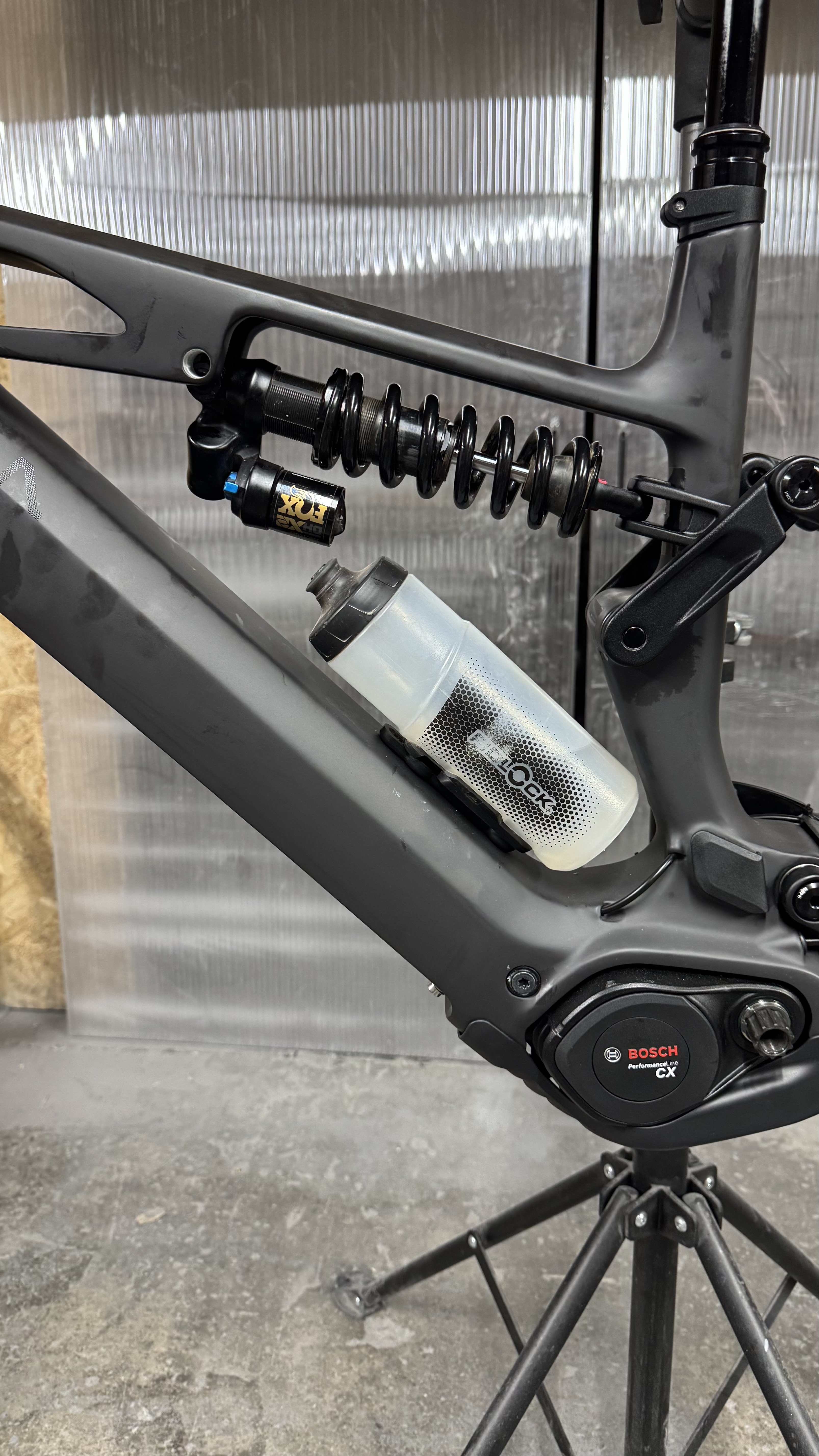

Firstly sorry for the rubbish video but we was trying to get the noise on camera the best we can... my bikes making this noise like your riding over a cattle grid when pedalling or freewheeling and i cant work out where its coming from, it sounds like the rear end to me.
it does it in all modes and off, it does it if im standing or sitting. It doesnt do it bouncing on it or when im off the bike. Ive checked all the bolts and shock mounts as well. If anyone has any ideas i'm all ears as its making me not want to ride it.
it also does it with the airshock as well as the coil.
Thanks
Also...its not a consistant rattle, so nothing is attached to something spiraling. It is a loose random sound. The sound is not metal, but could be aluminium or carbon. Stone in rim, loosened spoketension screw that subsided into the rim, or something inside motor.

Right little update on my issue... I've had no rattle for last 2 rides after replacing the motor mount bolts, these seem tighter in the mounts then the old ones. I'm so happy now thats been sorted but ill keep an eye on it. :D

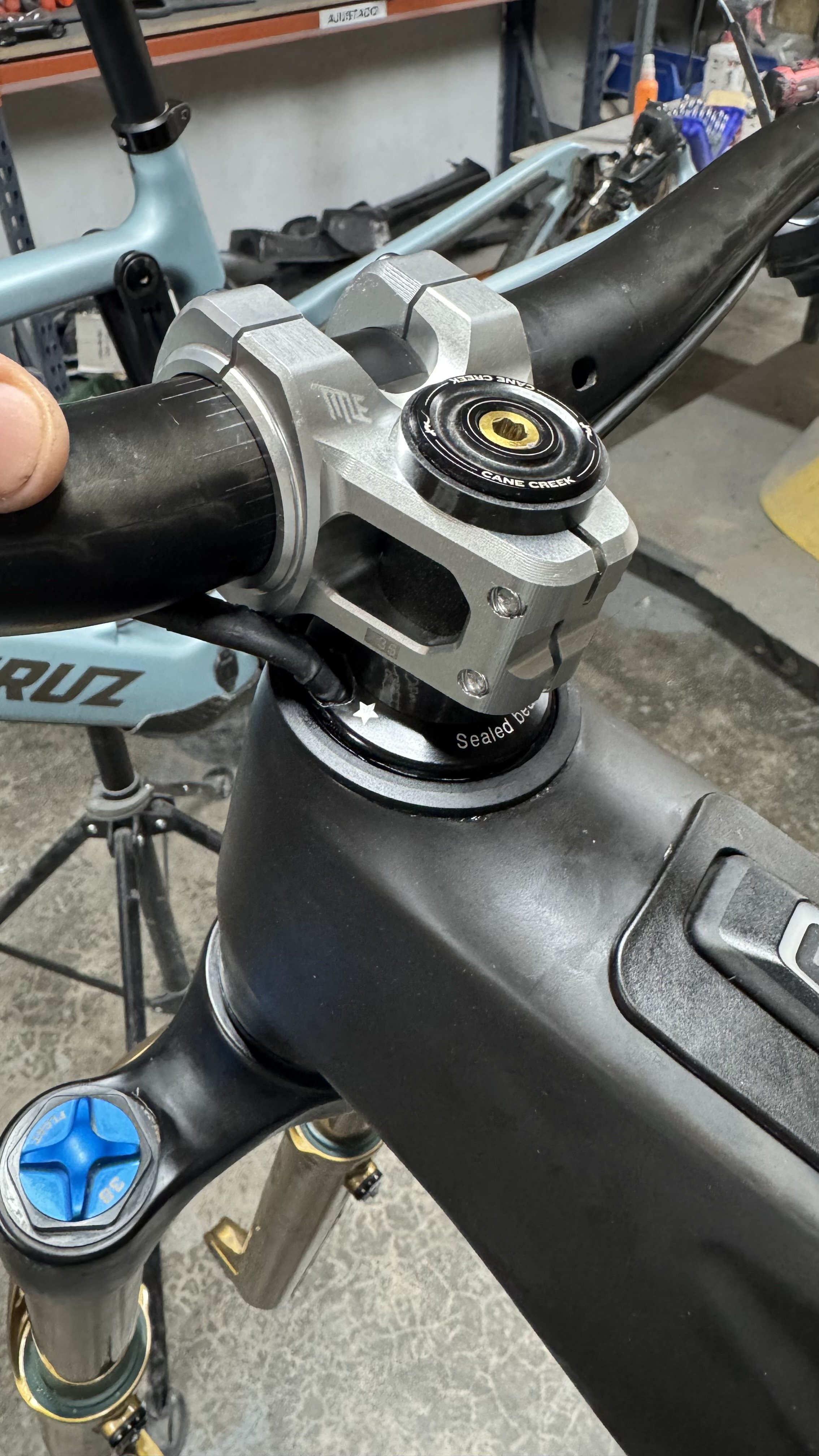

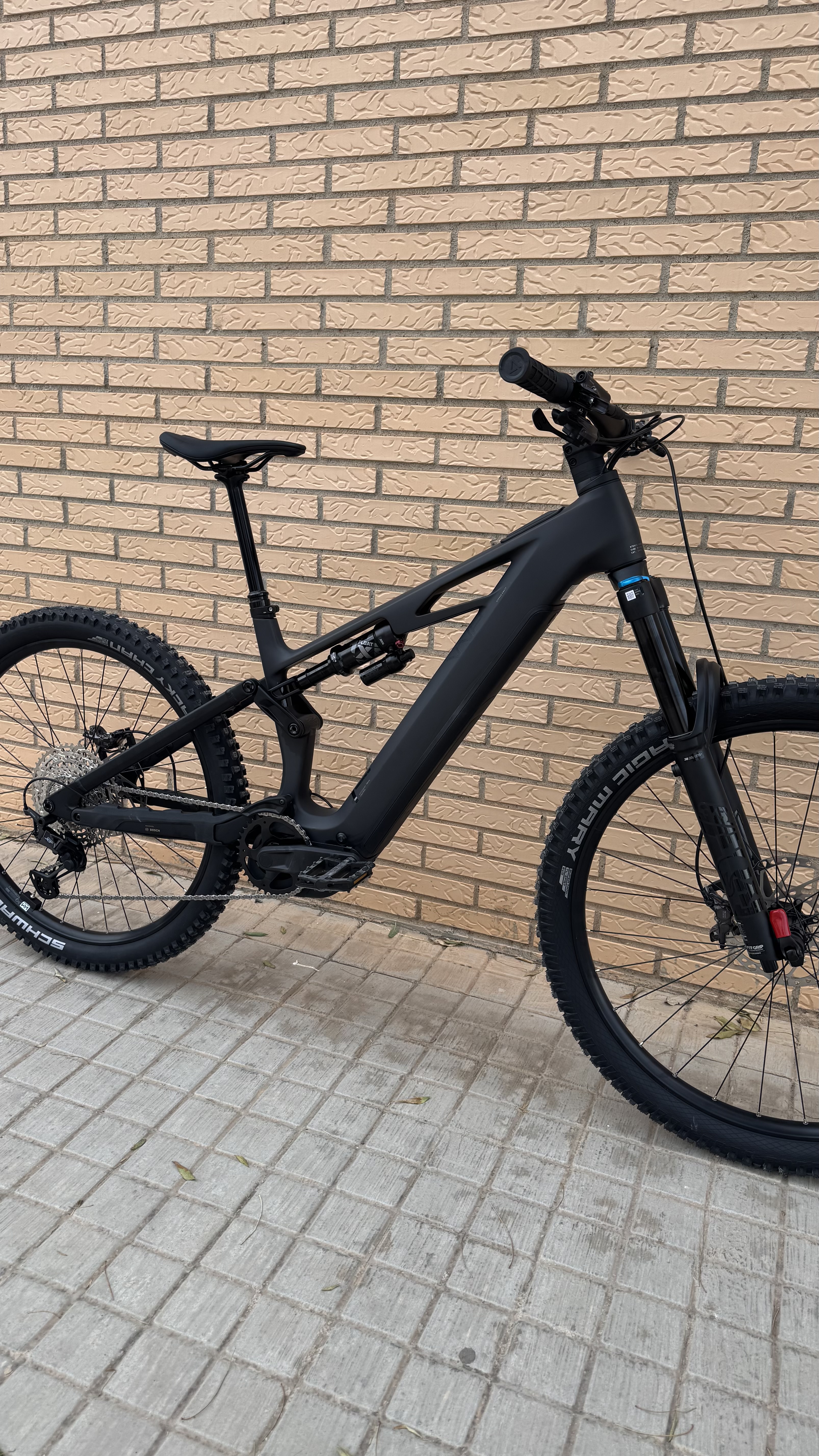

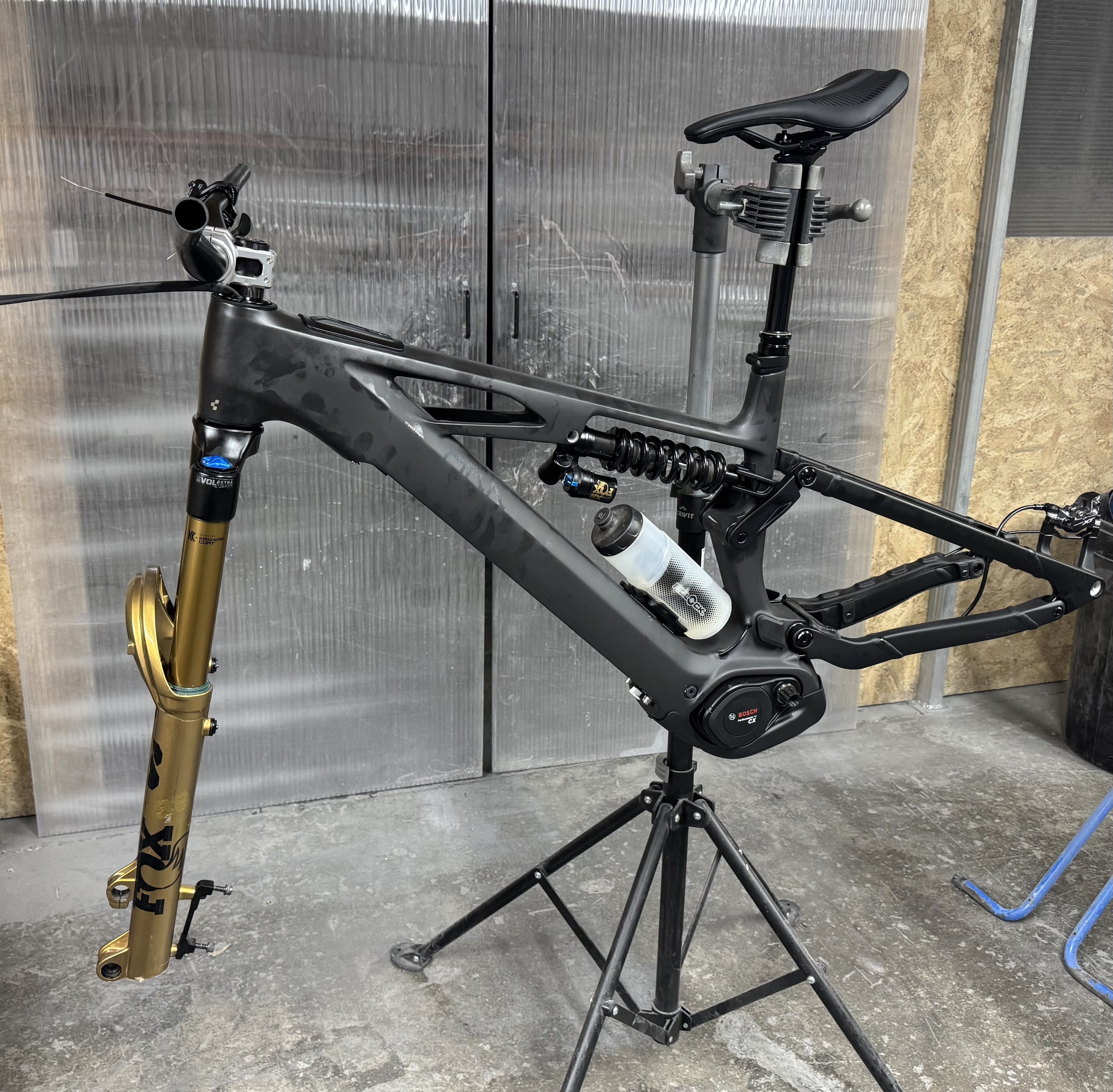

Finally I’ve received my One77 and I’ve already completely disassembled it! I’m going to customize it with the parts from my previous bike…
Unfortunately, the stem height I like doesn’t allow me to use the stock top cap, so I modified a regular one.
There’s a cable with a connector at the front that I don’t recognize— is it for plugging in a light? I wrapped it up and hid it inside the frame.
I’d like to know if it’s possible to remove the Abus lock cylinder that holds the battery so I don’t have to depend on a key. I’d rather use an Allen key or something similar… has anyone done this?
This week I hope to finish the assembly and test it out.
