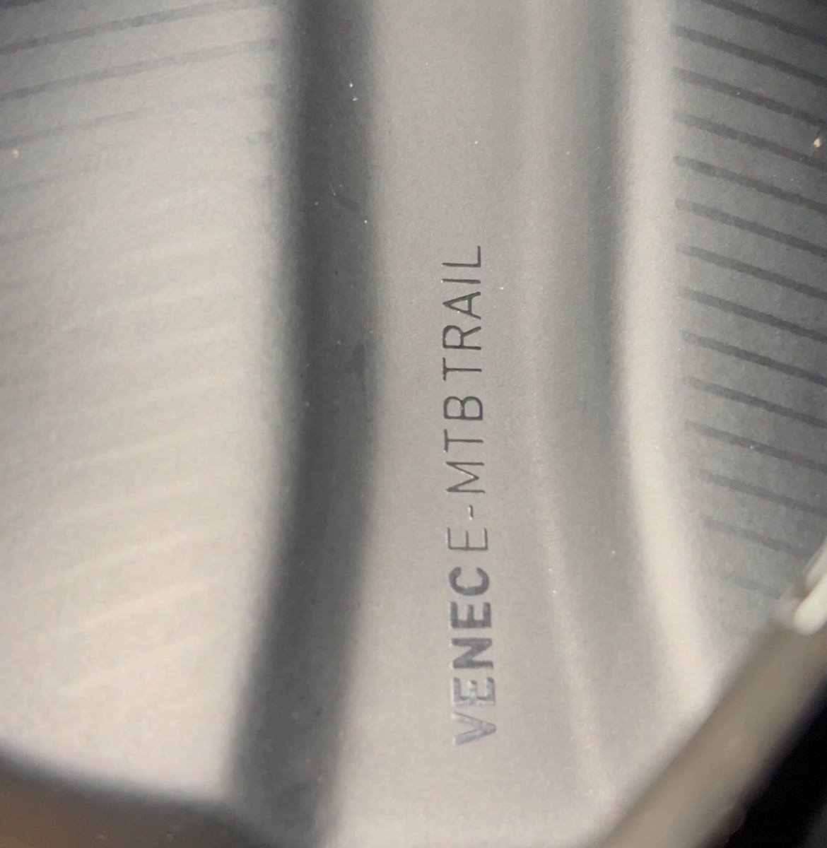

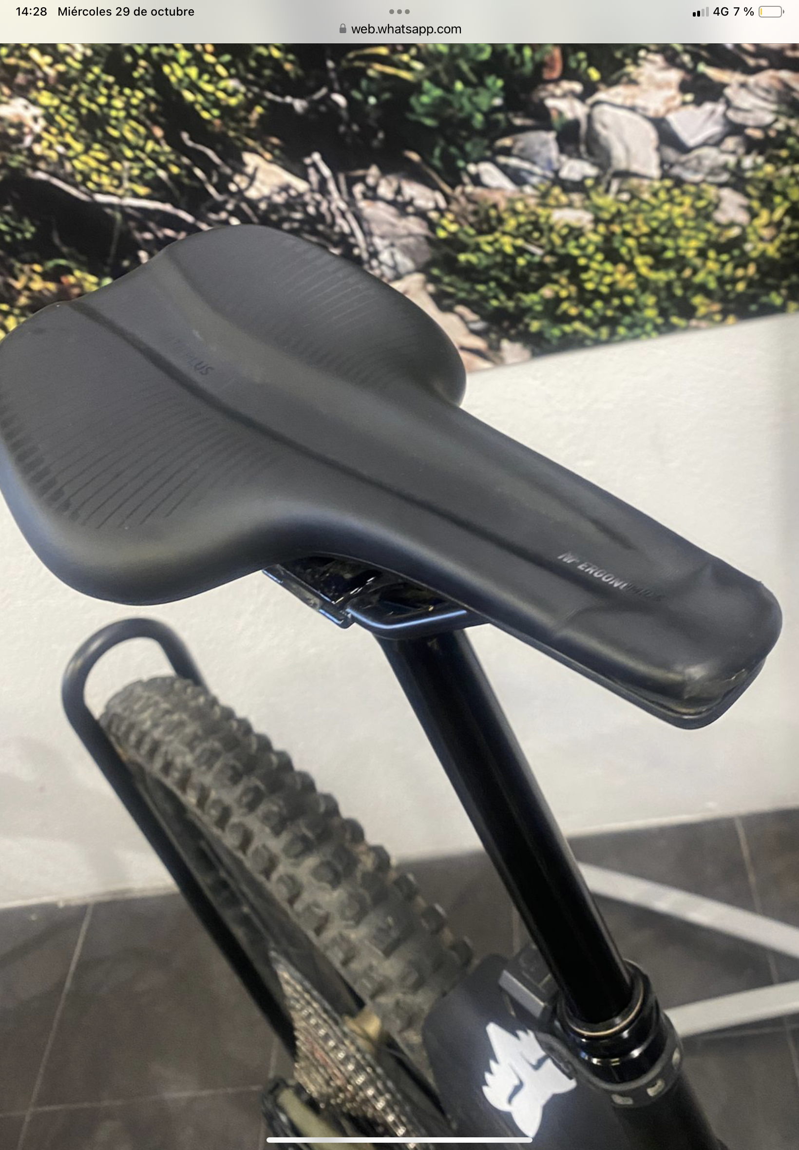

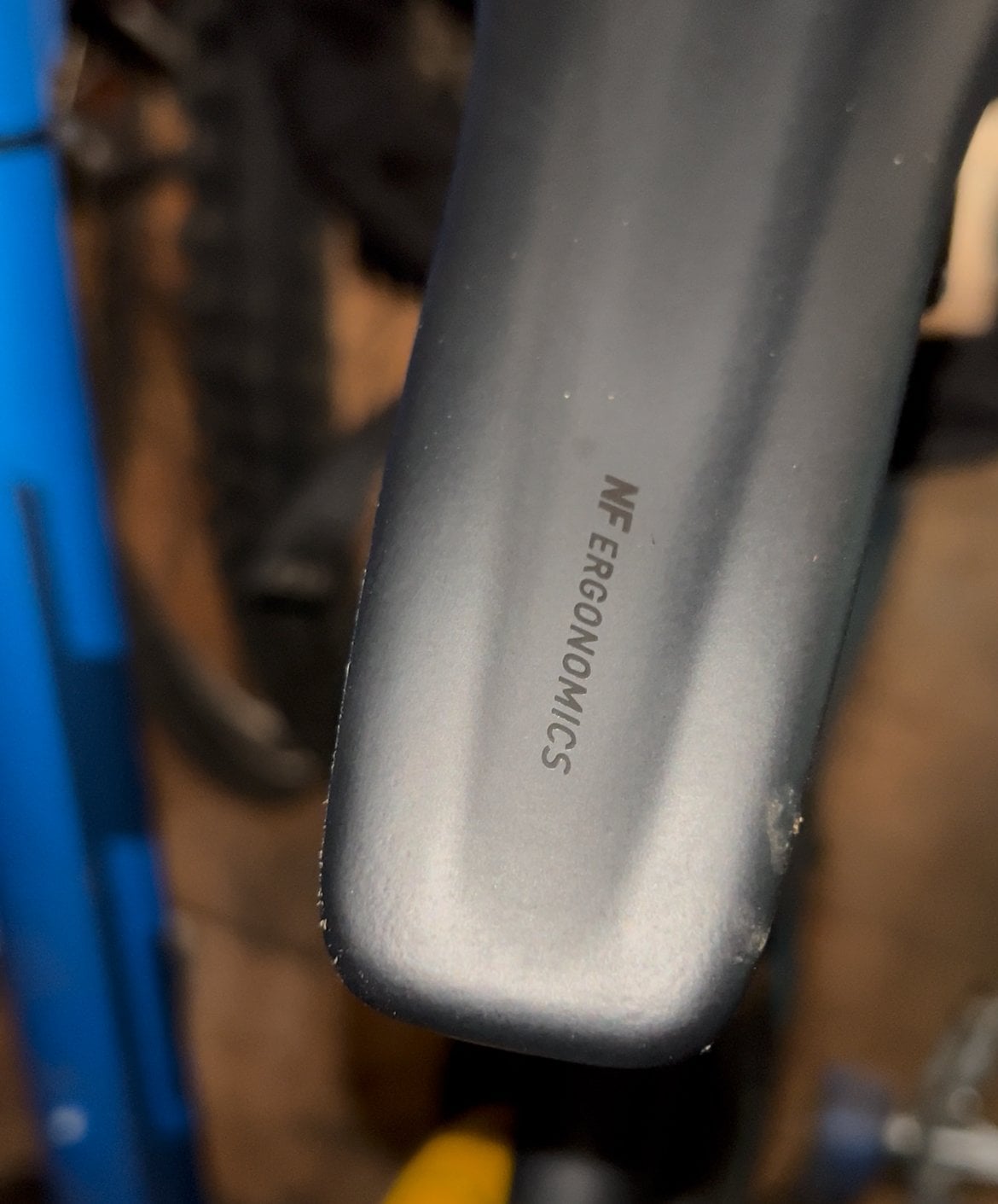

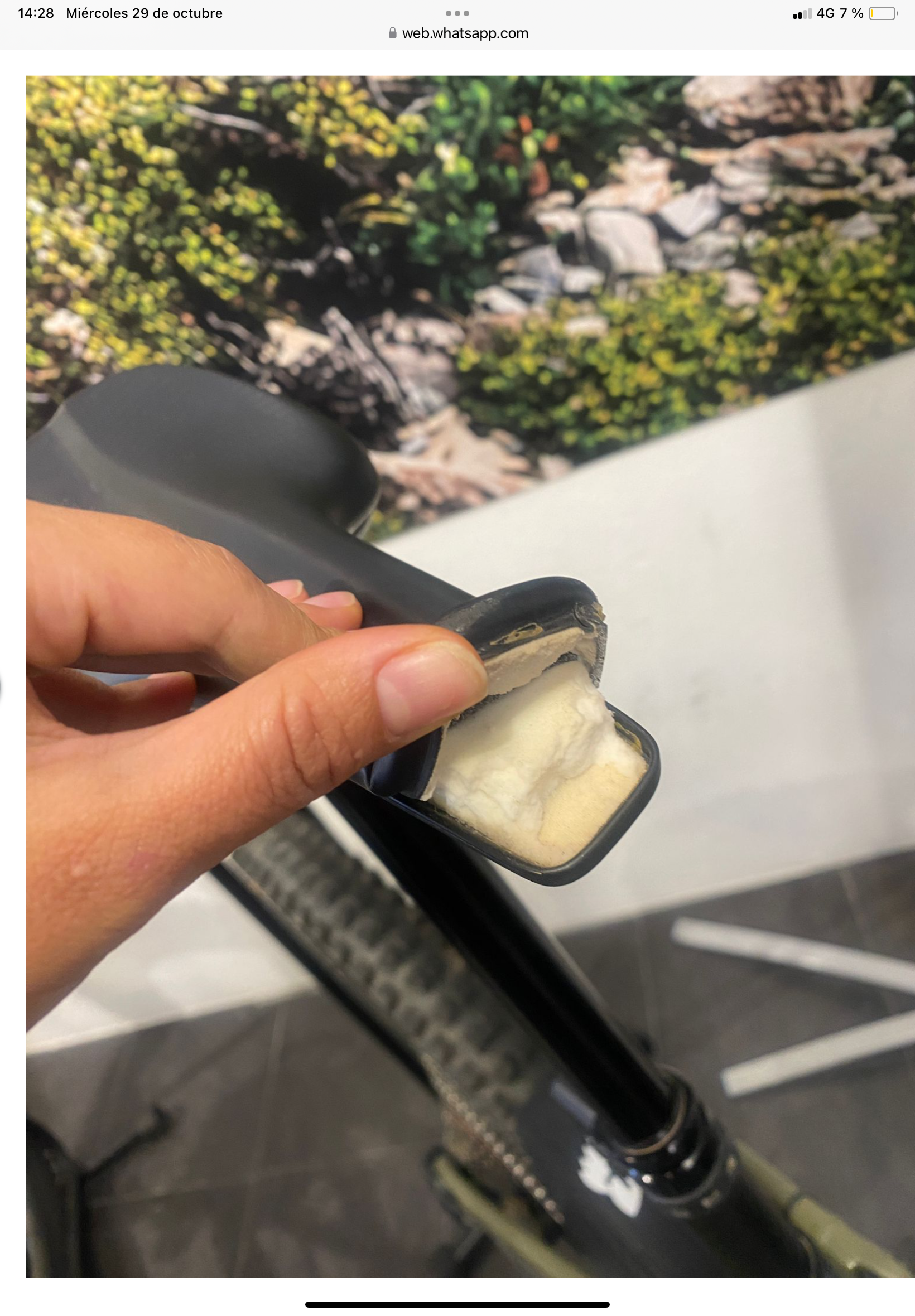

Hi, does anybody had a problem with the saddle , mine is broken by the narrow part , it is a One 77 TM purchased in June and my dealer tells me that probably is not cover by Warranty .I think is clearly a manufacturing or material defect.
are you the first owner? the factory saddle should - I think - be an Acid (CUbe's own brand) whereas I'm seeing the word Ergon in that pic, suggesting that it's not the original saddle.
My saddle collapsed on the left hand side, but IMO not a big problem 'cause it's a crappy saddle anyway. According to my buttocks...
Doesn’t look like a warranty claim to me, you can see where the finish is rubbed away on the cover at both sides of the nose.
Doesn’t look like the OEM saddle either
It's the original OEM saddle and not an Ergon saddle. It's an ACID Venec.
I'd go to the shop with it and ask for a replacement. They can send that one back to Cube for credit.
Yes I am first Owner ,and the Bike was purchased at a Cube dealer , and It's supposed to be a ACID Venec EMTB Trail 140 saddle .
I'd be asking for a replacement, but I also wouldn't be that bothered about buying a nicer steel rail saddle for 40e (recommend WTB volt personally) if they deny it.

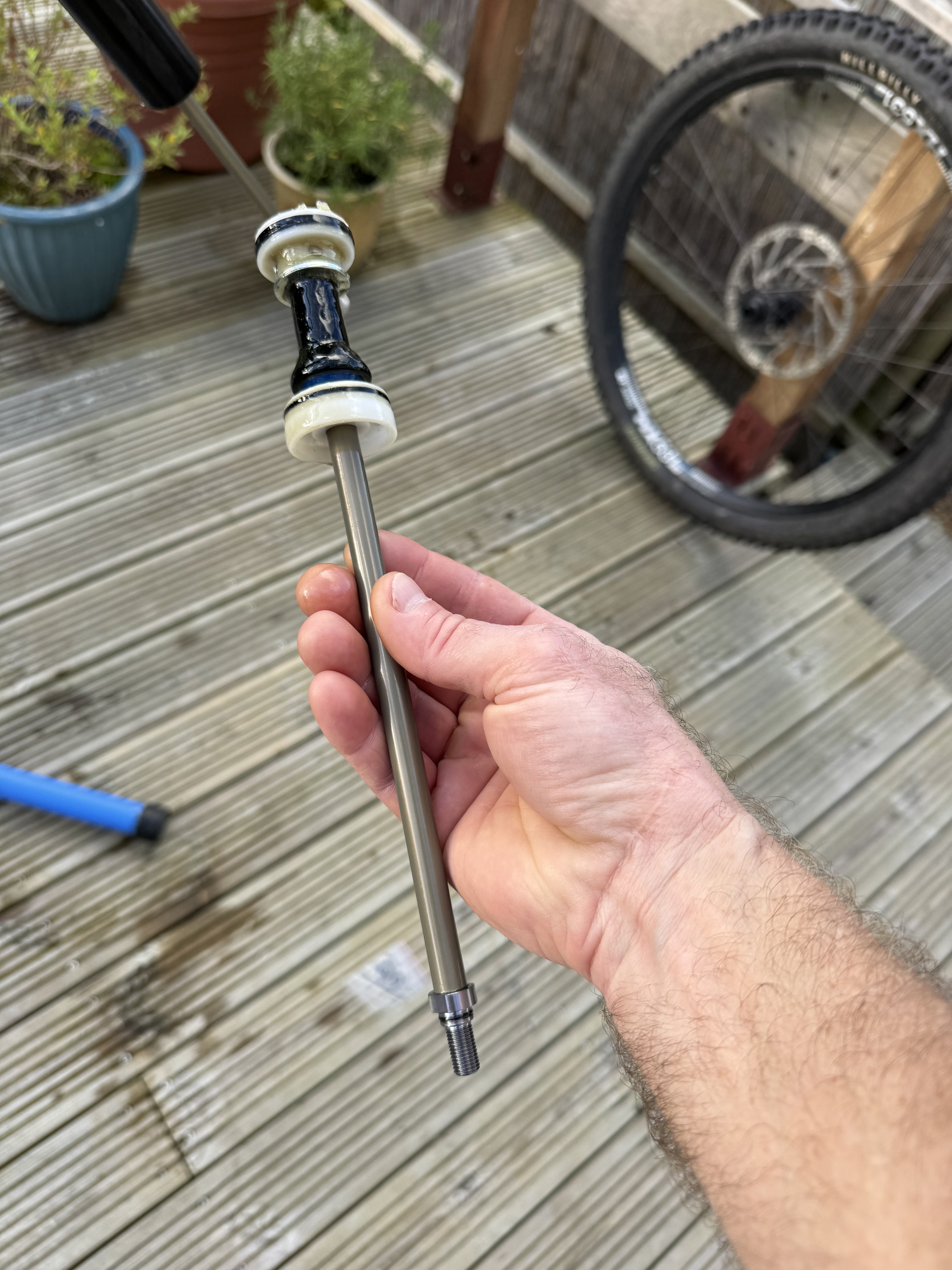

So I got my big 190mm ZEB back from warranty (blew the damper), was perfectly happy with the stock 170mm fox 38 for the month the ZEB was absent. A bit disappointed that my front end creak has returned which means either the ZEB has CSU creaking or isn't playing nicely with the headset. The fox was silent. I noticed my Zeb steerer tube has some wear on the black coating at the level of the top of the headset.

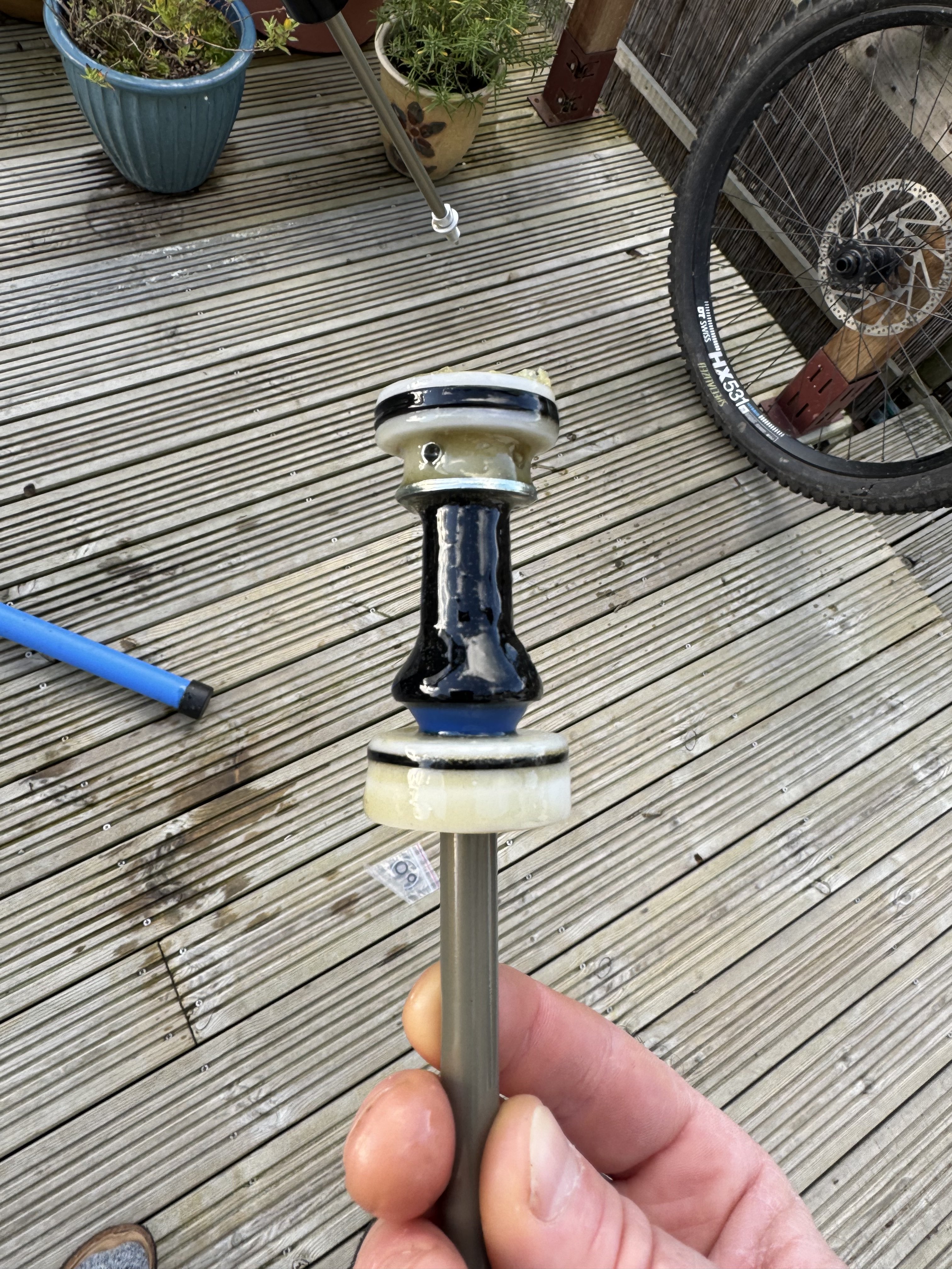

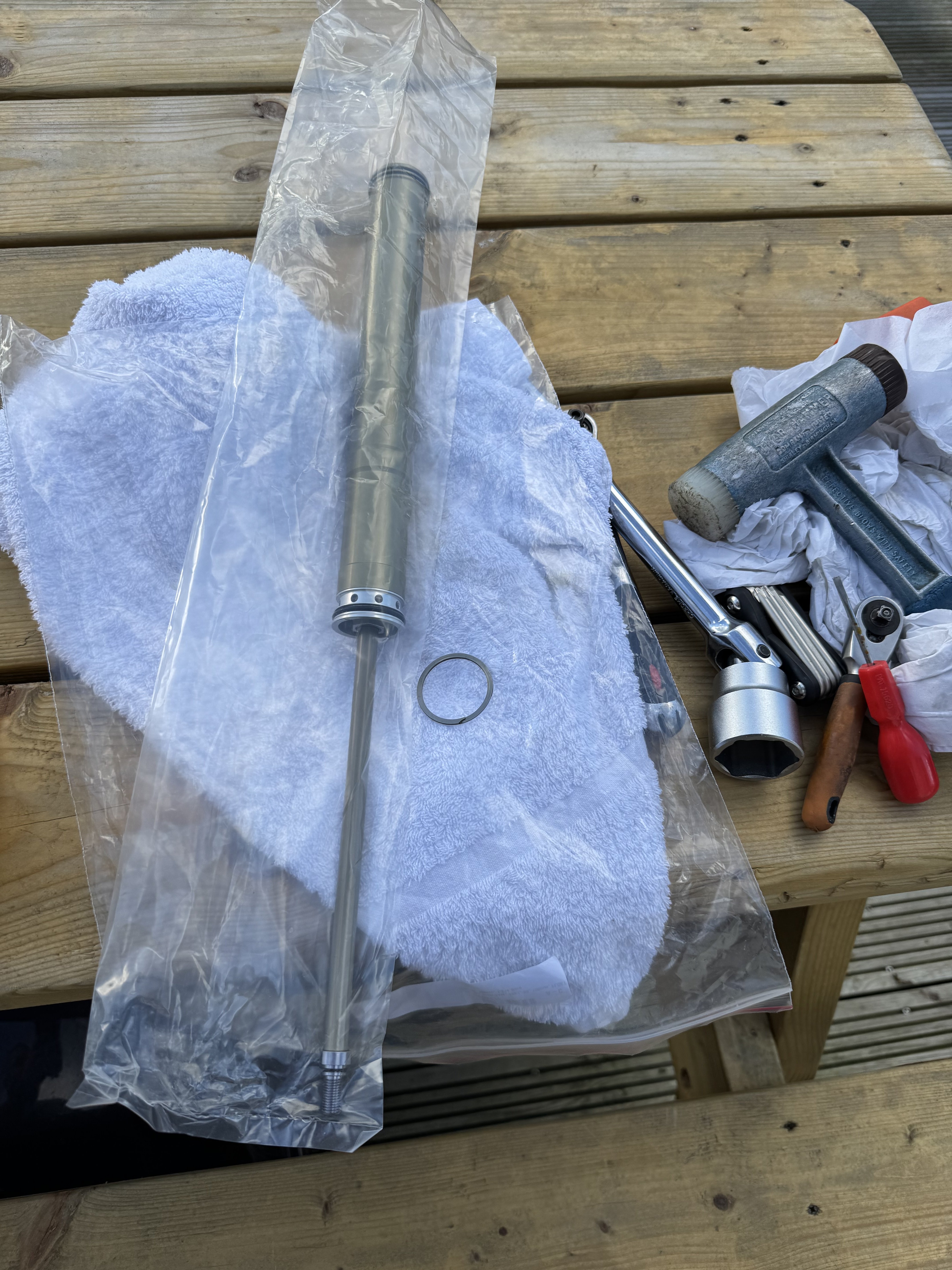

I went to install my new Fox 38 180mm airshaft
And the fecking air shaft on my 2025 Fox 38 looked like this on removal!
Not seen this version before and now I have a 180 air shaft I can’t return because it’s out of the bag and now slathered in suspension grease.
Not a happy bunny.
