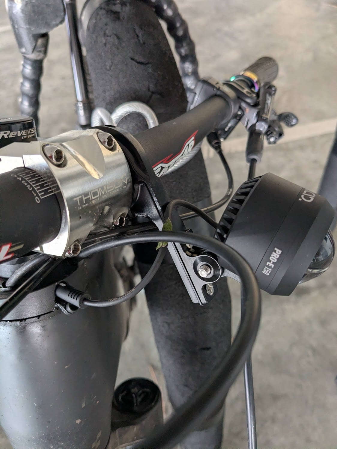

FYI: I finally got my Cube acid light working, it needed a setting enabled in the bosch diagnostic tool from a shop.
It is nice to have the light connected so easily to the headtube and never worry about charging another battery. Mounts to any gopro mount, and comes with a custom connector for the stock stem (didn't try it). Now I don't find the light that bright and there is a weird pattern, think of a like a diamond pattern.
So great for commuting, but you will probably need to pair it with a helmet mounted light for trail riding.
It is this one: ACID E-Bike Front light PRO-E 150 X-Connect

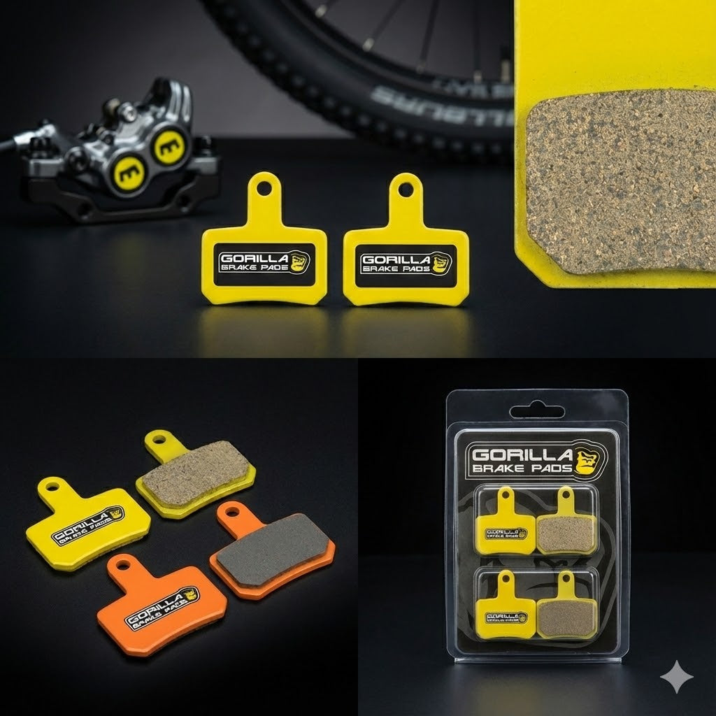

What brake pads are you putting under these bikes i have these brakes
Magura MT Thirty. Front 4-Piston/Rear 4-Piston. Hydr. Disc Brake (203/203)
Gorilla Brakes are my go to brand. I find they're on par with Galfer performance wise, but cheaper.
I like their black Enduro Pro Resin pads as they have loads of bite and are nice and quiet (although this is on analogue bikes, but I'll be using them when my ebike arrives too).
They will also recycle your old pads for store credit, which is pretty cool.
I use Galfer purple pads on various brakes (Sram, magura, shimano), good increase in power from them but expensive.

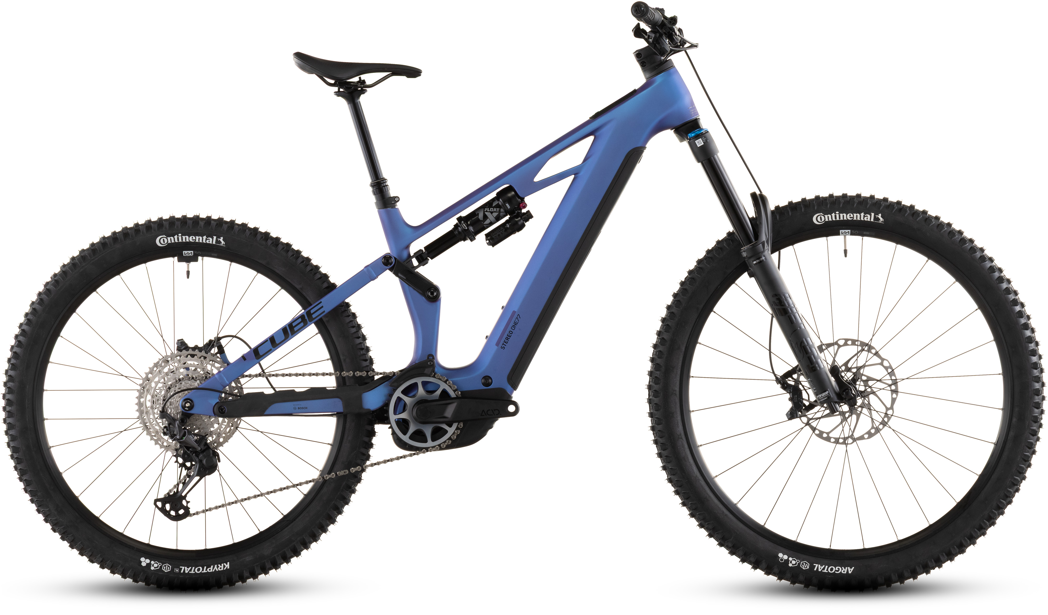

Speaking of purple, I saw the new SLX in purple at a shop, wow, really nice colour close to oil slick in real life:
Cube Stereo Hybrid ONE77 HPC SLX 800 blueiris´n´black
