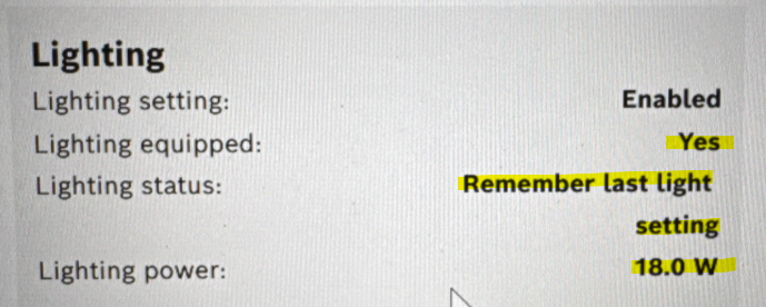

From what I've read somewhere, the basic version of the One 77 Race doesn't have a cable installed to connect the light. I have the Race version myself. You need to buy a cable and connect it to the engine, or perhaps a cable splitter near the display will work. You'll probably need to contact a Bosch service technician to enable the light option in the system. This can be done remotely. I've seen people on the forum who install US software, and they can certainly do it for a small fee. If you contact a Bosch service technician, they'll probably tell you which cable to buy.
P.S. When you connect this lamp, please share the information on how to connect it because I am also thinking about buying the lamp and the Kiox 400C display
I finally got this working. so what needs to be done.
Buy the X-xonnect BSE3 cable that you plug from the blue port on the motor to the front light.
after that you need to make "someone" or dealer change this in the Bosch diagnostic tool
This is crucial previously i only had the lightning settings enabled.
after all that my light wouldn't turn on i scratched my head almost giving up and asked chatgpt what the fuck was going on than i had to hold the + for 1-2 seconds on the mini remote and the light came up :LOL:
Amazing light and much brighter than my previous battery one i had.
Ridiculous that a Bosch dealer has to activate the lighting port. 1 minute change including connecting to the bike.
Fully agree, maybe we should set up a pressure group to try and get Bosch to change this so lighting and power ports (LPP & HPP) can be activated over the Flow app.
