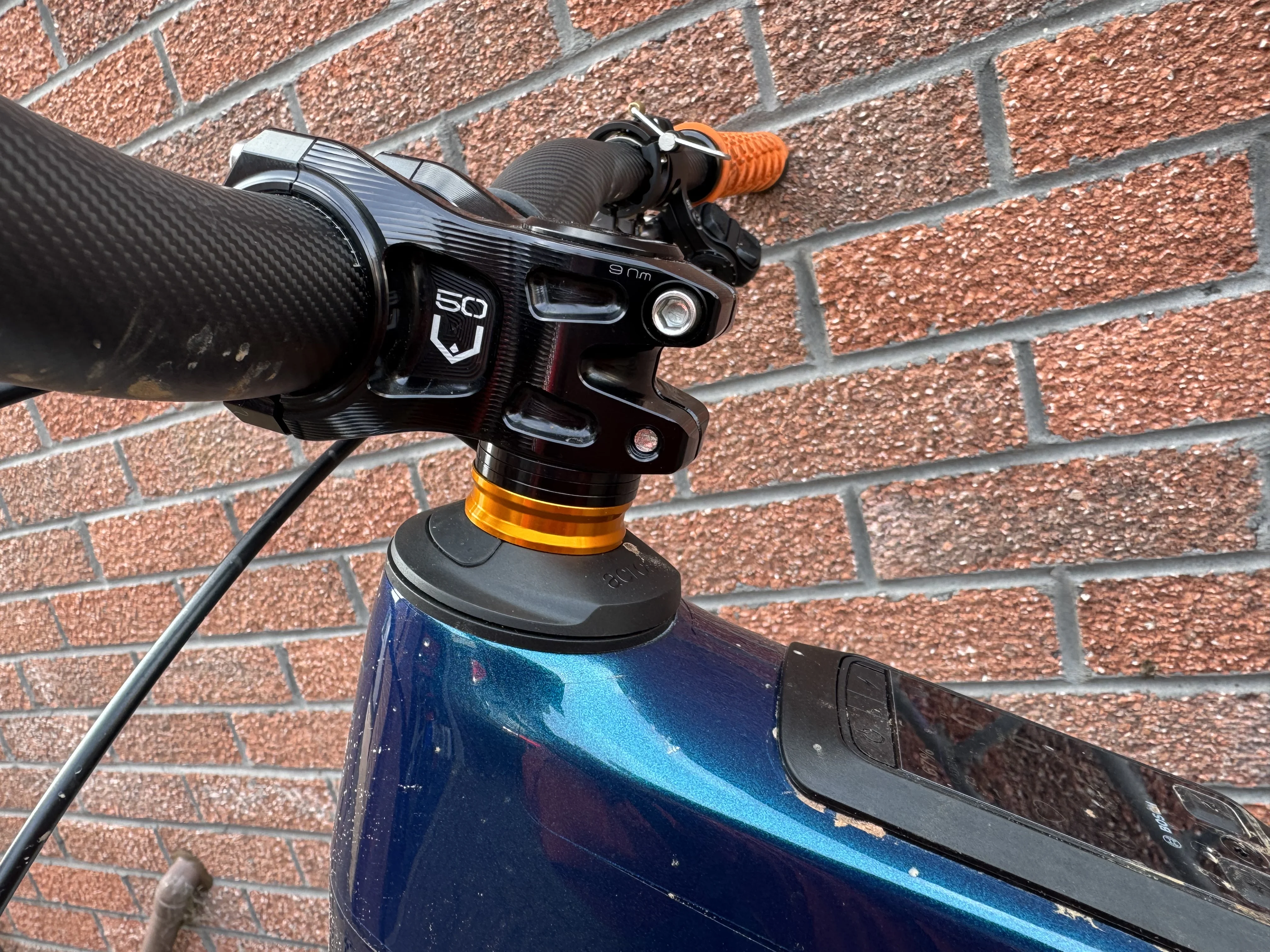

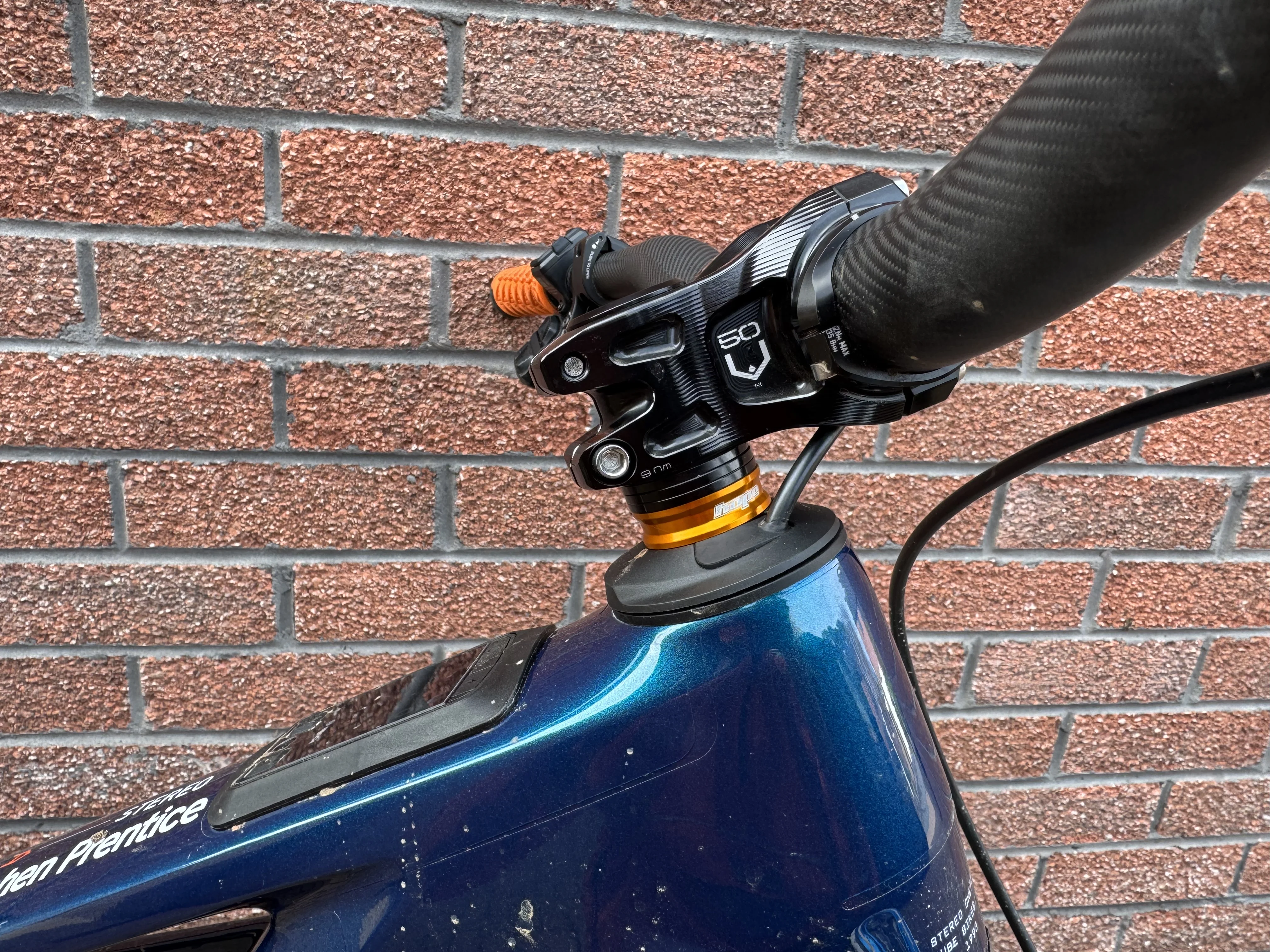

This is what mine turned out like. Still on the original headset but no X-port and with a slimline Acros 32.52.107R1 AM cable port, standard round fit stem and headset spacers
I got rid of the Purion 200 and the dropper cable as well

View attachment 181491View attachment 181493
looks good - I am replacing the ICR with the easybikeparts one so I won't be using the Acros kit. What's the height in mm of your spacers please, assuming you didn't need to amend the length of your steerer?
I didn’t alter the steerer, the stem is 40mm and I have 15mm of spacers in total

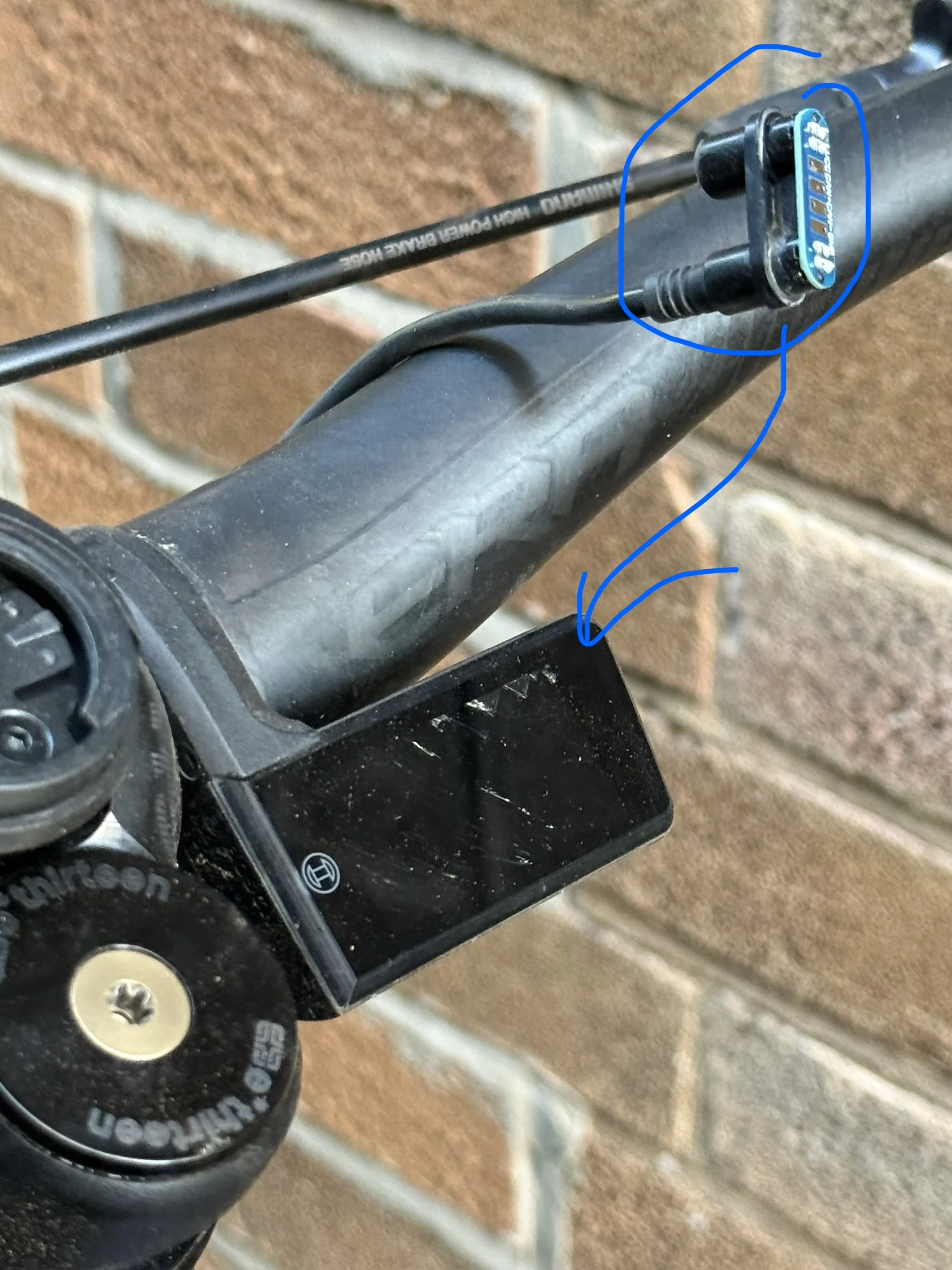

After loosing the front end on a steep dusty off-piste shoot at my local trails yesterday, I've not only been left with a very hurty left shoulder (nothing broken though.... I think), but the Purion 400 display on my One77 AT was completely smashed and the cable port broke off (picture below); it's definitely non-repairable.
In tragedy there is opportunity and this is finally an excuse to change the main top tube controller for the Kiox 400c, rather than replace the Purion 400 with another Purion 400 (given it's in a rsiky place to get broken again). Having read some useful earlier posts in this thread, I think the sequence of events is:
  • Buy a Kiox 400c (already ordered from my LBS here)
  • Buy a Cube Kiox 400c top tube adaptor (already ordered from here)
  • Pull the Purion 400 cable through the headset routing and tape it up inside the top tube (likely never to be used again, but still there just in case)
  • Use the spare rubber/silicone cable port bung from the broken Purion 400 display to plug the hole in the headset routing left by the vacant Purion 400 cable
  • Remove the Purion 400 from my attached devices in the Bosch Flow app
  • Follow these videos and for an understanding of how the Purion 400 was setup in the 2025 One77 bikes (Y connector) and then then how to replace the original top tube controller with the Kiox 400c.

I’ve recently swapped my Purion for the Kiox. It’s fairly straight forward. You’re right in doing all the steps listed early on in your post. I just coiled my Purion cable up, bagged it tight and secured it in the frame.
I had to delete the bike from the Flow app, along with the Purion and the mini remote, as it threw a hissy fit and wouldn’t pair with bike. It worked fine once all re-installed. It retains the motor stats once you’re all set (mileage etc).
Hope this helps. Any snags then drop me a PM 👍🏻
Forgot to add, I had to do the power and torque update again once installed.
