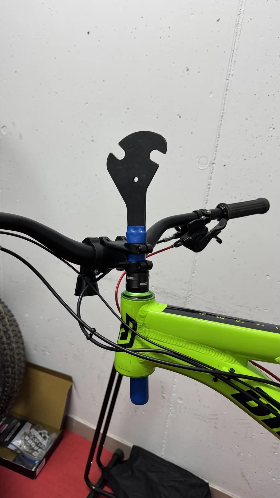

Hey all, my Fox Podium is leaking and needs to be sent in for service. Normally I would remove it myself instead of going through the dealer.
The only thing I’m unsure about is that the cables are internally routed through the headset. I had some bad experiences with this on my Orbea Wild, so I’m a bit cautious.
My question: is it easy to remove the fork and install it again on your own without causing problems with the headset or cable routing? Or would you recommend going through the dealer?
Thanks!
You could carefully remove the fork and while holding the headset assembly together with one hand, use some paper masking tape to tape it down. Or some straps. That way the assembly won't become a spaghetti mess.

You don't need to fully disassemble the ICR headset to clean and regrease it.
Not the same bike but here's how I stopped the clicking/creaking ICR headset on my Rise:
-Took the stem and all the spacers off.
-Cleaned spacers and applied a thin layer of grease
-Lowered the fork to clean/regrease the crown race and steerer tube
-Slid the upper bearing out and cleaned/regreased it along with the upper bearing cup in the frame
-Slid the lower bearing out and cleaned/regreased it along with the lower bearing cup in the frame
-Cleaned the cables and applies a thin layer of fresh grease
-Reassembled everything and torqued all bolts to spec
All of this was done with the brake/gear/dropper/motor cables still attached and through the bearings.
The Rise top cap bolt does require way more torque (8Nm) than on a non-ICR bike, so I expect the Cube will the same.

Here’s a hack for you
