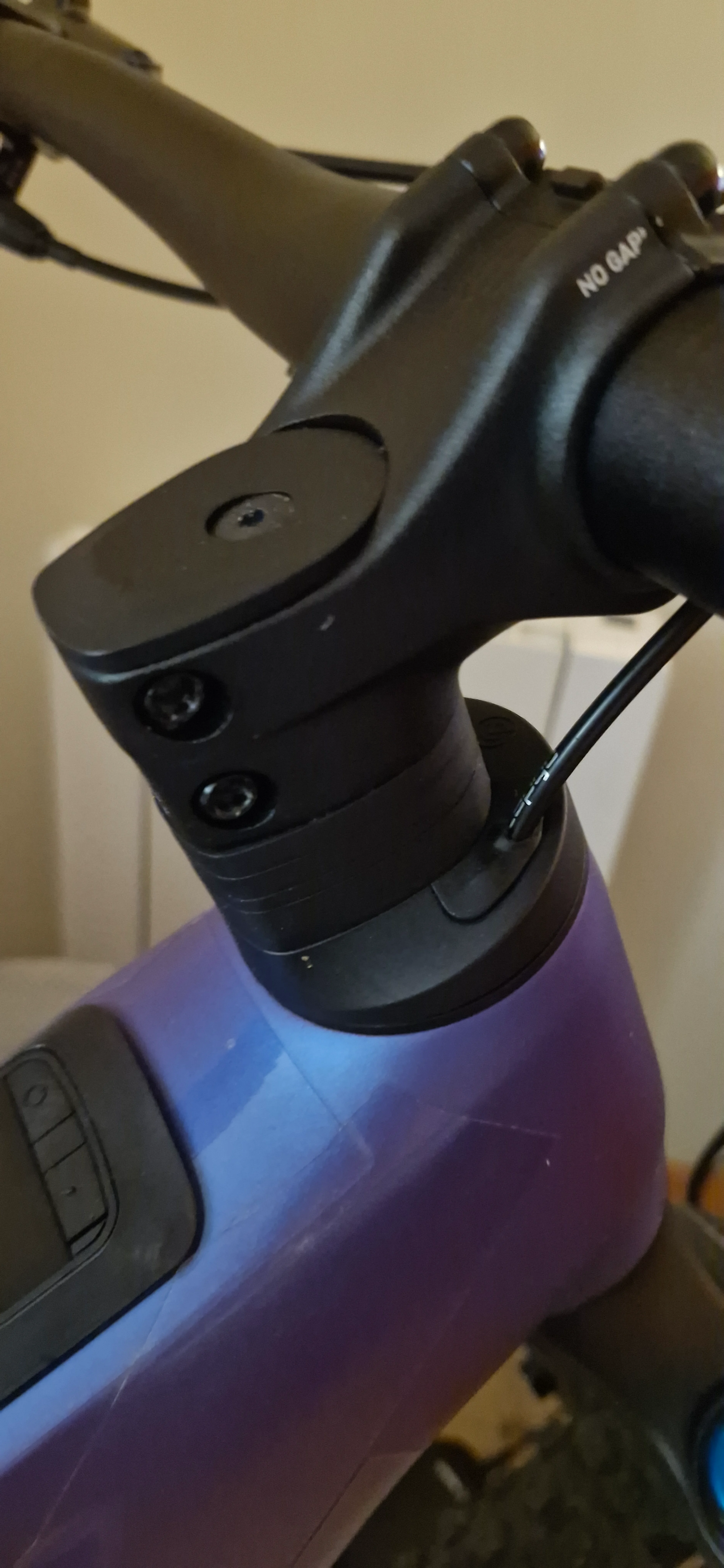

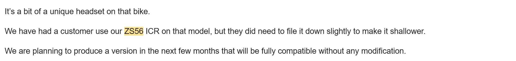

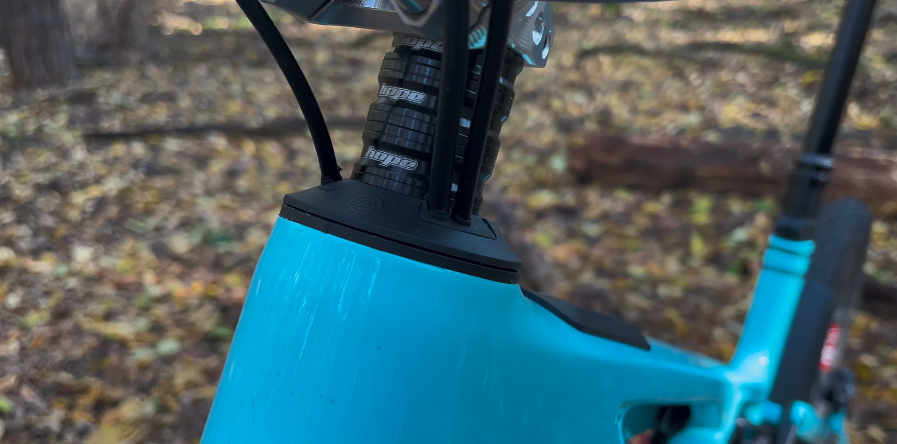

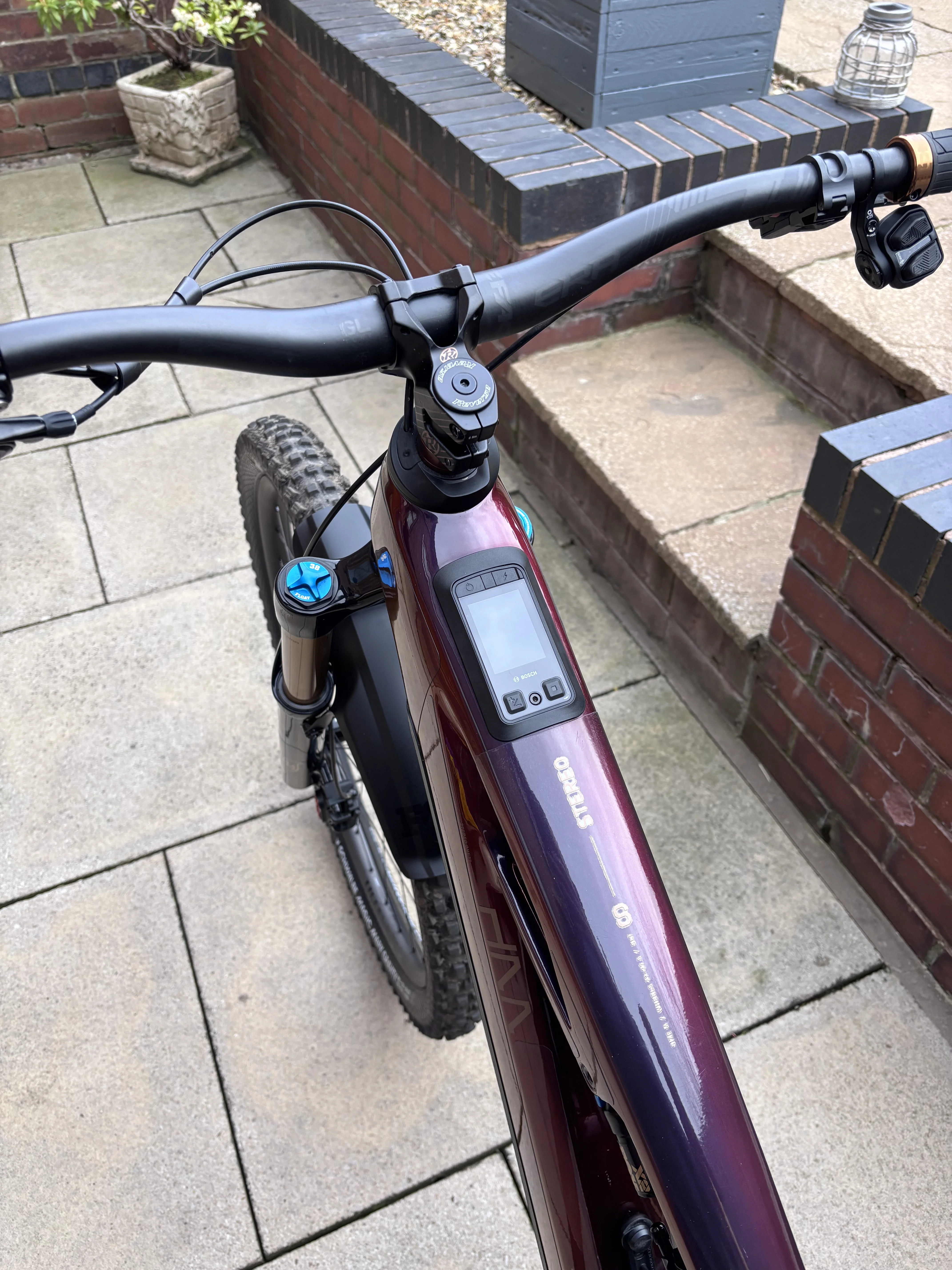

hello,
i bought a 2026 177 slx 800 and want to change that ugly stem and spacers
Can you please guide me on what parts do i need to get ?
hello,
You can use regular stem, and spacers. It's a classic 1 1/8" steerertube.

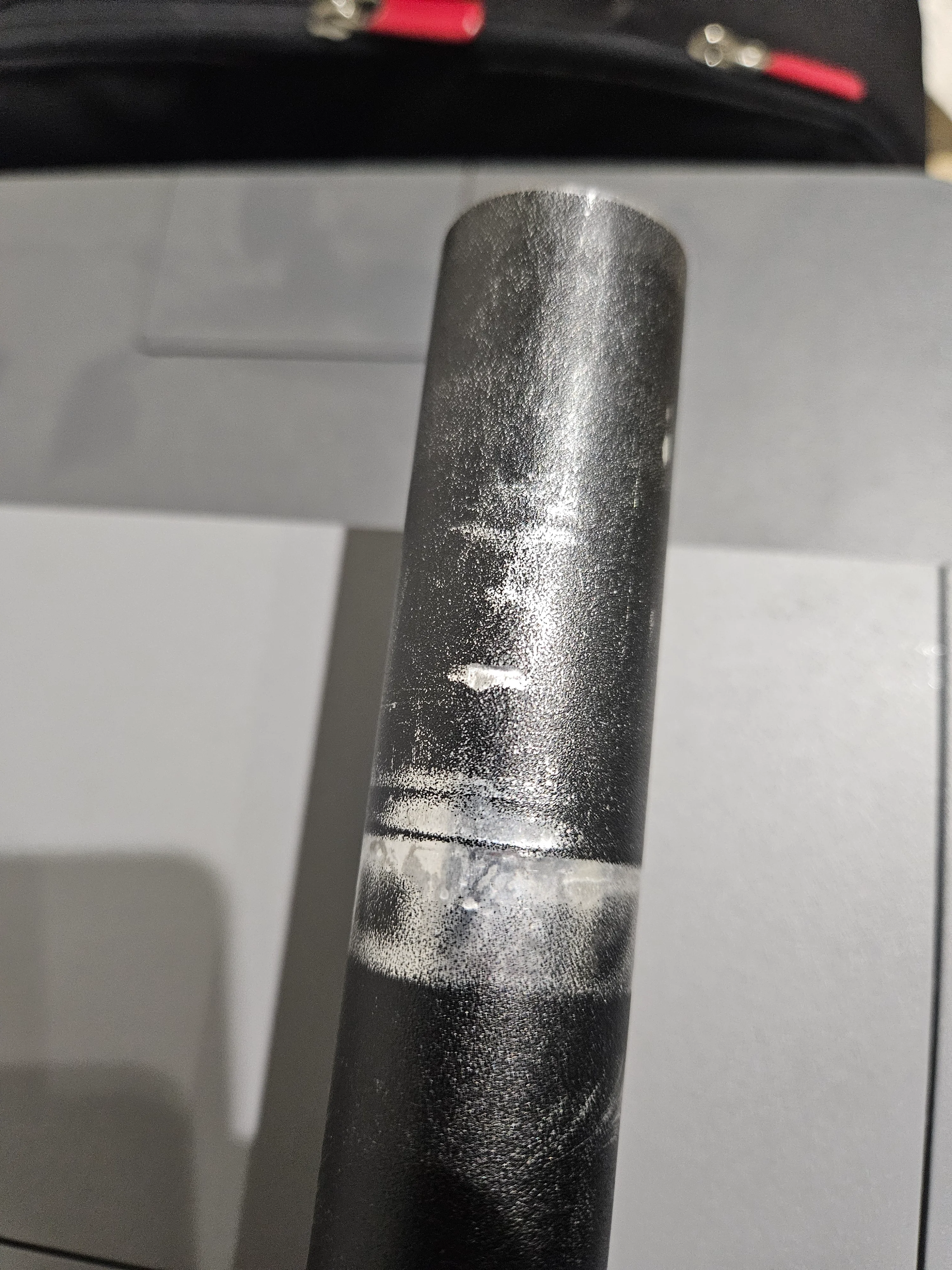

I noticed my Zeb steerer tube has some wear on the black coating at the level of the top of the headset.
@Rando_12345 do you still have the 'wear' issue on the steerer? I dropped my Fox 38 off at Fox today and they said mine had excessive wear in the same place on my steerer to the extent that one side had a small groove in it. They say it is typically caused by ill fitting or incorrectly designed headsets.
Check your fork steerer tubes guys! Fox today confirmed mine is fecked due to dodgy headset - most likely the crappy upper bearing compression ring not doing its job properly and causing wear. New fork time for me :( .
Ouch, havn't taken mine out in a while, but the headset does crack under heavy braking despite tighter than usual headset screw (presumably required to hold all the part together).
That sucks. Can’t they just fit a new steerer?

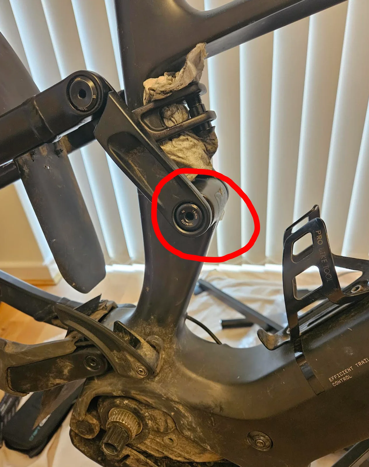

Another area to just check - At 1700 miles this main pivot bearing had failed on my one77. I had all the other frame /horst link bearings replaced too. I can tell you now it was an absolute ball-ache to change them!
Thanks for the heads up. That’s probably the tipping point for me to just pay my LBS to replace them when the time comes rather than doing it myself 😁
I ordered the new bearing kit in advance and when it arrived, I saw how some of the bearings were designed and then decided to get my local bike guru to do them as you need specialist pullers etc. I watched him do it and the amount of cursing going on.
it took him 2 hours to change all 14 bearings. I'm glad he did it and not me!
Is a blind puller needed to extract some of these bearings?
