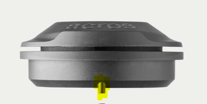

I have a worse problem - it appears the lug on the top plastic angle cup that locks into the notch isn't there on mine which means the cup is not staying in place at the right angle setting (steep for me) when turning the handlebar!
is this worthy of a warranty claim?
Mine is also missing, but I consulted the service guy when I was hunting down the mystery creaking from the front. Apparently, the notch isn’t necessary. But I ordered anyway some spare parts from Acros. New bearing cup with the notch plus aluminium part for cable management or what ever the piece is called. This way the headset can be tightened properly, at least according to the manufacturer
I will do the change in near future, because the headset has started making some noice. Probably greasing will solve this…
without the notch I can't see how the angle cup locks into it? Mine is not locking in place due to the missing lug on the angle cup and this means the angles are not right as the angle cup turns gradually
I paid 15€ for the upper cup… maybe the ones you’re looking are made of gold?

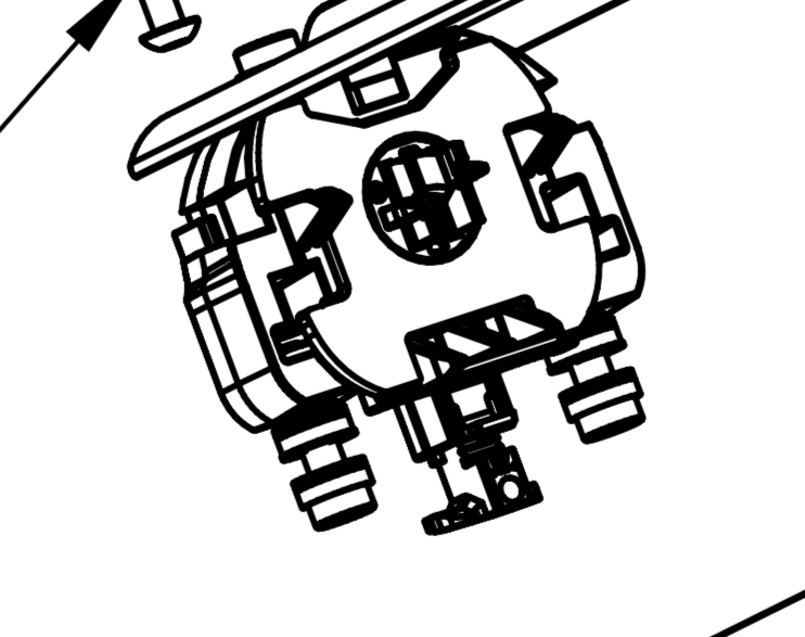

Does anyone have the part number of the small white plastic that holds the lower part of the battery cover in place?
It disappeared, I've been using duct tape for now

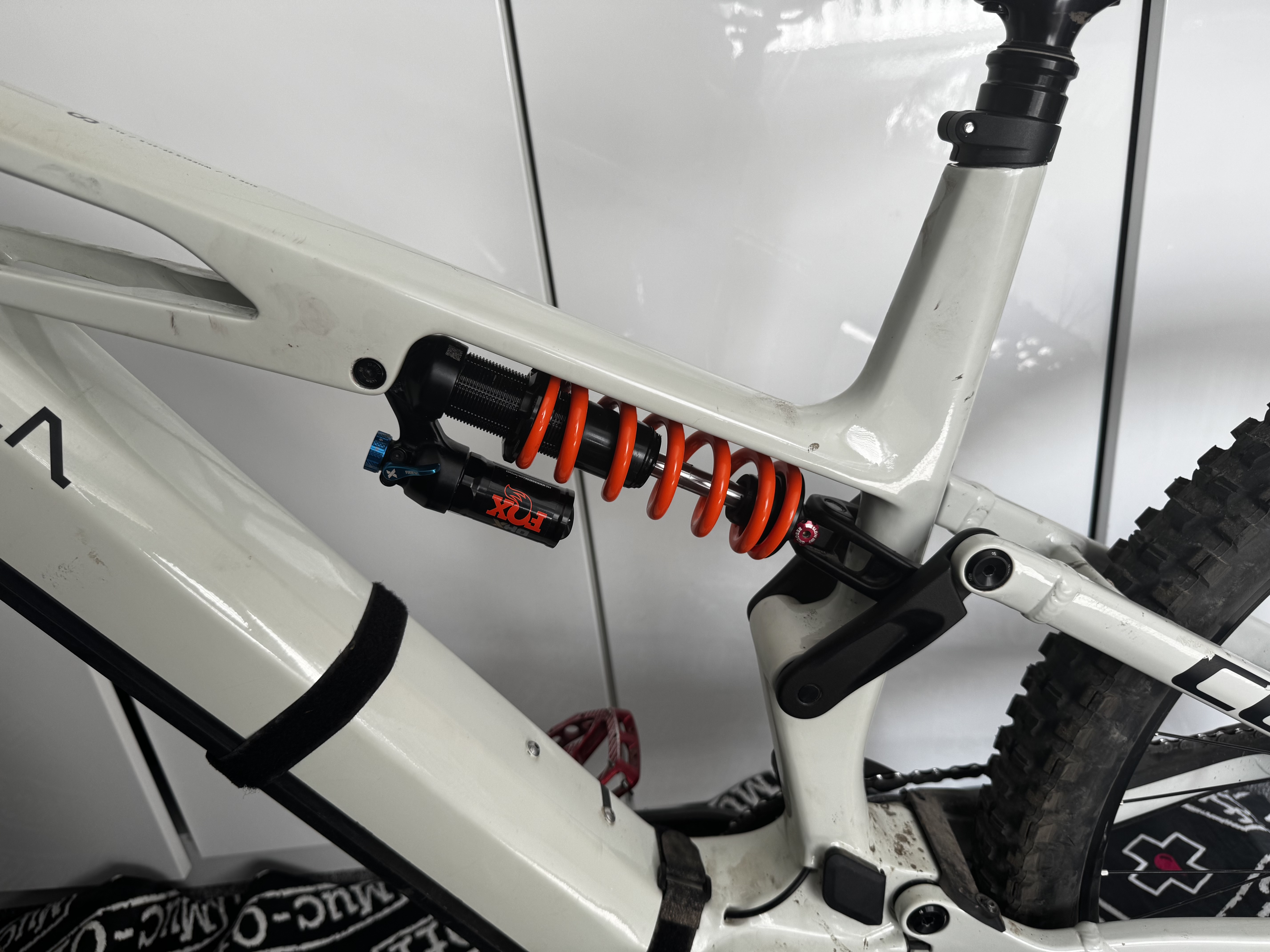

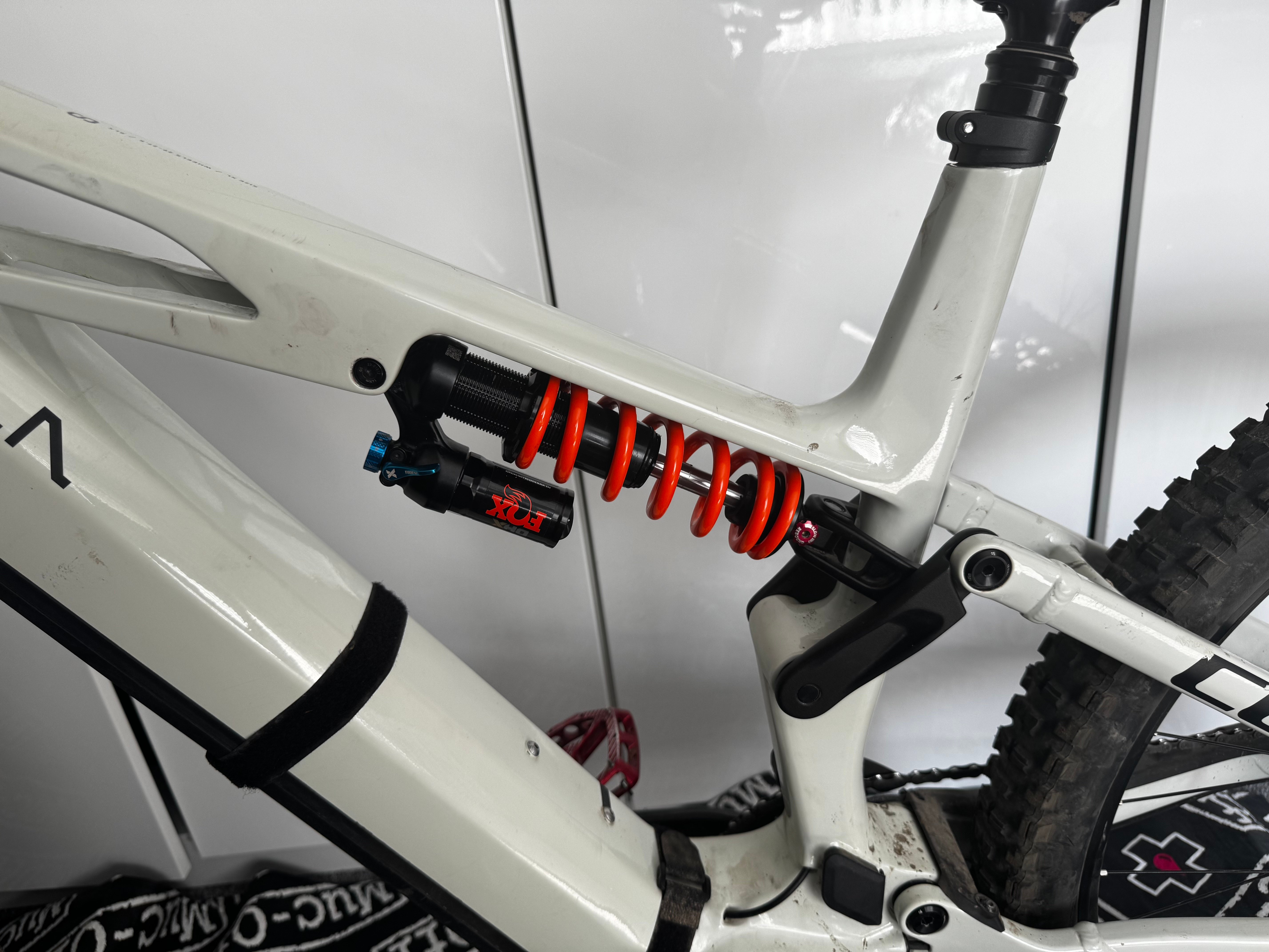

Any good? Much difference?
This is my first ever coil but so far it’s great. Only had a short ride in to the local woods. Over roots and a little drops it’s great, feels a lot more planted then the float x. The float felt hollow to me where this feels solid. Big test will be wharnie on Sunday.
I got one from here when I smashed mine (now replaced with the AVS guard). Not in stock at the minute, but the part number is in the description.
I don’t think you can buy it separately. I think you have to buy this
