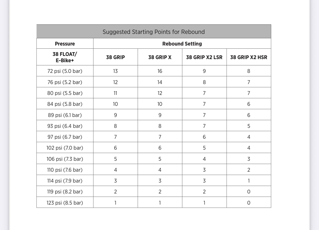

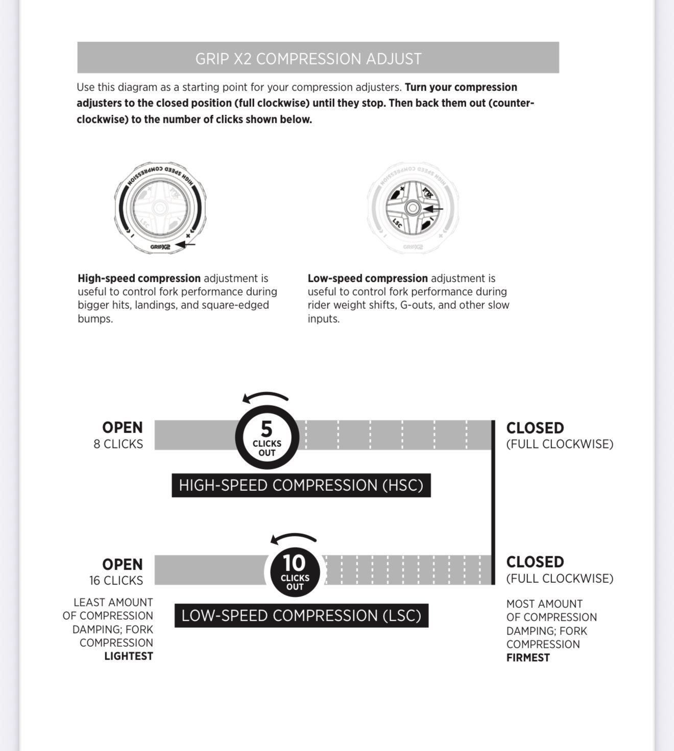

Everything is best done to match your base pressure that hits the % sag you want; rather than relying on Fox’s guesstimate for your weight, that never takes into account the bike geo. I’d try the stock settings for that pressure in this Fox 38 guide (pages 12-14) as a start point. For the forks I’ve usually found Shockwiz has only ever suggested 1 click different from these for the middle of the road ‘neutral/poppy’ feel (the rear shock is a very different story though).
For your base pressure that looks like clicks out (anti-clockwise) from fully in (clockwise) would be: 10 LSC, 5 HSC, 7 LSR, 6 HSR.
Edit - I’ve assumed you’ve got the 2025 Float X2 Factory forks. If they’re the Grip X or Grip 2 versions, then the 2022 guide is attached too

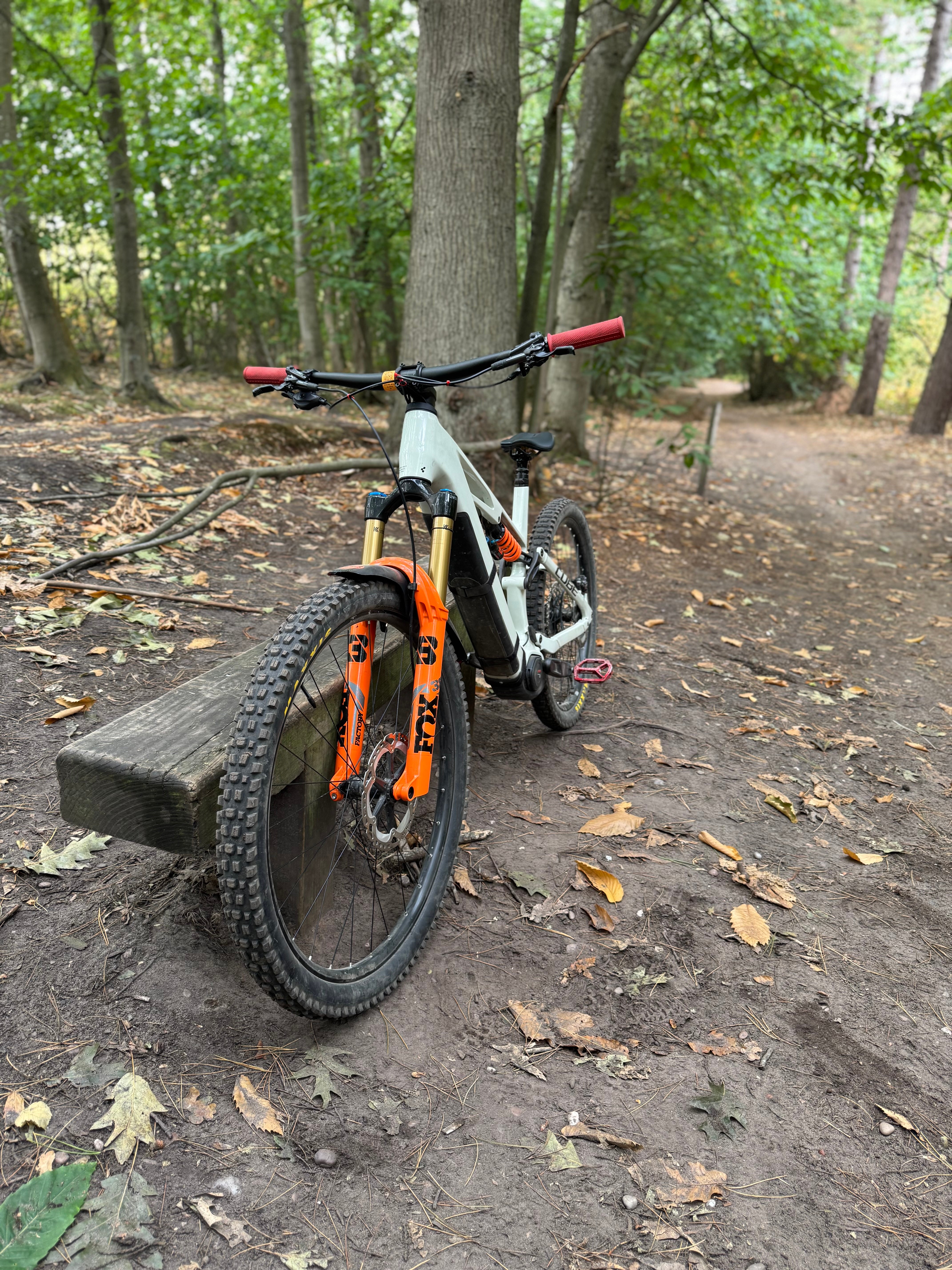

It’s the grip 2 2023 forks. From my little ride you can see how it’s too fast in the vid
Thank you so much, ill give those a go tomorrow and see how they feel.

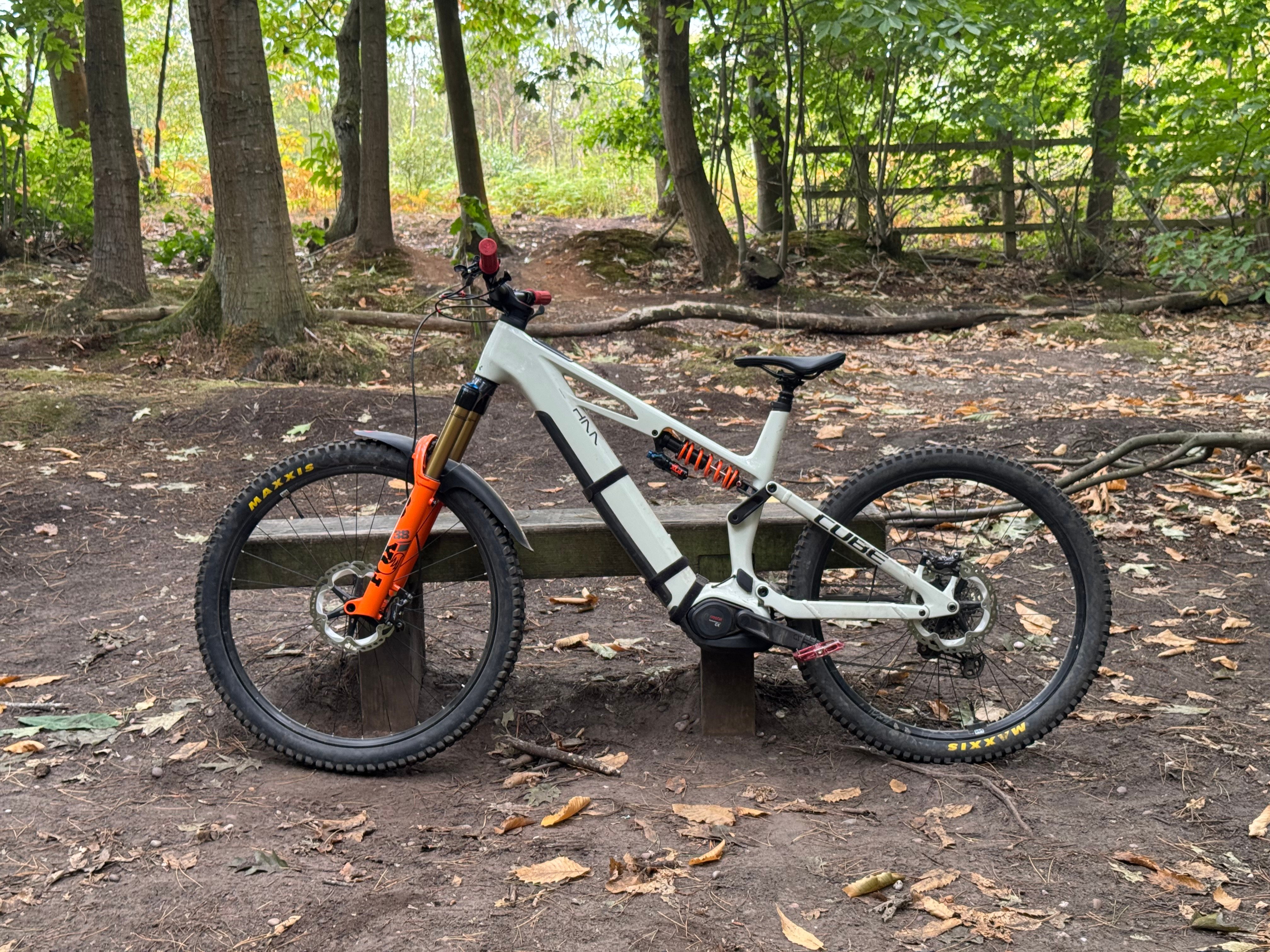

Back from the LBS - Shock Blown with ~20hrs on it... LBS are going to rebuild it tomorrow for free, if it happens again it goes back to Fox (and I switch to a coil :LOL:)

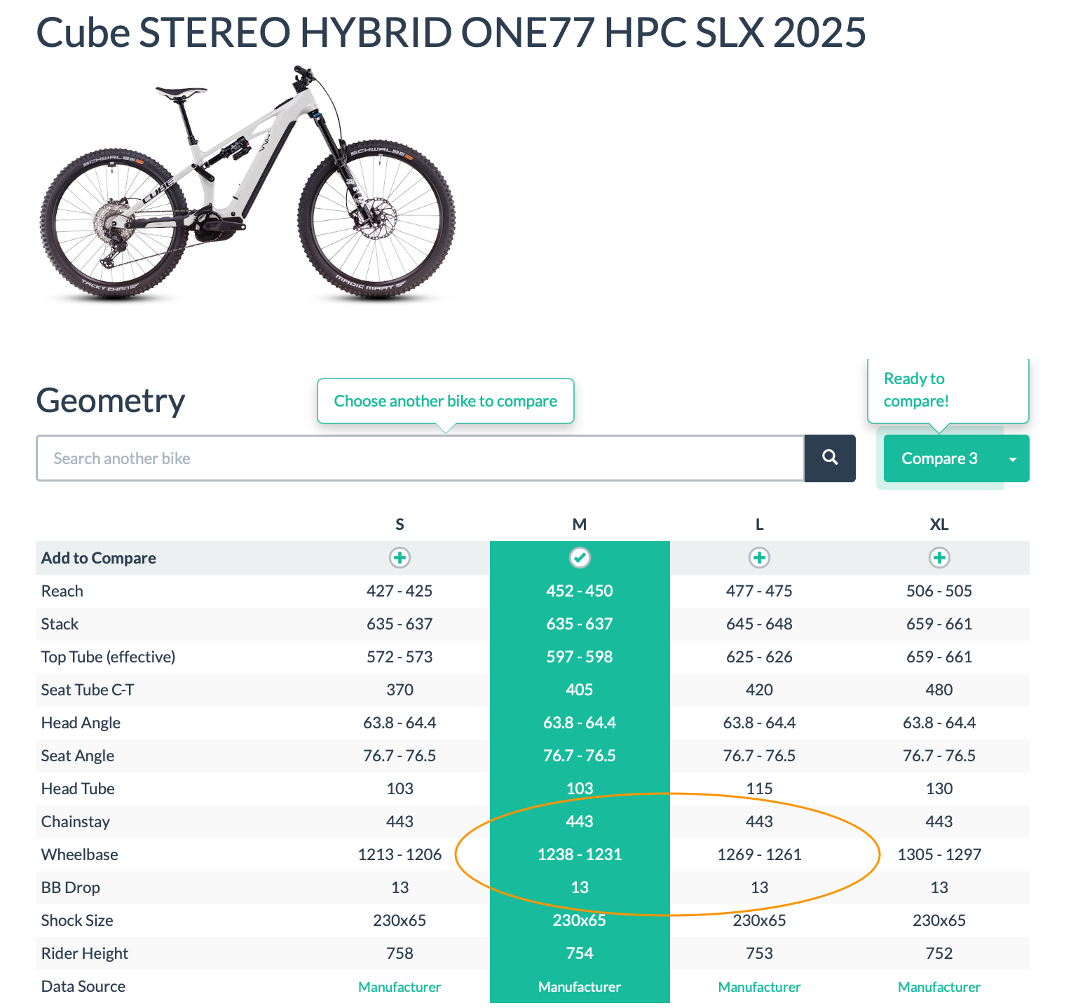

my Stereo 160 in size L had pedal strikes
I ordered the M and will add 150 mm cranks >>> Why?:
look at the table attached .. The M wheelbase is 30 mm shorter and the same components >> this should result in a bit more lee way.
I ordered 145 pinned cranks to try. If I don't get along with them I will try something else.
For the cranks, make sure you give them a few rides in case you don't love them at first, I'm pretty sure they will feel fine eventually!

This is a '25 version of the shock with 20hrs on it... Guessing it had sat in the warehouse for too long and then along comes a 250lb guy having far too much fun on his new bike and starts plowing it into everything... lol...
Got the bike back today and it feel like riding on a cloud compared to yesterday. Spent a couple of hours setting up everything from scratch and I am able to drop some pressure from the shock now that the LSR is working again.... That let me do the same up front and she's riding like a dream now. Cant wait to get her out on the trails again tomorrow.

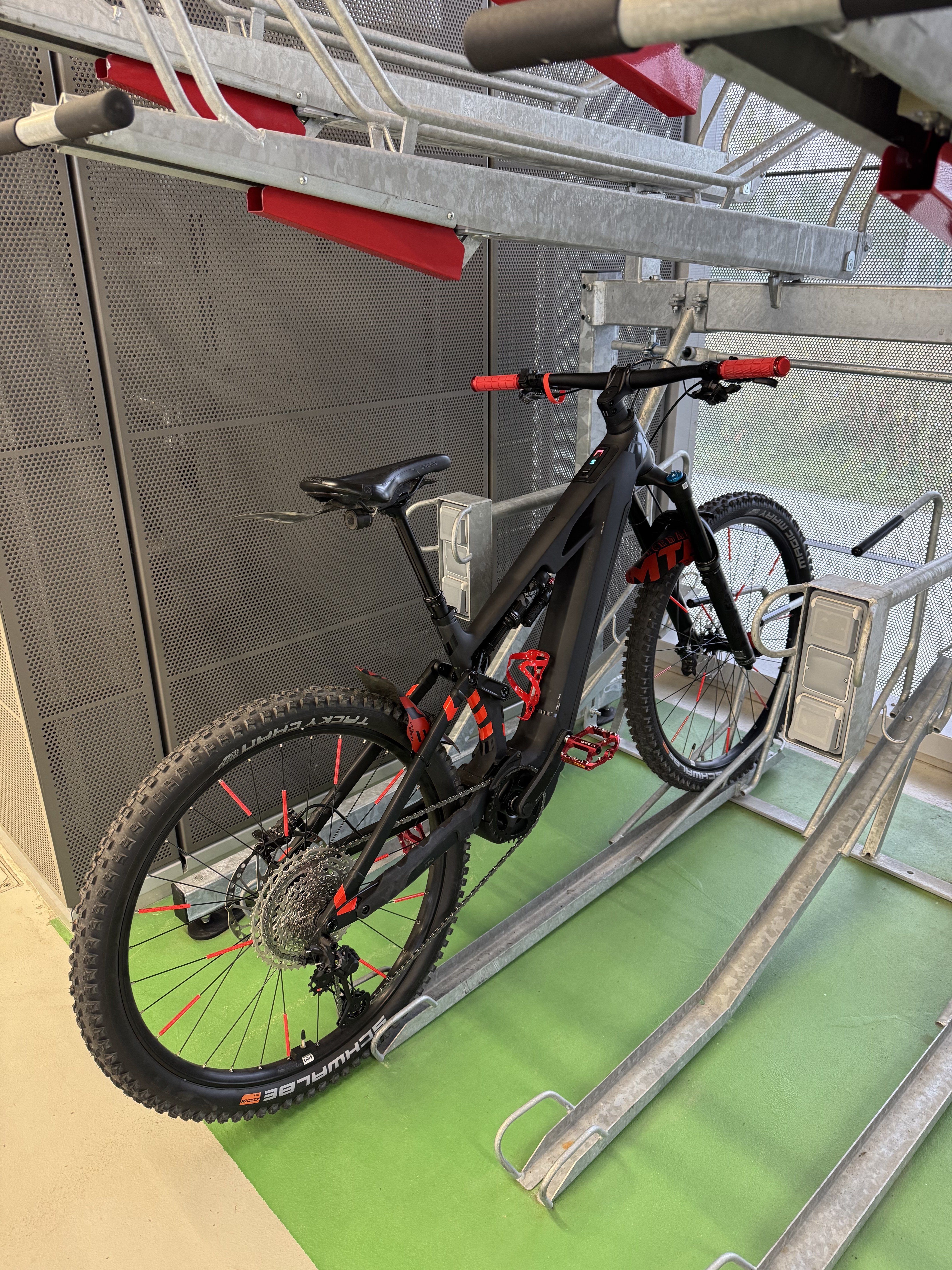

installed Miranda MIS17 Unisex Adult E Bike 150mm and ride with 20 % Sag on the one 77 . Tested the setup only urban this morning on the way to work. >> feels good and no strikes >>>yet

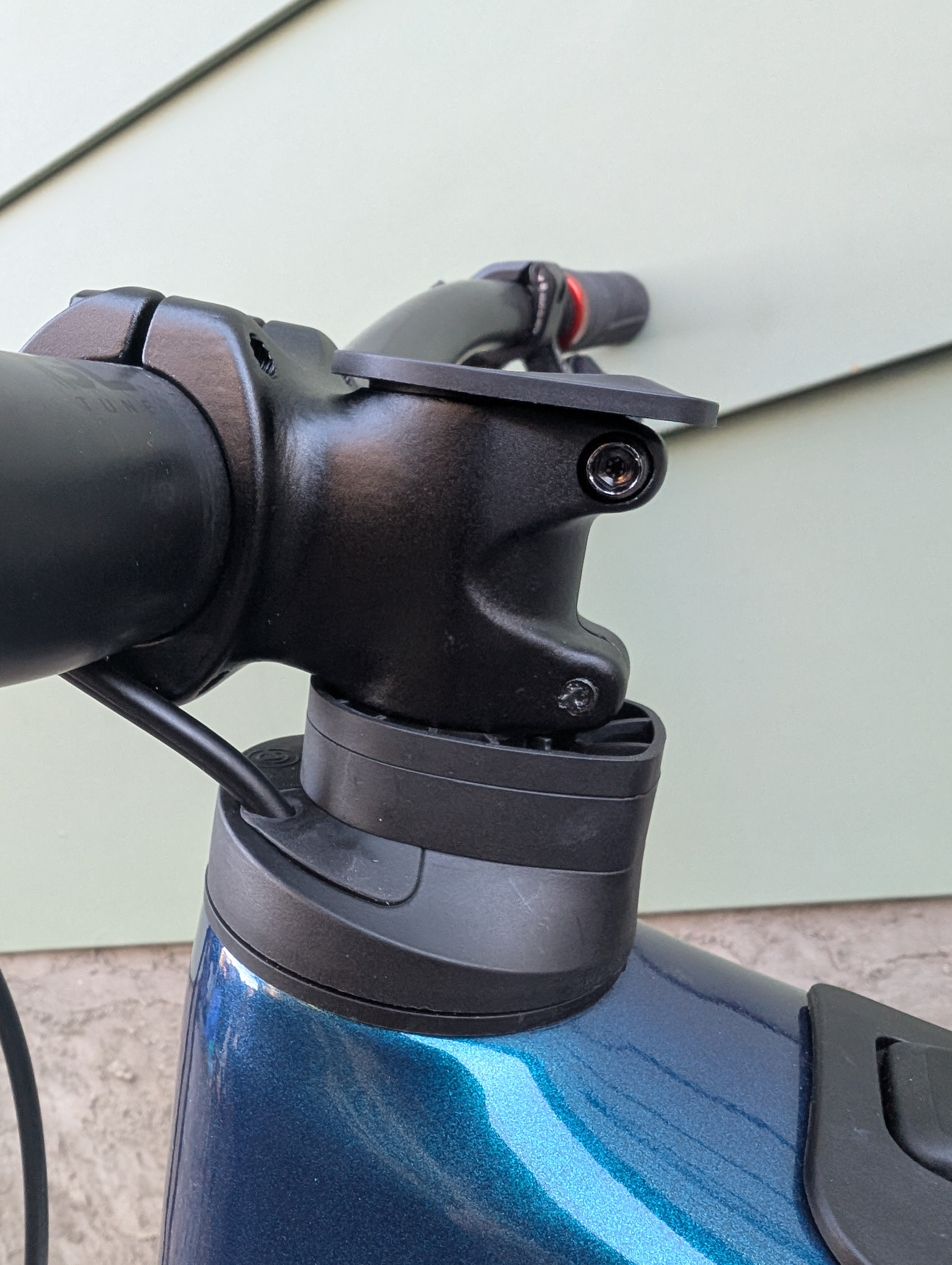

Also has anyone replaced the stem and spacers and or headset?
Cheers
Yes, over to an ethirteen stem, Hope spacers and Bergtec top cap and it all works just fine. Can't comment on the headset, as I've no intention of messing around with that until it needs it.
