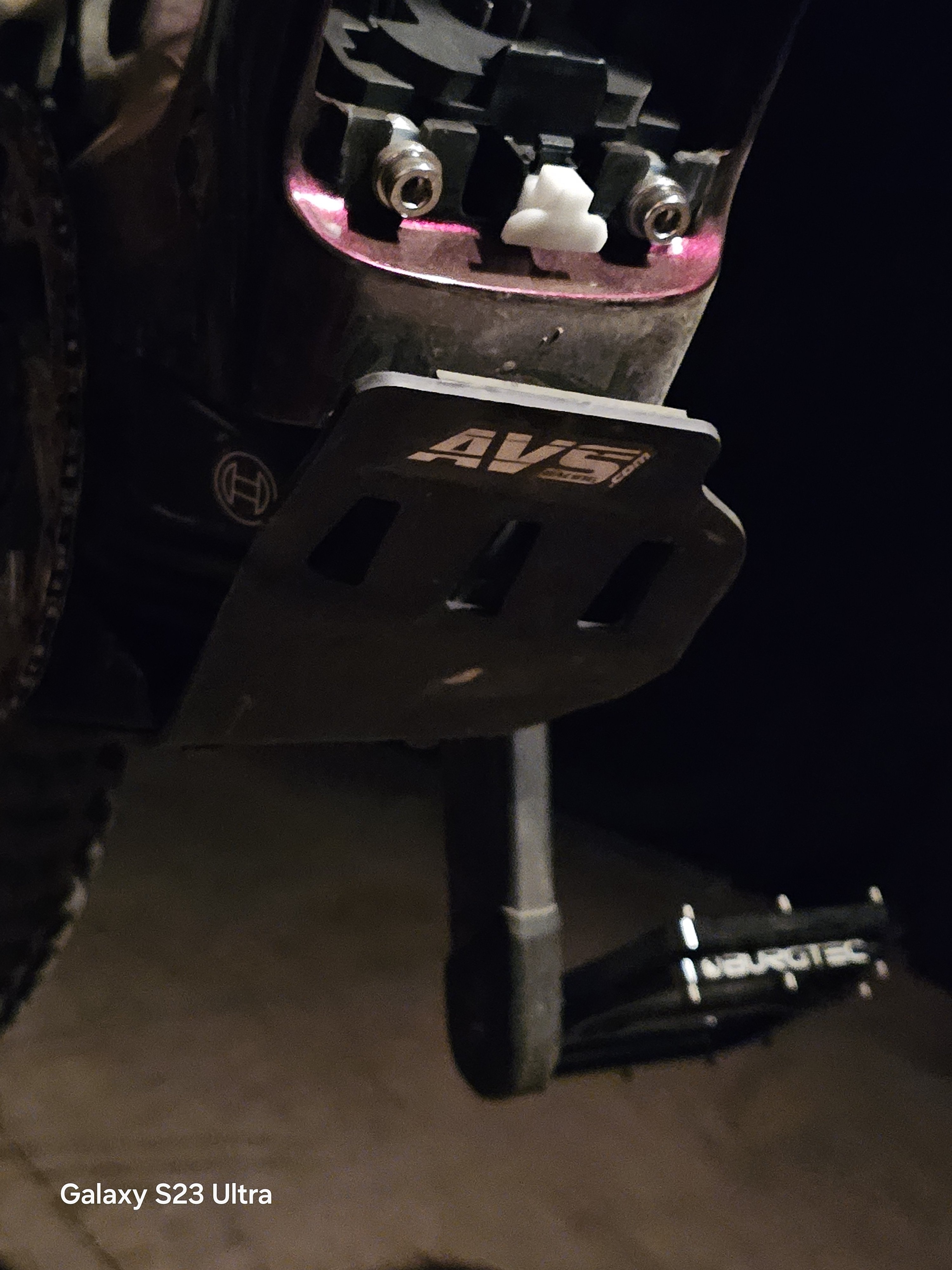

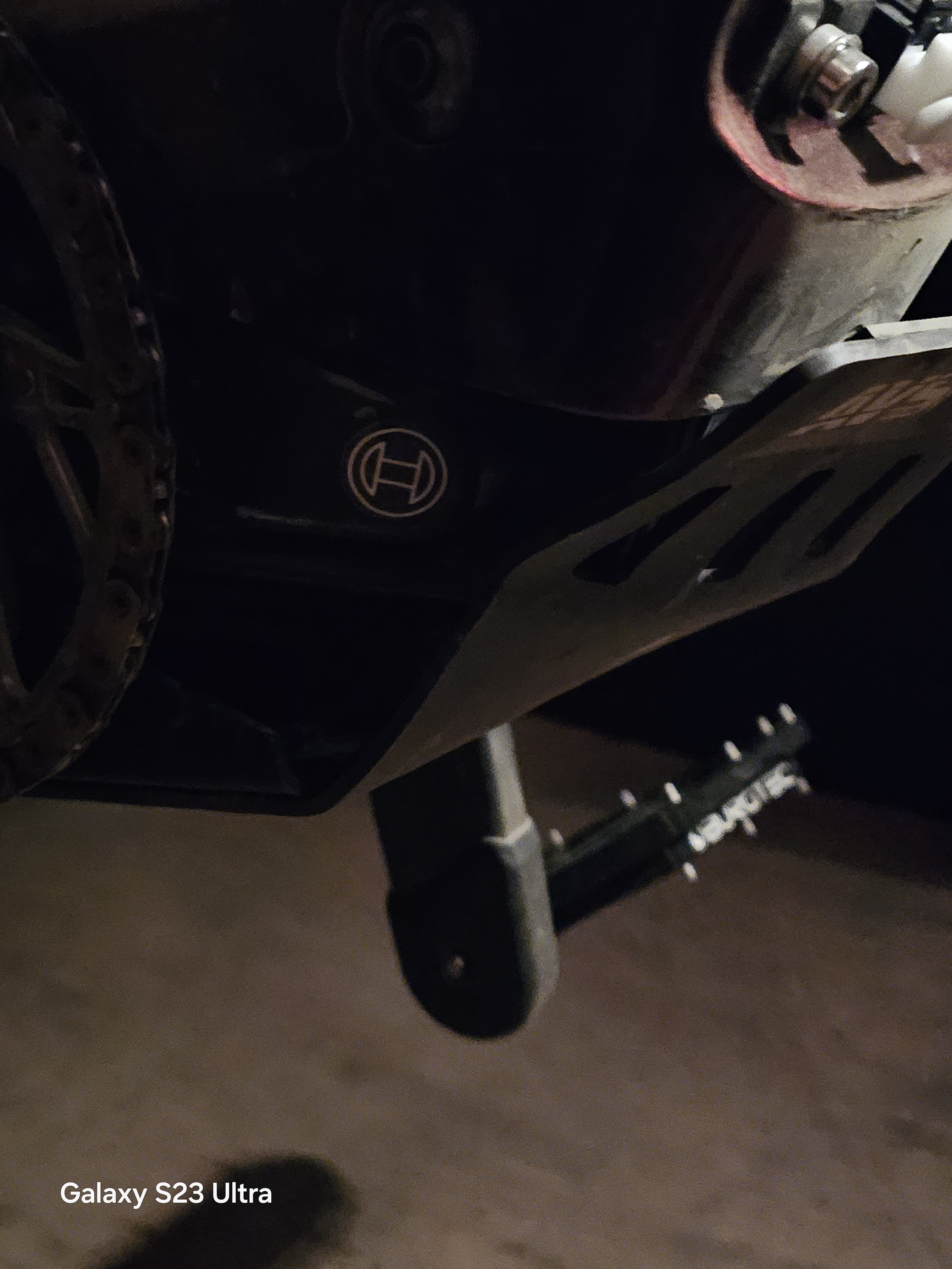

First run with the new AVS guard on and its is deformed 😅
I did the same to mine, it not the first run! 😁
That’s why I added a further, moulded, kydex guard to my bike. Which you can see in my earlier posts. Great, cheap, added protection.

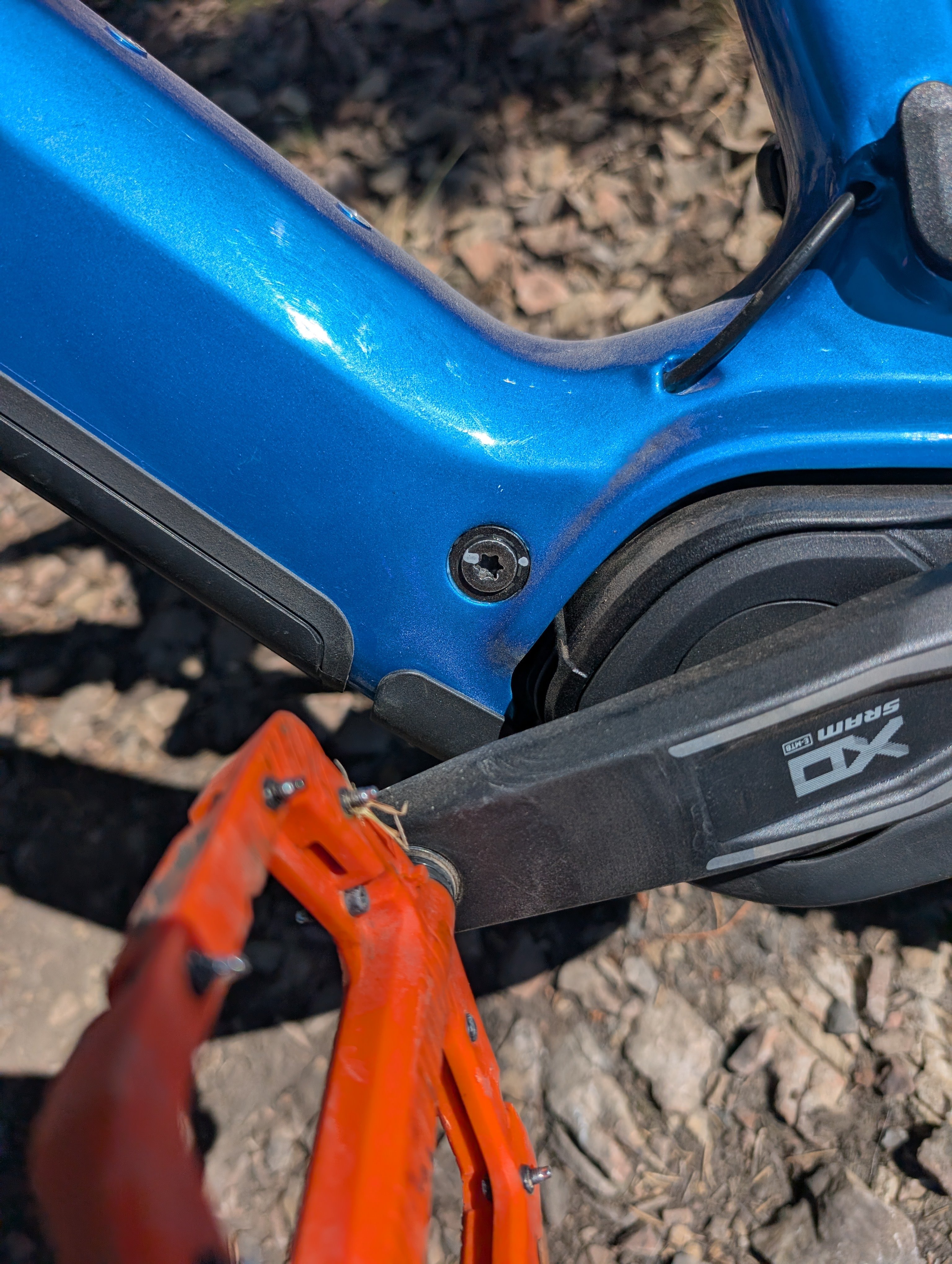

Spent a bit of time yesterday tightening everything as per the advice on here... Then followed up with a paint marker.
Went out today for a ride:
Was having fun until I started hearing a creak that got worse as the ride went along. Looked over my little white dots and immediately saw this:
When I got back home I added Loctite and torqued it down again.... Hopefully that's it for now.
Thanks for all the experience you guys have shared on here so far! (y):D
