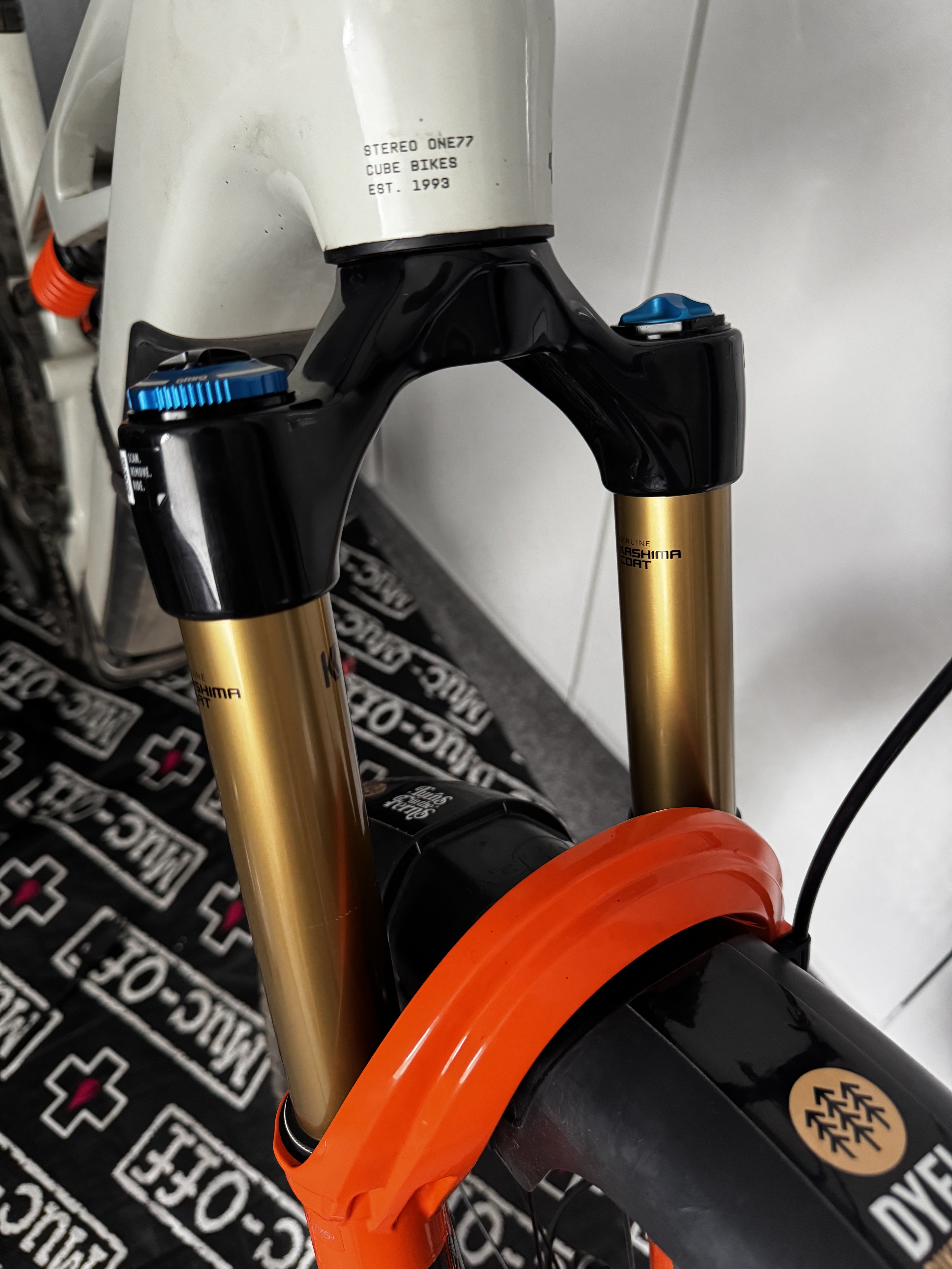

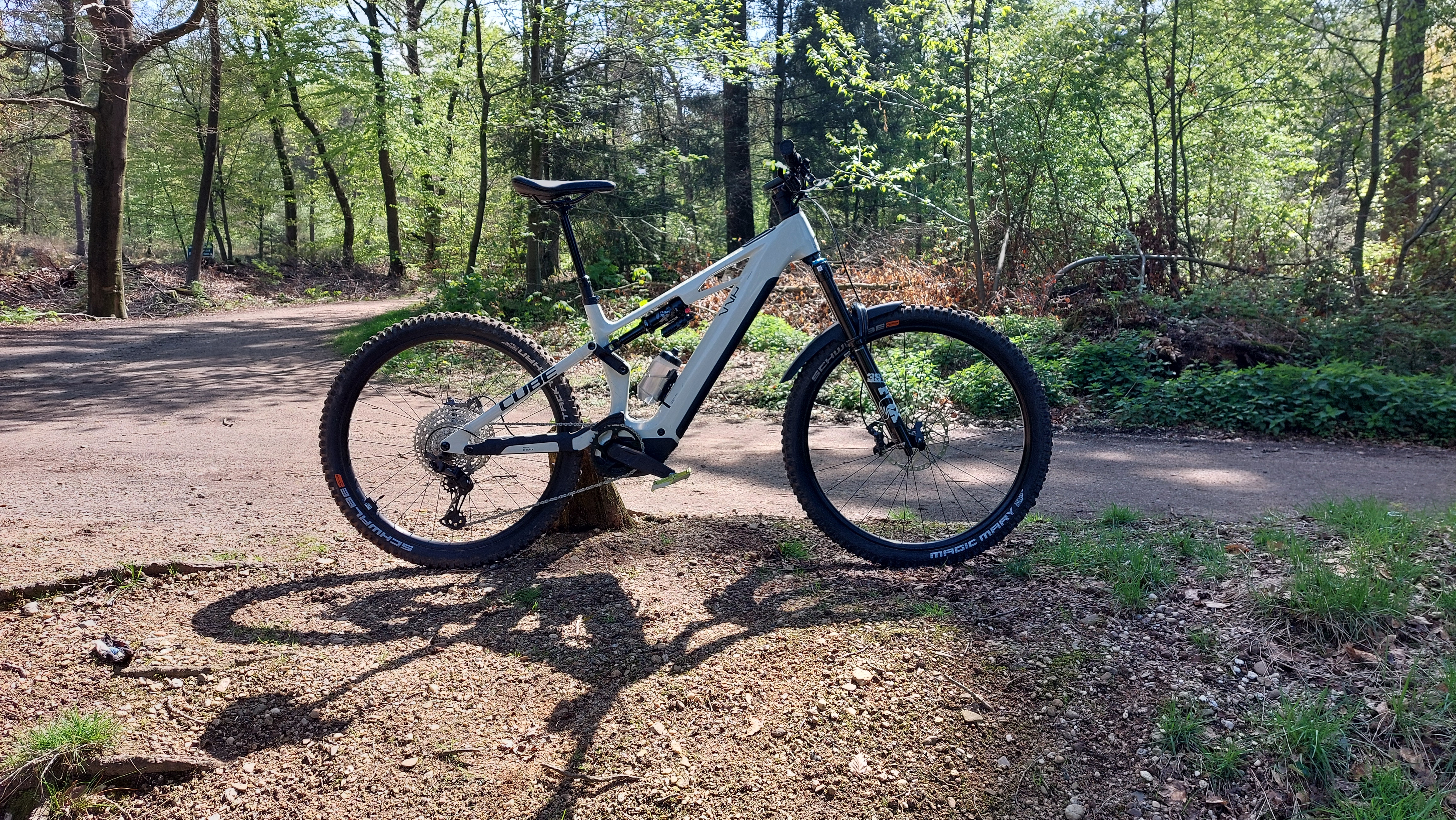

I’m 93Kg (in birthday suit) and after using a friend’s Shockwiz for several weeks with my XL AT variant (FF 38/Float X2). I landed on the following:
All numbers are clicks out anti-clockwise from max damping/compression (all the way in clockwise).
Forks (just over 20% sag)
89 psi
3 Volume spacers (stock as the bike comes)
LSR 6
HSR 4
HSC 10
LSC 10
Shock (30% sag):
215 psi
4 Volume spacers (4 max -bike comes with only one volume spacer)
LSR 6
HSR 3
LSC 4
HSC 4

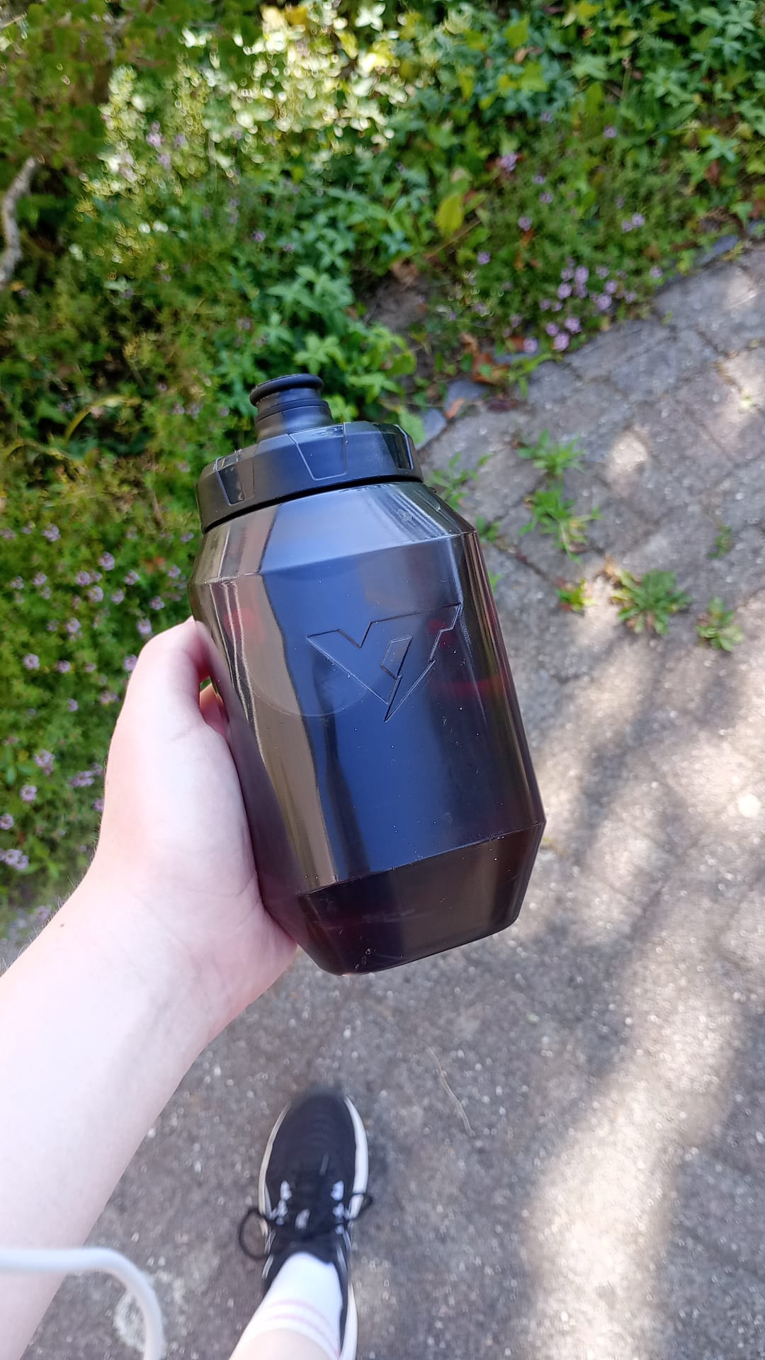

I can get a 500mm standard bottle in there. Did yours come with a 175mm transfer?
I bought a YT Thirstmaster 4000 with 600ml and Fidlock. Fits good on my former Fidlock system.
Note that the YT bottle comes without any fidlock hardware, so I recommend buying the 450ml standard bottle as well to get the base and bottle mount, and also swap out the lids as the standard one is nice than the YT one.

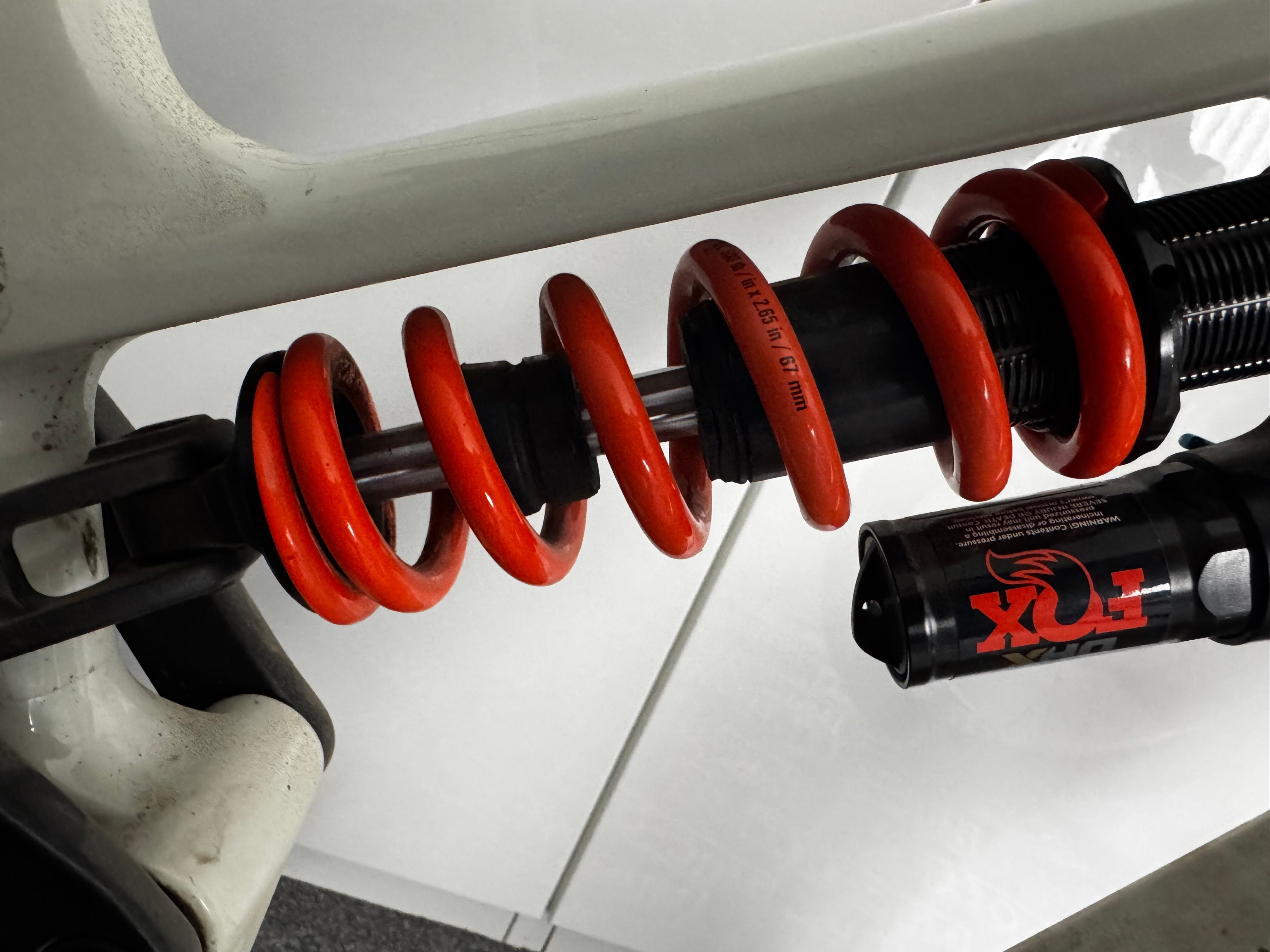

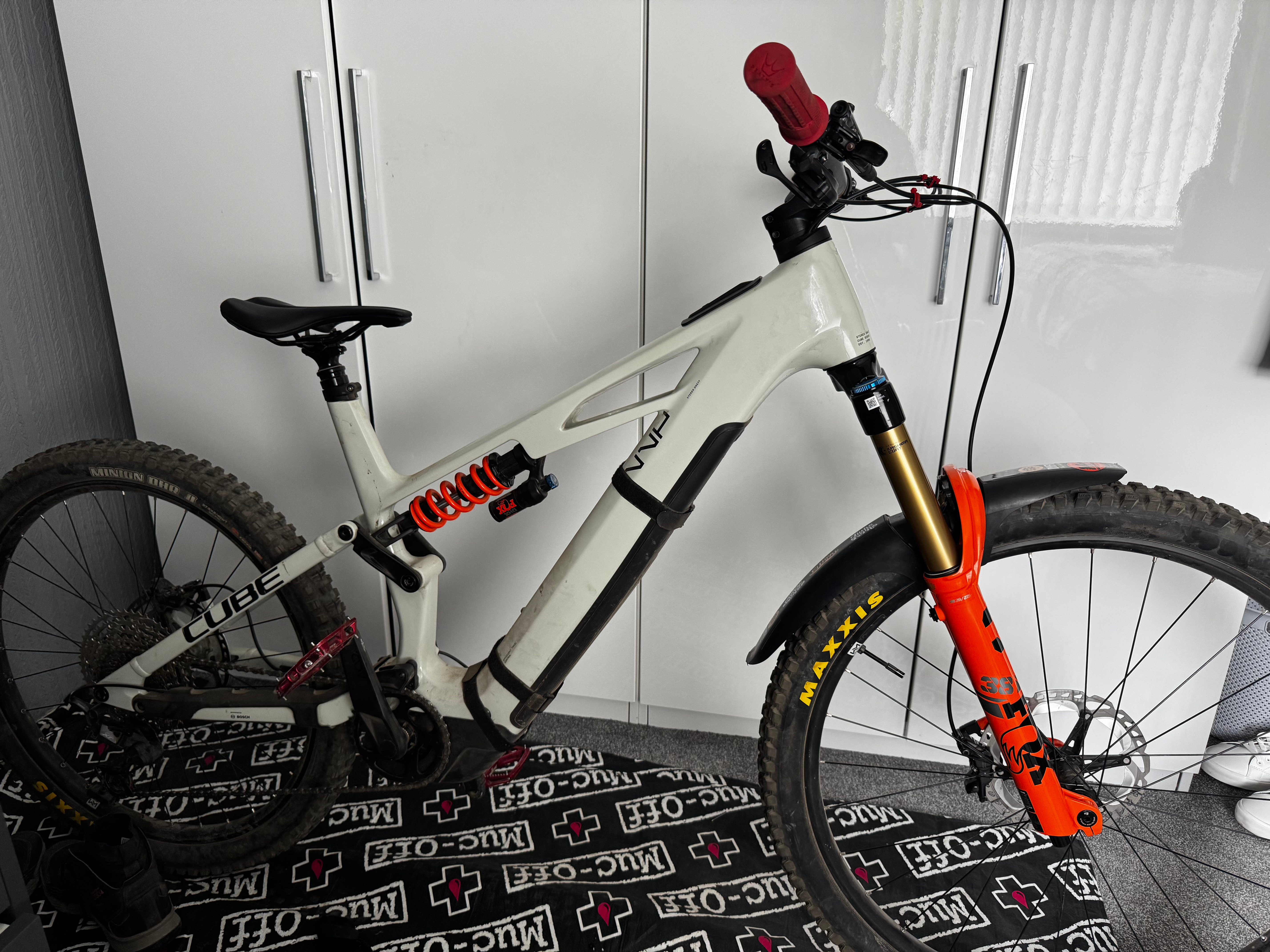

The coil. Small bump on the fork is night and day better then the base 38’s. The bike feels so much more planted.

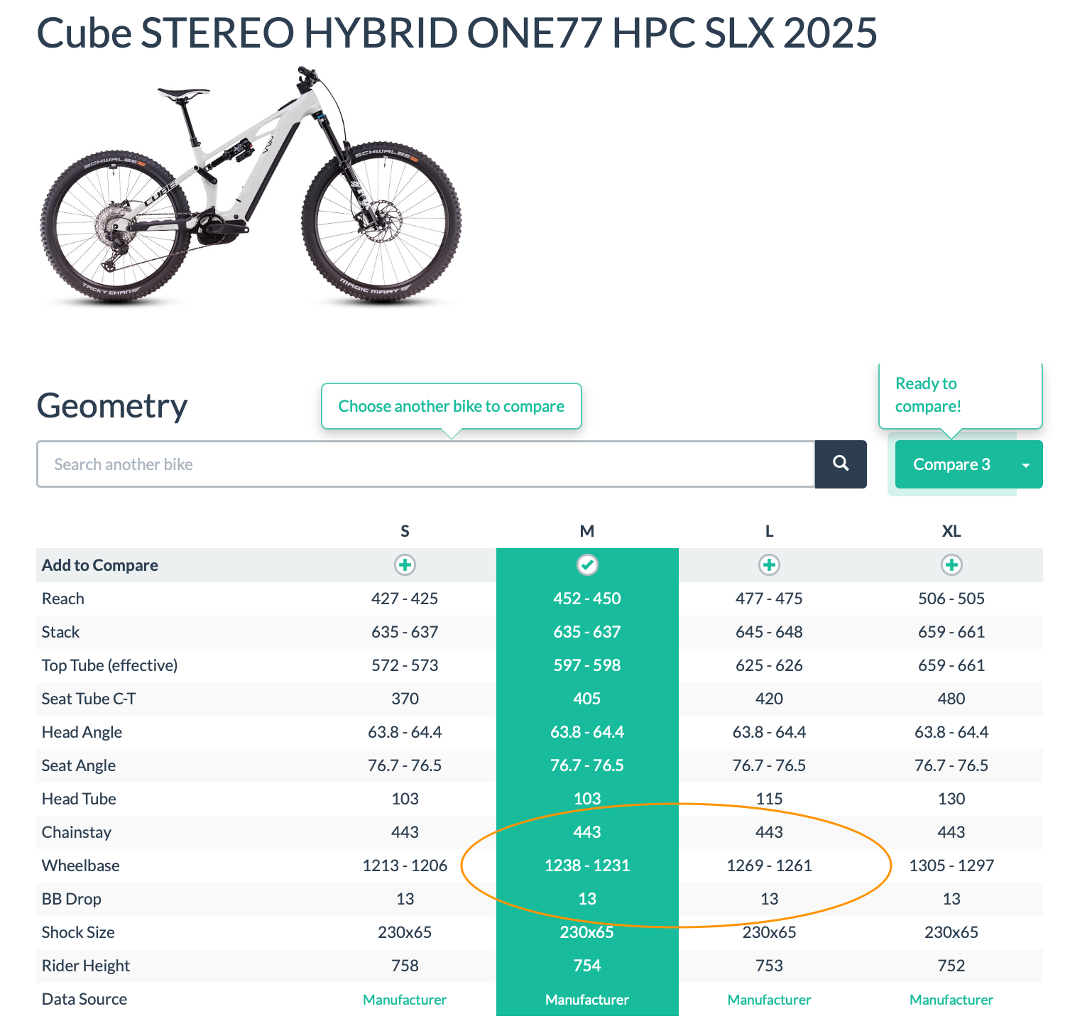

my Stereo 160 in size L had pedal strikes
I ordered the M and will add 150 mm cranks >>> Why?:
look at the table attached .. The M wheelbase is 30 mm shorter and the same components >> this should result in a bit more lee way.
