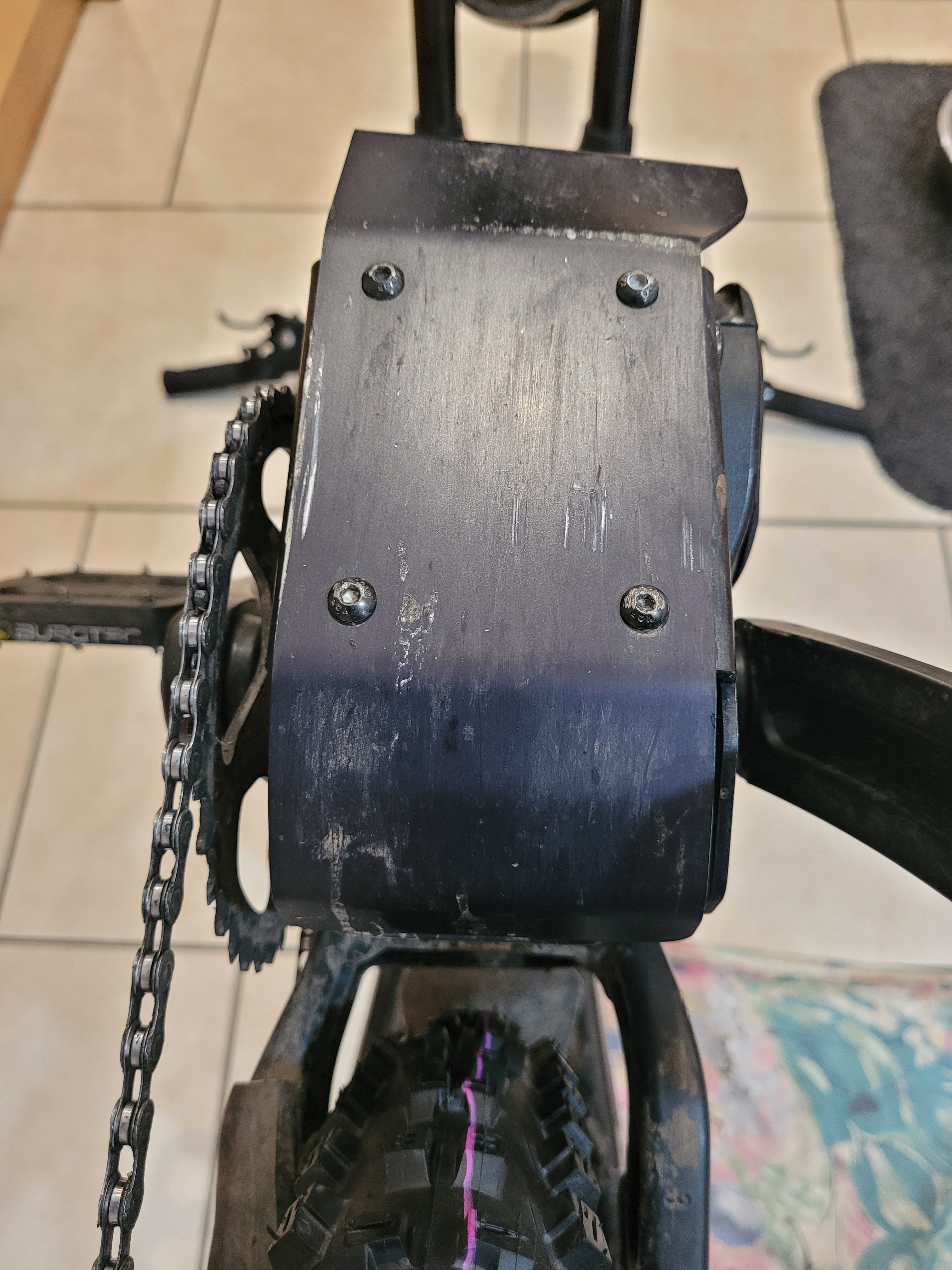

I'm going to buy an aluminium skid plate, surely this one some people here recommended :Cube Stéréo Hybrid 2025 ONE44 and ONE77 E-Bike engine guard
Is it working fine for those who bought it ? I'm a bit scared to damage the motor but I also think it will better protect everything that the plastic default one which protects basically nothing, right ? :)
I just can't stand the default plastic one, 2 rides in a row where it falls without me noticing, not until I stop and have to reverse on the trails to find it lying on the ground.... (by the way at least the new Bosch update makes it a lot easier to climb back trails, it feels really better to climb now in Turbo with max numbers for power and torque)
Recently got one and fitted it. It's great and I haven't been worried about it at all.
It's solid, covers the motor and offers much more protection than the plastic one.
I think it may be a bit smaller/streamlined than the plastic cover too because I'm clearing a few things easier without it getting knocked. The bottom is flat and not curving down as much.
I would 100% recommend getting it.

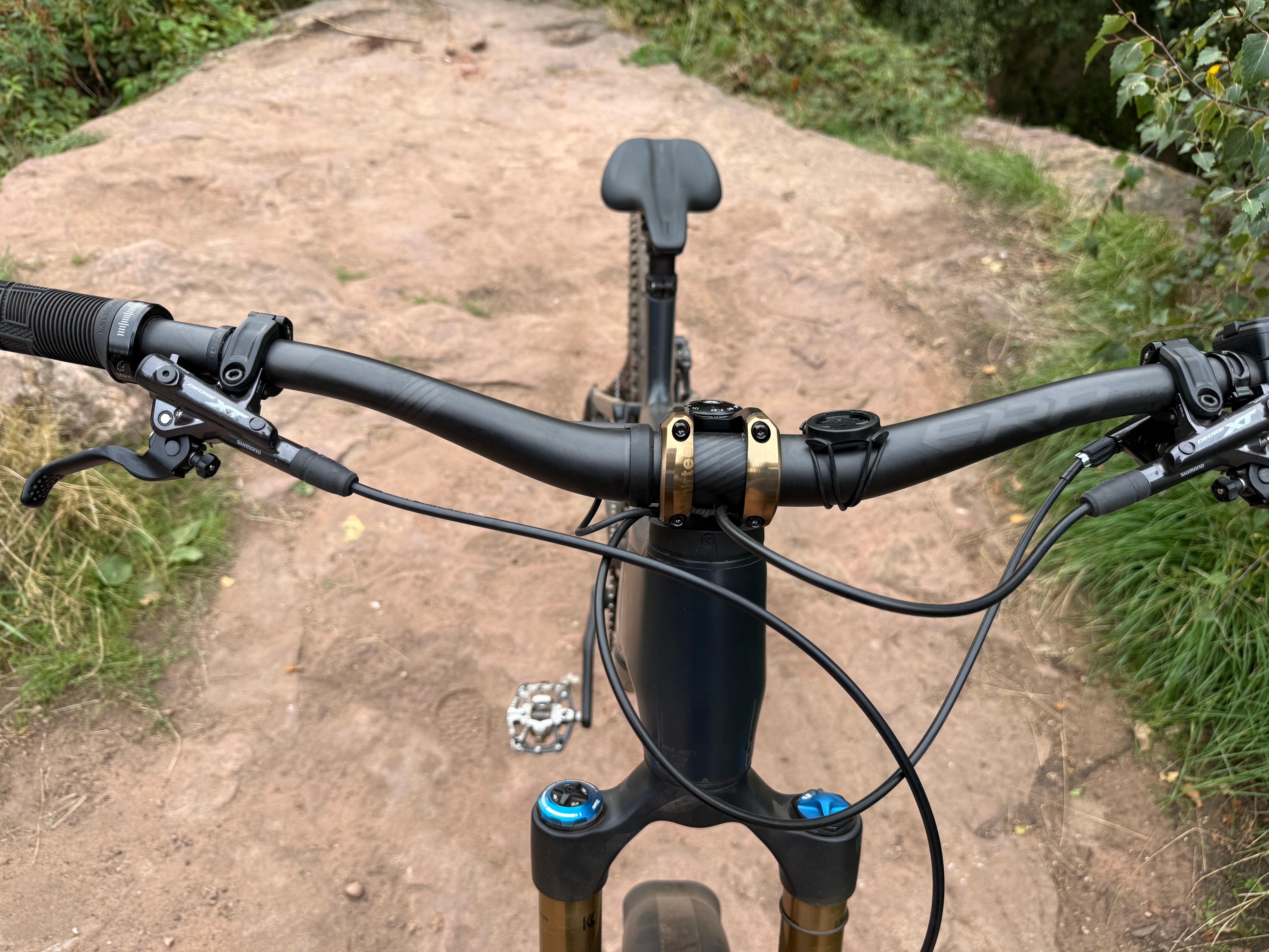

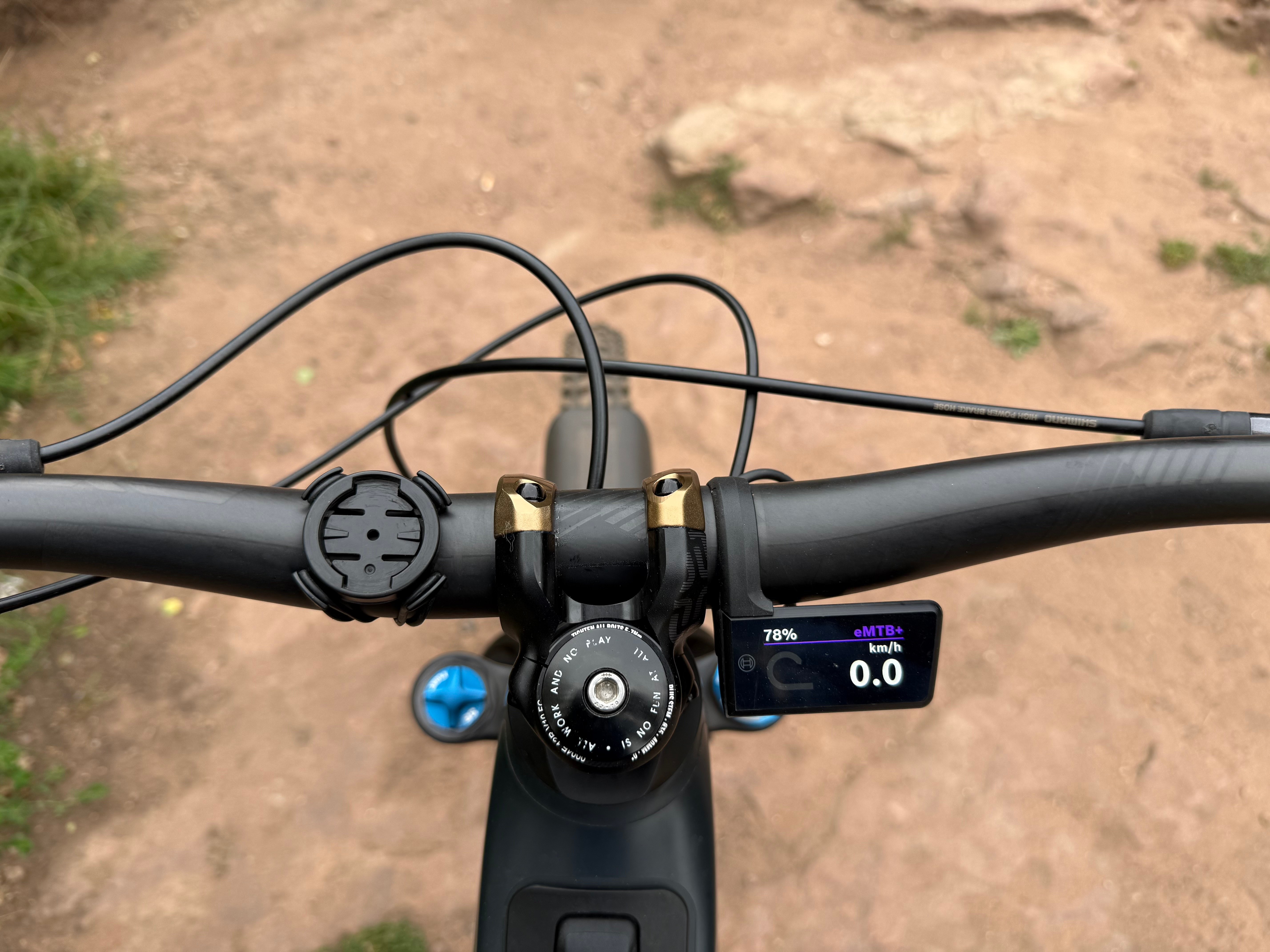

Some more experience to share, that may be of interest to those that were between sizes and went up a size. I went up from a L to XL, as the L was slightly short on reach and too short on seat stay length (I hit min insertion depth for the dropper post with the 165 cranks when I tested it). So I went for the XL, but always felt it was perhaps 10mm too long in the reach. So, I saw these ethirteen plus 35 stems in the 40mm length, on offer on the ethirteen UK website at £36 down from £90 rrp. The stem that came with the bike is 50mm length and also around 15-20mm rise (I always felt that rise was excessive and not needed). Anyway, I’ve fitted the new stem and, apart from the colours being a great match to the carbon/gold bike scheme, it‘s made the bike ride exactly how I’d hoped. I now feel fully balanced on it and it has‘t moved weight off the front wheel, as the rise drop has more than counteracted the loss of 10mm in reach length; I actually feel I have slightly more weight over the front now.
In summary, if you were on the size fence and went up, I’d highly recommend giving this mod a go (especially whilst ethirteen are nearly giving these stems away).
View attachment 165660View attachment 165661
Now for the sucky news, I’m in for a right knee ACL reconstruction op this week, so this was my last ride until next spring ☹️. An old injury that really needs fixing before my knee completely destroys itself, so it is what it is.

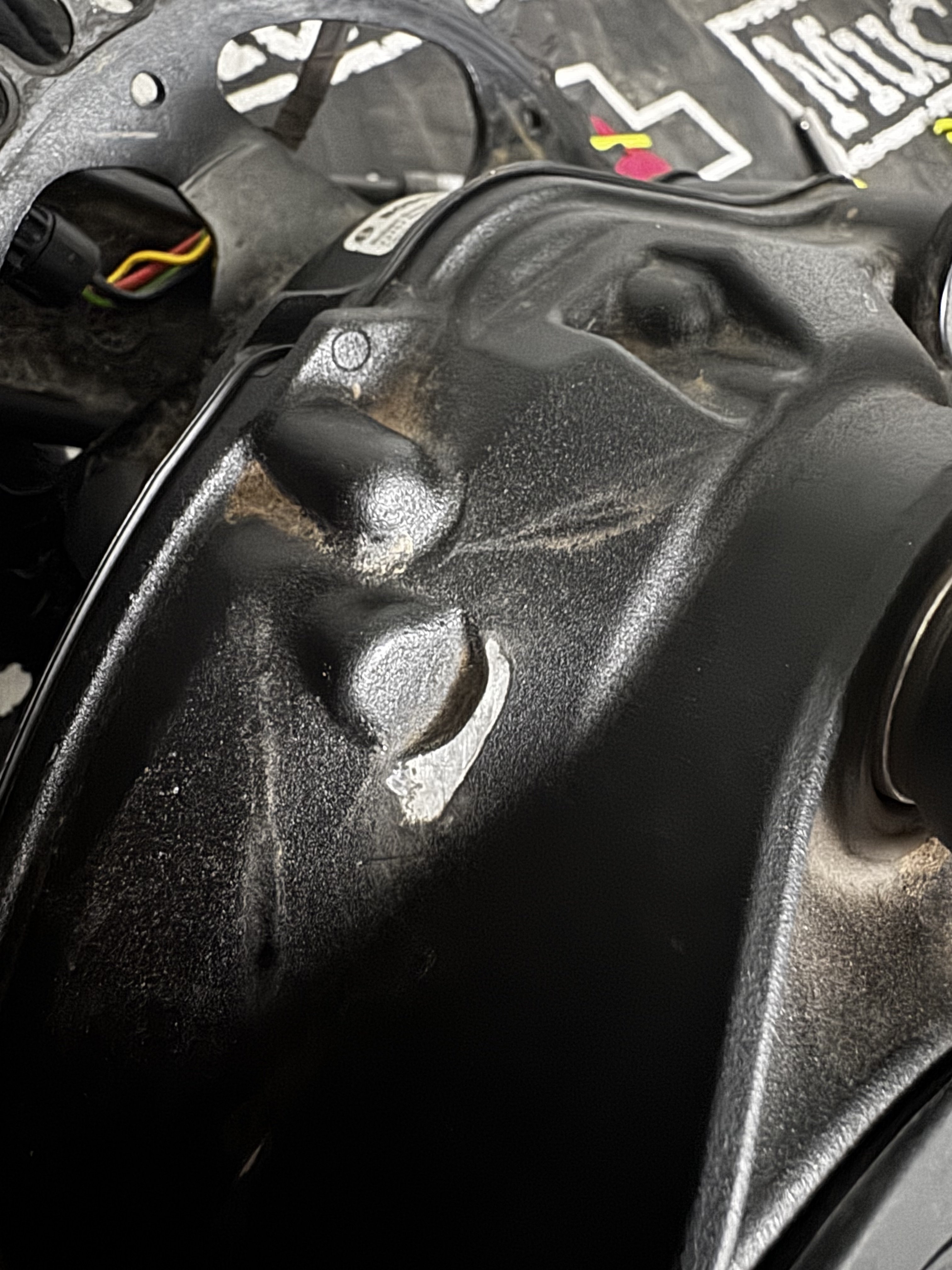

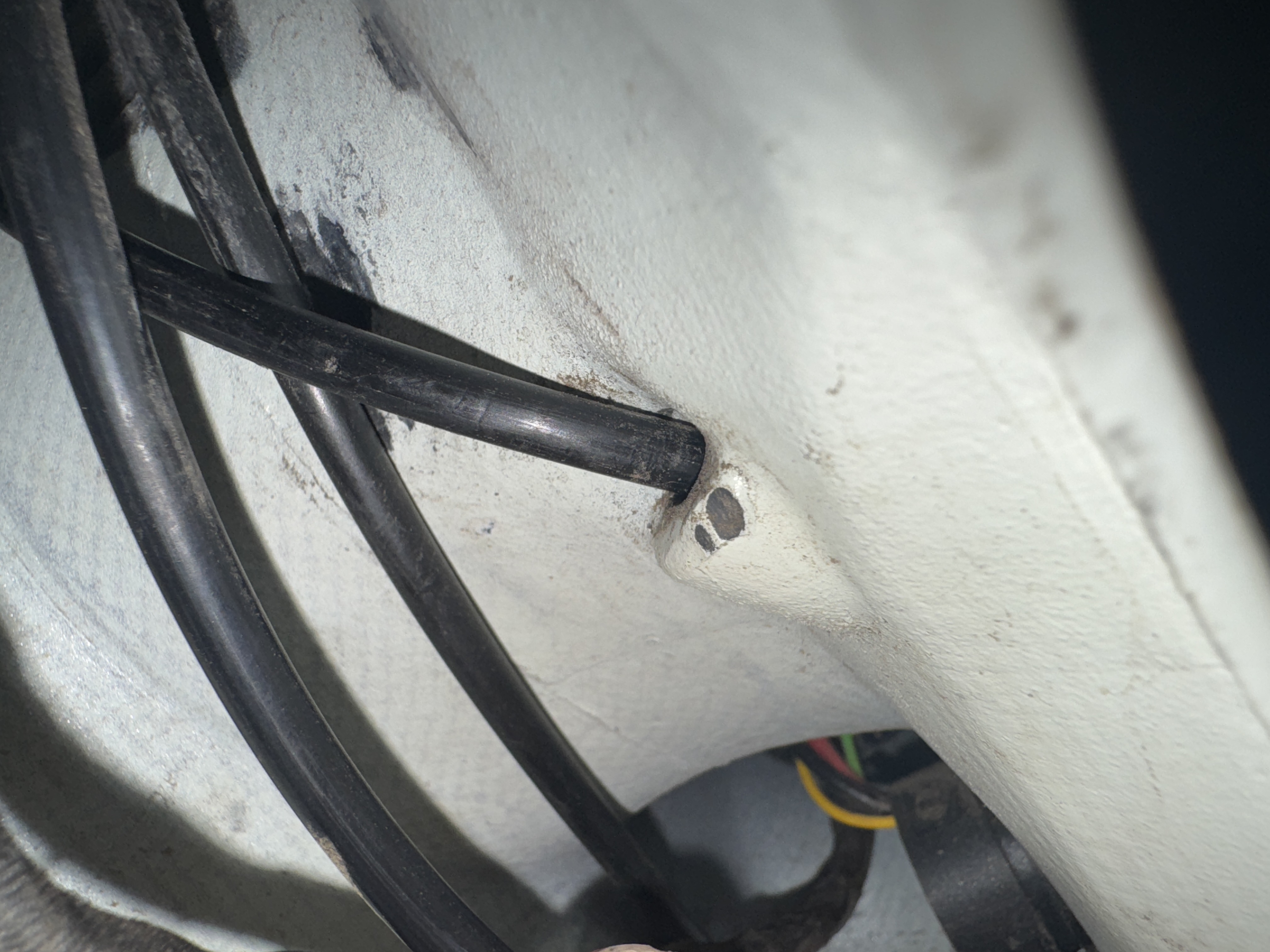

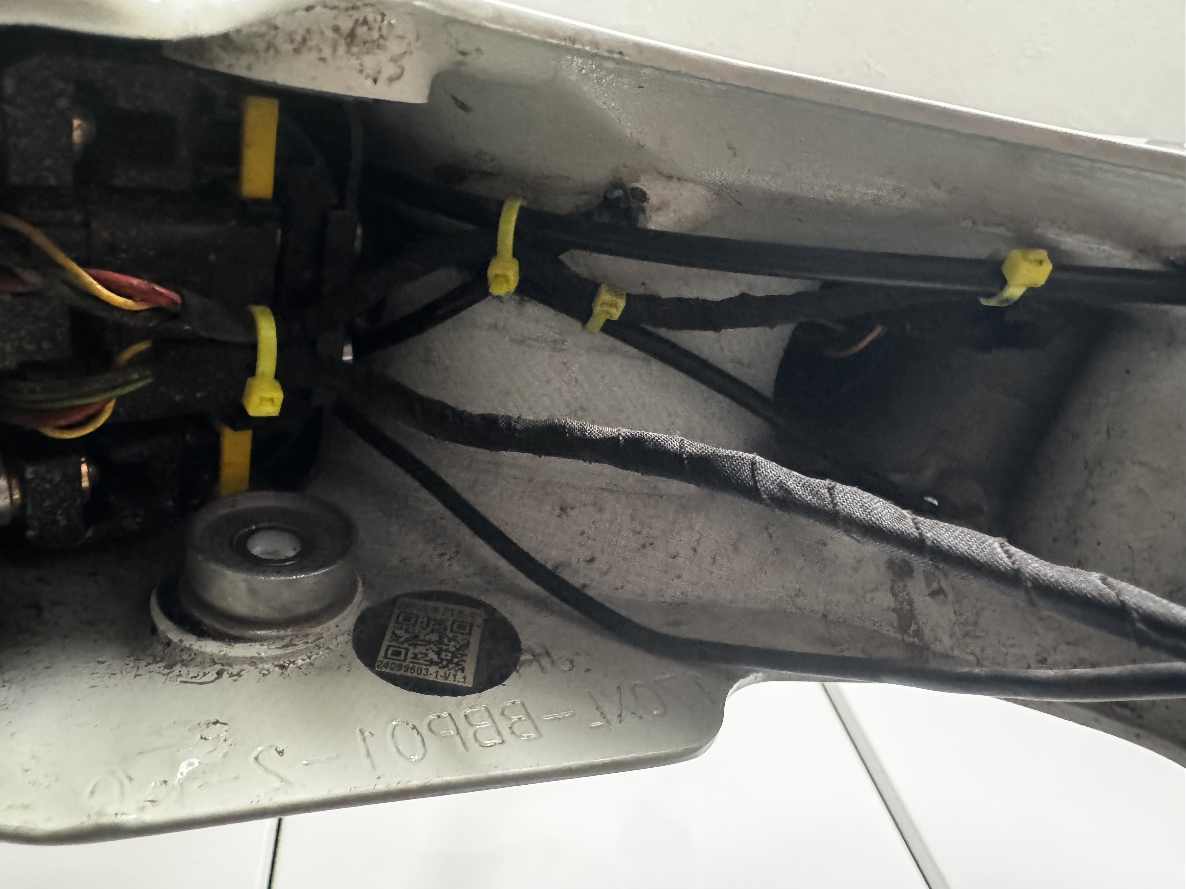

Dropped my motor today to see if I can locate where the noise is coming from. All I could see was the marks to the casing and frame where the dropper cable goes. Anyone else spot anything wrong? Tempted to put some foam up in between motor and frame.
