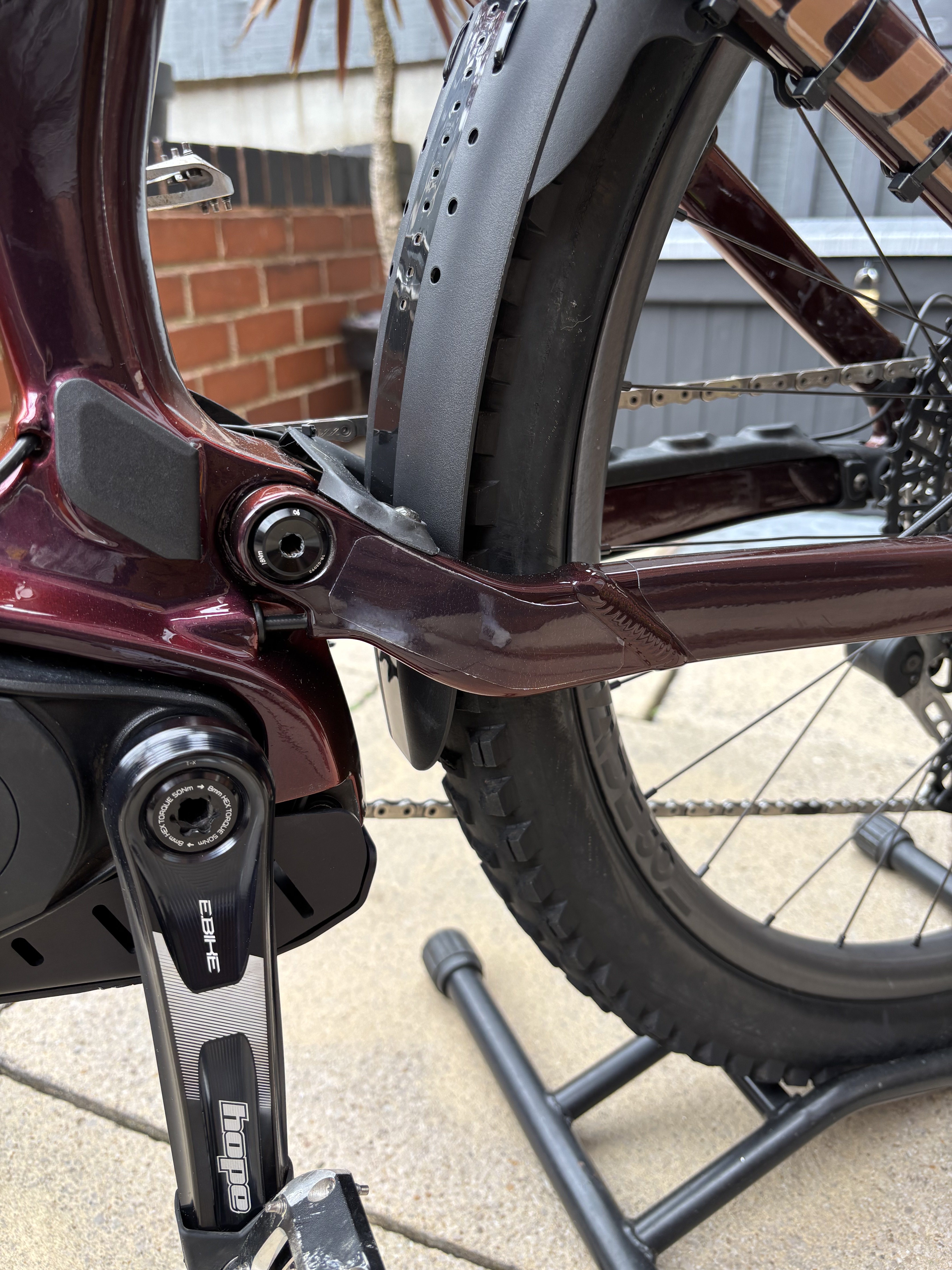

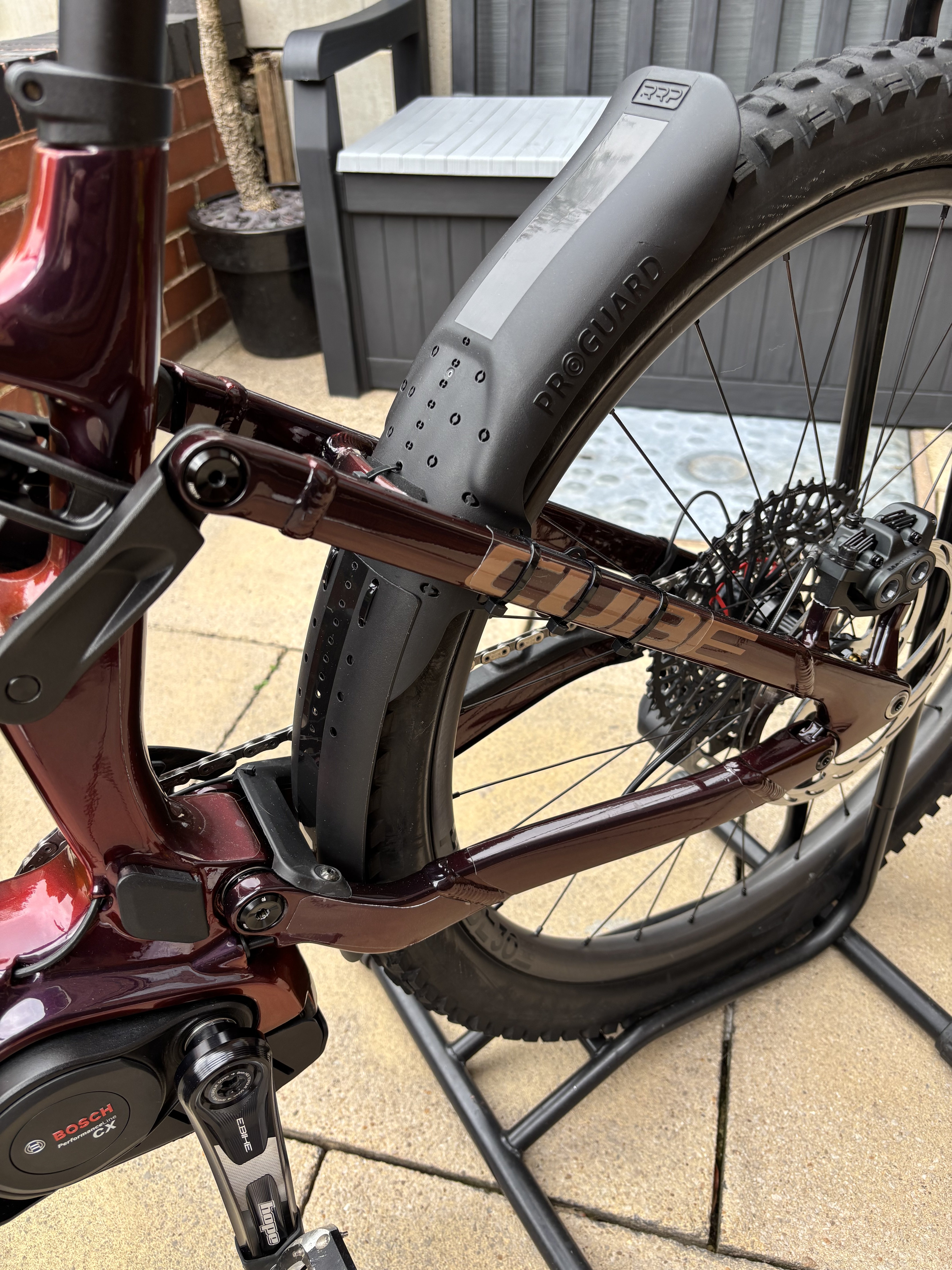

RRP Proguard rear with extender should keep the vulnerable lower swing arm pivots relatively free from the worst of the slop.

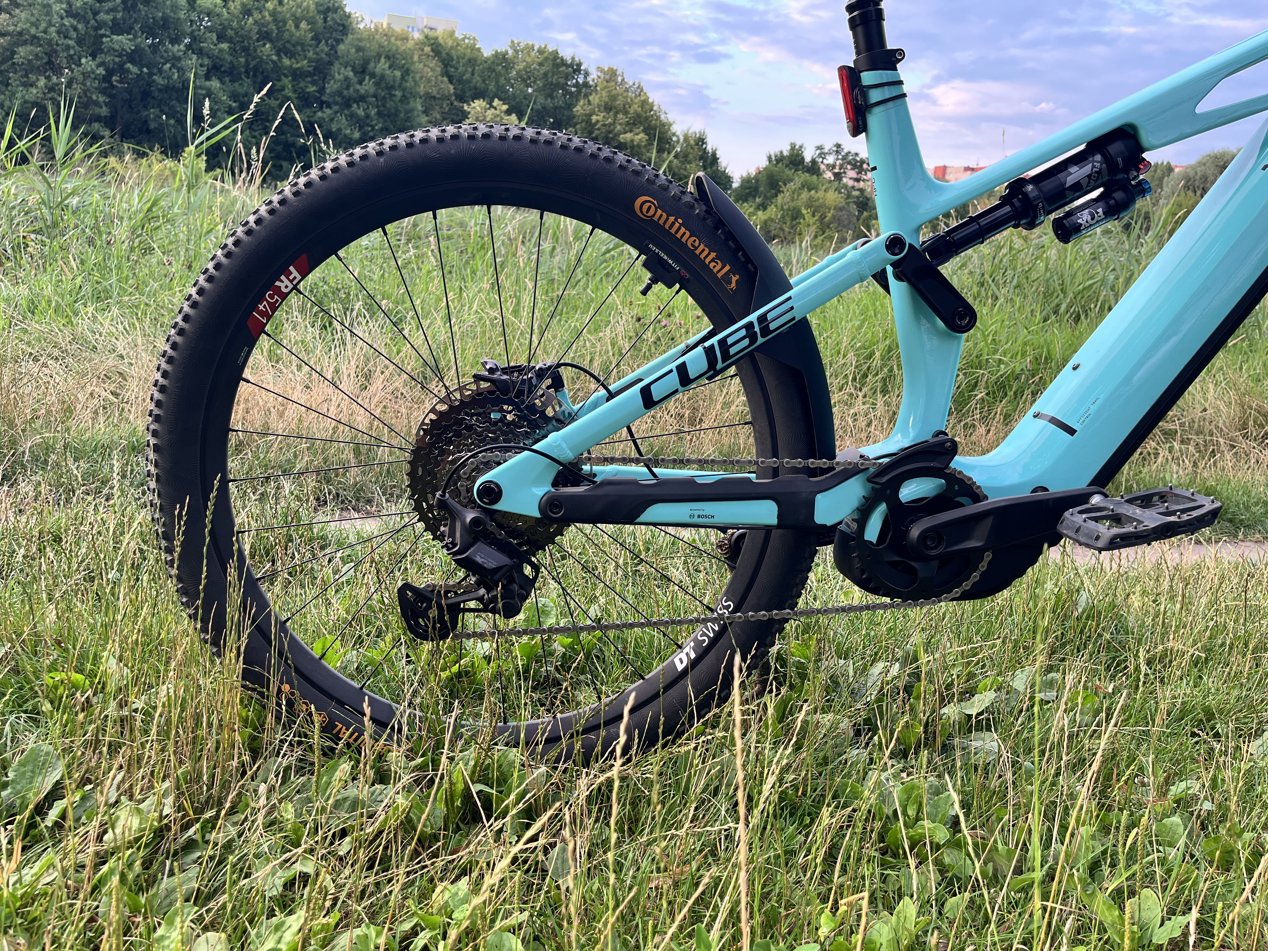

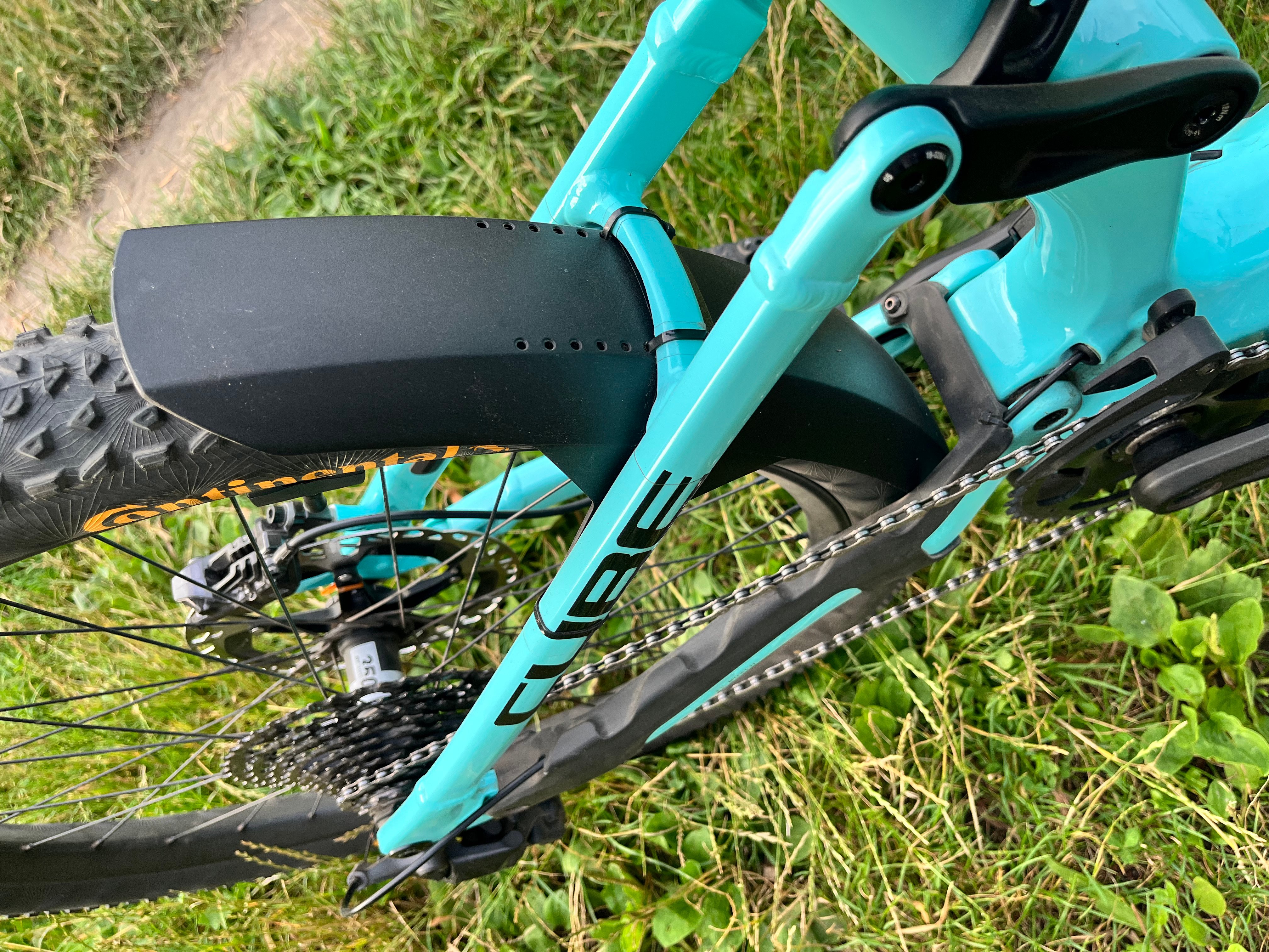

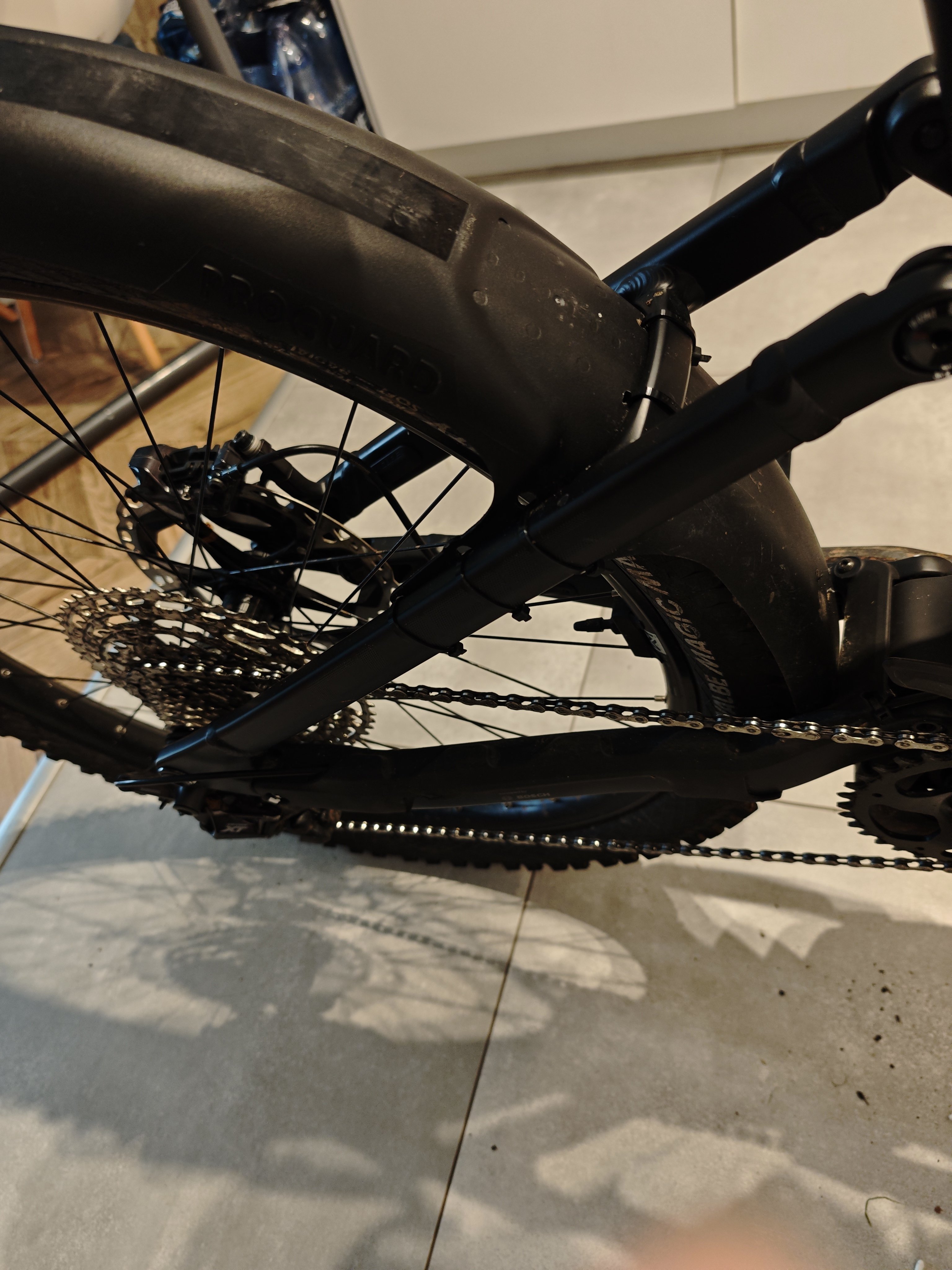

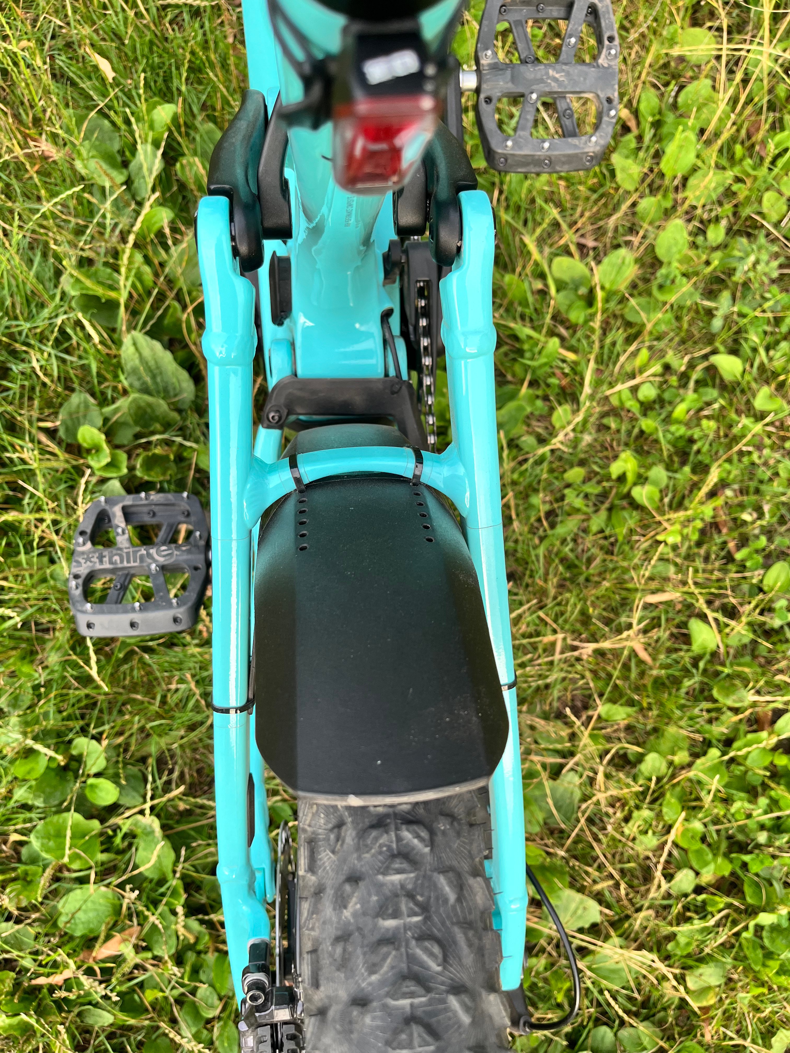

If anyone is looking for cheap fender, I use this Cube Acid MUD Blocker Front Fender on my rear wheel which cost 18€. It's too short for rough, and muddy conditions, but if you need something that will protect swingarm bearings, and prevent mud from collecting on the engine, I recommend it :)

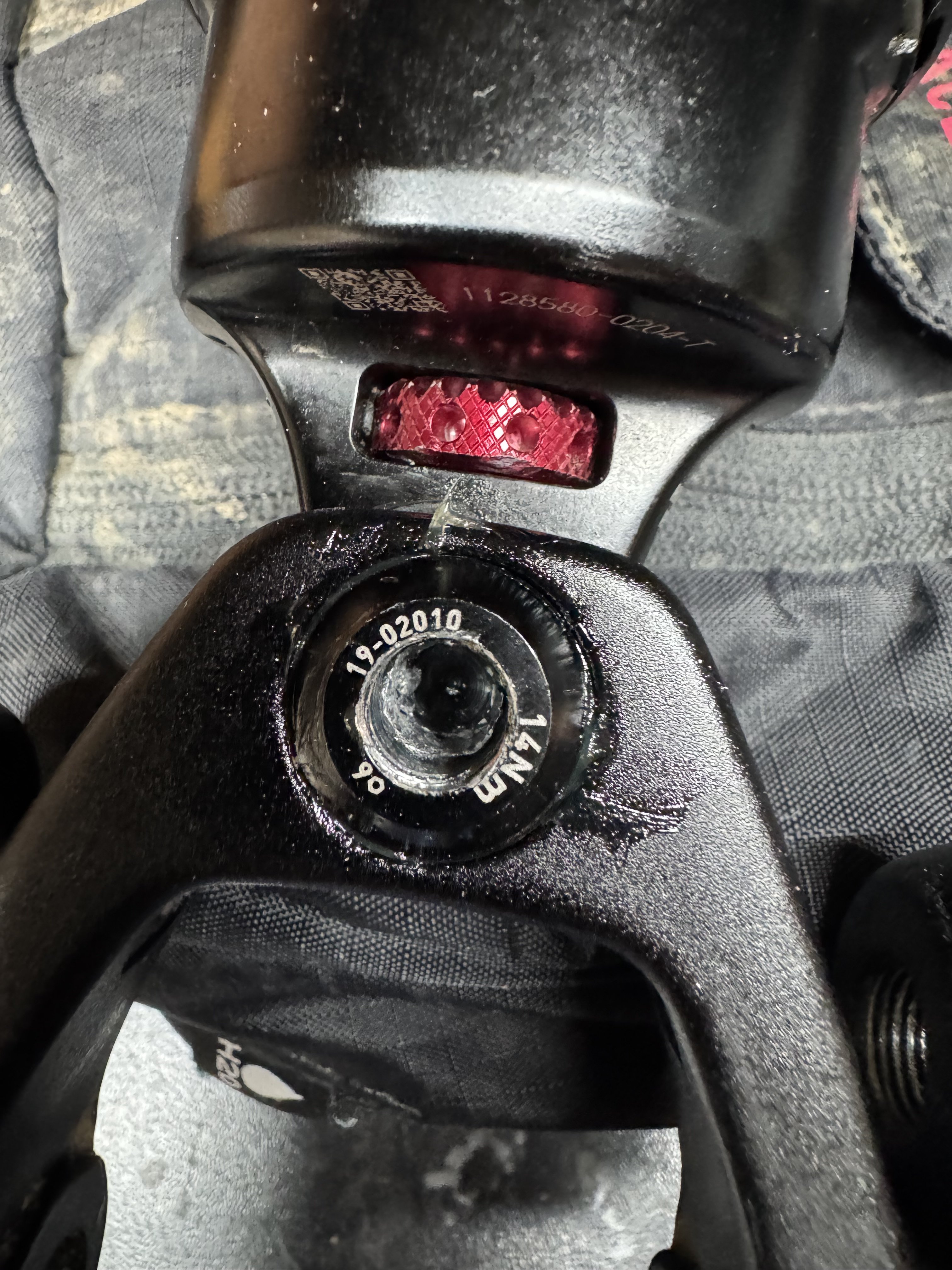

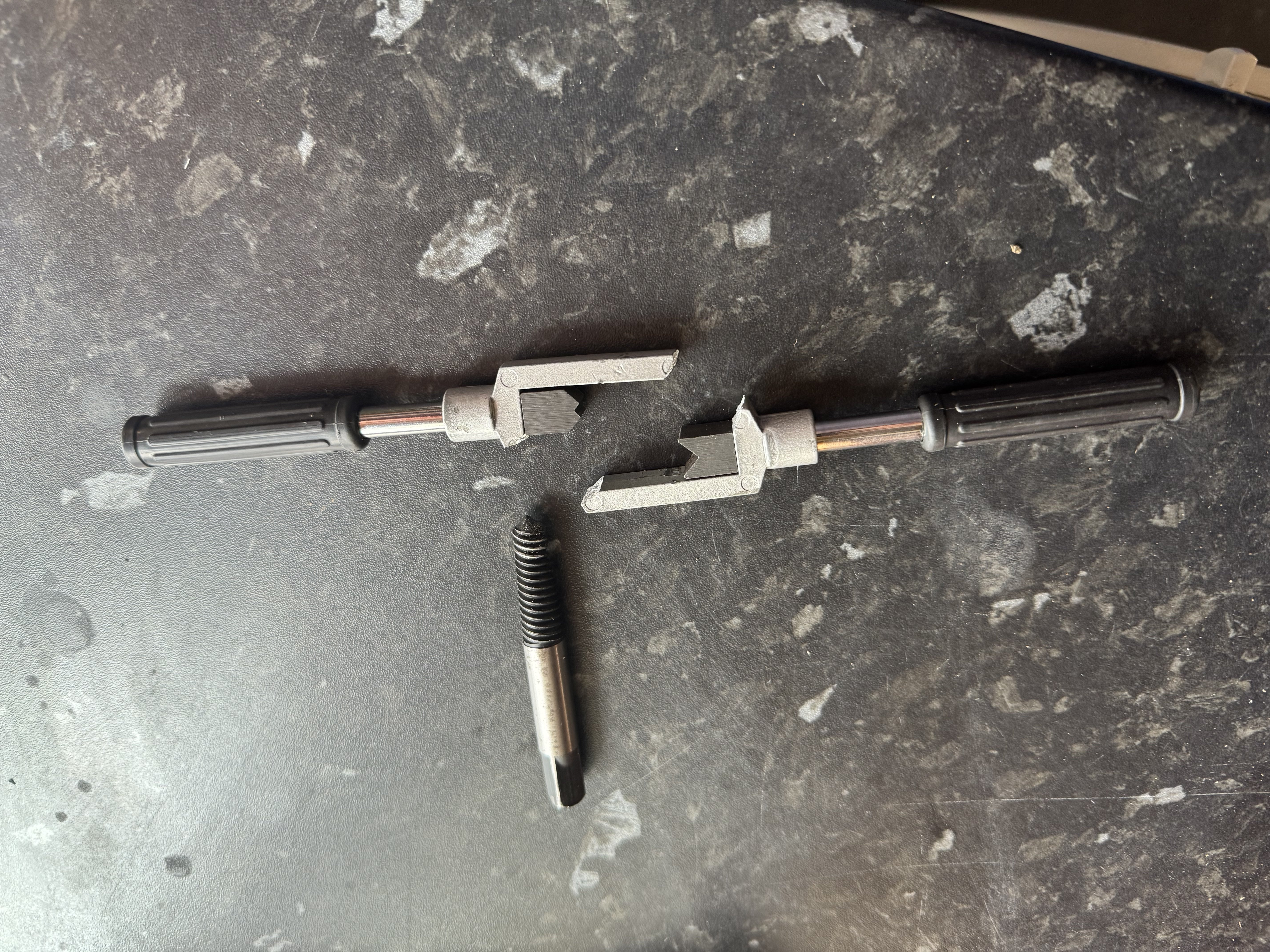

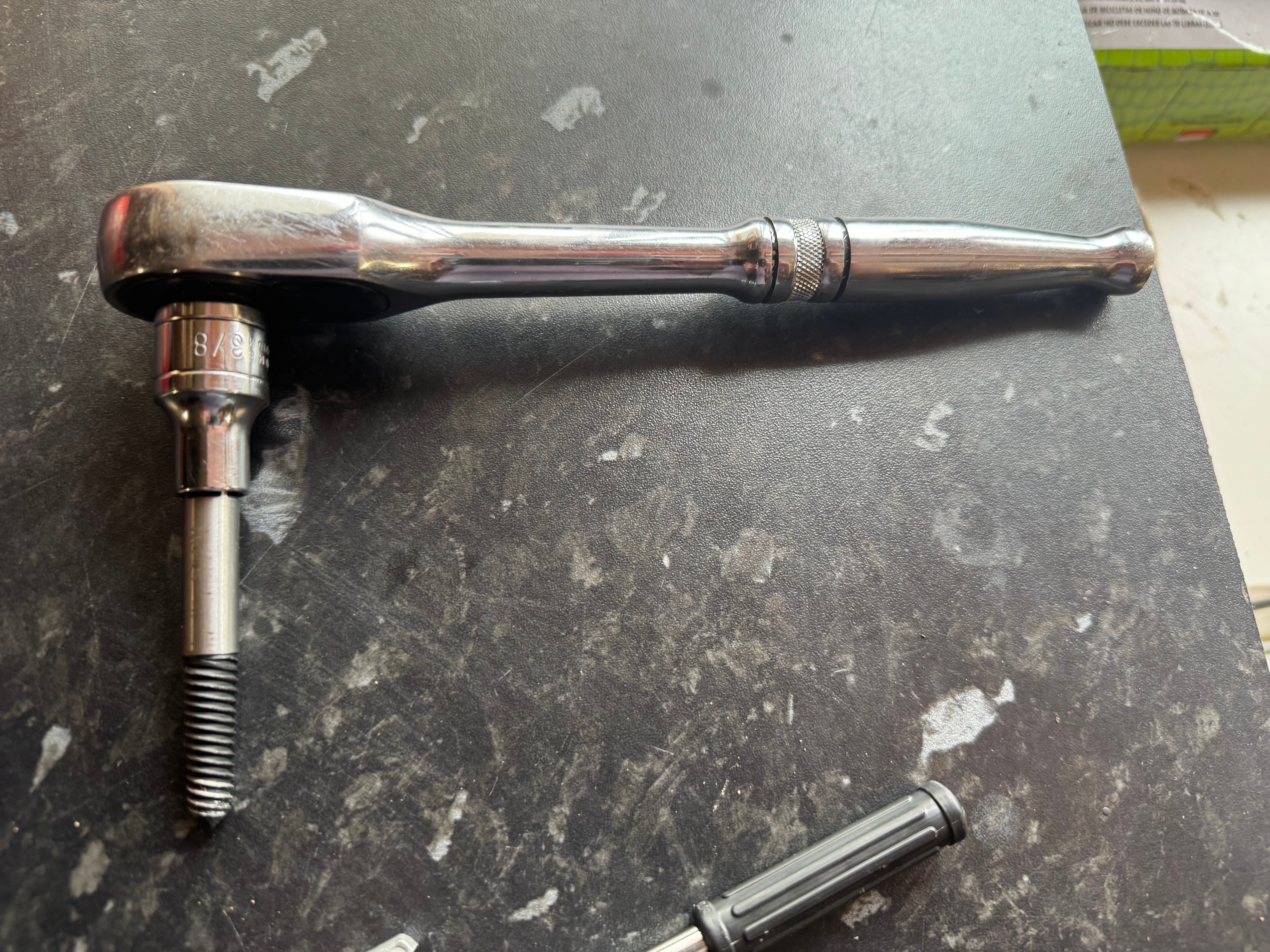

Be careful with over loctiting the clevis shock bolt.
Torqued properly but rounded when removing just now, even though the first few turns were ok.
I had to use a bolt extractor in the end. It was so glued in that I broke my die handle and had to then resort to a ratchet wrench and 3/8 socket to get the bastard out!

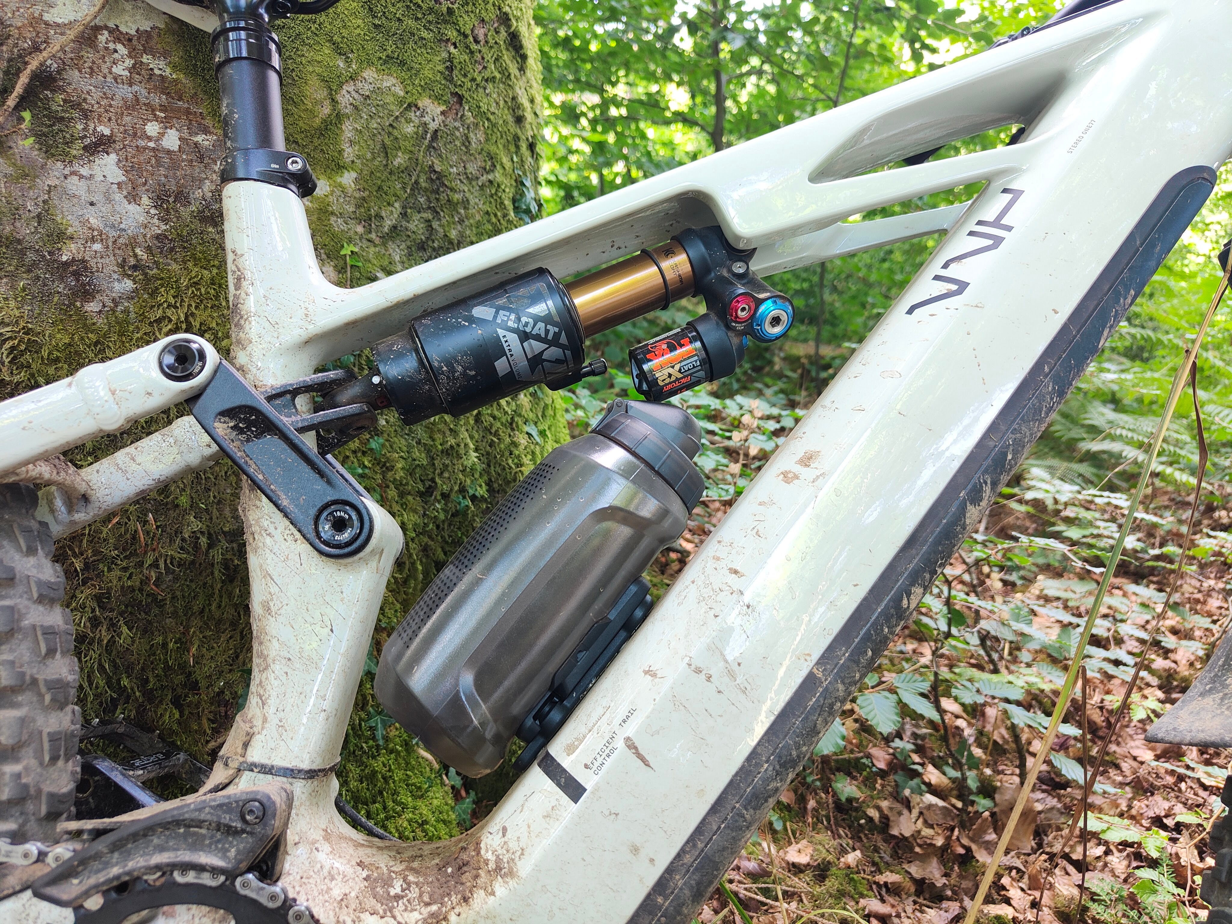

Good news. The 750ml Compact Twist bottle fits ok. Just.!!
The top cap of the bottle misses the shock piggy back resevoir by the width of a rizla paper. Took it for a proper ride over the weekend & had no issues with interference. I'm chuffed with that. Thanks to all who contributed advice :) :)(y)
(y)
On analog bike ( Commencal Meta AM) I had the same problem and it was resolved by rotating mount point and adapter on the bottle. Works fine for 3 years, might be a solution here. .
View attachment 165197 (y) View attachment 165198
A rizla. Now there’s a measurement!
Depending on the moulding of the bottle and the lid will determine if the to cap sits high like yours or low so the fact it still fits even in the worst position it could be in is good news as I may buy one as a second or even main bottle knowing this now. The 590 always ends up finished before the end of a ride and I don’t always have drinks in the car which can be a pain.
Thanks for rolling the dice!
You could also buy another bottle with a different lid, I have one without the dust cover.
Lol. No worries.
Go for the 750 & you'll be fine ;)
