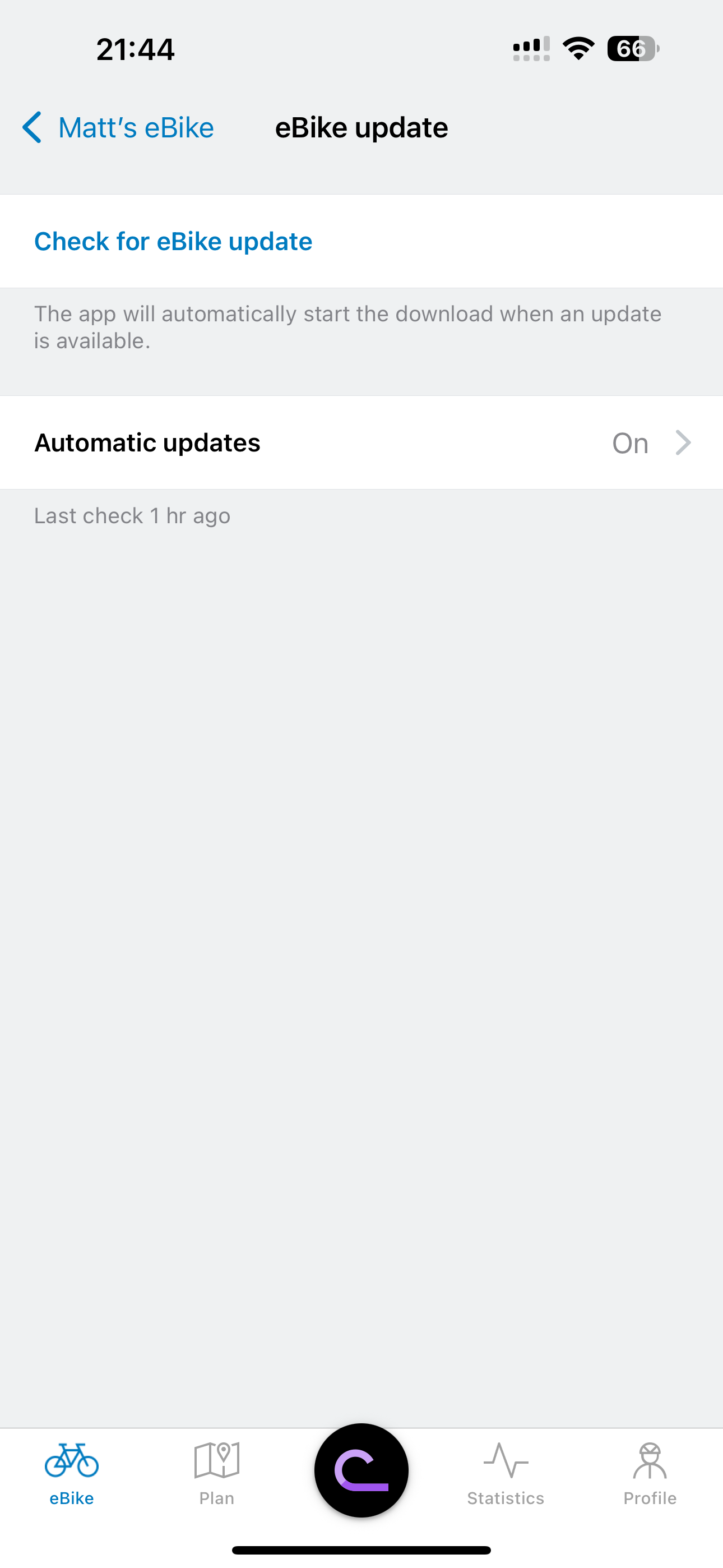

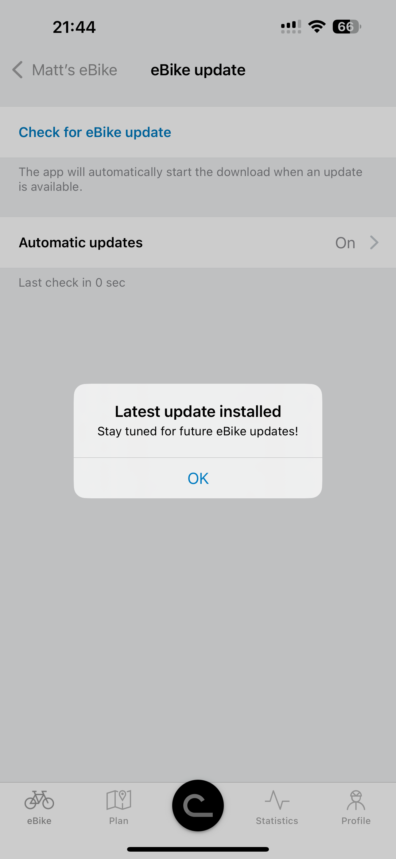

I updated the software but for some reason the max torque is still 85Nm. 🤔 any thoughts?

I found that after updating the Flow app, then installing the software/firmware to the bike (which failed a couple of times before it installed on the bike), I only had the power increase from 600-750 watts but not the torque increase from 85 to 100Nm. I had to go back until the software update screen on the Flow app, and lurking there at the bottom of the screen was a second option to install a ‘performance’ update. Selecting that then installs (in 15 seconds) the torque increase.

I’ve got the same problem. Did the update that did the power increase, but no torque increase or emtb+ mode.
Cannot find anything on the app to do with the ‘performance’ update.
I tap on the update and it says it’s up to date.
This is on iOS btw.
Bit deflating 😕

clear the app by swipping up so its not running in background then connect to bike again and it should pop up. Its what i had to do, might take a few trys but it will pop up
I must have tried what you said about 20 odd times and still nothing pops up.
Where in the app did yours appear? On the update tab or as soon as you opened the app?
Same here. Maybe it appears someday, doesn’t stop me riding the damned thing 😁

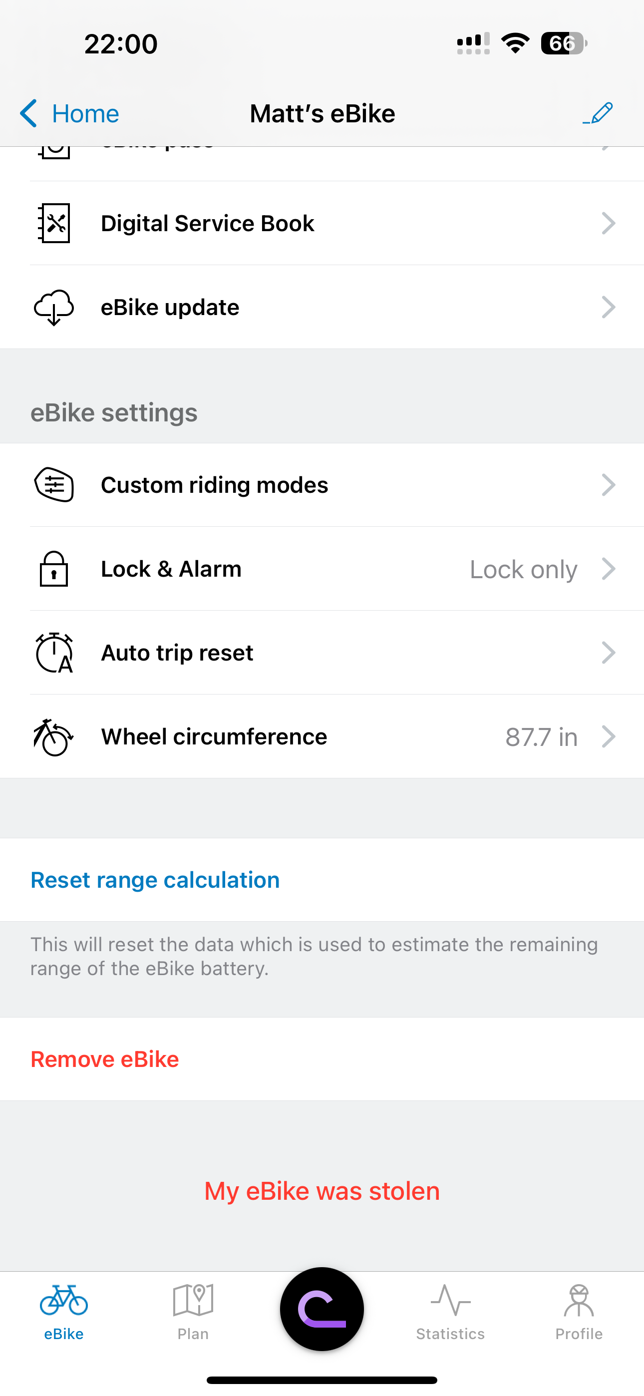

In the Flow app I had to go back into ‘Settings’ (the cog symbol top right of the Home Screen) then to the ‘eBike update’ screen. At the bottom of that screen was a banner with something like ‘performance update available‘. Tap on that and it installs the 100Nm torque update
There’s no option at the bottom of the update page on mine.
I’ve given up with it now. If it appears at some point, then so be it.

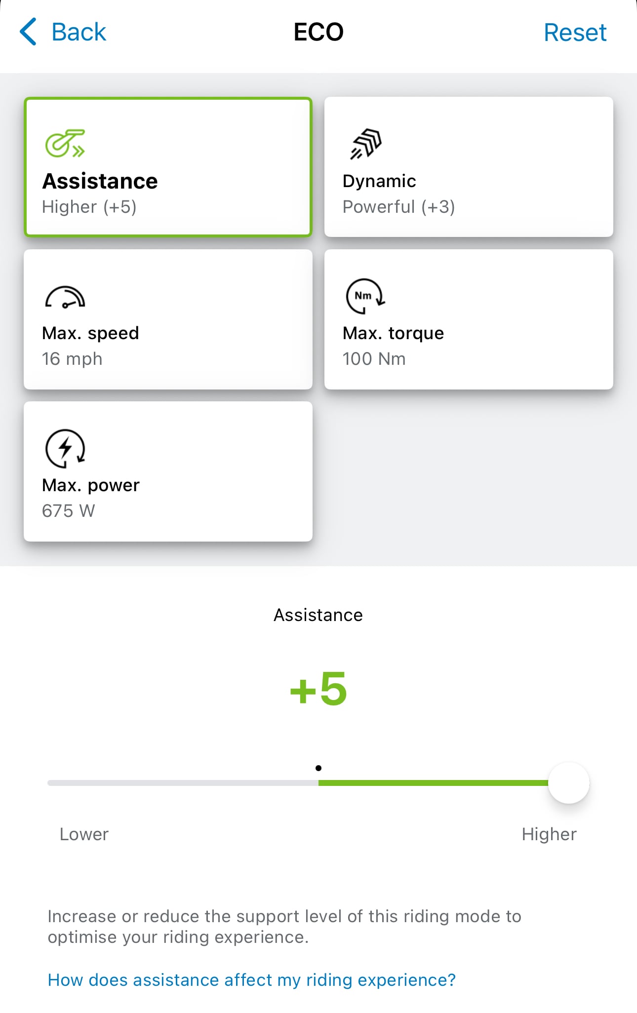

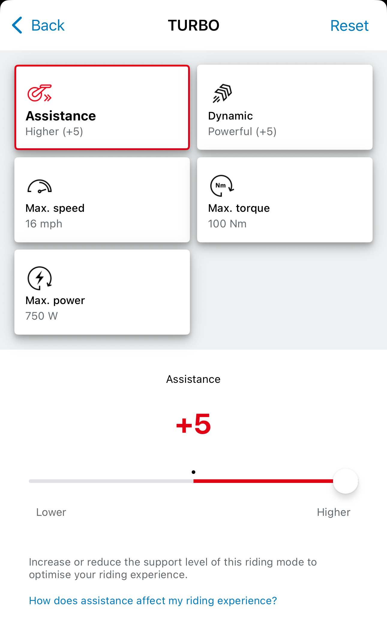

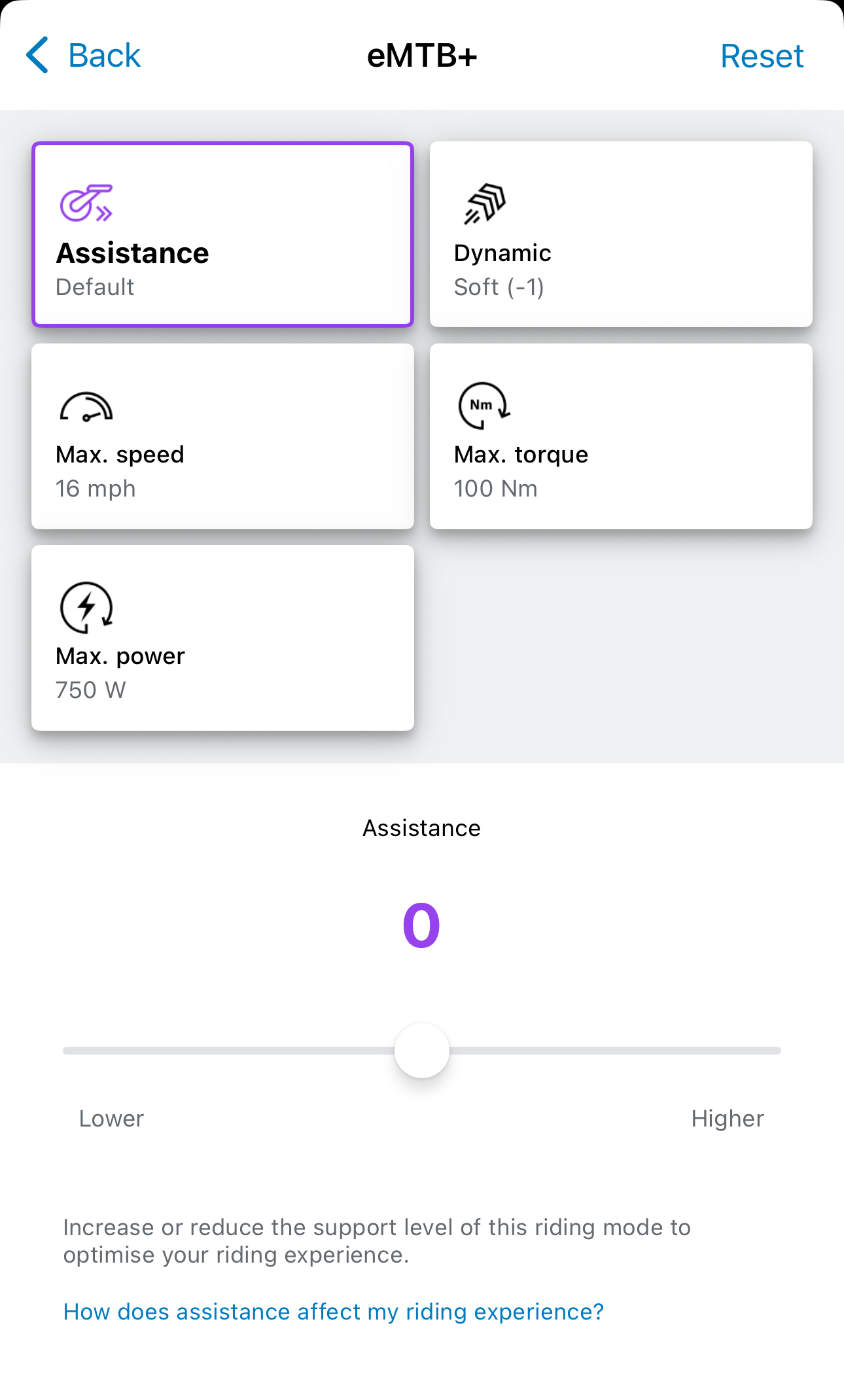

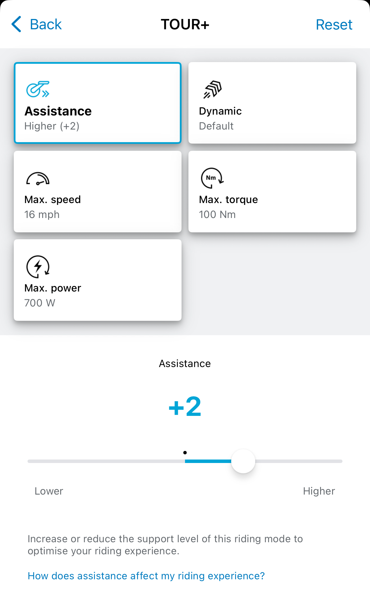

I’ve settled on the below settings, seems perfect for me unless someone can recommend me any different. Very happy with the upgraded power.
View attachment 164390View attachment 164387View attachment 164388View attachment 164389
I use Eco, Auto, EMTB+ and Turbo.
Eco: 600w/55nm (A:0-D:0)
This keeps me as close to my mate on an Levo SL as possible. I should actually go down to 330w/55nm, I'll do this on Sunday when I ride with him and see how it is. My bike is 5kg heavier.
Auto: 600w/85nm (A:0-D:0)
Used when riding along a normal asphalt road or hill. Might go down to 70nm.
EMTB+: 600w/85nm (A:0-D:0)
For all MTB riding. I may change to 750w/100nm in the future after some range tests
Turbo: 750w/100nm (A:5-D:5)
Ready for when when I need it. Everything is turned up to the max because it's "TURBOOOOO".
Yeah, that’s a bit rubbish for you :(. I now feel like one of the ‘lucky few’ that got the torque upgrade before it was paused by Bosch.
