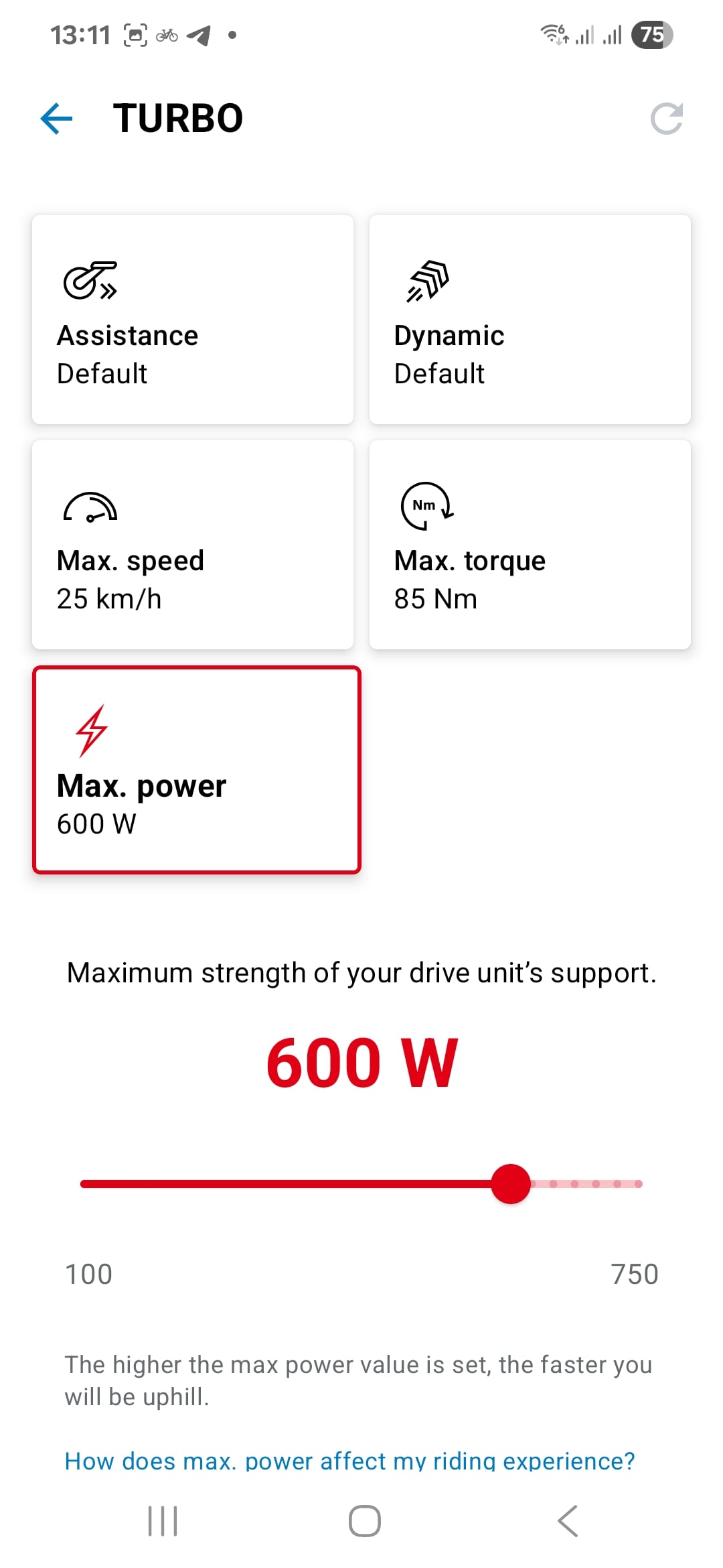

I've just updated android app and the bike!
I found that after updating the Flow app, then installing the software/firmware to the bike (which failed a couple of times before it installed on the bike), I only had the power increase from 600-750 watts but not the torque increase from 85 to 100Nm. I had to go back until the software update screen on the Flow app, and lurking there at the bottom of the screen was a second option to install a ‘performance’ update. Selecting that then installs (in 15 seconds) the torque increase.

I have set EMTB+ and left it as 650w/85nm
I changed TURBO to 750w/100nm
Will see how they compare later.
Borrowed an iphone to do the update, as above the 100Nm setting was a second short update.
I set emtb, emtb+ and turbo as modes, I don't see any %assist setting, so hoping emtb is still 320 gradual, emtb+ is 400% gradual and Turbo is 400% linear.
I did the same, and I'm going for a test ride :)

I've just finished my first ride. 100Nm and 750W are definitely noticeable, but I only have it set on Turbo mode, because I don't need that much power. I prefer to have a longer range. Nevertheless, I recommend everyone try it, because it's great fun :)

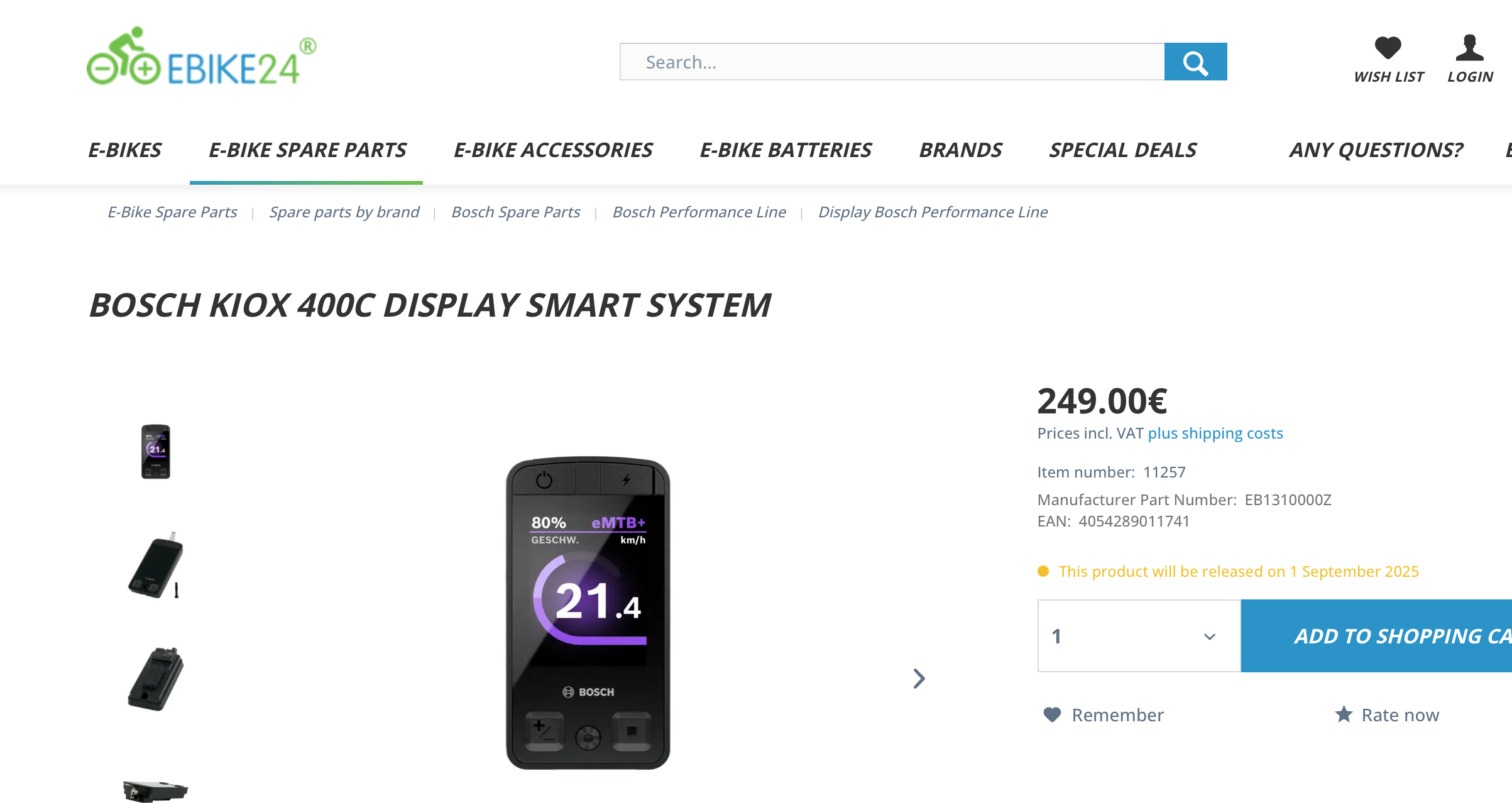

PS. Does anyone know when Kiox 400C will finally be available and how much it will cost? I also saw in a video that Cube will require additional cover, and unfortunately display won't be flush with the frame.
That’s interesting/disappointing wrt the plate for the kiox 400c. Could you share a link to the video

It should fit flush if you remove the frame. Maybe you saw a early production model? still crap if thats the case tho.
It should fit flush if you remove the frame. Maybe you saw an early production model? still crap if thats the case tho.
I think the poster is referring to an adapter that will allow older bikes without the larger cutout to retrofit it. In this case the kiox would sit on top of the top tube.
