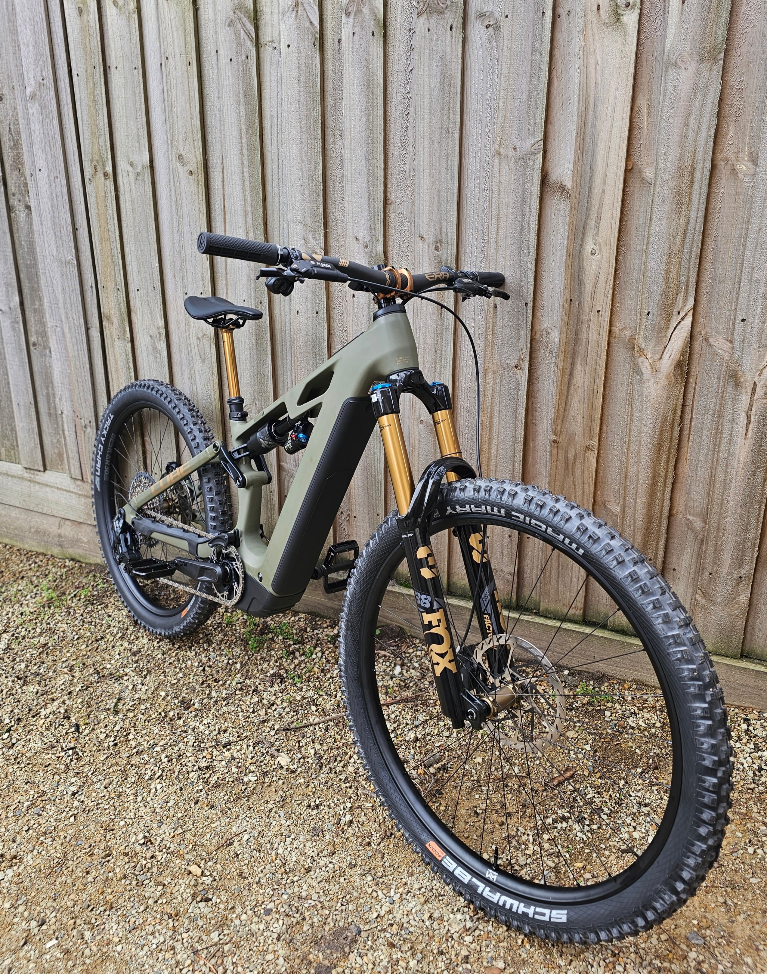

Freshly built with a bit of bling added! Just waiting on the MMX mount dropper lever and Ridewrap to arrive. Swapped out the Magura MT7s for the Mavens from my old bike.
Only ridden around the neighbourhood so far, but with 175psi in the rear shock and me at 72kg kitted up, I'm still almost blowing through all the travel—definitely seconding FlashtoBang's comment about the base tune being way too light.

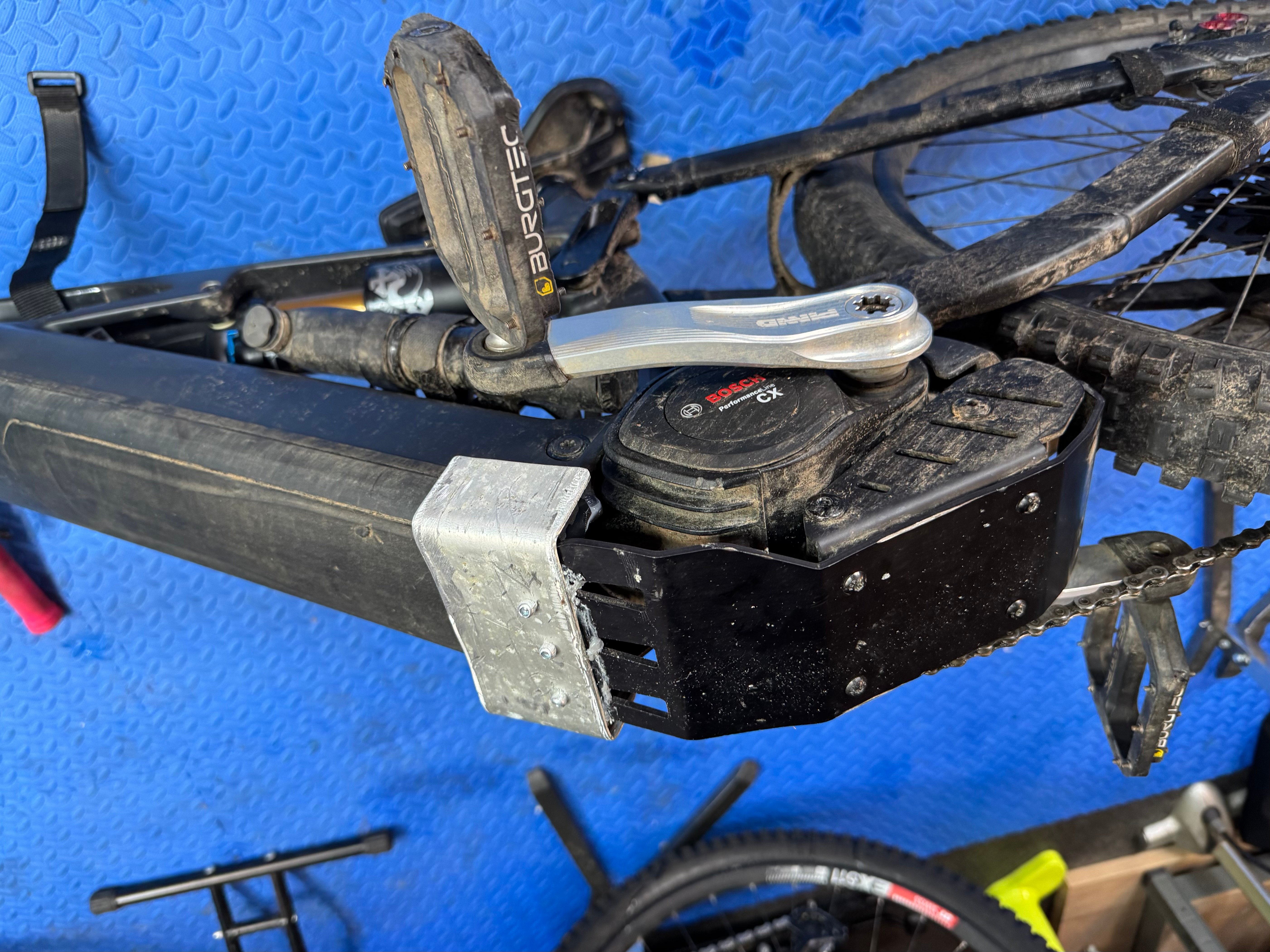

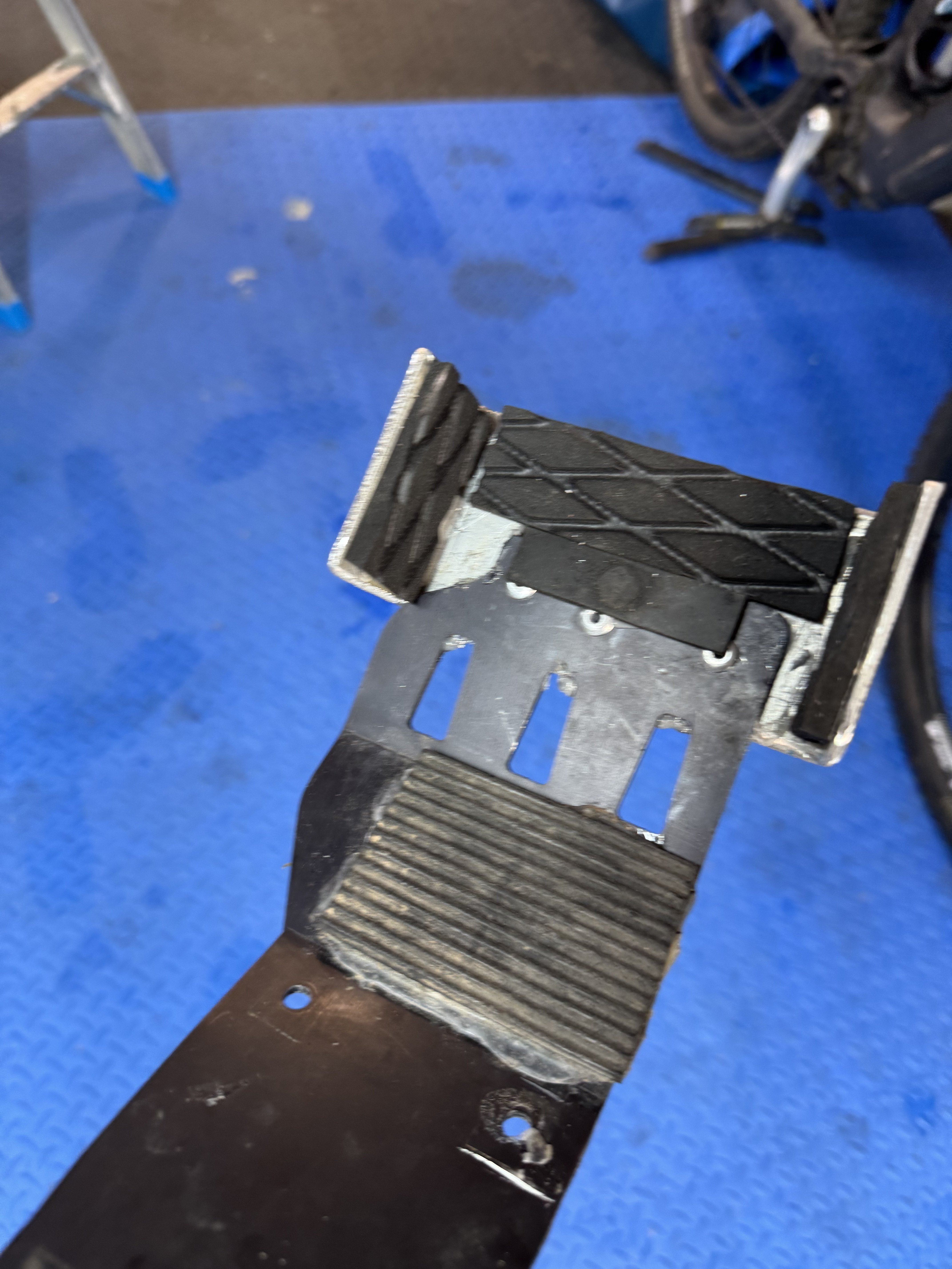

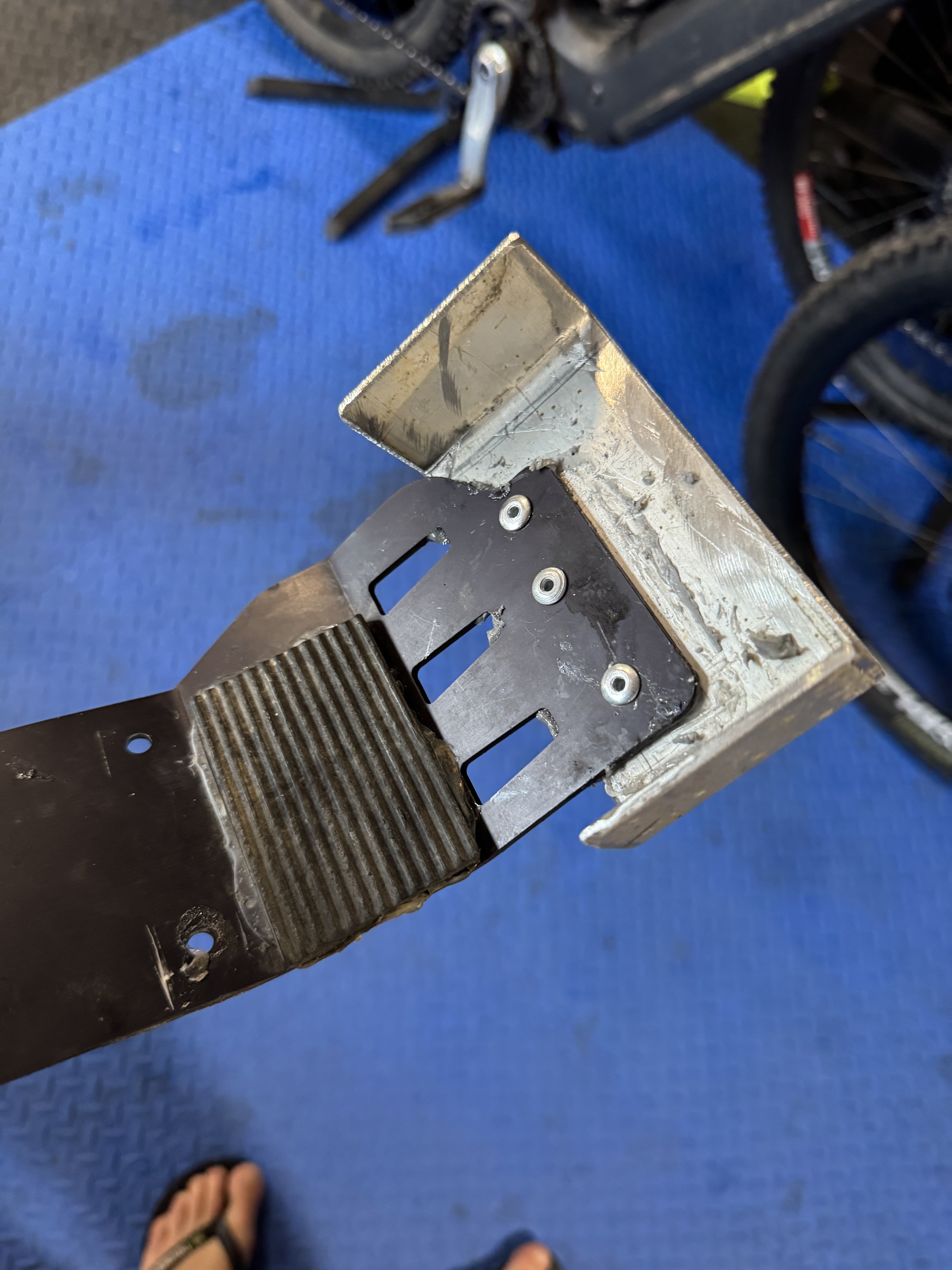

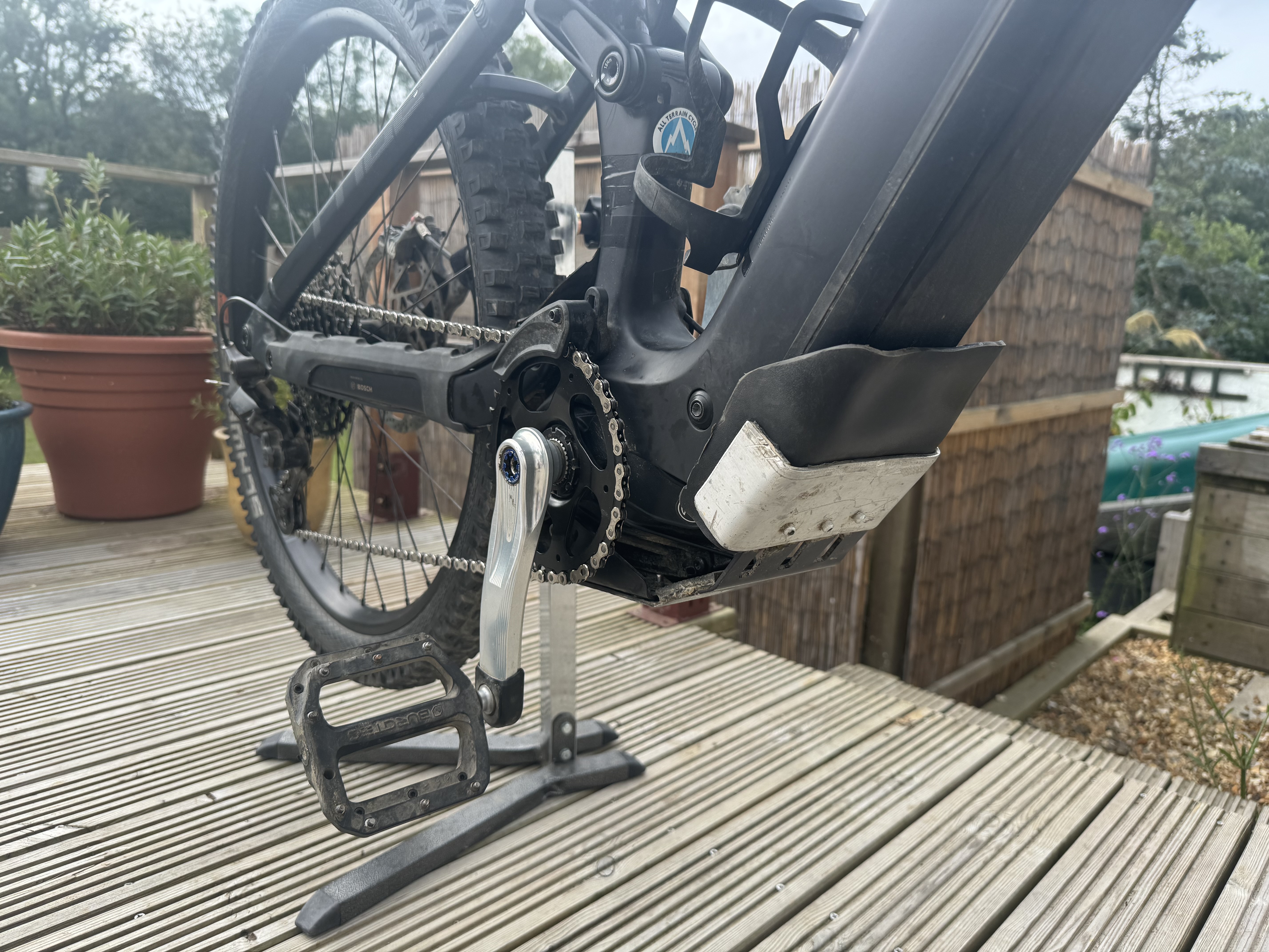

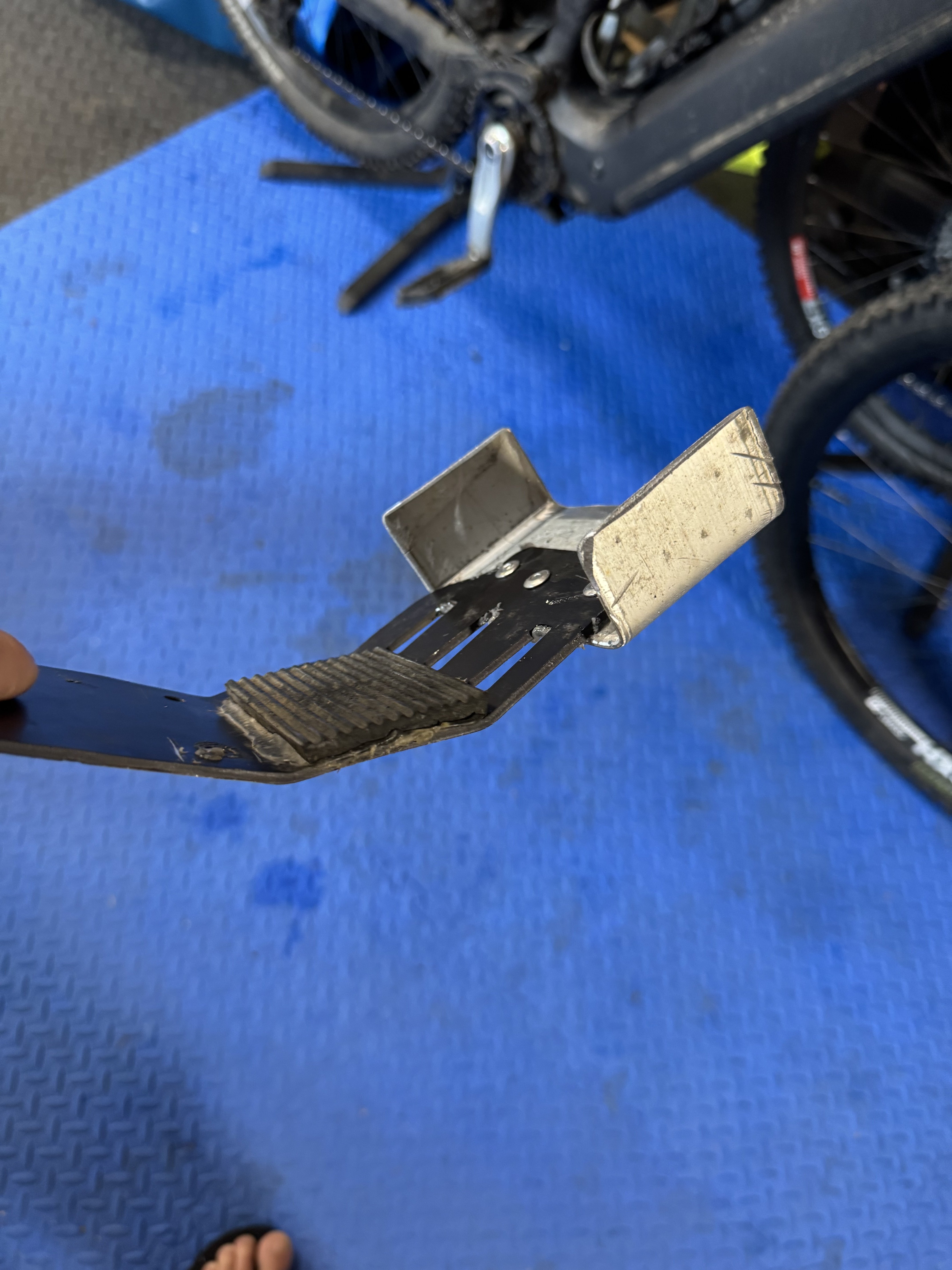

Behold!
If you thought the original AVS guard was agricultural then take a look at my Dr Frankenstein modification.
I don’t honestly care because it’s bloody essential on this bike.
I also added another volume spacer to the rear shock to try and increase mid support. Now running 3 for my 82kg riding weight.

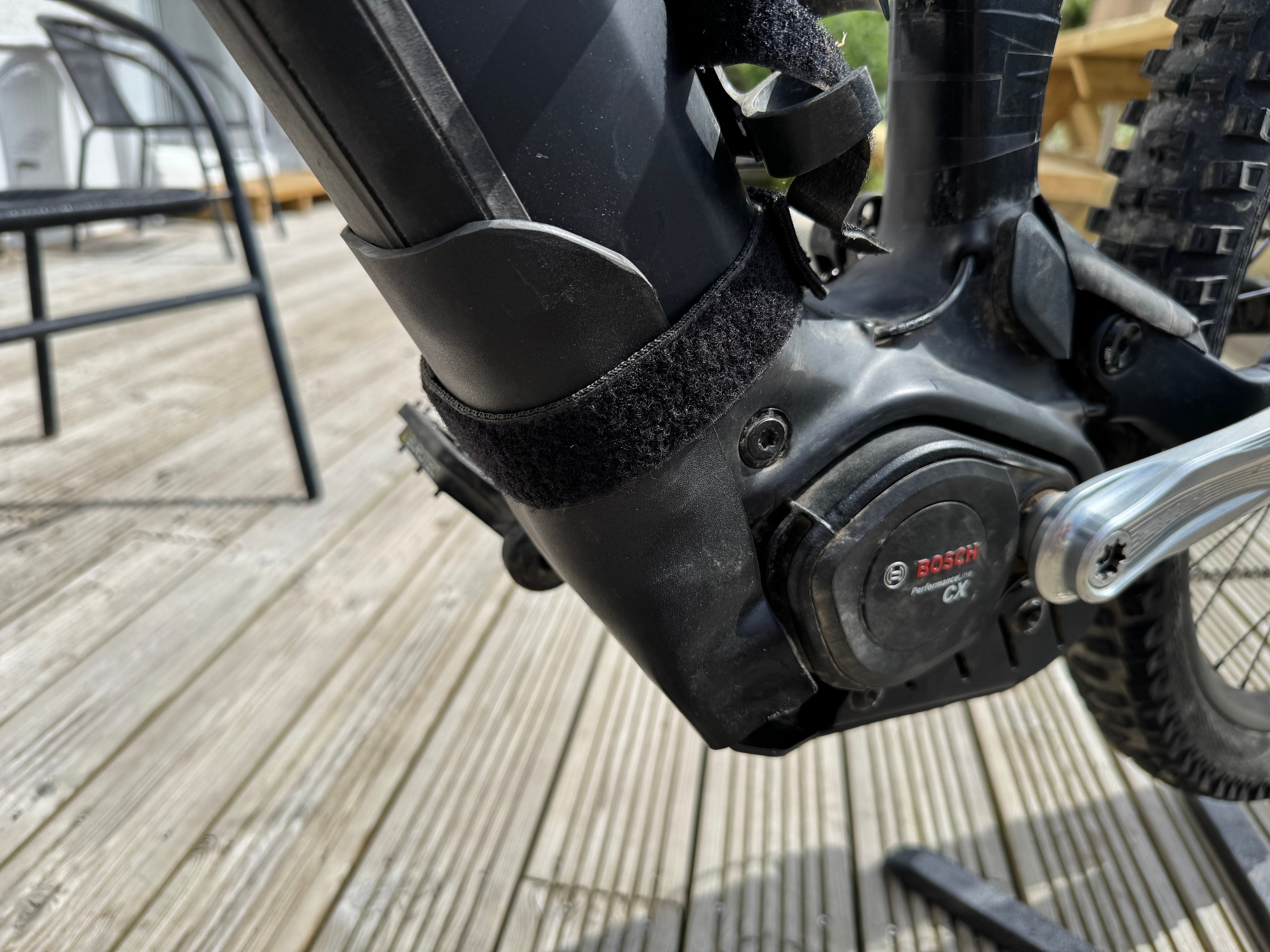

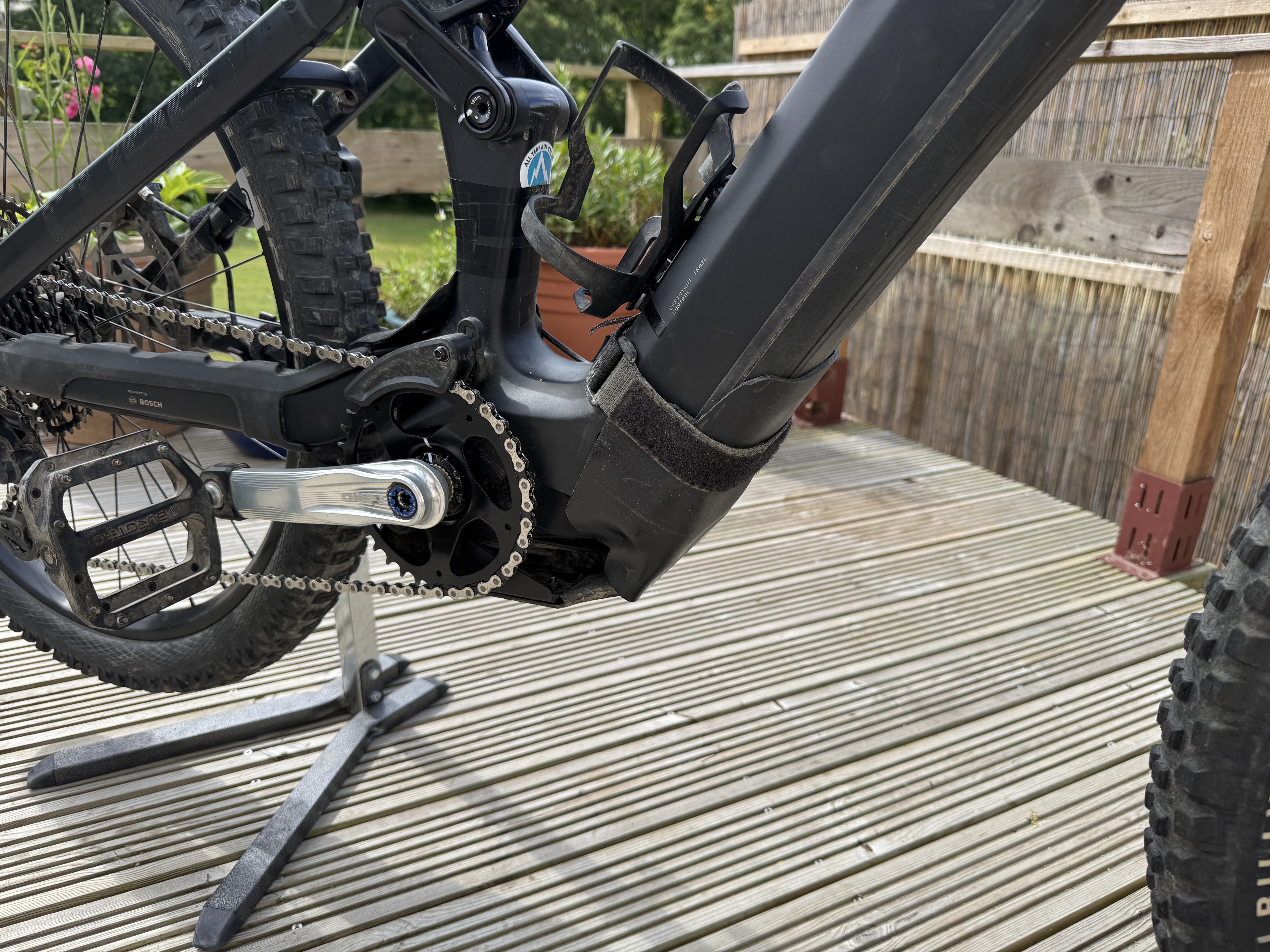

I couldn’t live with the hideous protection so I simplified and used a piece of 3mm think kydex and then heat gunned into a shape that provides more protection and (with the help of a strap) some extra battery cover security.
Much happier. Easily removed and I was using the additional security of a strap before anyway.
