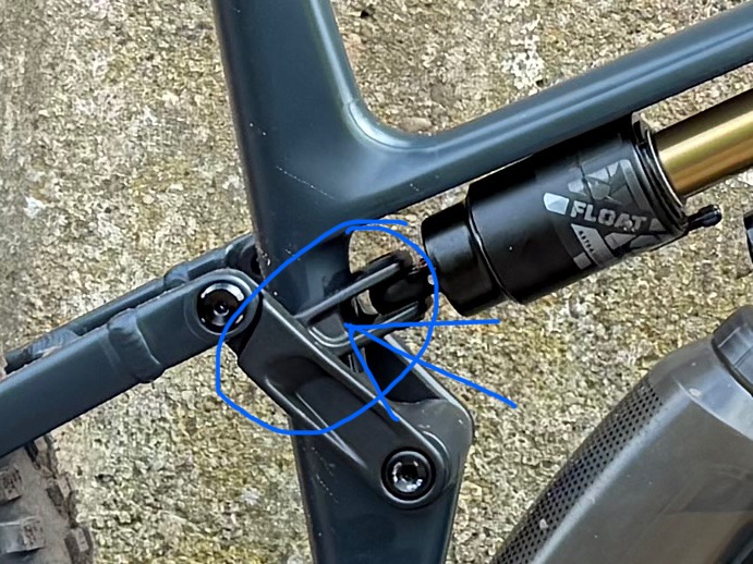

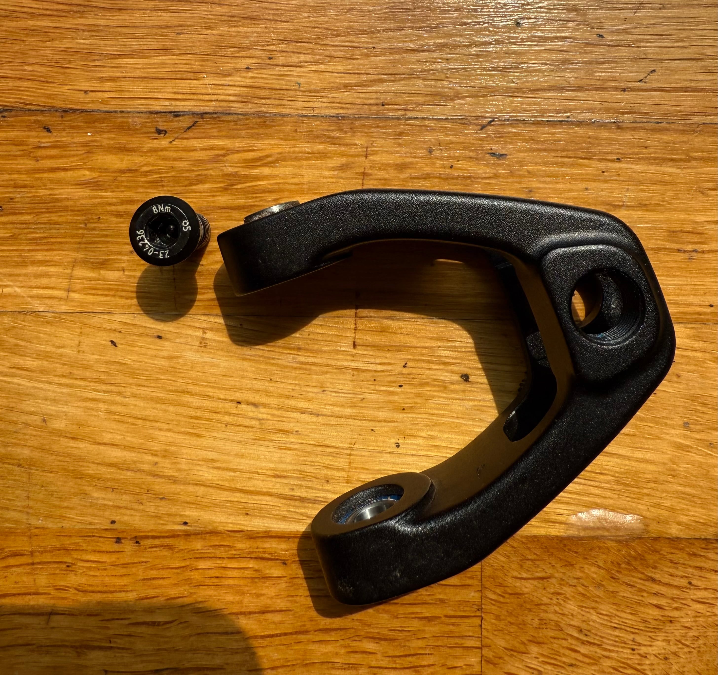

General suggestion is to loosen off the shock and frame pivot bolts enough to put some thread lock in where the end of the bolt will screw back in to. Then, once torqued up, drop small blobs of white paint on the end of the bolts and immediately next to that on the frame. That way it’s easy to visually check if a bolt is coming loose.
I found the pivot bolts on the yoke next to the seat tube needed tightening, but they are a pig to get to unless you put the bike in a stand and remove the wheels and shock.
Be careful with removing the top shock bolt as there’s a (really important) conical washer that just loves to fall out and roll under the nearest immovable fixture you have in your garage 🤬
Can you post a pic of the "yoke" part you refer to as coming loose, please?

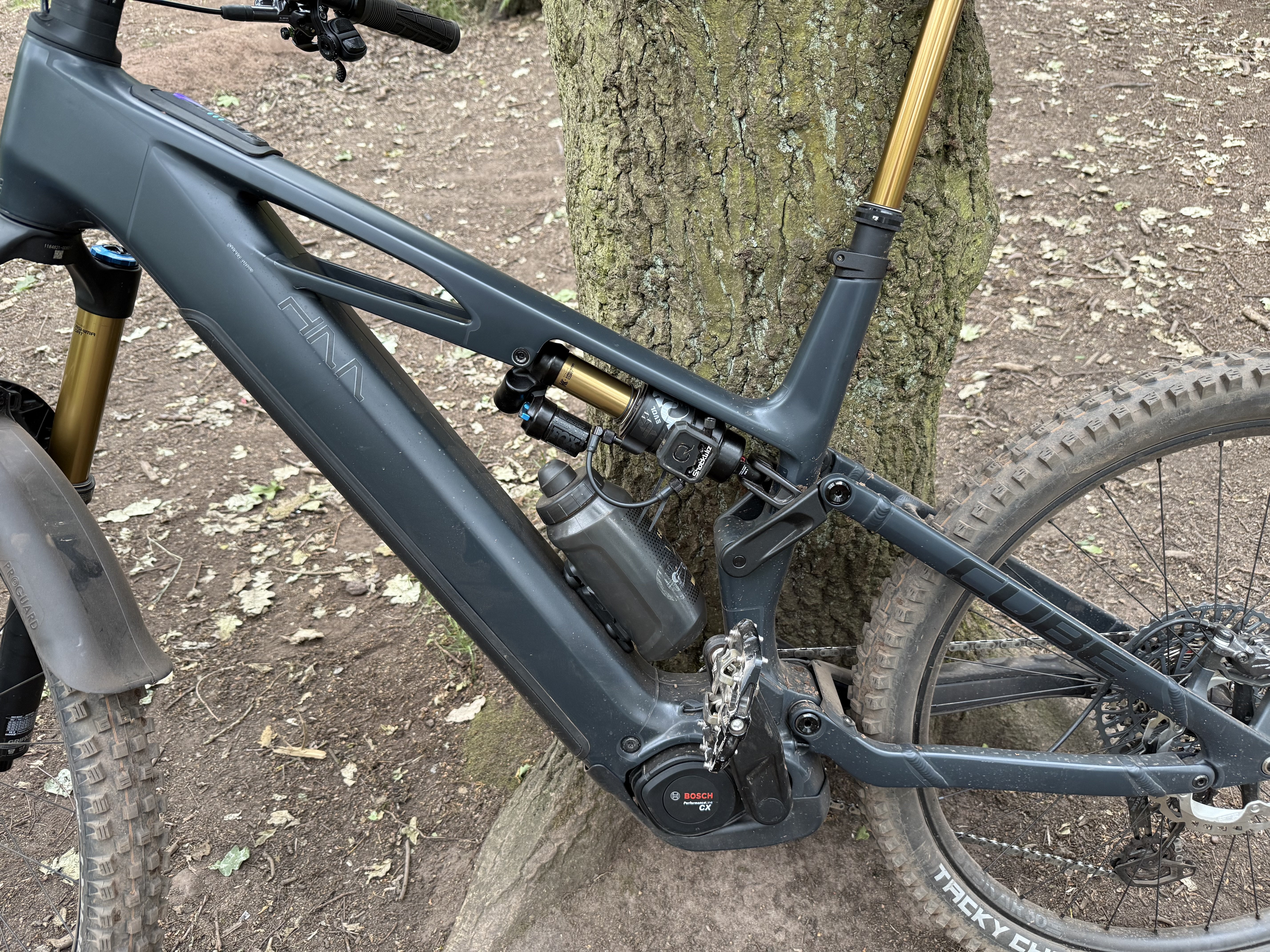

Excellent. Thanks for your reply. It looks like this.?
What size Fidlock bottle is that please.? I also have an X2 shock & want to fit the biggest bottle possible.
Thanks :)
It’s the 590. The largest I could get on the bike as it happens :)
It’s also worth bearing in mind the frame size. Mines an L and it’s tight. I believe the 750 is on the XL which would give marginally more space.
I wasn’t sure if this would have been too tall. It’s marginally shorter than the 590 which I guess helps. Do you have a pic on the bike?
Edit. Signals rubbish, pic randomly loaded in after I send message. Ignore 😂
Ah, yes. Mine's a Large so maybe the 590 ml is the max size to go for. FlashtoBang.. What size is your frame.?
Yes, mine is the XL frame, but there’s loads of space. When I checked them out in the shop, the only difference I could see is the 750ml was fatter than the 590ml one, but not any longer that I could see. Maybe worth a trip to your LBS to see if they have both in stock to confirm.
Edit - the 590 one is 208mm in length TWIST bottle 590 + bike base | Smoke | 09636-001032(TBL) and the 750 one is 210mm in length TWIST bottle 750 compact + bike base | Smoke | 09676-P01032(TBL) so I seriously doubt 2mm will make any difference. I suspect the 750mm one will work in the L frame bike if the 590 does.
I can confirm based on the length of the 750 that it won’t fit. The thickness of the 750 brings the part where you drink up and currently I only have about 3mm of space. A bit of basic maths puts the edge of the cap approx 4.2mm upwards which would foul. As you can see, I have to have my lid a particular way in order to have it fit already.
Edit, the cap seems different, maybe it will fit… it’ll be bloody close that’s for sure.
