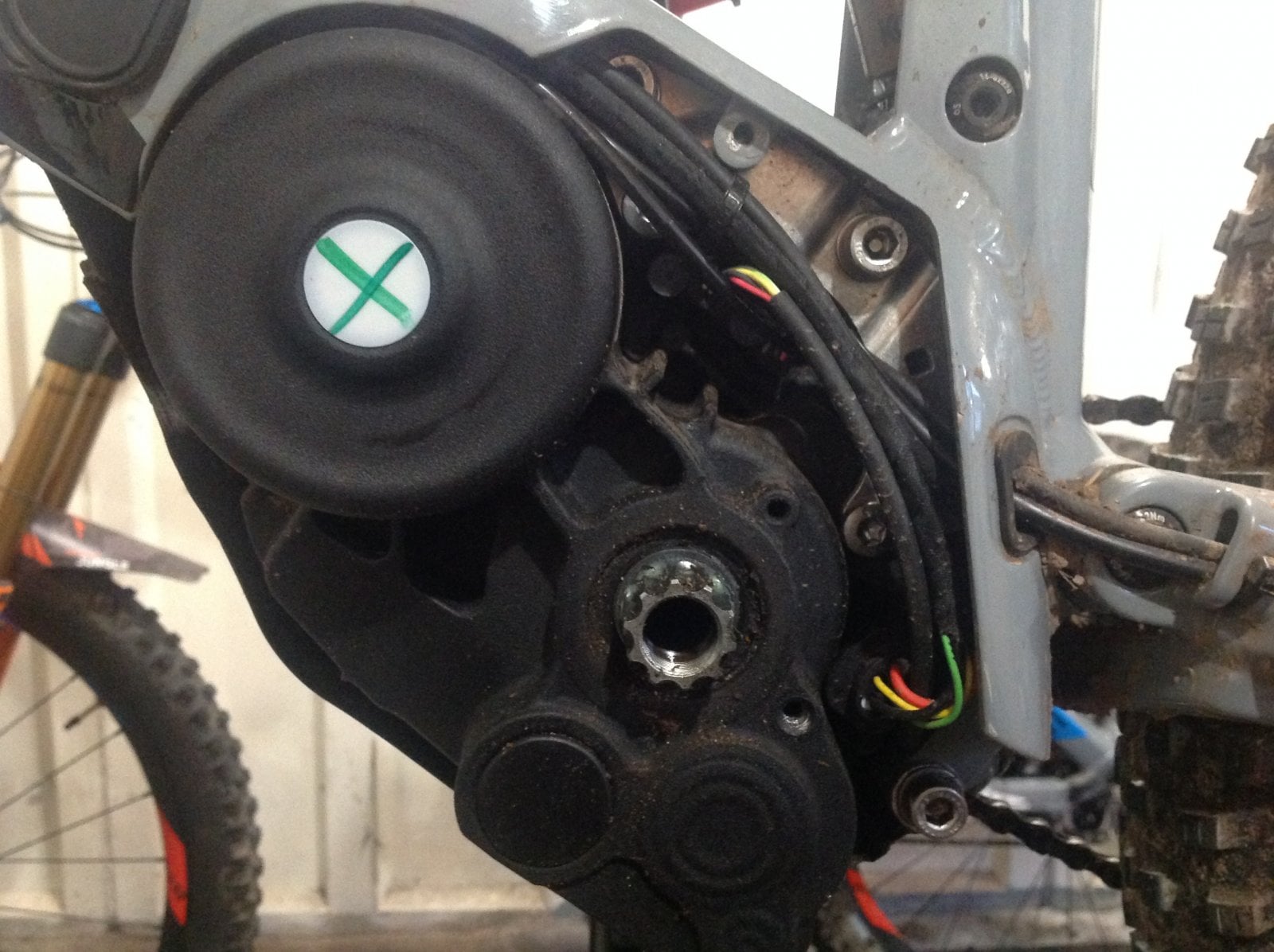

After removing the bash guard & the cover, the inside was very clean and tidy ( unlike many specialized motors ).

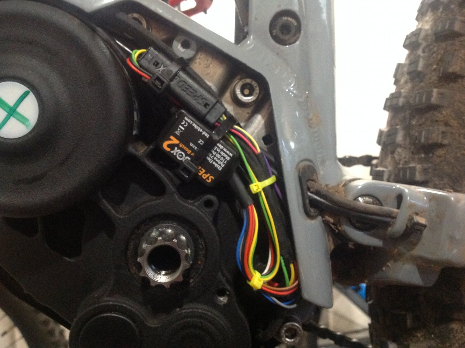

A blowout with the compressor, cut a cable tie, pullout the two plugs from the motor, plug in the two new plugs into the motor, then plug together the new loom.
A little bit of tidying & a few cable ties, you would have thought an Auto - Electrician had wired it
Instead of a 55 year old plumber
After replacing the cover & bash plate - which took much longer than the re-wire

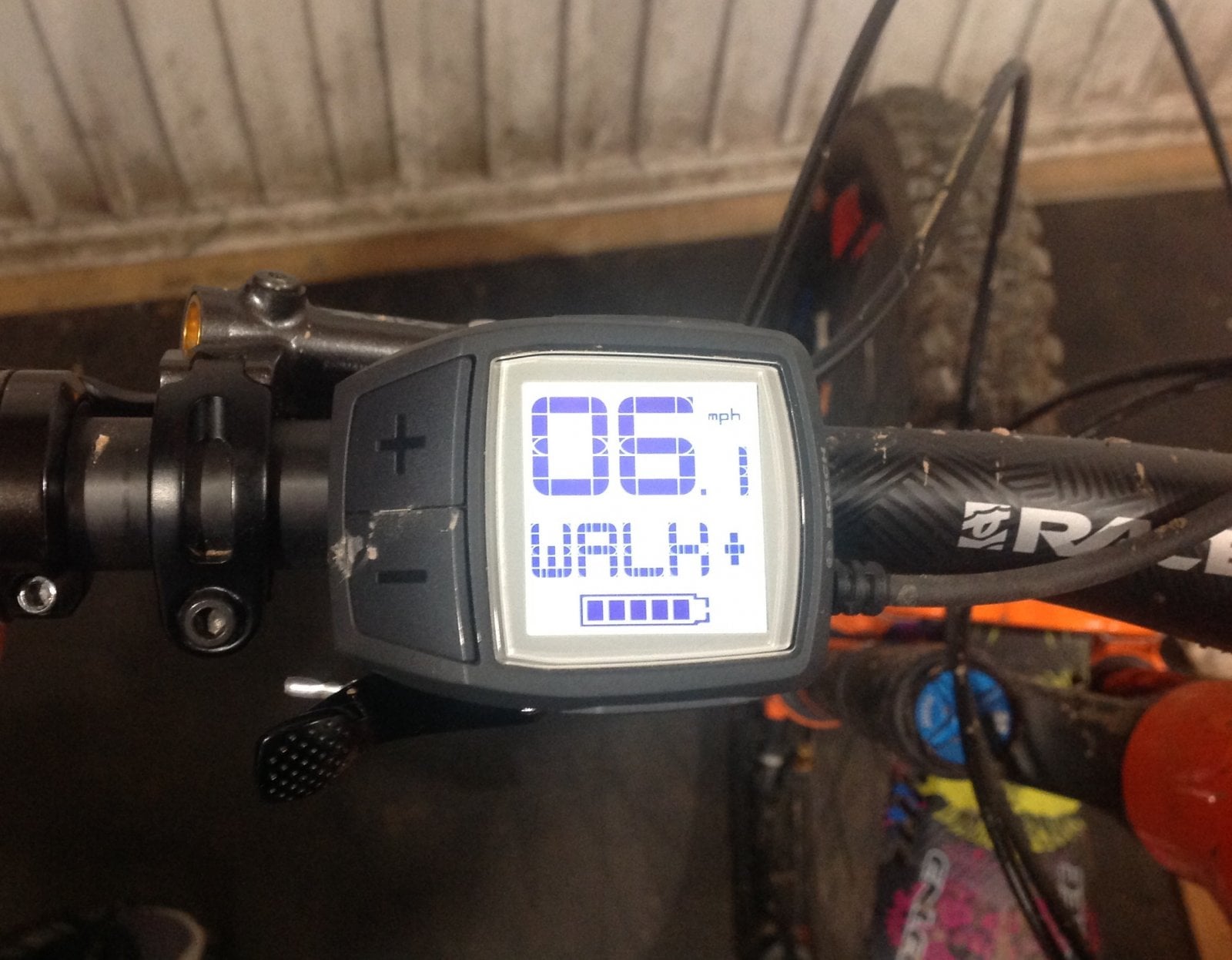

Then time to switch on -
And press the walk button which now showed 1.5 - which means 15 MPH
Press the walk button again -
And this appears 6.1 - which means 61 MPH......If you can peddle that fast.
I then took the bike out onto the street & broke the speed limit......as I hit 32 MPH
