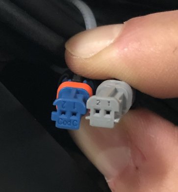

Hey guys.
Has anyone had problems fitting speedbox2 to Bosch active line plus gen3?
It looks as 2-pin connector is a different shape and I couldn't fit it...
I've bought my Cube touring one 2020 e-bike this year if it makes any difference

Hey guys.

did you check that the gen3 motor was supported by speedbox????
Yes I did. gen2 and gen3 are supported. I've actually contacted them directly with the same photo as above and they confirmed that for some reason Bosch Active Line changed the shape and suggested to cut off the plastic bar from the right hand side on their connector manually.
They said that it's not gonna affect the warranty, but as I bought the item from ebay - I'm not sure if I'm going to modify it or return back to seller and buy again directly from speedbox website asking them to make that adjustment.
