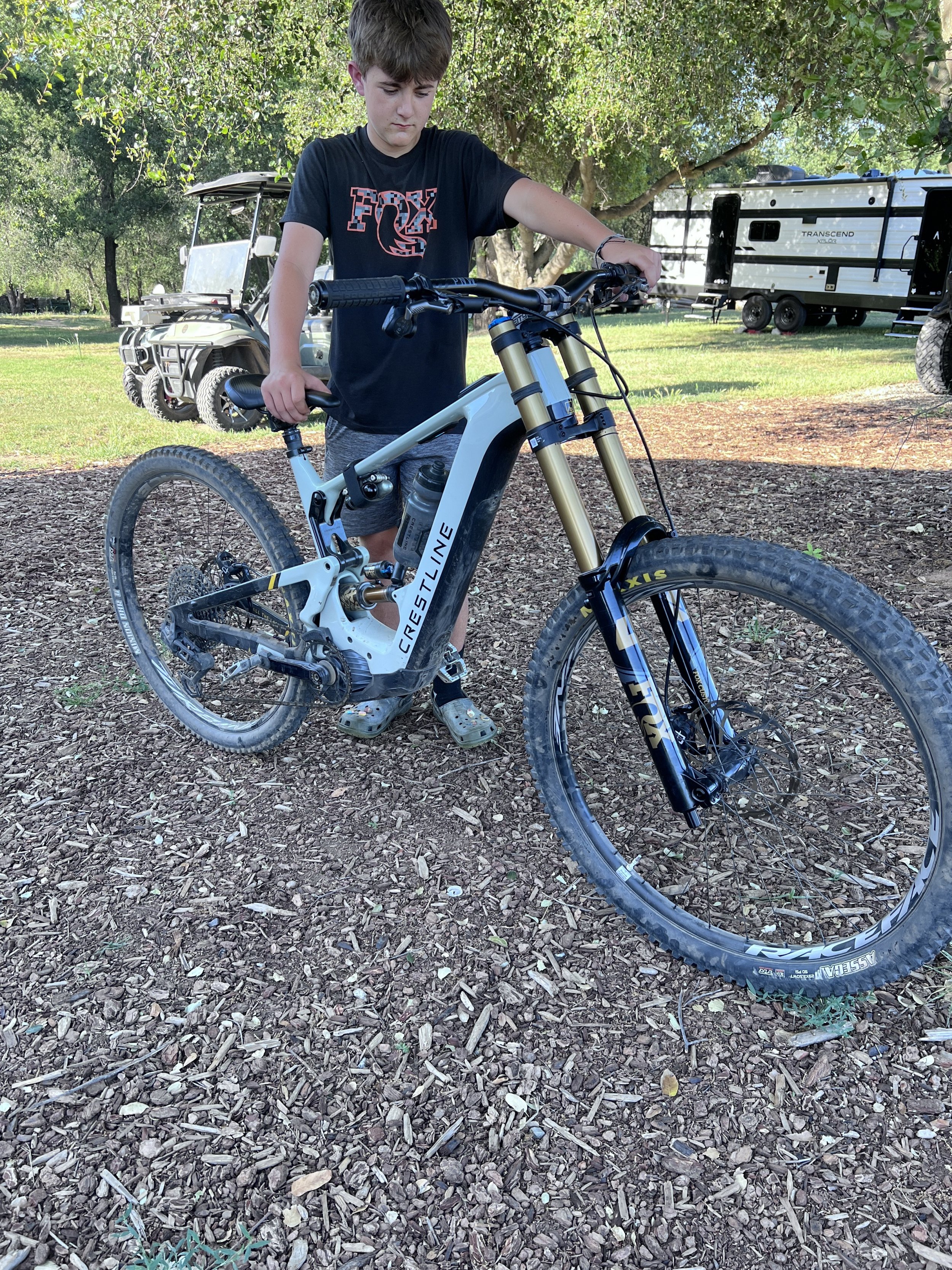

Anyone running a fox 40? I put one on and immediately felt weird. Went back to the 38. Just curious if anyone is loving the big squish life? To me the bike feels alive with the 38. I have a kenevo on 29ers and fox 40 and it feels good. This bike is amazing though!

That 200mm/40 should only be 10mm higher front end than a 180/38 so .4⁰ slacker head and seat angle and 3mm higher crank axle. Id take the added stiffness and 20mm as long as the turning radius wasnt messing with me
I am running boxxers and the turning radius is a bit annoying on occasions but I can live with it. I have never tried 180 38s but I am keen to compare but not willing to pay the price of experimentation so I will have to live with the verdict from the interweb🤣
I tried a dh38 on mine, it made it dead, lifeless and the turning circle meant it was an immediate no.
Have an intend flash now, wouldn't bother with a dual crown ever again.
Ok that's one against a duel crown. Pretty emphatic no that one. Personally reasonably happy with boxxers but the grass always looks greener on the other side of the fence
Yeah the steering was a real bummer, I could probably cope with the other negatives.
Just try all the things on your bike is my recommendation 🙂
Running 200mm 38mm Boxxers on mine. Absolutely epic, best suspension performance and tracking ever. Steering restriction has made me a much better rider as I'm looking for high lines on entry. Now I never hit the steering lock.
You can count on one hand the number of dual crown certified eBikes, so don't miss out on this superpower 😁
New Boxxer is also a lot better than old one, it has great mid stroke support.
