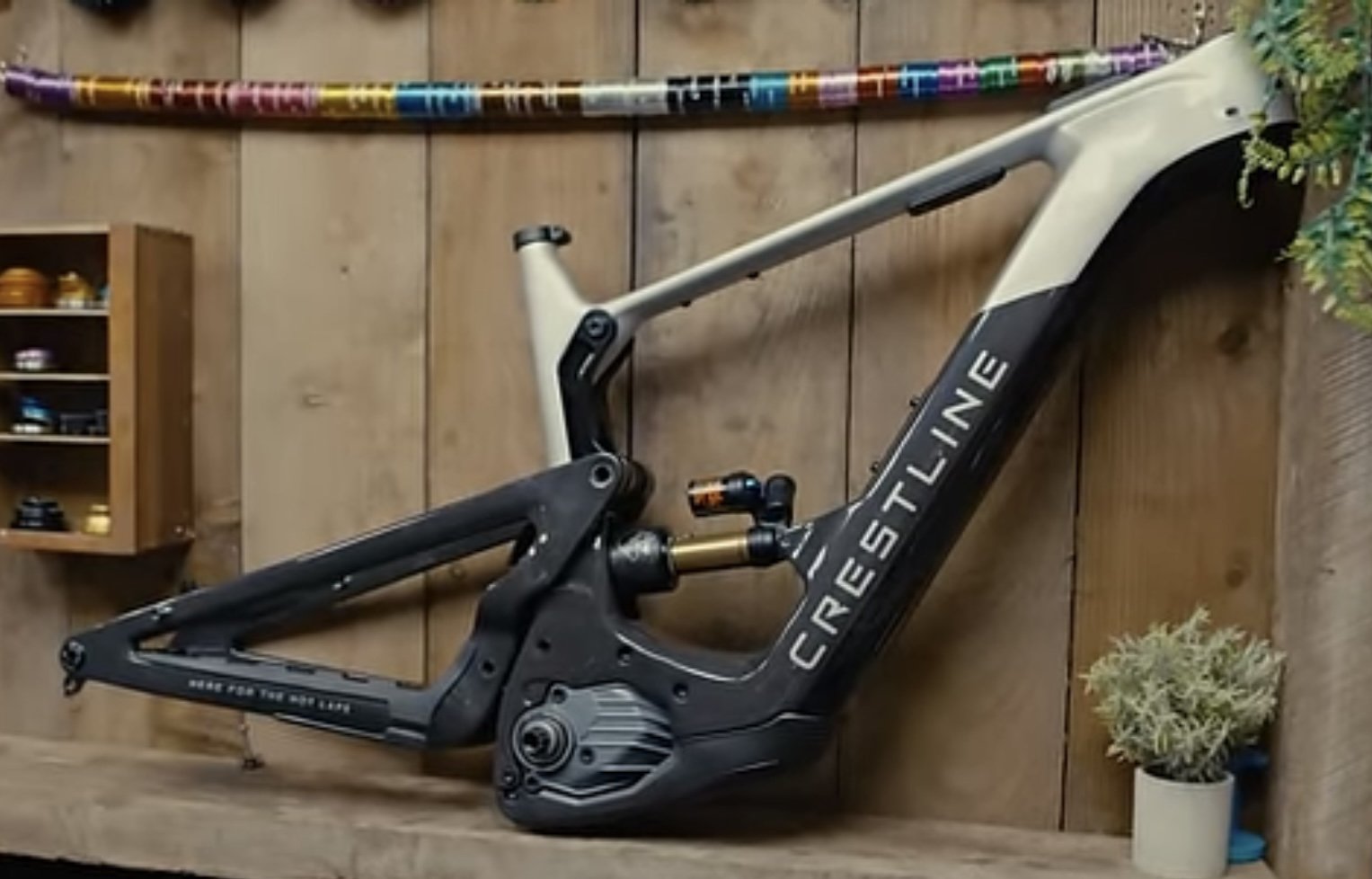

I'm a bit grumpy about Crestline after sales support...
Since day 1 I have had headset clicking issues. I kept tightening it and it would go away for a while then come back, so I dropped the fork to investigate. The lower cup dropped right out. Sticking a Vernier on there showed that the frame had been machined 0.2mm too big in all dimensions (i.e. round, not ovalisised). After asking for support we agreed to epoxy bond in a works headset which Crestline paid for. This worked for a handful of rides then the problem came back and the steering felt like a bag of spanners.
The solution I was offered was a bespoke machined larger diameter cup to suit the frame. This would have stopped me having future reach/angle adjusts, so my request was to post the bike back to the factory and have a new front triangle built onto it and returned.
I was refused this and pointed towards the warranty T&C (which incidentally didn't even exist when I bought the bike). In fairness to Crestline they posted out a new front and rear triangle very quickly and as a gesture of goodwill sent the 180mm rear link upgrade (zero hardware though, which would have saved me loads of build time).
So why am I grumpy... I never felt comfortable taking on this rebuild but I wasn't given any other option. I am 4 days into the rebuild and £300 down in expenses (ride wrap, new headset, headset press, Bosch motor TP40 bit).
Maybe I'm being unreasonable, maybe my mechanic skills should be better, I'll let you judge.

Did you get an entirely new frame for free? With the upgraded link? Also didn’t you just switch over the hardware from your current frame? I don’t know if I am reading that correctly I’d be pretty stoked on the time and few hundred bucks to be rocking a new frame. I guess I need to go get my calipers to check my headset!
Why would you want to swap frame if yours works?
Wait are you asking me if I’d like to swap frames or why would one want to? I’d be interested in a swap maybe.. I have one of the original black ones with 1000 miles on it
I had a similarish issue with a YT jeffsy frame where one of the frame bearings just fell out when I went to inspect it after 6 months. I sent a video, they told me to ship the bike back to them and they replaced the frame in under 2 weeks. That was a 2.5k bike. At 4-5 times the price, I would expect at least the same level of service...
Let's not be trying to find reasons to get new frames folks it's not about that. If you have a genuine issues then troydon will help has much as he can, if your in the UK and need spare parts then troydon will more then likely send you to me for bashguards and frame protection and I will also help in anyway I can to get you back riding again.

This is interesting because I too have headset clicking, all summer long. After messing with it for awhile, tighten-retighten, removing the fork, cleaning and re greasing all the bearings, the clicking went away for one or two rides then came back.
I contacted Troydon about it and even asked if anyone else had issues. He said to purchase new top and bottom bearing sets and try that. I now have the new bearing sets but haven’t installed them, figured I’d wait until I service the fork. And honestly these damn Bosch motors are SO noisy with the rocky terrain I ride, I have that to keep me irritated…….why not have a clicking sound along with a rattle sound, along with my ear buds turned up to drawn out some of it all. Thankfully Crestline is just flat out a bad ass emtb that’s more capable than most! This makes all the noises and a derailleur system(instead of gearbox) more tolerable! I’ve found Troydon’s service to be top notch, he has even answered one of my calls while he was actually riding his bike(talking to me through his hands free ear buds).
Be thankful you got the 180mm Cascade rear link free, I paid the $300 to give my Crestline 180mm rear travel over the original 170mm!
I think Crestlines response is perfectly fair and reasonable.
Did you contact works components for a price on a custom headset cup?
No I haven’t, nor was I aware of that option.
I will install the new headset bearing this winter when I service the fork, to see if that does the trick.
I’m not running any angle adjustment or offset. But I am at 190mm on the fork with high stack and 40mm riser bars.
