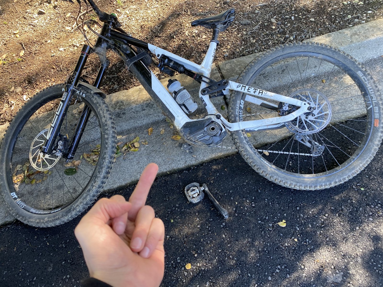

Well, you guys warned me. The big top cap bolt fell of and then the threads inside the crank arm stripped. Going to look for something better to replace the e13 stuff with, but not sure what is compatible or even in stock.
And unfortunately this happened right before a sizable double which I cased super bad and severely bent my handlebars.

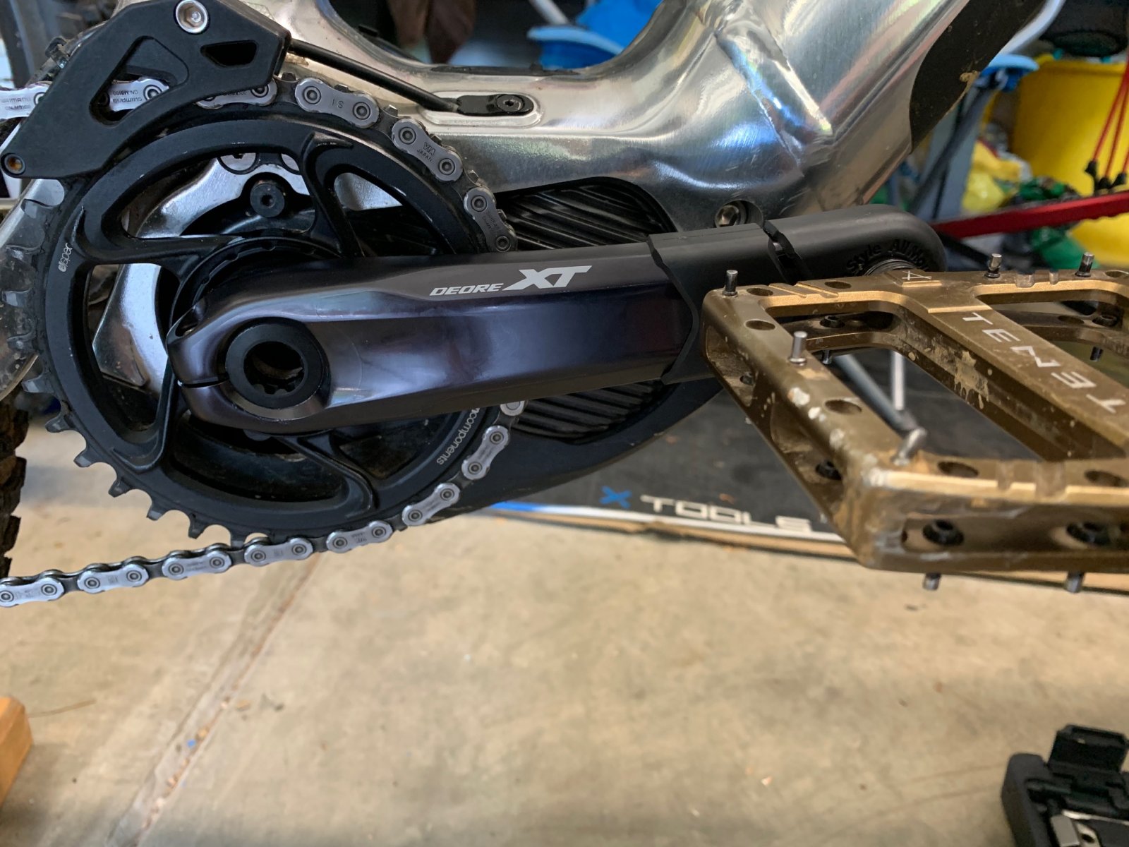

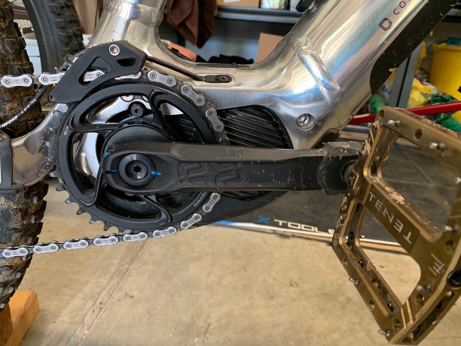

Until my Shimano cranks arrive, 6-7nm on the cap, and 16+ nm on both pinch bolts (alternating from 12-14-16 from inner bolt to outer when tightening). Also marked cap and bolts so have visual reference if they start to loosen on the trail. Too many instances of fellow MTBers getting hurt when the e13s have come off. Not gonna risk/deal with it.
UPDATE --> OK to WAY BETTER. In all fairness - once the e13s were (over) torqued, they did not move much... but, started to creak a bit (which isn't confidence inspiring). Ultimately the fit just isn't that great, and the torque specs are basically wrong... so be careful out there. Shimano XTs on now - peace of mind acquired. I used blue marker to visually let me know if the e13s were loosening. I looked and checked this habitually before every big send which ultimately is not the best way to prepare yourself...
View attachment 62099View attachment 62100
does the oem chainring work with the XT cranks? got XT 165mm waiting to install.
Absolutely. Works perfectly. Be sure to align the gap in the end of the crank arm with the drain hole in the EP8 spindle (will fit 180 degrees out which blocks drain). The plastic ring/shroud on the e13 drive side crank doesn’t fit the Shimano crank - and it’s not needed. Works great, looks great.
