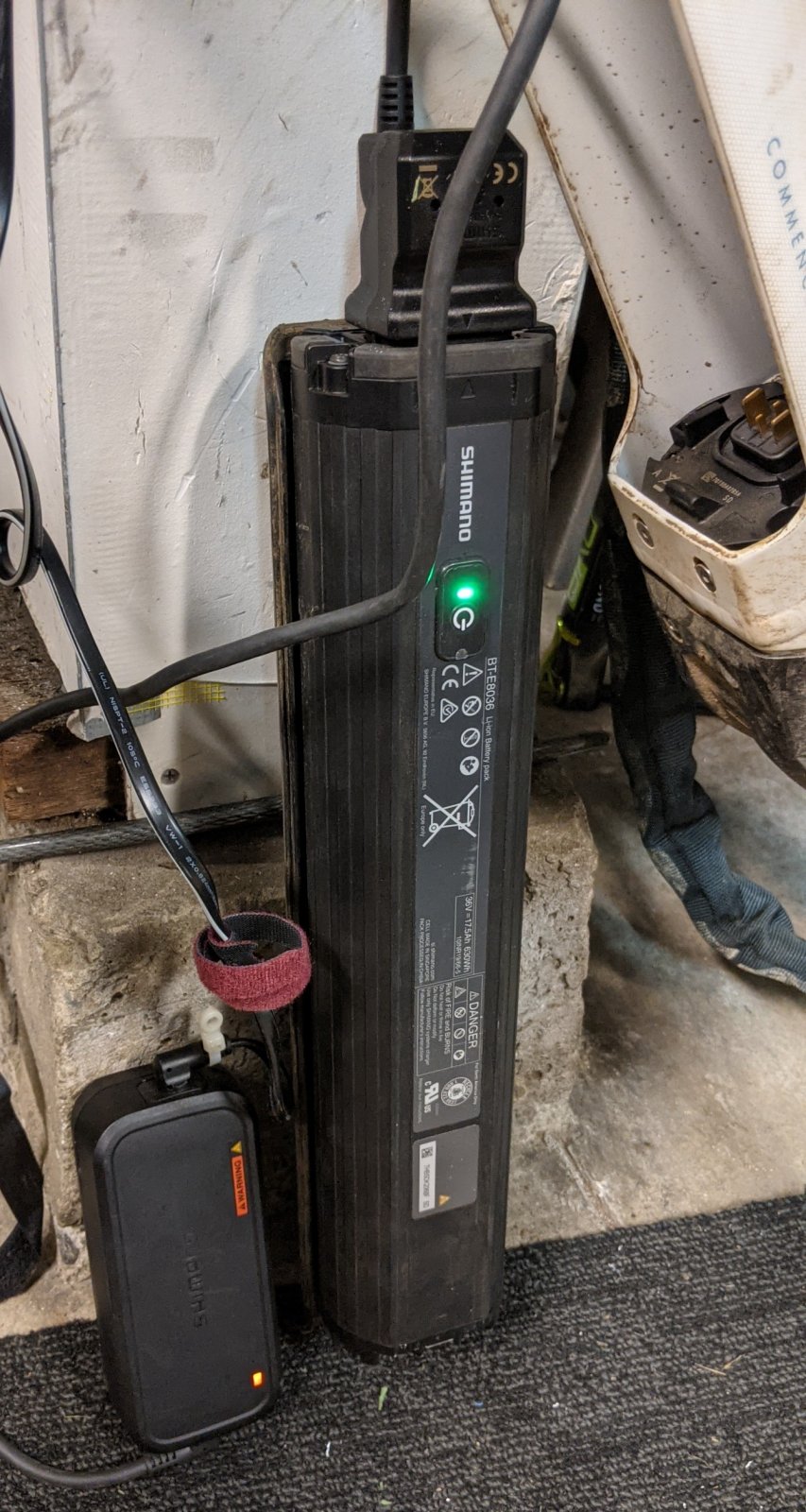

in other news I finally received my off the bike charging adapter ordered from Japan in September via surface shipping to the USA! super duper extra unobtanium part. it works.

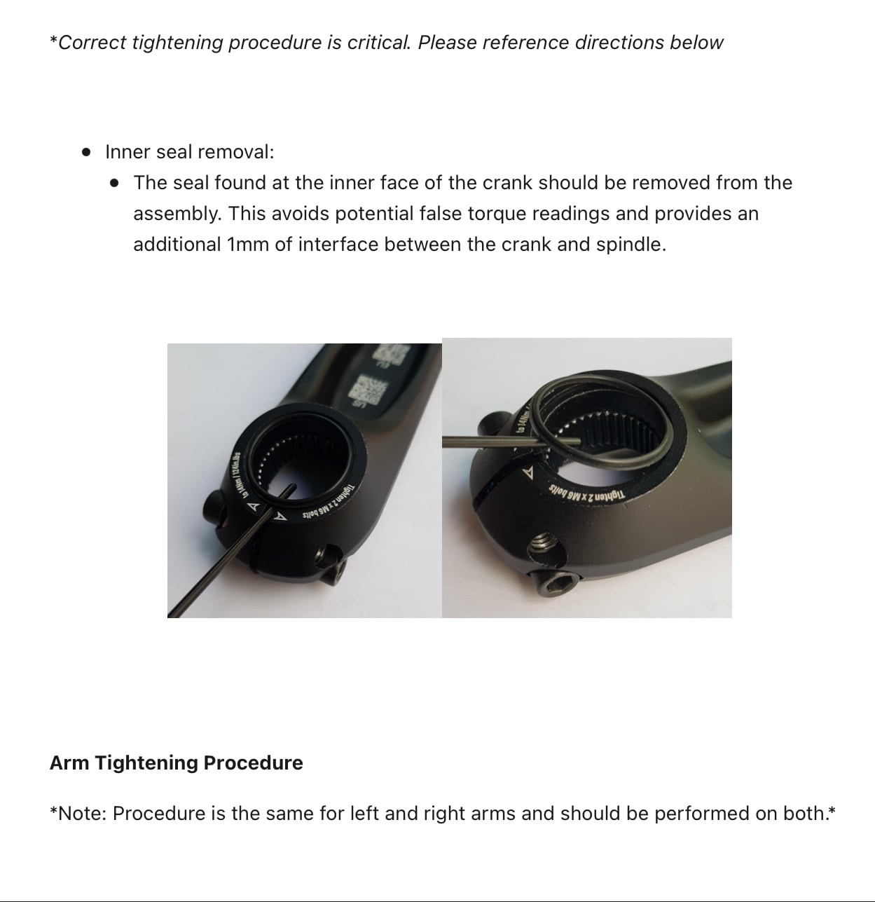

Guys, we have an employee from E 13 active on this forum, that has answered our questions regarding this issue. They have written up a document on this and also discussed with us on this forum what their current recommendations are. If you have any questions you can try and ask them on that thread and tag their user. See the links below:
Their official documentation for this product/issue:
The thread on this forum related to this topic:

Anyways, back to the documents, early in the TSB 156 document, it mentions to remove the inner seal as it takes up a 1mm space in between crank’s inner face and the spindle.
That’s rather interesting! Has anyone done so to their assembly?
I have not removed the inner face seal. Honestly I didn’t see this directive until after I (over) torqued and marked the caps and pinch bolts as described above.

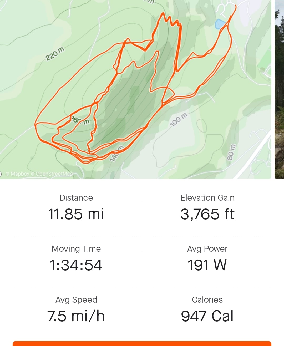

Just wondering what sort of elevation and distance yous have been getting, 2nd outing on bike using trail mode, just a few times on boost for small hill, I was just down to the last bar of the battery,
