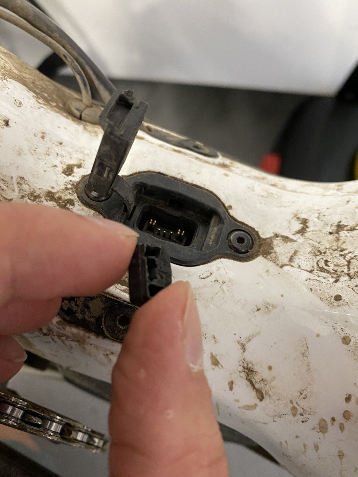

Oops. Hopefully I can get this replaced so I can charge my bike.

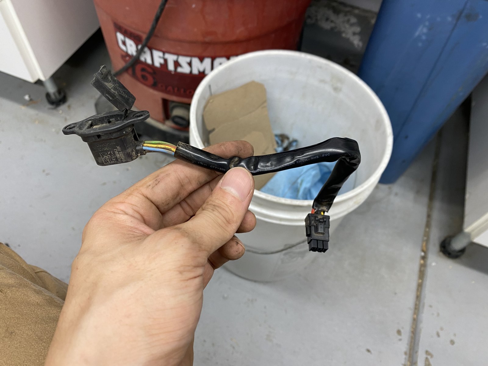

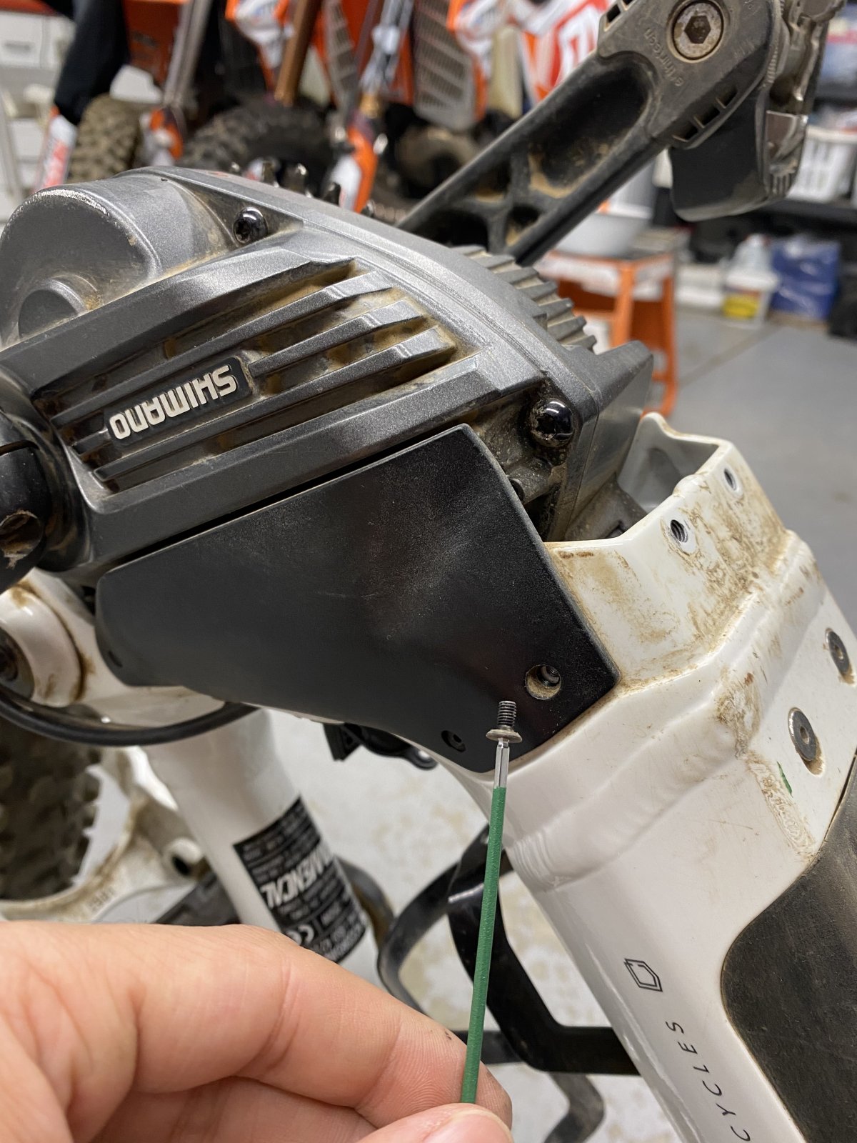

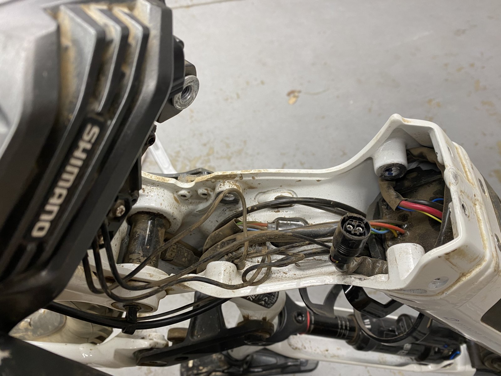

Took about an hour to replace this guy. I hate how you have to remove the chainring to remove the motor. And my E*13 chainring needs a special tool to remove. (Maybe all chainrings for EP8 need it?) Also don’t like how the plastic skid plate covers some of the motor mounts. Two of mine were finger tight, and I never would have known because I cannot see them or access them without removing other parts.
Why does Commencal love to use teeny tiny bolts?

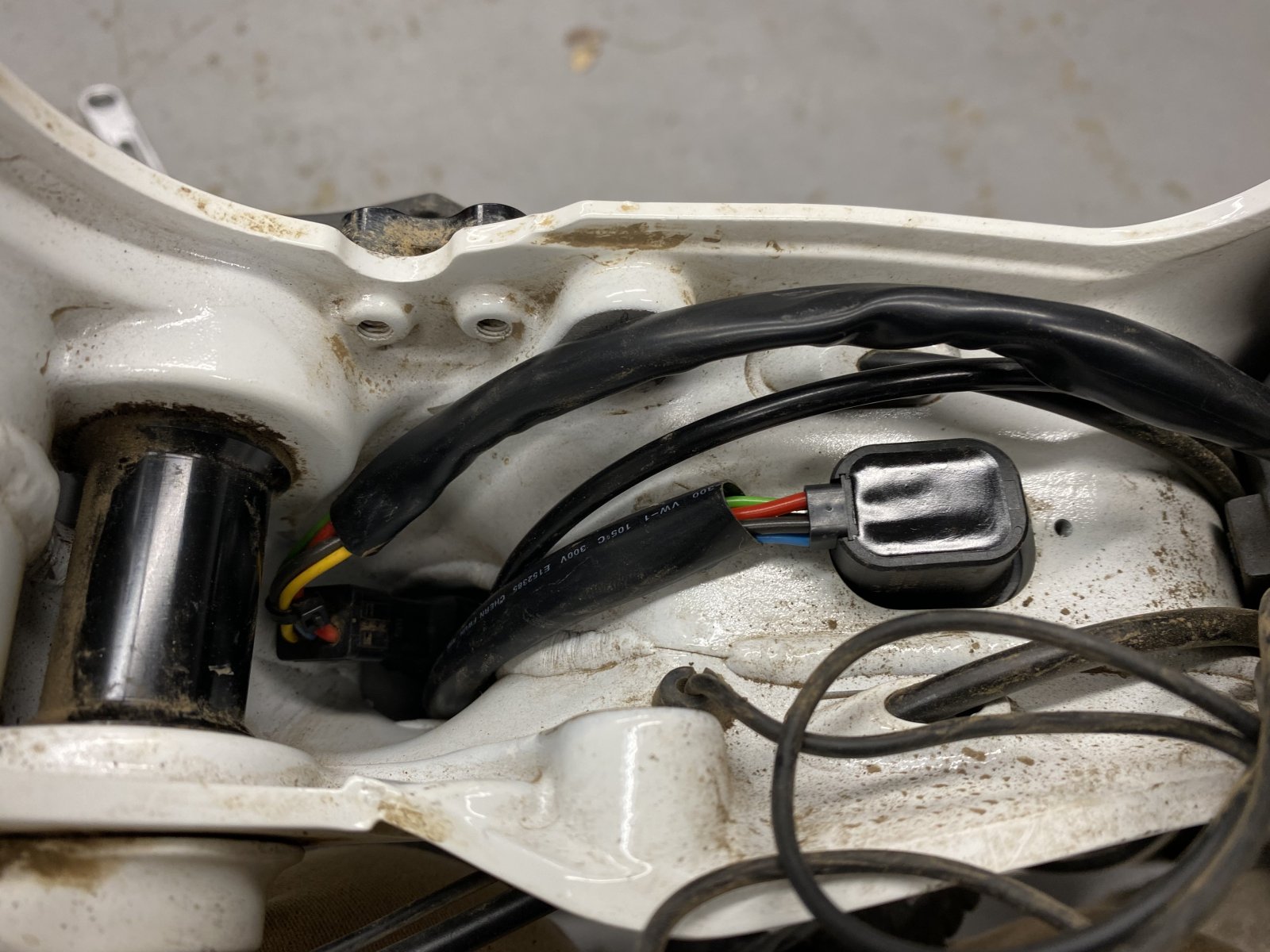

Getting the motor out of the frame was not easy. Got out the rubber mallet and still no luck. Had to pull out a moto tire lever and pry from the bottom. Lol. The charging port cable was looped and shoved up the seat tube. Other cables were a mess compared to other ebikes I’ve seen. Remember to unplug your power cable before yanking the motor out, I speak from experience. Lol
New cable installed and and ready to go. All bolts installed with loc-tite especially the torque cap on the cranks.
Awesome - thx for the pics. I’m gonna check my motor mounts. Noticed a little creak when I start to put the power down. That tool to remove cranks is specific to Shimano motors I believe, not e13 specifically. Glad you got it sorted!

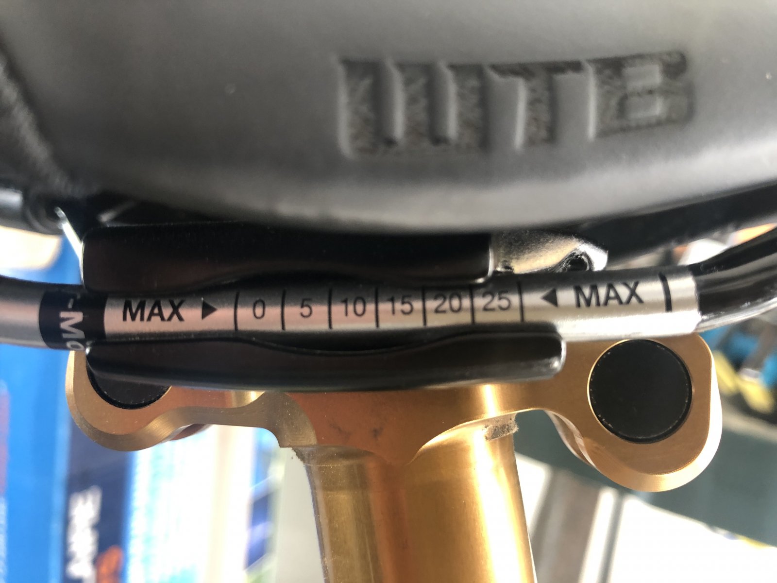

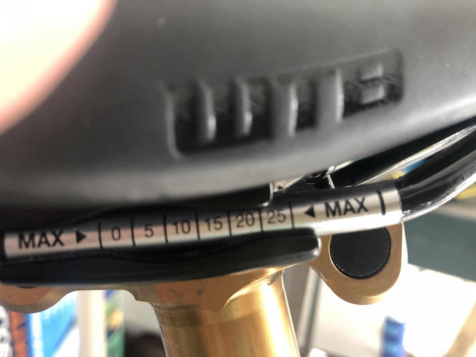

Check your seat clamps! I was riding my MetaPower (Signature) today down a fast sweeper when I heard a loud metal CLANG. I thought Wtf was that? Well I Iooked back to see my seat and both clamps sitting in the middle of the trail! Damn thing just popped off. Luckily (!!) I was up on the pedals at the time, coming down hard on the bare seat post would NOT BE GOOD. Holy crap.
Doesnt this top clamp look too small? Severe angle needed for the front screw to fit, which I think is why the seat popped off in the middle of a ride.
