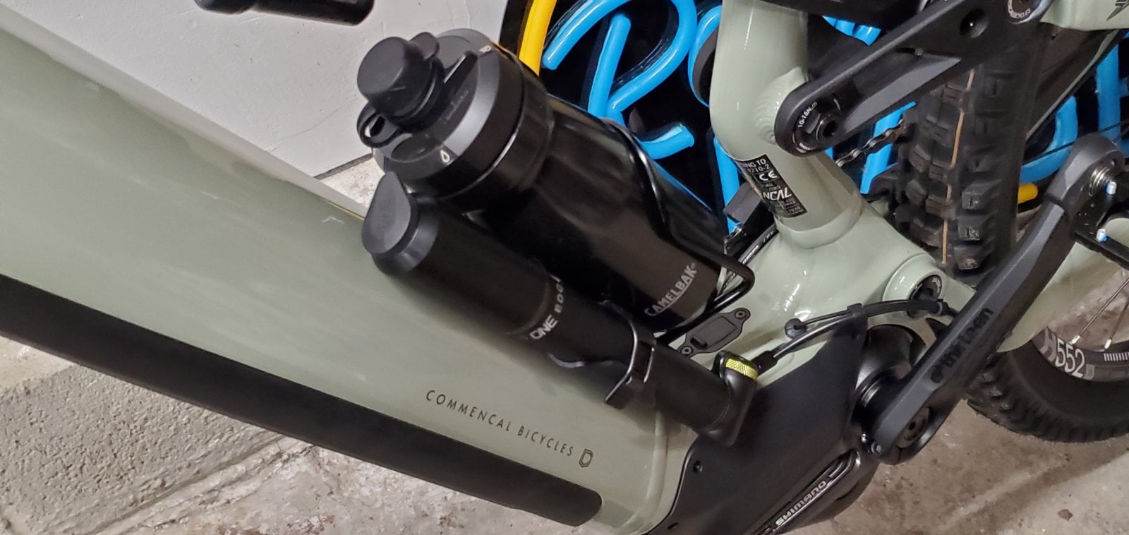

Also, installed a 1up 100cc pump and toolkit. Been riding on and off for almost 20 yrs, trying to go bagless for the 1st time ?, had to cut a few m6 bolts down to fit the water bottle bracket, stock bolts were too shallow and the one 1up supplied hit the battery in the downtube.

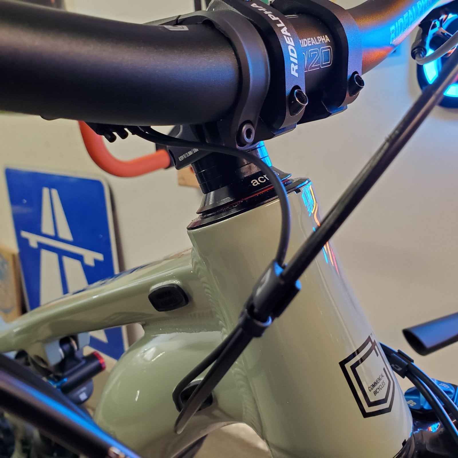

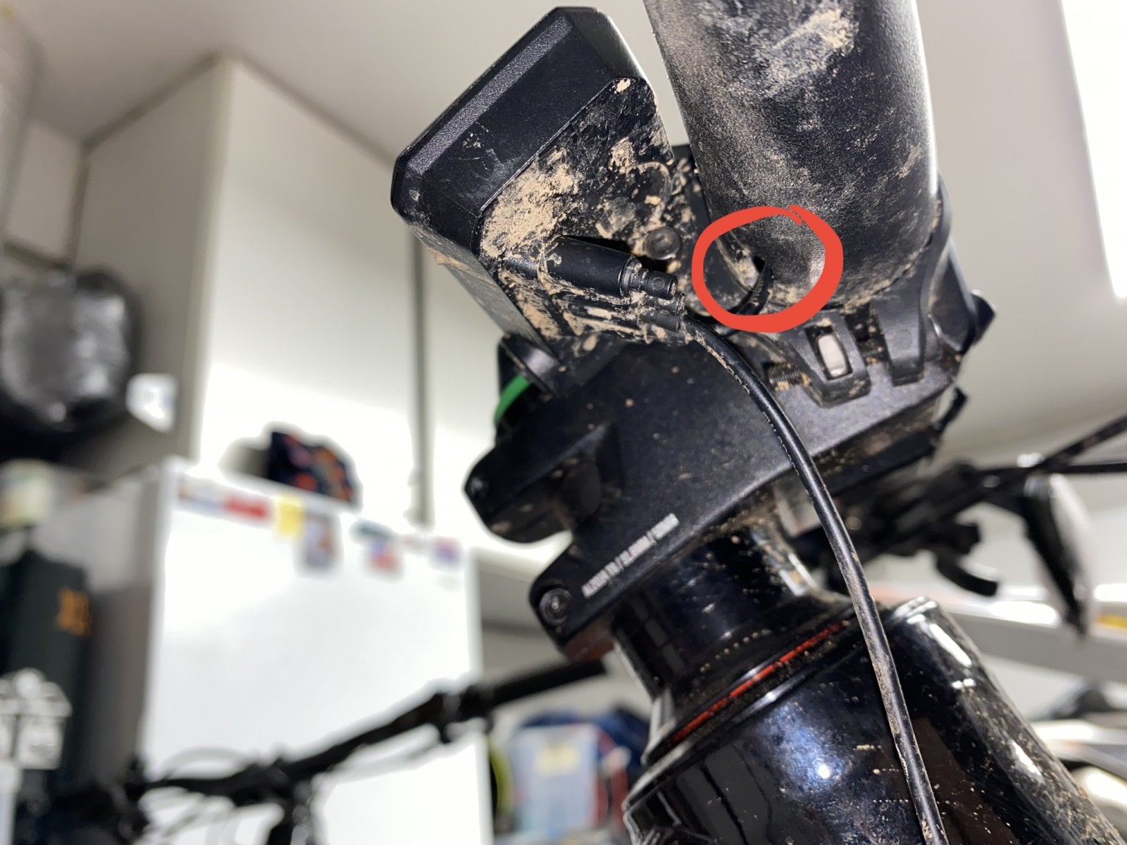

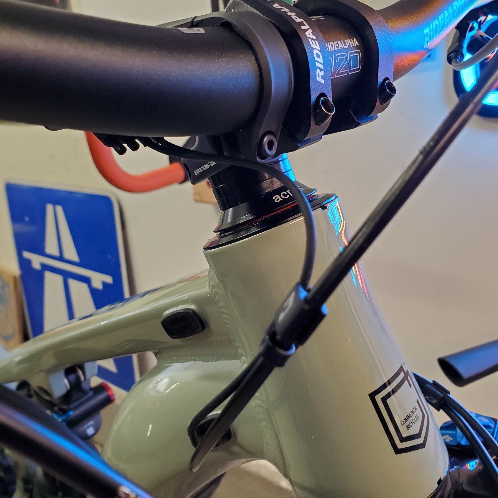

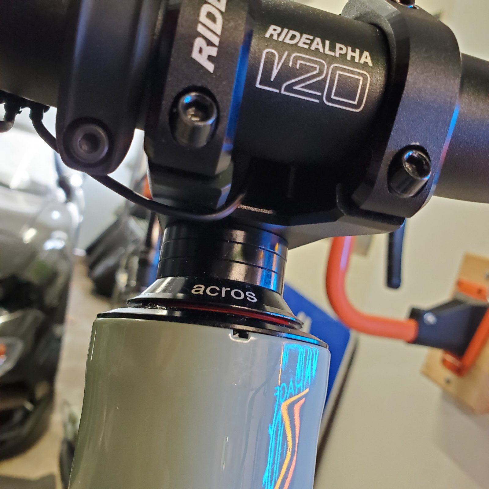

Is this routing to the display, and through the stem correct? Or is there a channel or routing to run that wire actually inside the stem clamps? Doesn't look as clean as I'd like TBH, with the wire just hanging like that. The manuals that came with my Meta 29er are from an older model, just trying to figure it out.
The cable that runs to my motor goes into the frame with the shifter cable housing. The cable the goes to the thumb switch goes straight into the hole in the bars. Neither are running under the stem.
Thanks, There's 2 wires that come out of the display, one of mine goes with the shifter cable and into the frame on the downtube. The other wire was coming out from under the stem when it was shipped. So there's no wire coming out under of the stem on your bike? Where does that 2nd wire from the display go? Just to clarify you also have a '21 Meta 29?

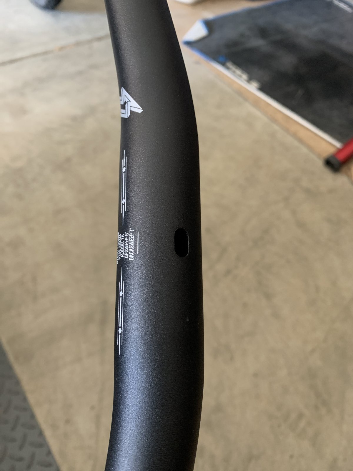

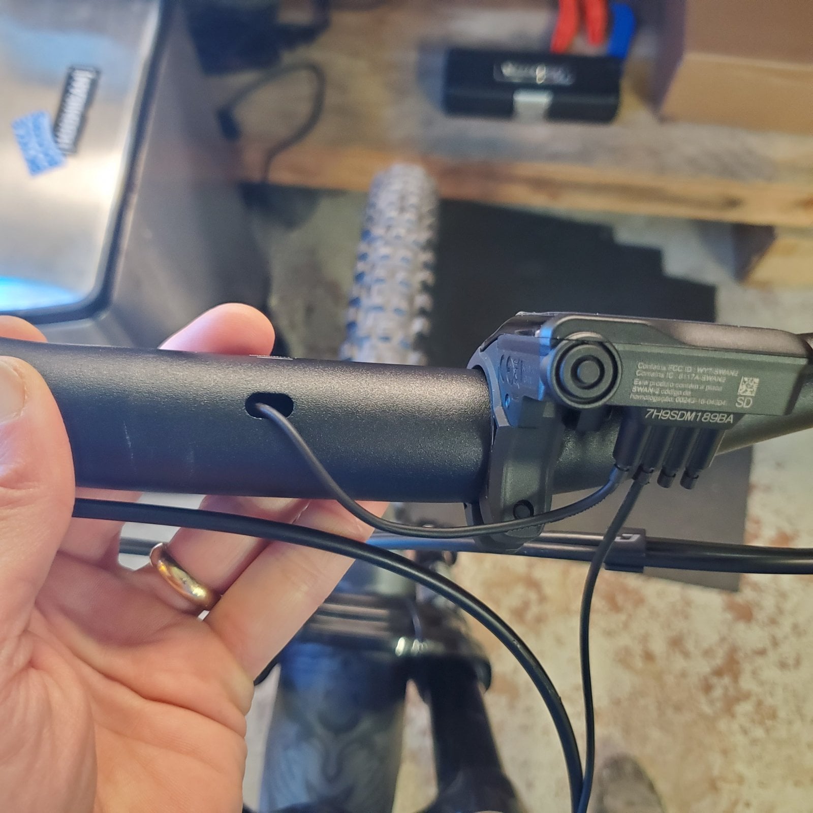

I have a hole in my bars the cable runs directly into.
Ah haa! I just checked I do not have a visible hole like that. According to website spec sheet on the 29 Essential, I should I have the "RIDE ALPHA R20 E-Bike 31,8 mm, 780 mm width, 20 mm rise, Alloy 6061, electric wire internal routing".

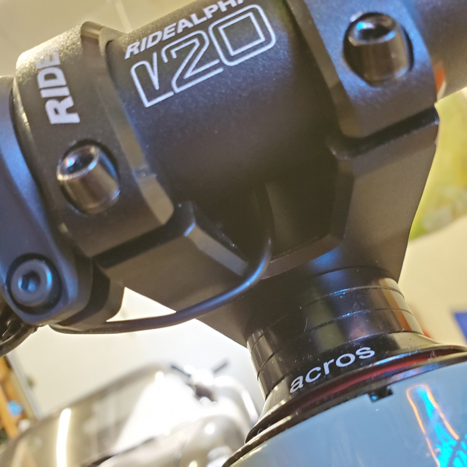

From the website, all the handlebars on every Meta 29, 27 are the same R20, you're saying yours has a hole, I definitely have to re inspect mine. The motor shifter, on the left side is all internally routed, then under the grip in a channel in the bars, I'll take it fully off and inspect the display/stem area more, worst case I can drill a few small holes to run the wires cleanly. Thanks again.

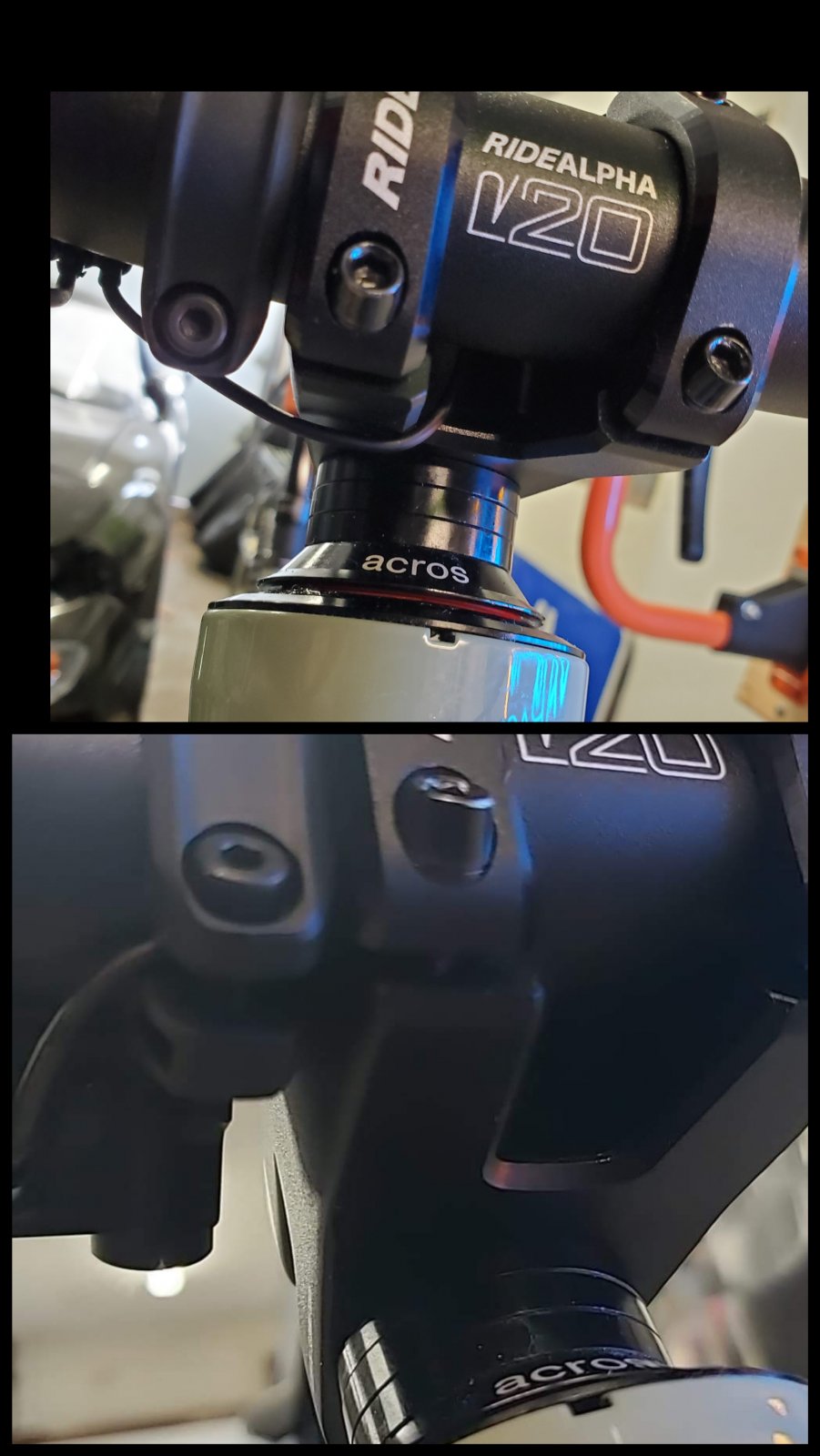

Edit, I only have the 1 larger central hole into the stem, definitely no smaller hole like you pictured, I'll try to re route wire under the display bracket bolt.
Managed to route wire under bracket and the lower stem bolt had a small gap when torqued. Before and after Polish_20210312_101531838.jpg
That’s strange the hole placement is different on our bars.

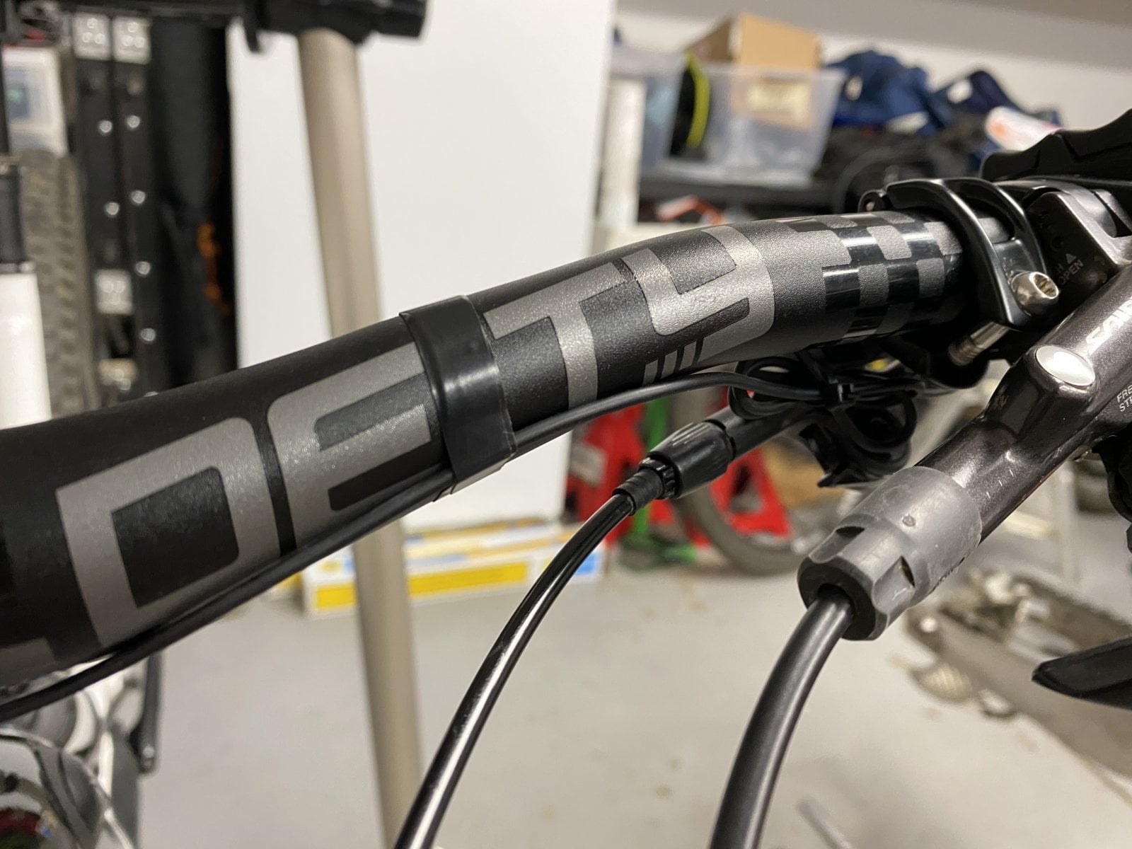

I swapped out the stock bars for some Deity Brendog’s and this is how I routed the cable because I wasn’t willing to drill two holes in my bars. Made a few small loops and secured behind the dropper lever, and then secured the cable to the front side of the bar with a half-width piece of electrical tape. Looks clean enough from the rider’s perspective, so will just call it good.
I swapped out the stock bars for some Deity Brendog’s and this is how I routed the cable because I wasn’t willing to drill two holes in my bars. Made a few small loops and secured behind the dropper lever, and then secured the cable to the front side of the bar with a half-width piece of electrical tape. Looks clean enough from the rider’s perspective, so will just call it good. View attachment 55854
OCD me would paint a silver I on the electrical tape ??

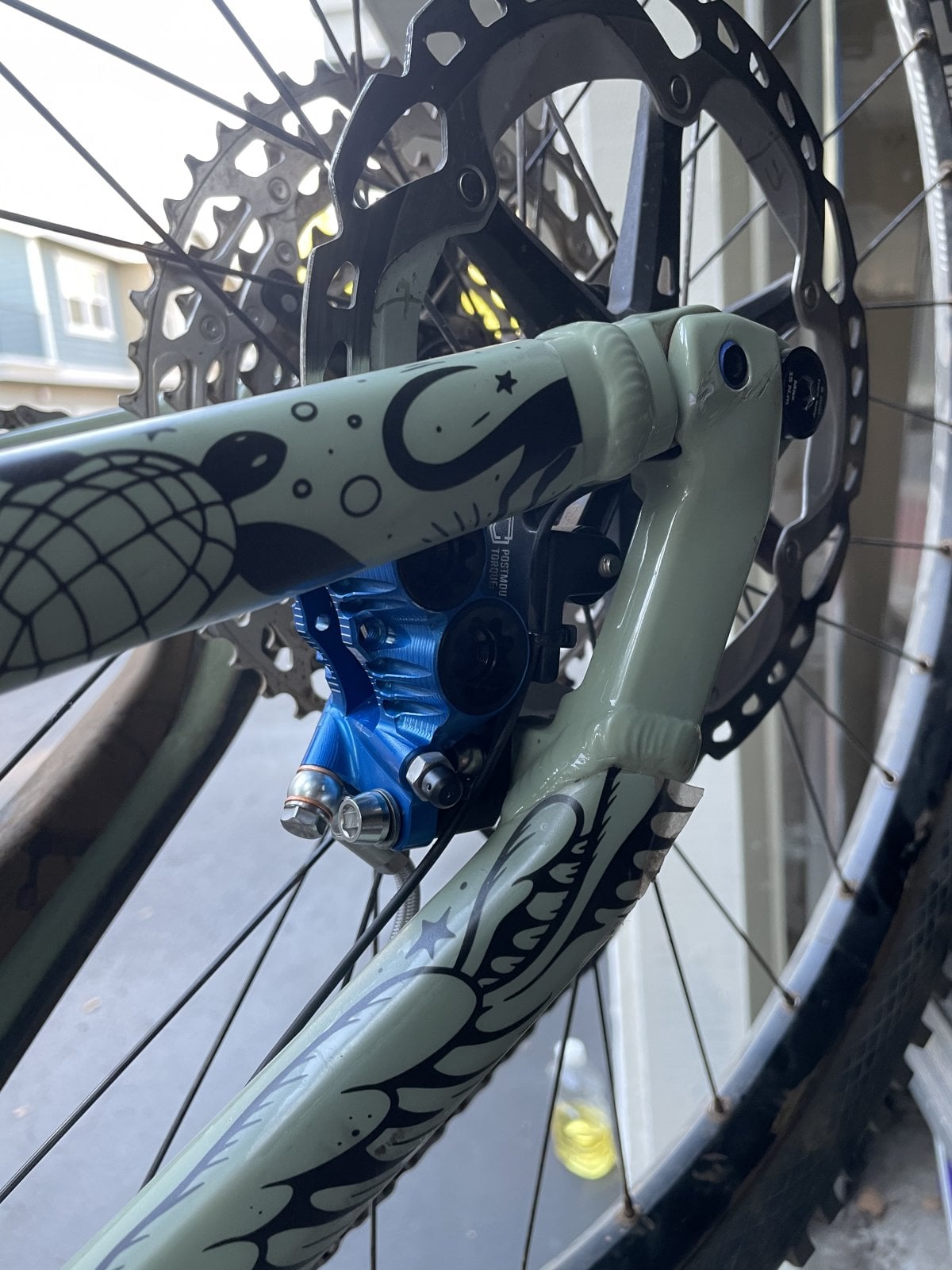

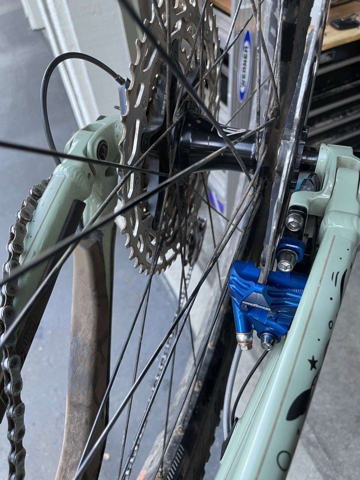

Anyone have experience installing Hope Tech 3 V4’s on the essential model? I’m having issues with the rear caliper not fitting because it’s hitting the seat stay too early.
I currently have the standard shimano center lock rotor (203mm) and the 40mm post mount.
Am I being an idiot and missing something obvious here? I was trying to install this in the blazing heat after a full day of routing the cable through the frame and was burned out.
Any suggestions are appreciated!
I had the same issue and Commencal confirmed frame is not compatible with Hope 4 piston caliper
