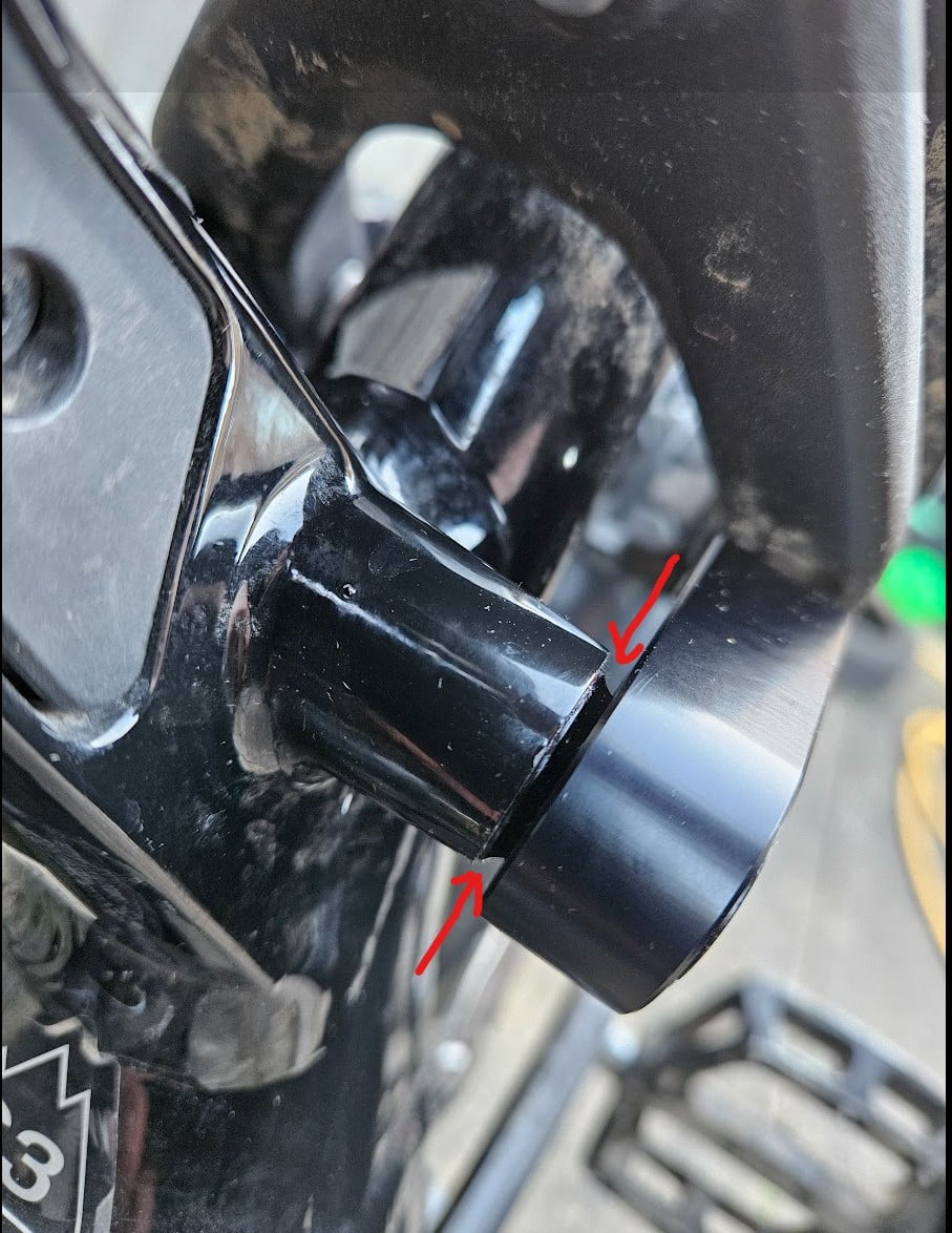

Replacing the link today, while removing the original link, I have 2 spacers dropped down and did not record where exactly they are coming from. From youtube instructions, these should be fitting on the most forward pivot, narrower side facing the bearing, could anyone confirm pls, as it looks quite weird to me, ie having a "gap" between the fixning point.
