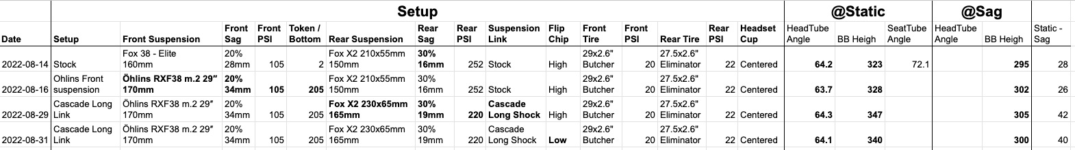

Its not so much the center of gravity but more like the geometry changes. BB gets higher, seatangle and headangle get steeper which will effect the handling of the bike and might make it less capable in some situations. I really prefer the low bb setting to the high with the stock link. That's why I asked cascade about the geo changes.
The bottom bracket is raised with the long link, the stock geometry is not maintained, but the bike works much better.
The seat tube becomes more vertical, which only has advantages.
The steering is closed, but this is very easy to correct with the angle-set of the Levo.

All you guys that run the cascade long travel setup, do you prefer having the rear wheel set in the or high or low flip chip mode? It seems like the long travel raised my bottom bracket up by quite a bit and I was thinking about running the low flip chip mode to kind of counteract it.
I initially put it in low to get a similar to stock height when the bike was in high before the long link. However, I recently changed it to high and think I'm going to leave it here as we have a lot of technical rock in my area and need all the clearance I can get.
Definitely better LOW for me
I didn’t take good measurements but is the chip in low still with a taller bb with the cascade link than stock linkage set in high?
In my measurements it was still higher in low but once you added proper sag it was almost identical
I ran lower for the last year, but in the last month, I switched back to high, and I think I like it better for my riding (I ride a lot of tech). I need the clearance.

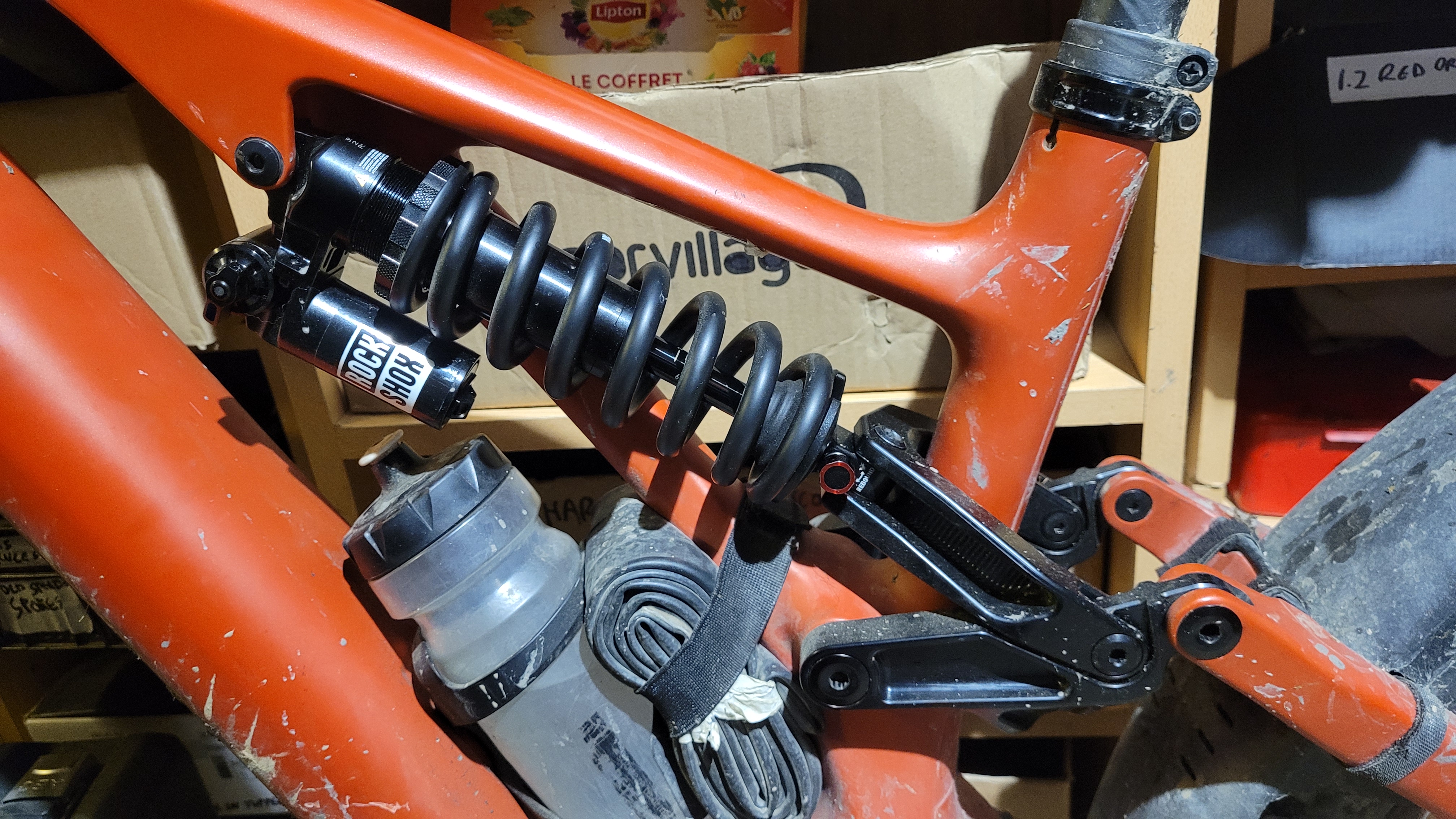

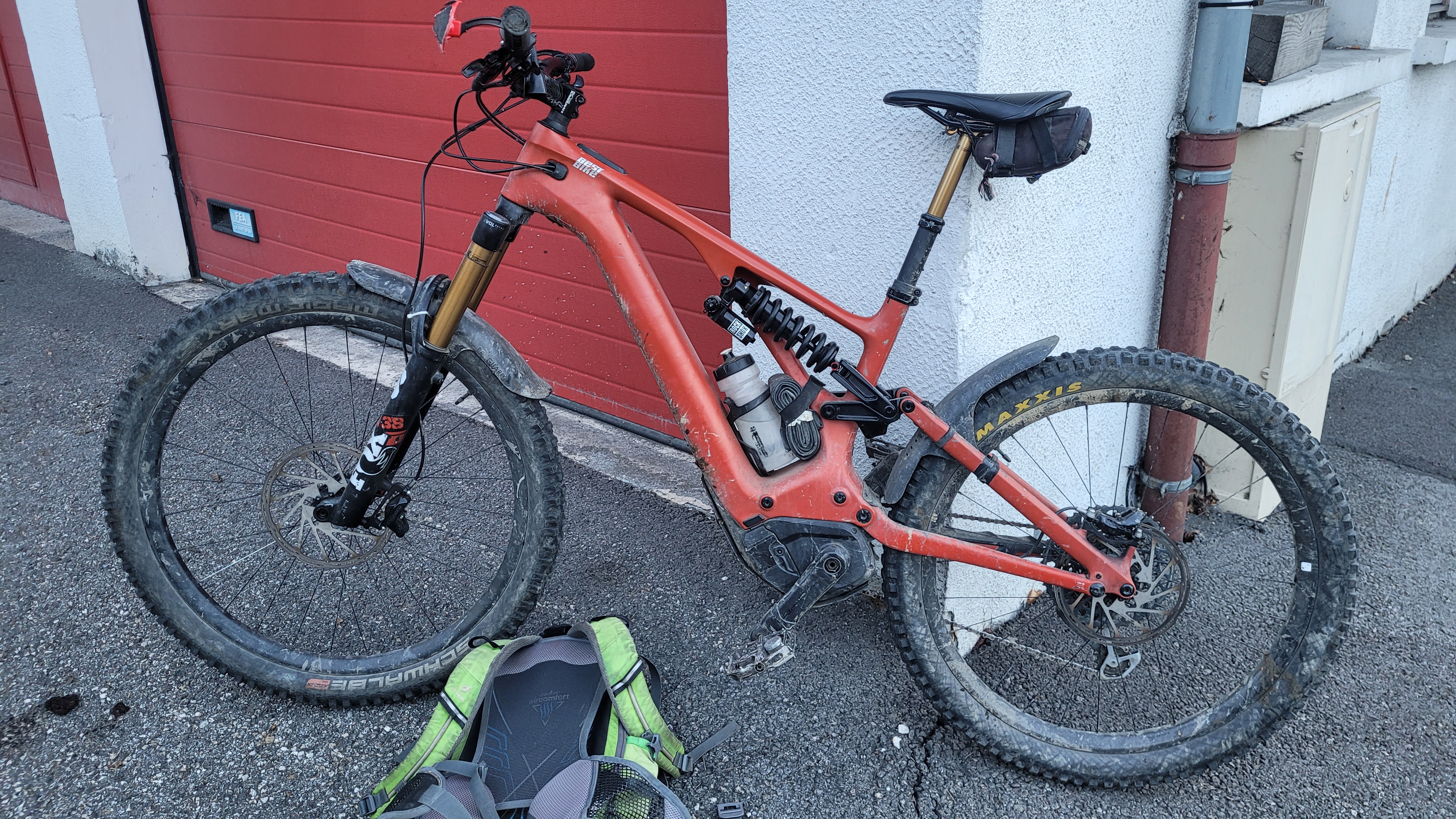

Just to add my thoughts to this discussion I fitted the long-shock link and I'm very happy with it. It's on a 2022 Levo Gen-3 Pro S4. I fitted the alloy version of the long-shock link along with a Rockshox Vivid Ulitimate Coil with HBO. I'm 105kg (yes, I know a fat bastard) and live in the Alps so I'm generally climbing technical single-track or blasting down pretty steep and rocky stuff. I have gone with a 550lb spring which seems close enough for now but I bought a 600 in case it was too soft.
I had previously fitted a Vorsprung coil kit and extended the travel to 170mm on the Fox 38 forks. I had always found them to be harsh and very hard to set up, even with a 170 airspring and, whilst they were much better with the coil, they were not as good as I'd hoped. I solved this by fitting a slightly higher rated spring, 55lb/in instead of the 50lb/in I had originally put in and by changing the bath oil to 5wt Fox Teflon from the original recommendation of 0w30 Rockshox and by not using any grease on the bushes, I'm now just relying on the oil splashing about. I also didn't fit the shrink-wrap to the spring as I didn't think a big lump of plastic sitting halfway up it would improve small-bump compliance and it didn't look like it would rattle in a fork as big as the 38 either. I was right on both counts.
With coils all round and a 170/165mm travel setup instead of the stock 160/150mm the ride of the bike is transformed at both ends without, it seems to me, negatively impacting stability or geometry. I can go at least 20% faster on the really bumpy, flat-out stuff, and the improvements in small-bump performance on the flats and climbs coupled with the much better mid-stroke support on single track makes it really very impressive. The bike is finally 'nice', not 'ok'. The rear end is way better than the stock link and Fox X2. The sag was around 28% when I fitted the coil, although it's hard to get a really accurate measurement, and no clearance issues, at least not on my bike. I more go on feel and may experiment with the 600lb spring to see what that feels like but for now the 550 is fine. It pedals very nicely, doesn't bob much and sits up nicely when going uphill. Downhill it just soaks it all up in a controlled and tidy way, like a downhill bike does - you just point it and let the machine soak up the punishment and think about your lines and braking, not hanging on to an out of control bucking bronco. The front end with the Vorsprung coil, lighter oil and no shrink wrap is finally nice, not harsh and constantly bashing my hands. I can probably tune it all a bit better but I found the Rockshox to be pretty good with middle settings, just a little up from middle for rebound. The HBO is on one click for now, I'll see if I need to wind it up for the bike park in summer. For now on alpine single-track and fast, choppy descents and steeps I'm very pleased and the combination of the coil fork and coil rear with revised linkage seems to be very harmonious.
So all in all very positive. Upgrading both front and rear was not cheap, close to 1500 euros and a bit of time to set it all up but, in my opinion, this turns the bike into the weapon it should always have been, not the poorly sprung, harsh pogo-stick it came as when I bought it. The Fox X2 had always leaked and whilst it was very reactive, it would never really sit at the right sag when climbing, even with two tokens, and it always seemed to chew through 60% of the travel just with the weight shift due to the climb - or maybe that is somewhat the link/coil combo that has improved this? The two conversions have added probably 1.5kg to the bike but at a porky 105kg I can always go on a diet if this bothers me and not drinking beer is a lot cheaper than trick components! For an e-bike, it really isn't an issue and coming from dirt-bikes that weigh 105kg (and that's for a light two-stroke, more like 125kg for a four-stroke), 23-24kg is still very light to ride and weight does tend to make the suspension work well if you're not too bothered about doing tail-whips in the air. My days of tail whips, rather like my days of elegant dancing, are now sadly long gone...!
This has been my experience, anyway. I hope it's useful to some others who might be thinking about this conversion...
Can't exactly agree, yes, when bike is on a parking lot, unsagged, BB is higher, but during a ride, dynamic SAG is quite similar to standard Levo, and during full compression BB should be even lower than in standard Levo.
depends what you are after.
For more than a year I run it in in long CS + 29" at the back, why? to move BB higher - I have a lot of techy trails with pointy rocks.
However a few weeks ago I put 27.5" back again and put CS in short position - unsagged BB is ~5mm lower now,
the bike is more manouverable and fun on some trails I currently ride - fast, but twisty, not too many rocks - way better for that type of trails.
