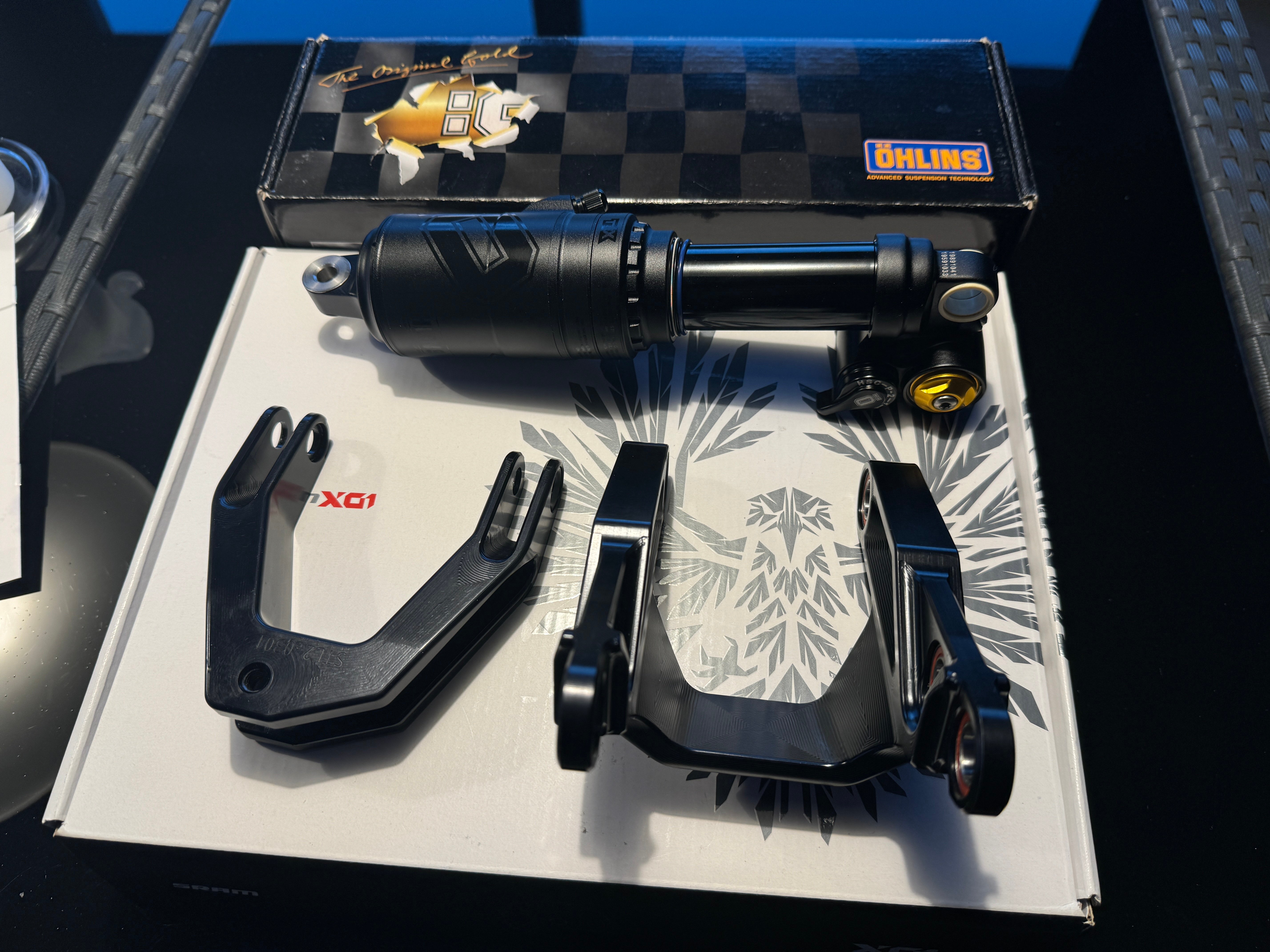

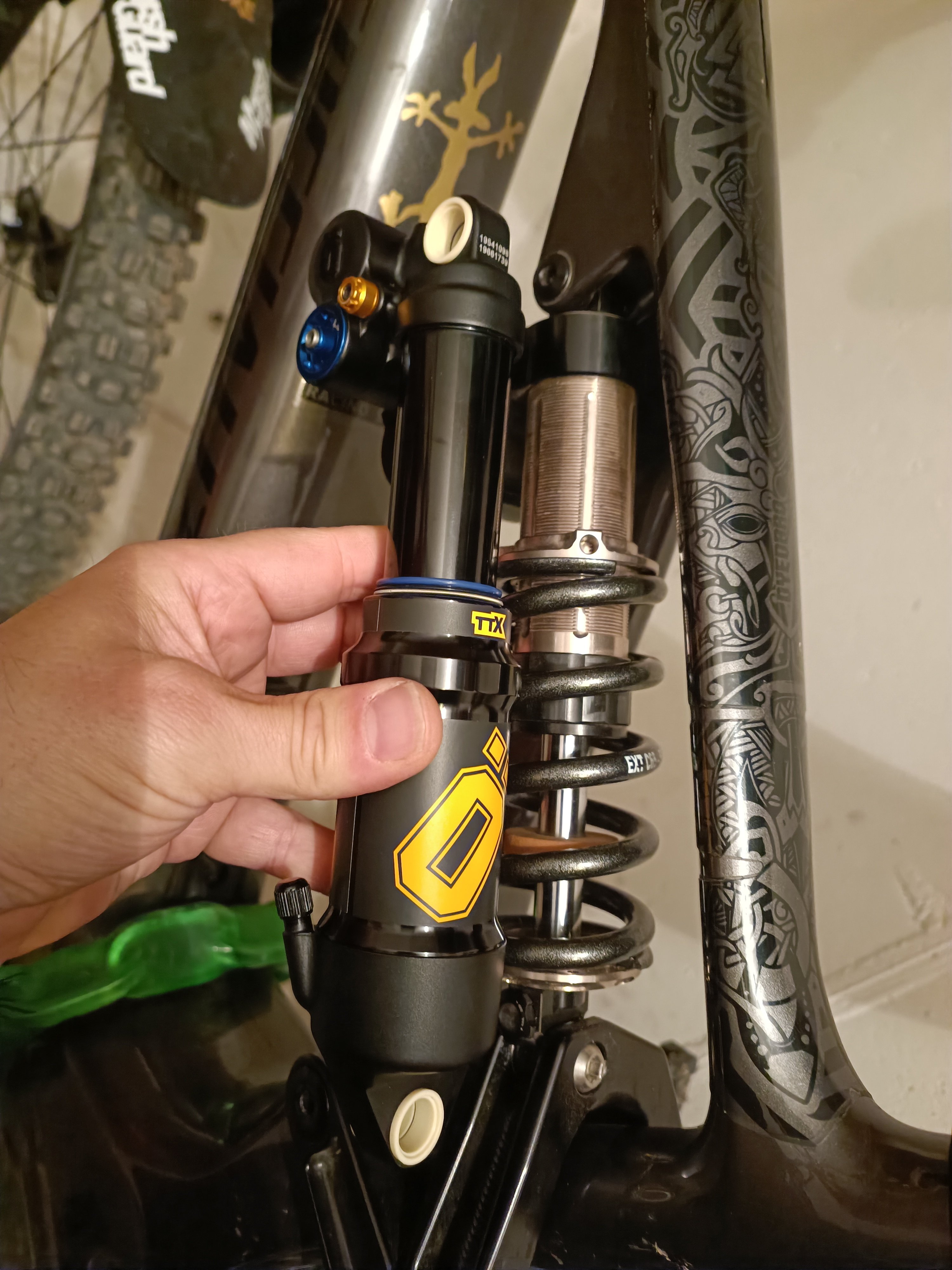

I’ve been running the regular link for a while now, it’s definitely a noticeable difference and I think it was worth it. I used the X2 for about 50 miles before it ate itself, I’ve been on an EXT coil since. I have the long link kit still in the box, I’m on the S2 size so I’m really limited on what shocks will fit. I’ve been looking at just picking up an Öhlins TTX 2 air but then I’d have to get a new fork too, can’t be having mismatched suspension.
I will say that I’m currently back on an air shock since my EXT is away for service and I think I enjoy the air shock more.

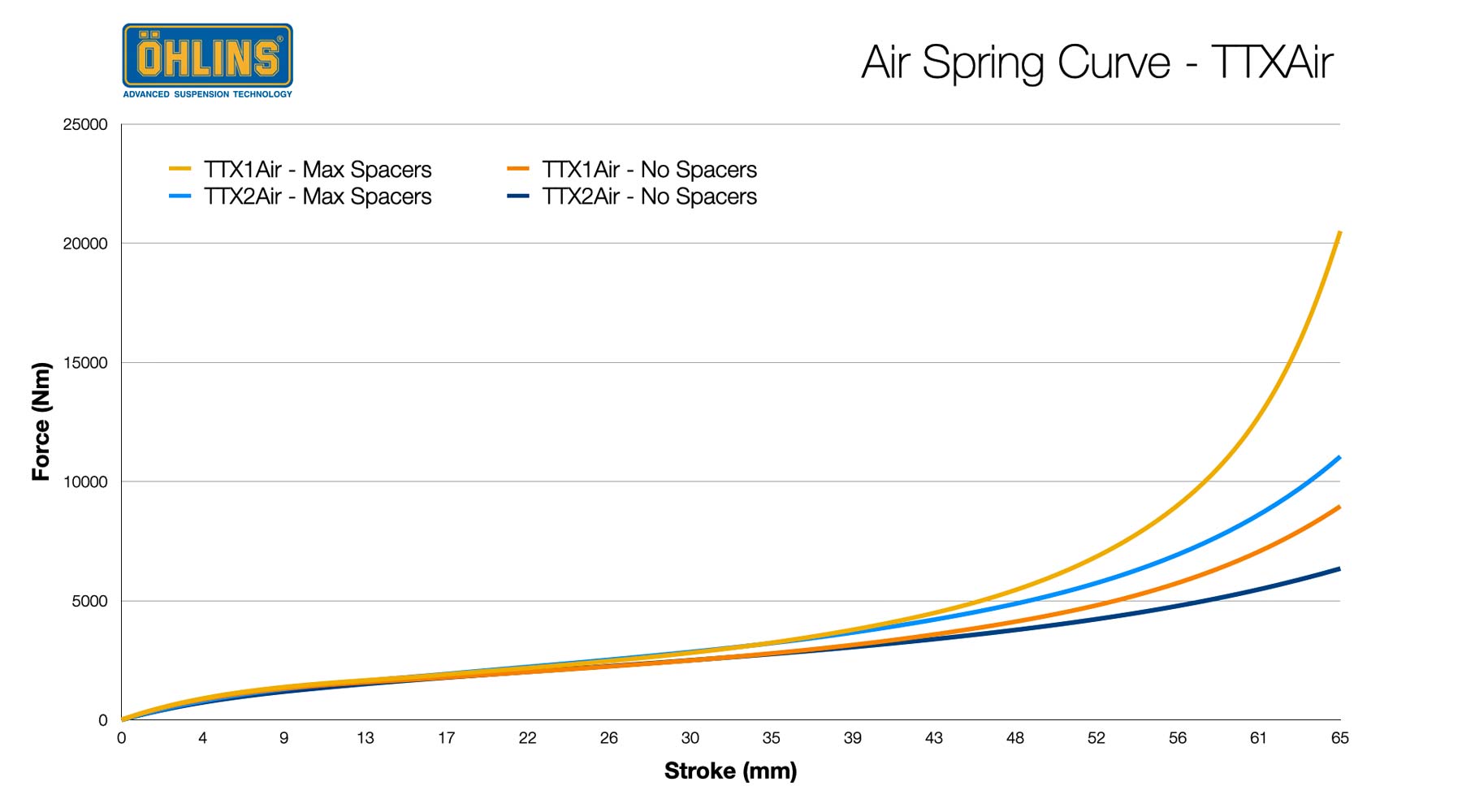

Hi, why a ttx2 air instead of a ttx 1 air? The levo is not very progressive, it should be better with a more progressive shock absorber, am I wrong?!
However with E-storia I NEVER reach the bottom of the stroke, there is always 1 centimeter left even with HBC completely open and I don't understand why, I also tried with HSC and LSC open it doesn't change, sag 19% so I would like to play with TTX1Air
The long link makes the bike more progressive, I think by like 15% or so. If I were using the stock link then I’d look at the TTX1. One of the guys I ride with has the TTX1 on the stock link and loves it.

did you test the ttx1 instead of the ttx2? I'm confused which one should i take for my long shock kit ?

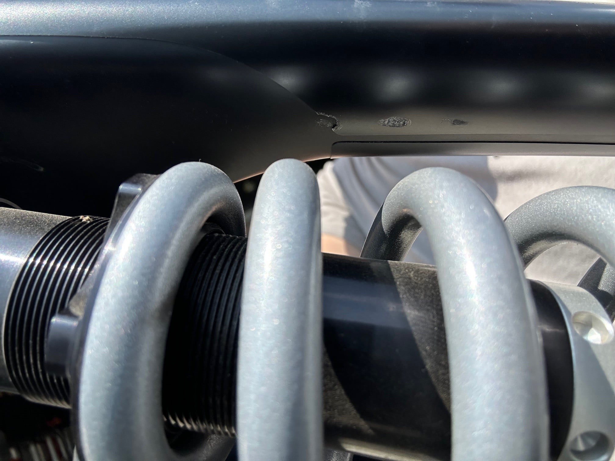

I’ve tried both. There really is no comparison. The long link transforms the rear end to a different level of plushness and traction. The standard cc link is an improvement but still hangs up on rough stuff compared to the long link. The X2 rubbed on my S3 with a long link so I went with Rock Shox super deluxe coil with HBO. Ride quality is superb.

I’ve ran both, the 160 cascade link was a huge improvement over the stock set-up but the long link kit is a huge improvement over that. You may or may not be able to use certain shocks though, neither of my first 2 choices would fit without hitting the frame. I would say you could recoup a decent amount of money selling your stock shock but X2 resale values are shit. I practically had to give mine away to get rid of it, nobody wants them🤣😂
