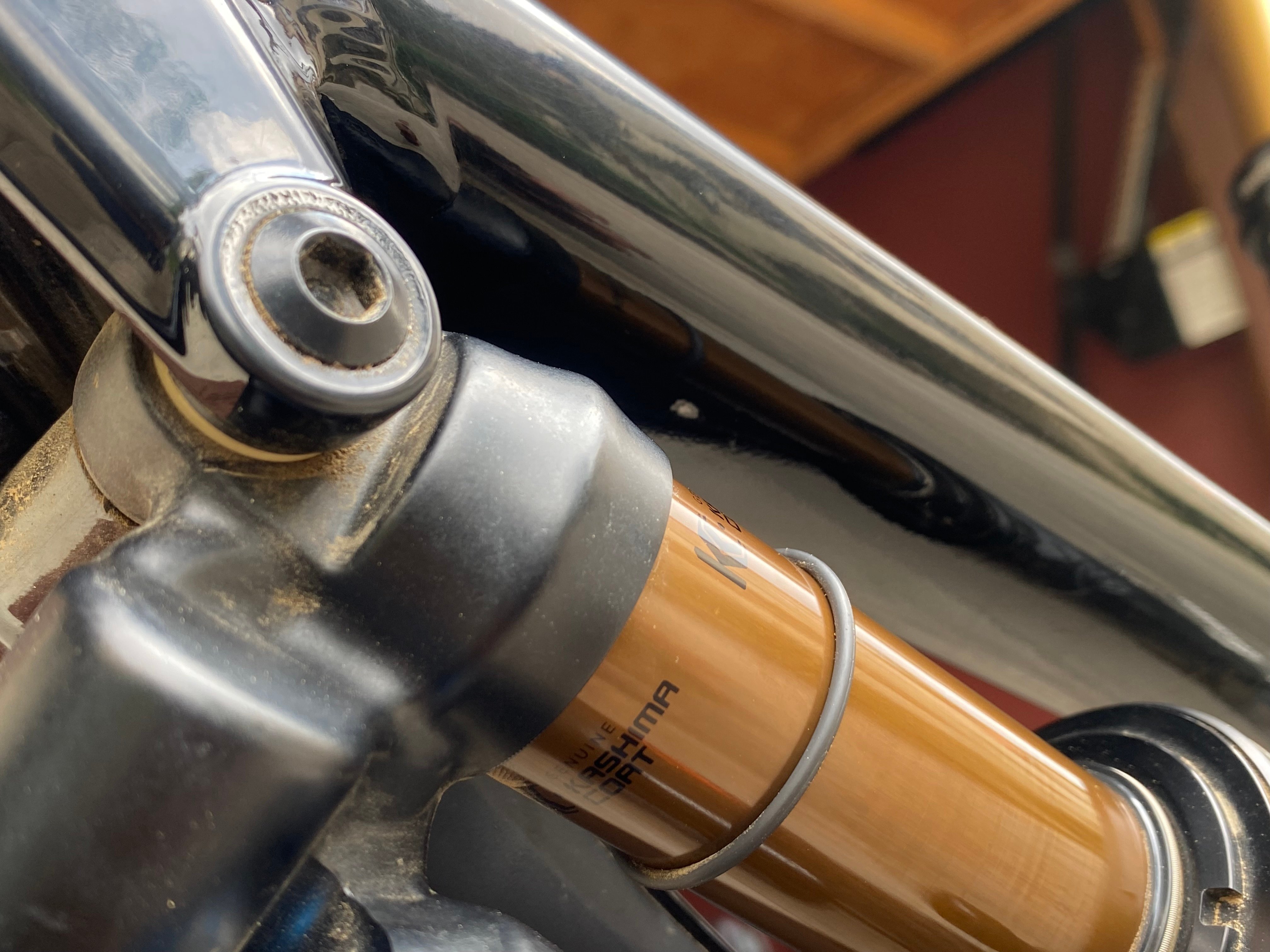

I’m experiencing rubbing issues on my 2023 S4 comp alloy Levo paired with the X2 and long shock linkage :/

I have exactly the same issue, in my case my bike is a turbo levo comp Alloy 2023 size S3 with the long link kit and a fox X2.
Has Cascade given you any solution? It doesn't seem very logical that this is happening to more people through the forums and Cascade doesn't review it or warn about it on their website (except in sizes S1 and S2).

IME, it’s a Spesh issue, not a cascade issue. My mate had to send his Levo in for warranty work so he swapped his stock link/shock back in. We put the long link/Ohlins shock on my bike so I could try it out but the shock hit the frame, both frames are the same size. When he got his bike back we measured the front shock mount and it was a few MMs further up on my bike, just enough to cause the spring to touch the frame.
It is a specialized problem for sure but Cascade should still acknowledge the issue. It cost me a few hundred dollars since I had to cover a bunch of shipping costs on turning my x2 and I was without a working bike for a few weeks. If I had know it was a risk I should have likely handled it all differently.

I don't agree that it is specialized's fault. Spe is the bicycle manufacturer and Cascade of an accessory for a bicycle model, it has to ensure the compatibility of what it is manufacturing. Does Spe have to ask Cascade for permission to have a different tolerance when manufacturing? It's as if Valeo is suing Audi because one of its models has a dual-mass clutch and another a single-mass one...
Yeah, I don't disagree with that. They should have enough feedback now to know there is a problem and the specialized tolerance to how the hole is positioned has a higher degree of variation than they initially planned. At least a warning on their site is required I'd think.
The X2 fits some frames and not others, so it a variance in the frame. If you space the top of the shock over a couple mm, it usually fixes the problem.
