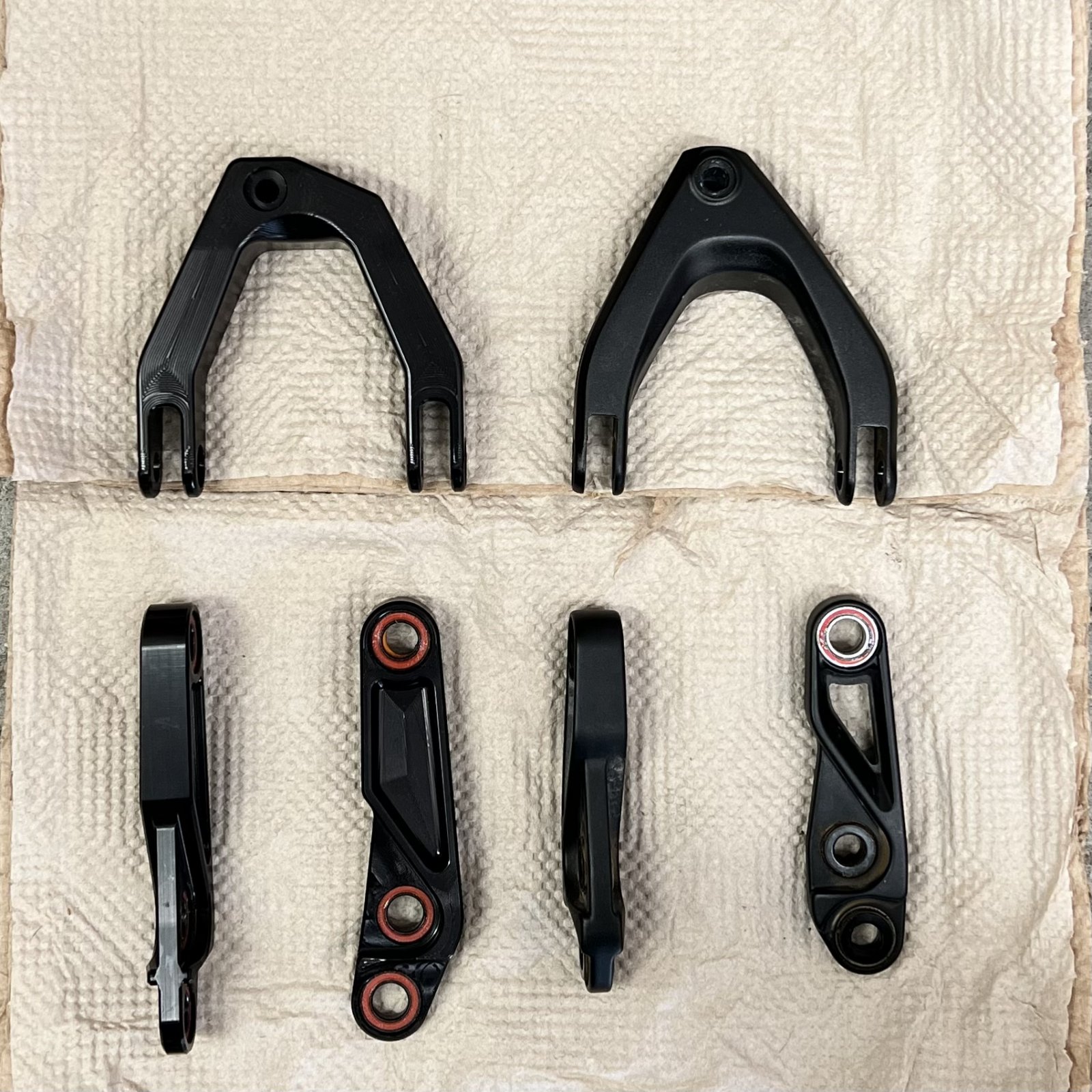

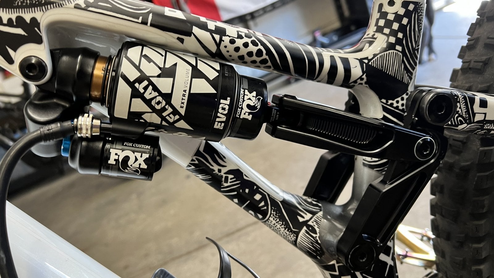

Just finished install. Excited to go for a ride and finish set up.
Stock 210x55 upgraded to 230x65
Will convert stock 150mm travel to 165mm
No more high pressures. Easy bottoming out gone
No clearance issues

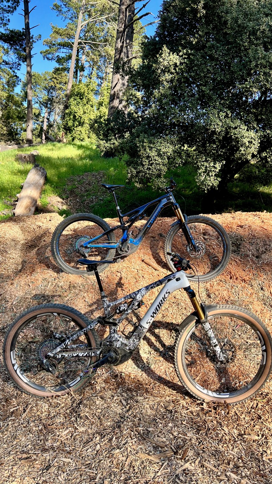

side by side with a stock gen3 Levo
170mm travel up front. 165mm rear!
Will post the 210x55 for sale soon

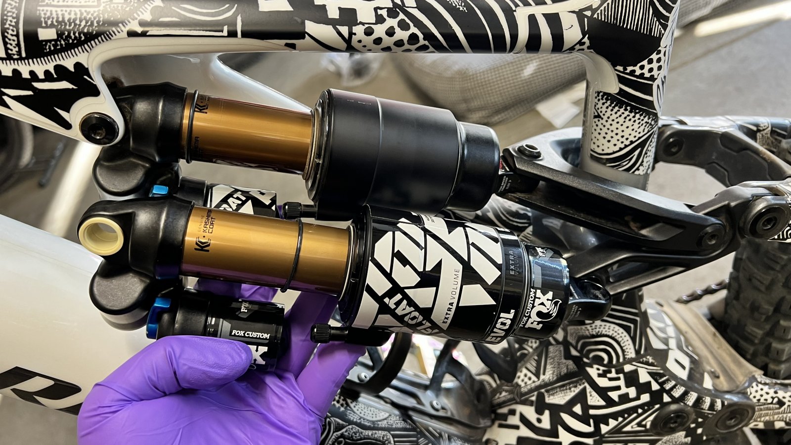

** you can see the DU bushing on replaced shock (hole near HSR)
*Took the 230x65 X2 from my Kenevo and serviced by Fox. Fitted the stock rockshox coil back on.
**i was lucky to already have a DU bushing for the shock. Saved me from dropping what i was doing and making a run to the bike shop. You can use the old bushing from the old shock if you have the tools. But I recommend having a new DU bushing. (Don’t know if this was mentioned on CL site as i did not read any of the instructions lol)
