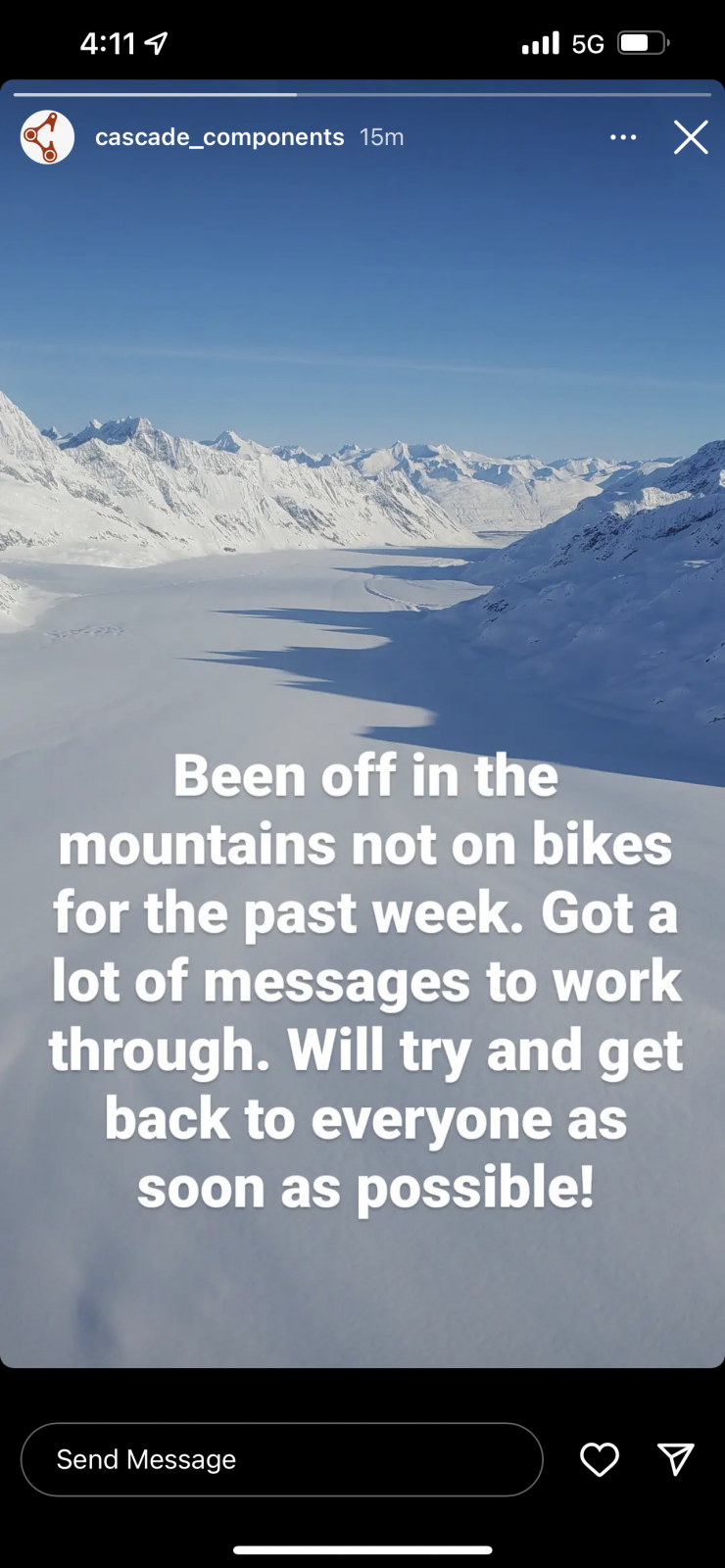

Just saw this post, for those who have been trying to get in touch with them

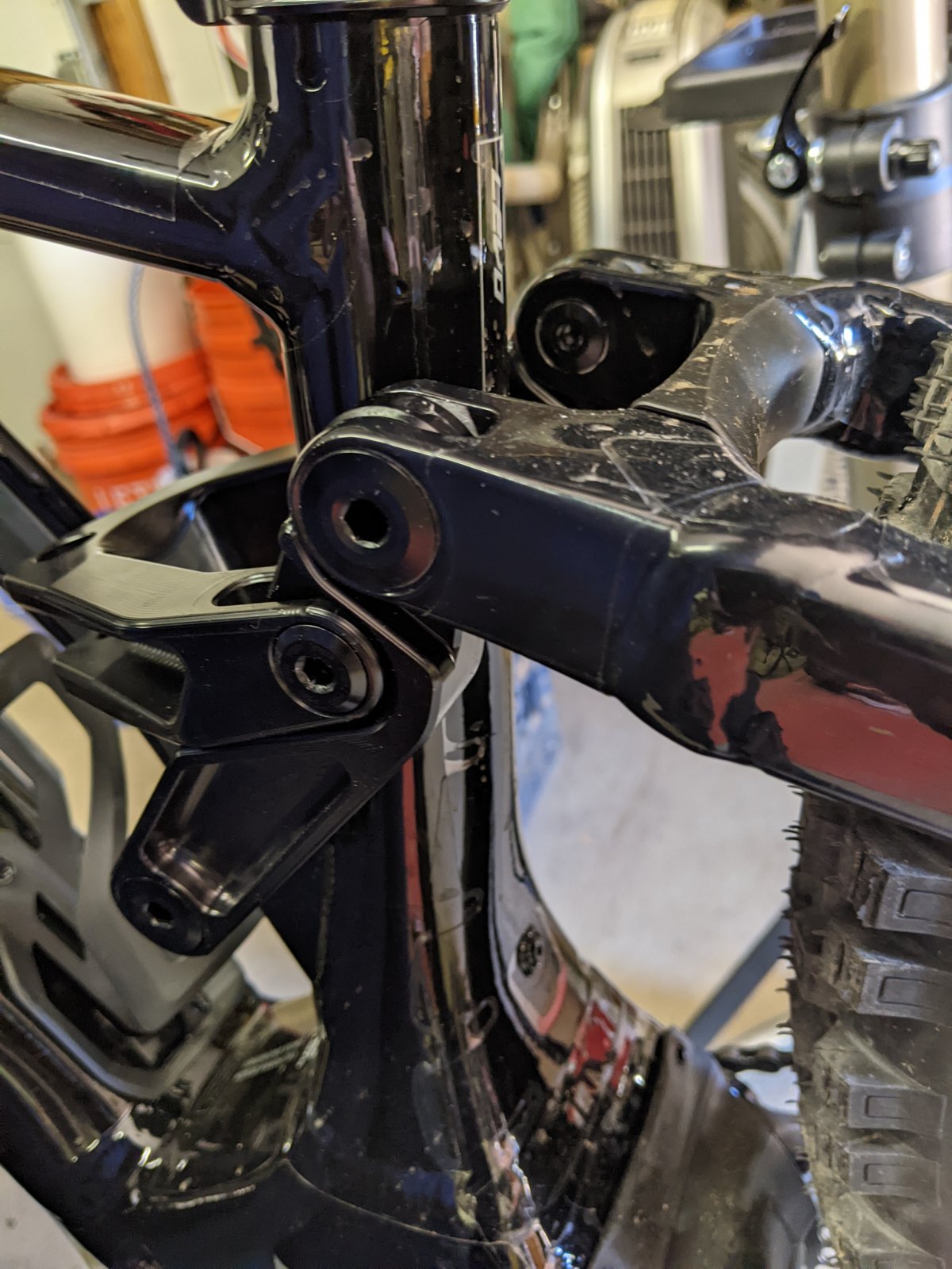

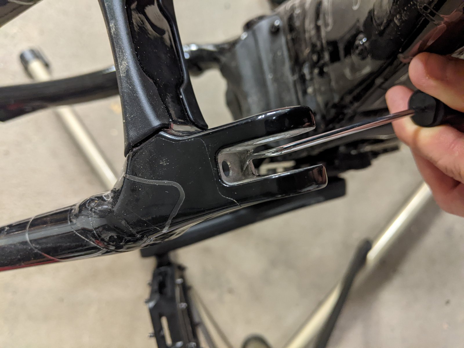

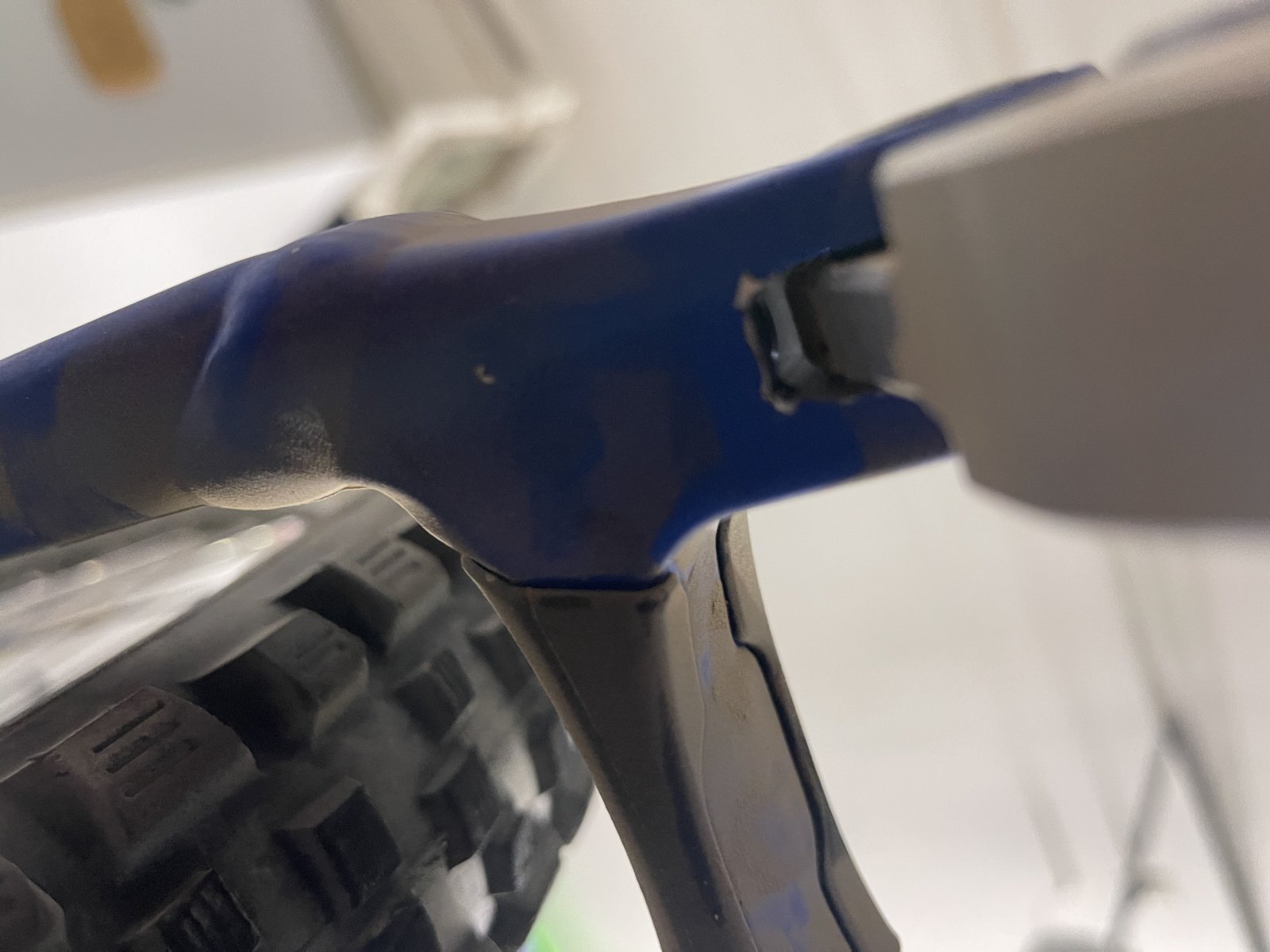

Well BAD NEWS the link does not allow full travel on a S2 alloy. The links interfere with the seatstays before full travel is reached. I'm a bit bummed about this and will be contacting cascade tomorrow. My guess is the alloys will need a separate set of link plates than the carbon bikes.
Just curious, would you happen to have a picture of the interference?
The link bottoms out in the clevis on the seat stay. The casting has a rib in it that interferes. The carbon version must have more clearance in the lower portion of that clevis.
I could grind on the bike and link to get clearance but I'm not going to do that.

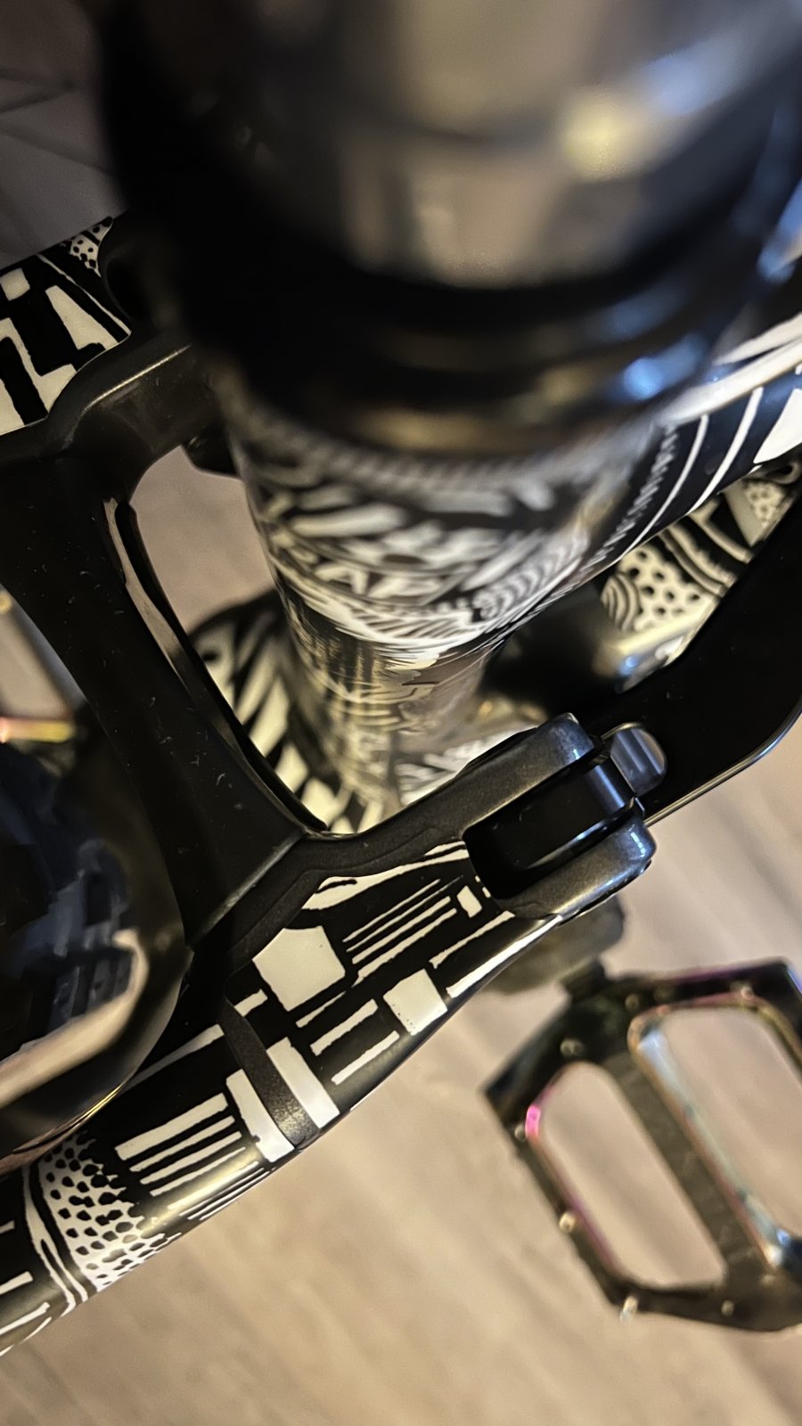

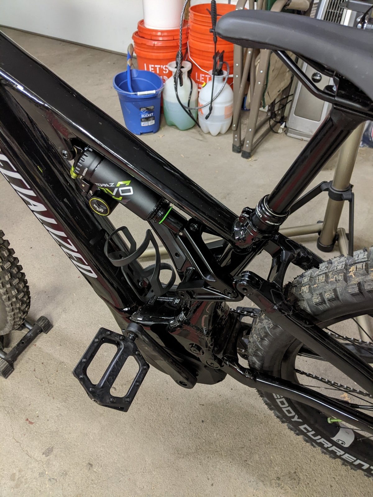

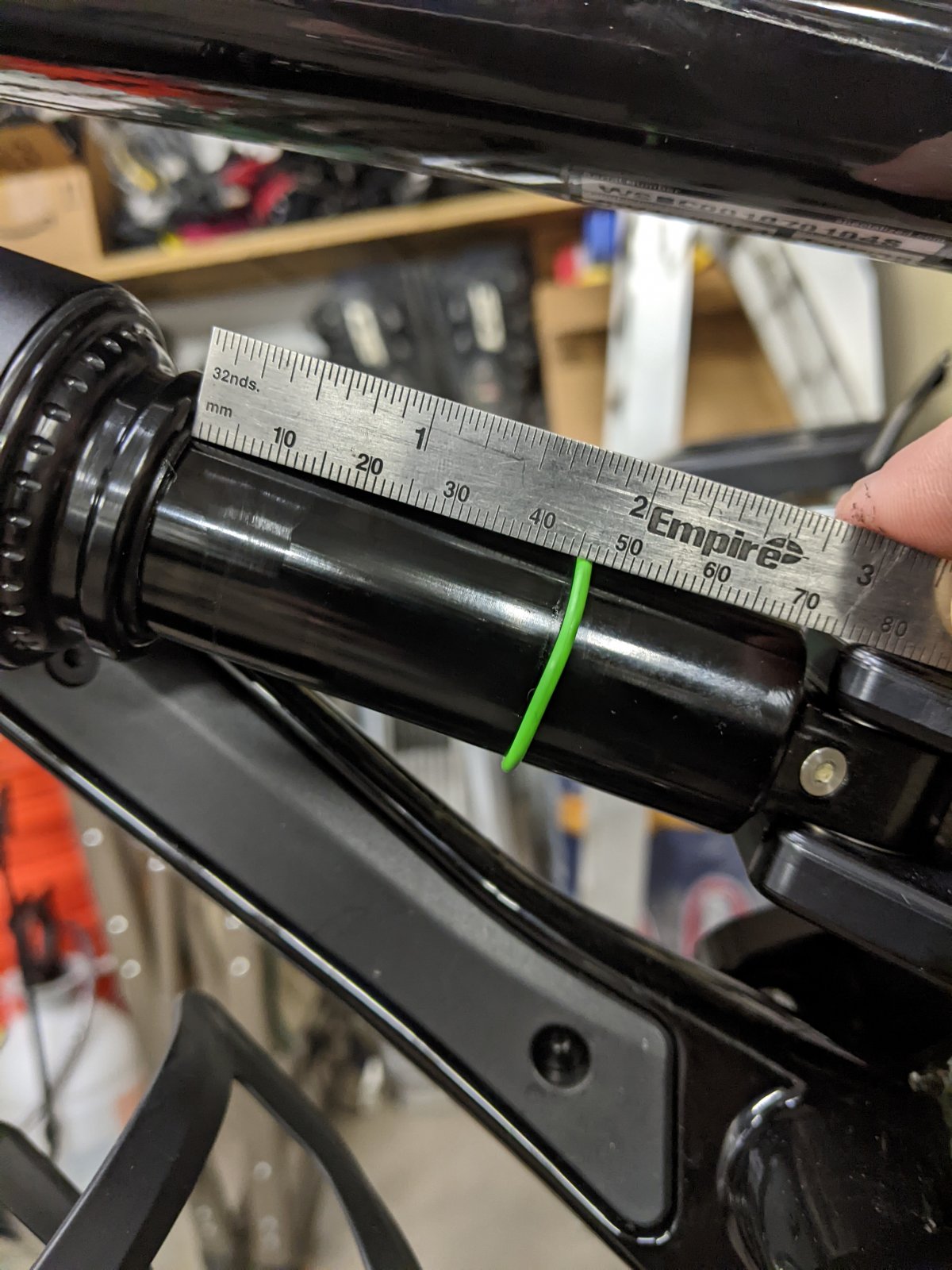

Weird...i let the air out the shock to double check clearances. this is how it looks

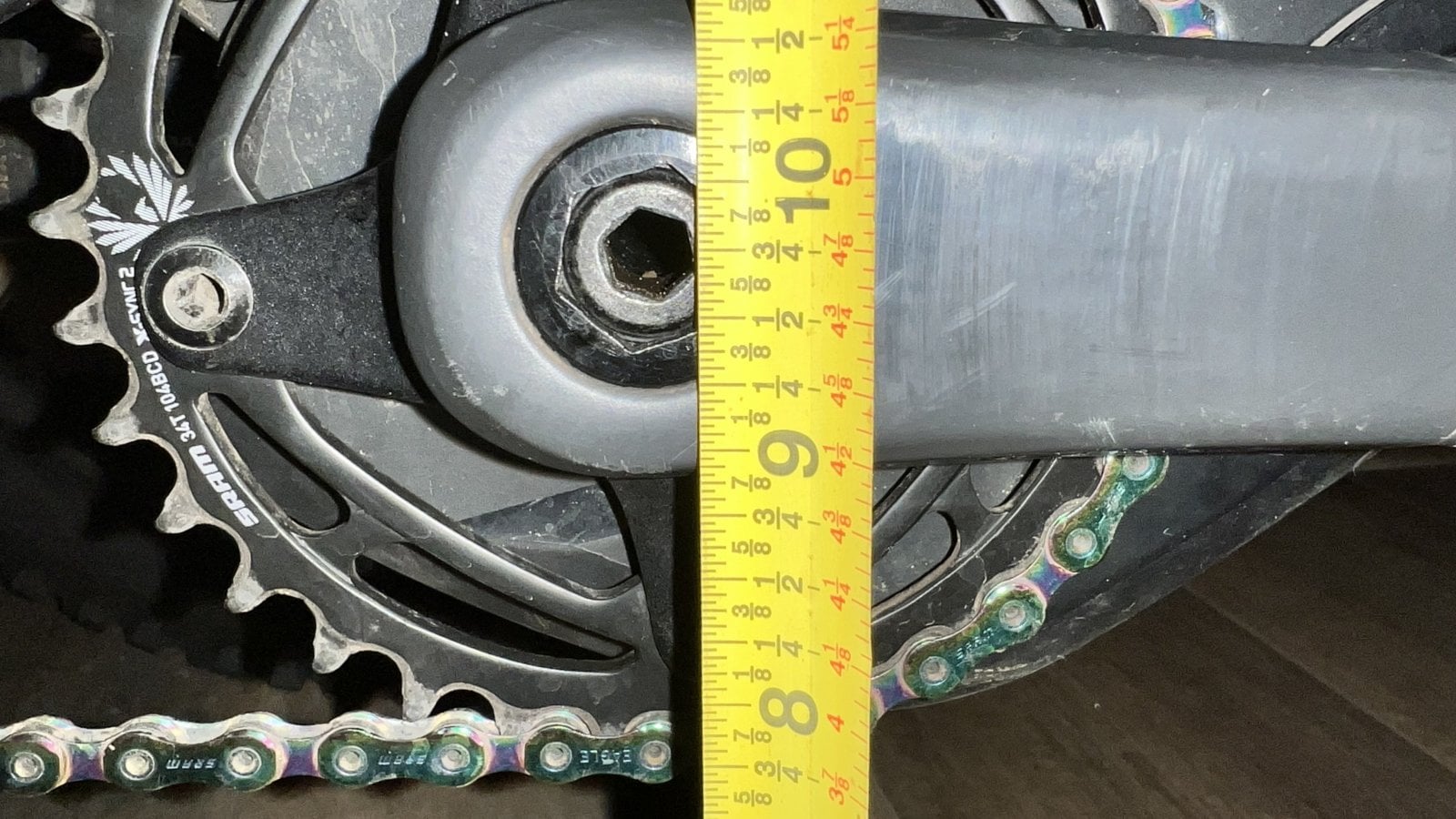

Did some measurements with new linkage on my S4
170 Fork at slack setting. 65 degrees (iphone leveling)
Rear HIGH setting
BB height 361mm
Currently:
170 Fork at slack setting. 64 degrees (iphone leveling)
Rear LOW setting
BB height 351mm
I thought the rear flip chip is only supposed to change the height about 5mm. Looks like it changed 10mm
While the air was out the shock i went ahead and checked the BB height at full compression
Rear HIGH setting
BB height 361mm
Currently:
Rear LOW setting
BB height 351mm

Spoke with Cascade about the interference and sent them detailed images of what was happening. The said only 2 people have had this issue, myself included, so it looks like the seatstay castings vary and not all bikes have issues....they will be working up a link with more clearance in that area. Hope it happens sooner than later as I have a really nice shock just sitting on the bench staring at me...

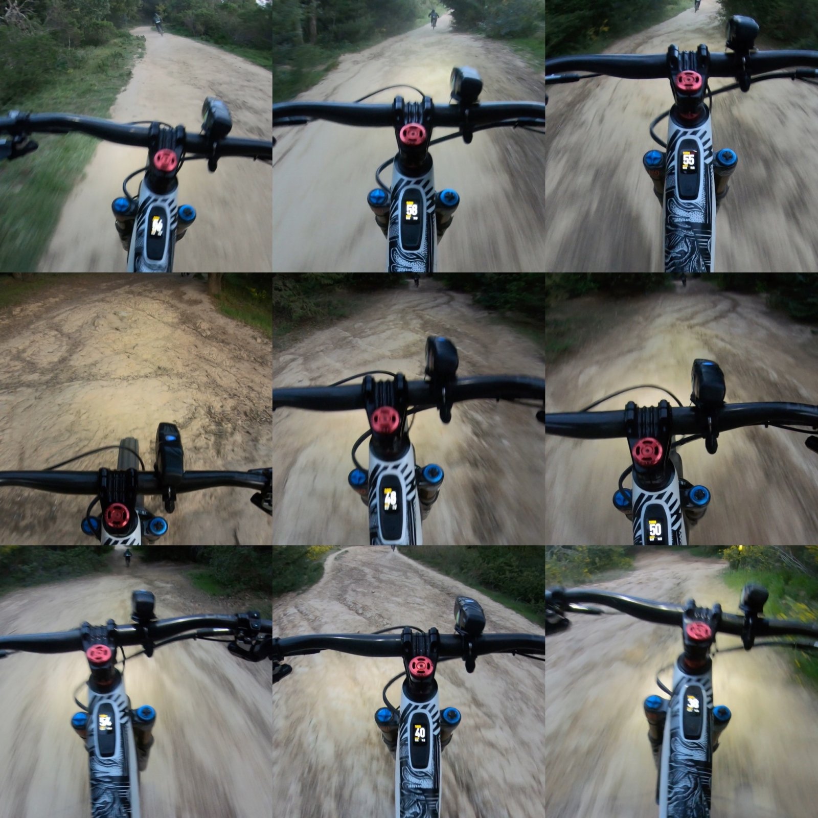

Every time I change my suspension settings i like to test it on this trail to compare. Nothing too crazy, just bumpy and rutted all the way down with sections to jib. Of course any mistake would be costly as there are some deep ruts, sharp rocks, slippery round rock slabs and loose sandy sections. It’s not downieville by any means but it’s a good bumpy ride.
230x65 handled it very well. Excellent support from the suspension. I’m very pleased with the performance. Everything from small bump, mid support and bottom out resistance. All i can say it’s so good compared to stock.
I’m not a fast rider. I’m actually on the slower side amongst our group, but not the slowest lol. The faster riders really just jump over all the rocky sections, I’ll flow through them. Mid 40’s and i just like to ride.

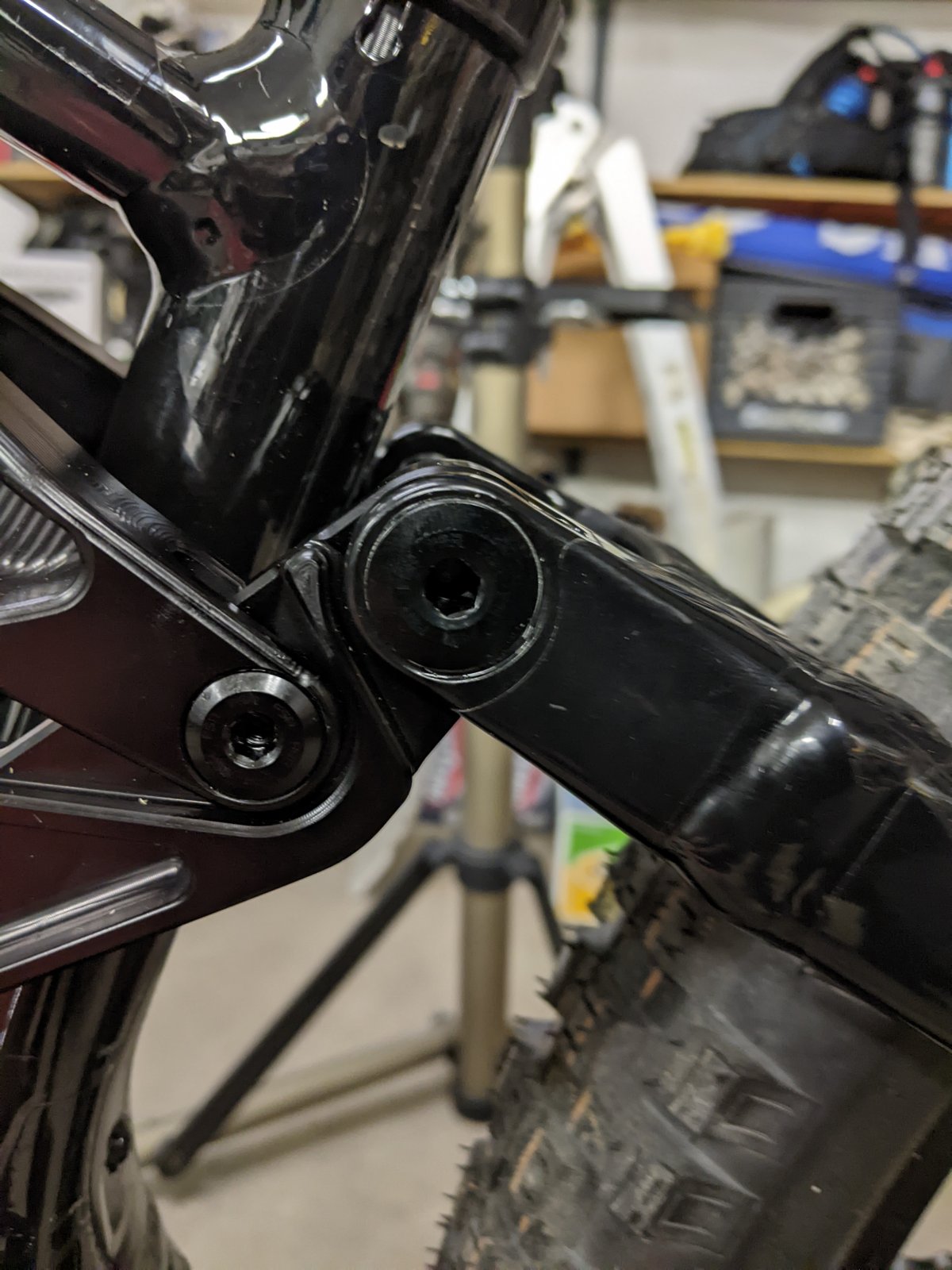

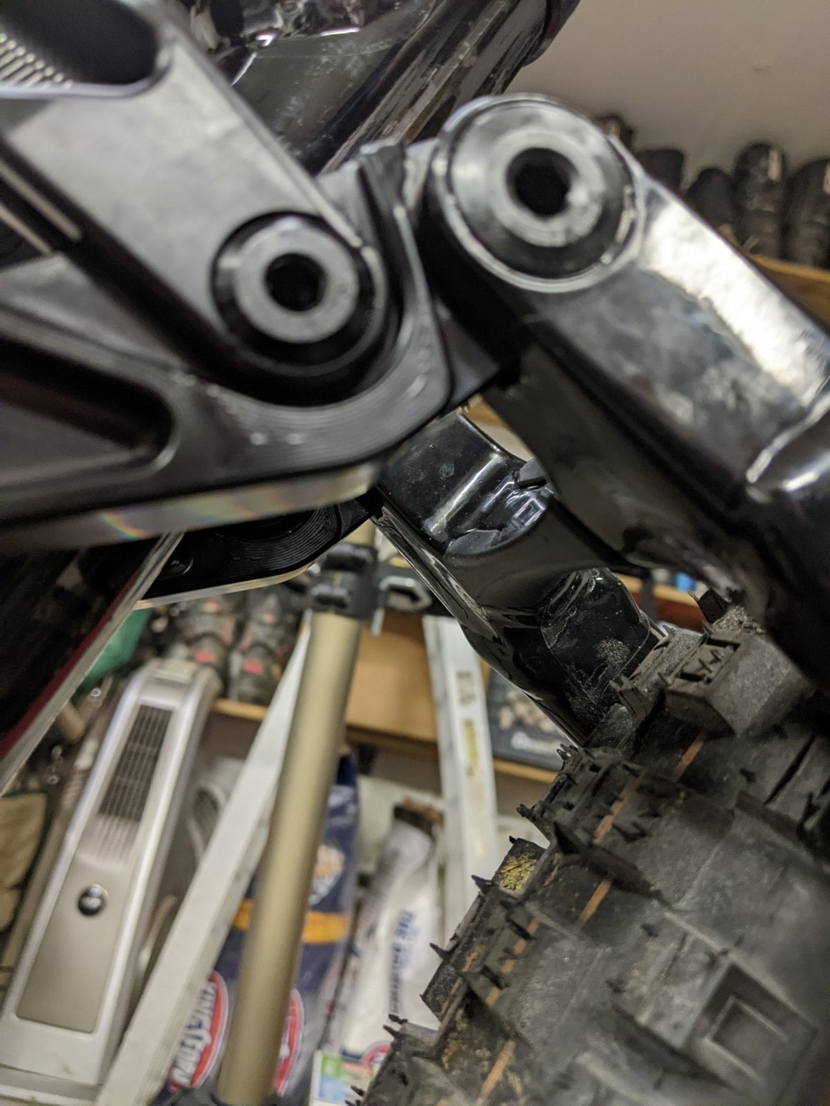

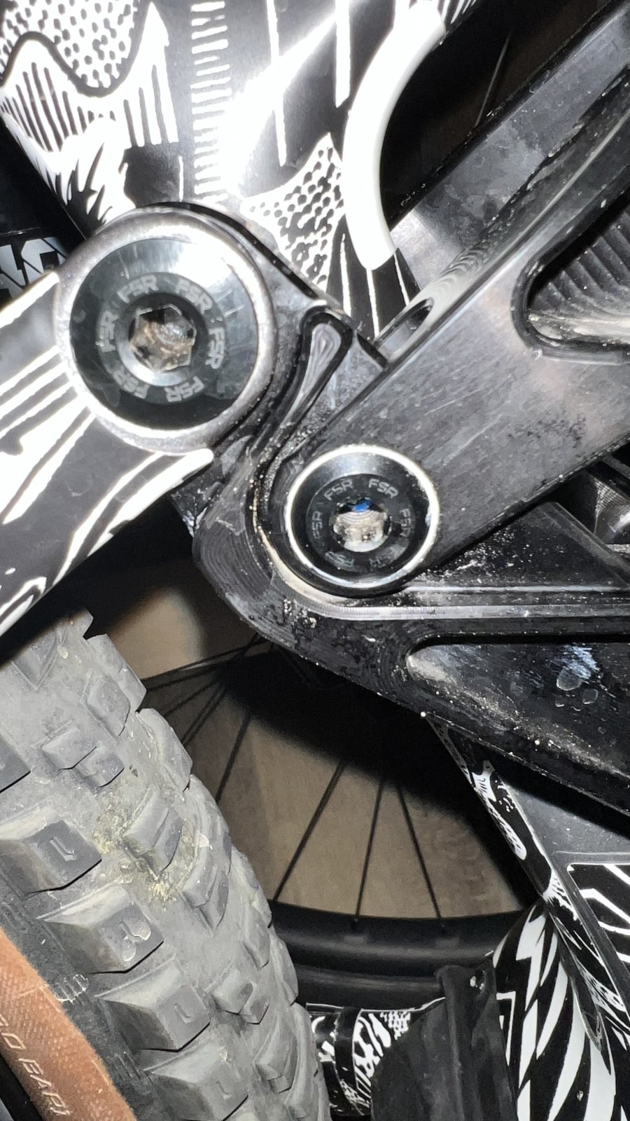

So my alloy S2 is also binding on the seat stay. Did one ride and noticed I didn’t use all the travel. Photo’s looking up.
Yep thats where mine contacts.....these are the images I sent to Cascade so they are aware. You can see a rib inside the casting that is the main culprit. Reduces travel quite a bit to about 45mm of stroke.

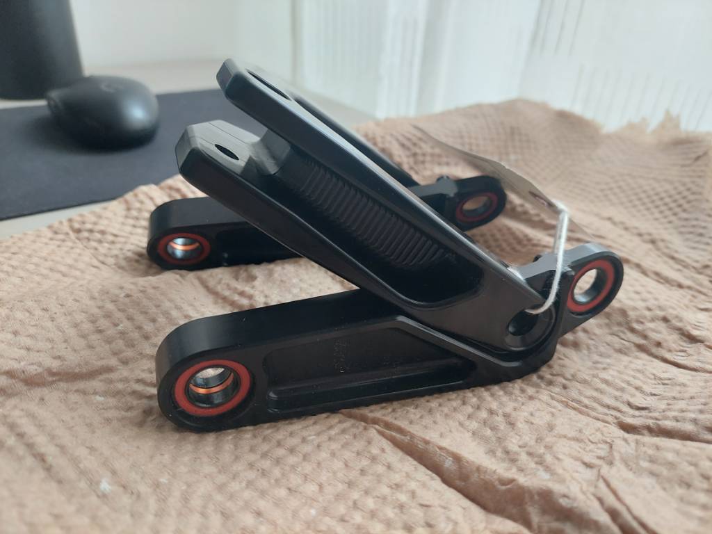

Just received long link!
