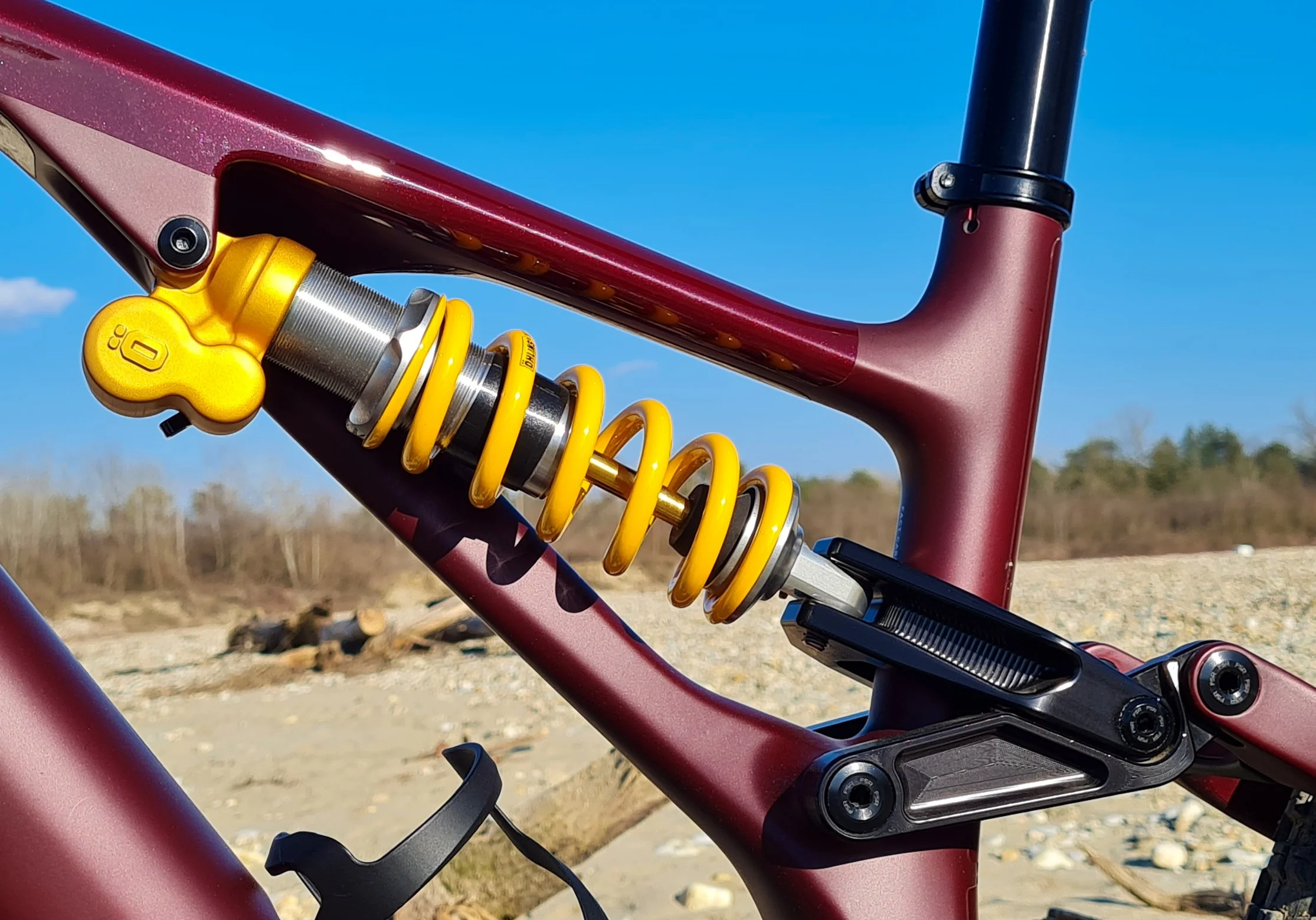

Yes, 502 lbs/in worked great for me and I’m still riding it on my Öhlins TTX22 M.2.
For reference, my 85 kg is fully ready to ride, including helmet, backpack, tools, and water. With the 502 lbs/in spring I’m right around 29% SAG, and the rear suspension feels buttery smooth and very supple, with plenty of support once it gets deeper in the travel. No harshness, no dead feeling.
I did not end up running a progressive spring. With the Cascade link and the linear 502 lbs/in coil, the bike already feels well balanced for my riding and honestly I don’t feel the need to change anything right now.
If you’re 85 kg without gear, I’d personally start closer to 500 lbs/in rather than 550. Based on my experience, 550 was way too firm.
Hope that helps.

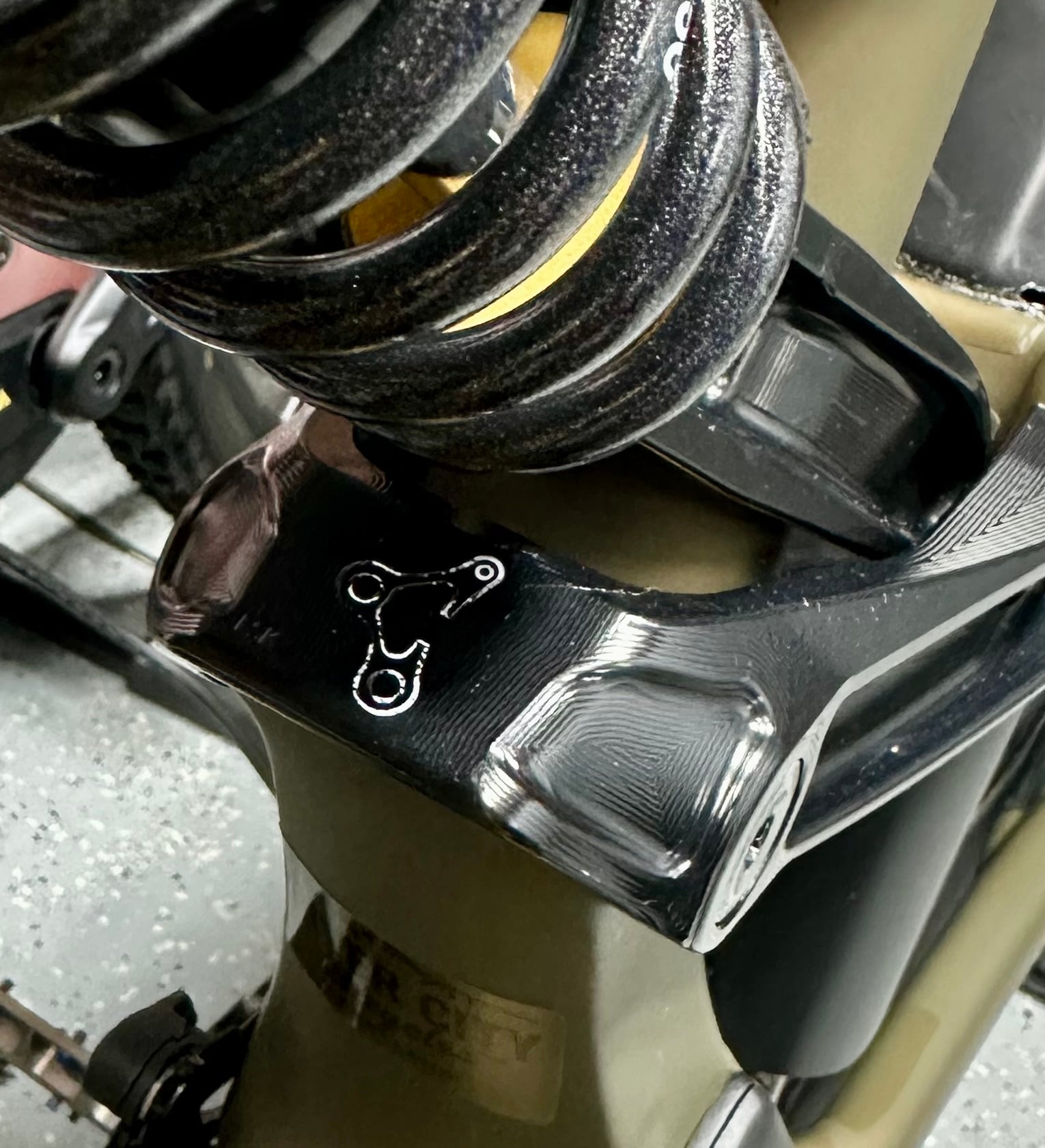

Cascade links with the right shock on the right bike are so frighin awesome.
Love everything about mine. View attachment 172279
I have the same Levo (Obsidian). I'm trying to find out what coil shocks don't have clearance issues with the S5 comp carbon (2023; gen 3). Are you on an S5?
S4
Just contact Cascade Components they will set you straight. I’m on a Gen 4.
