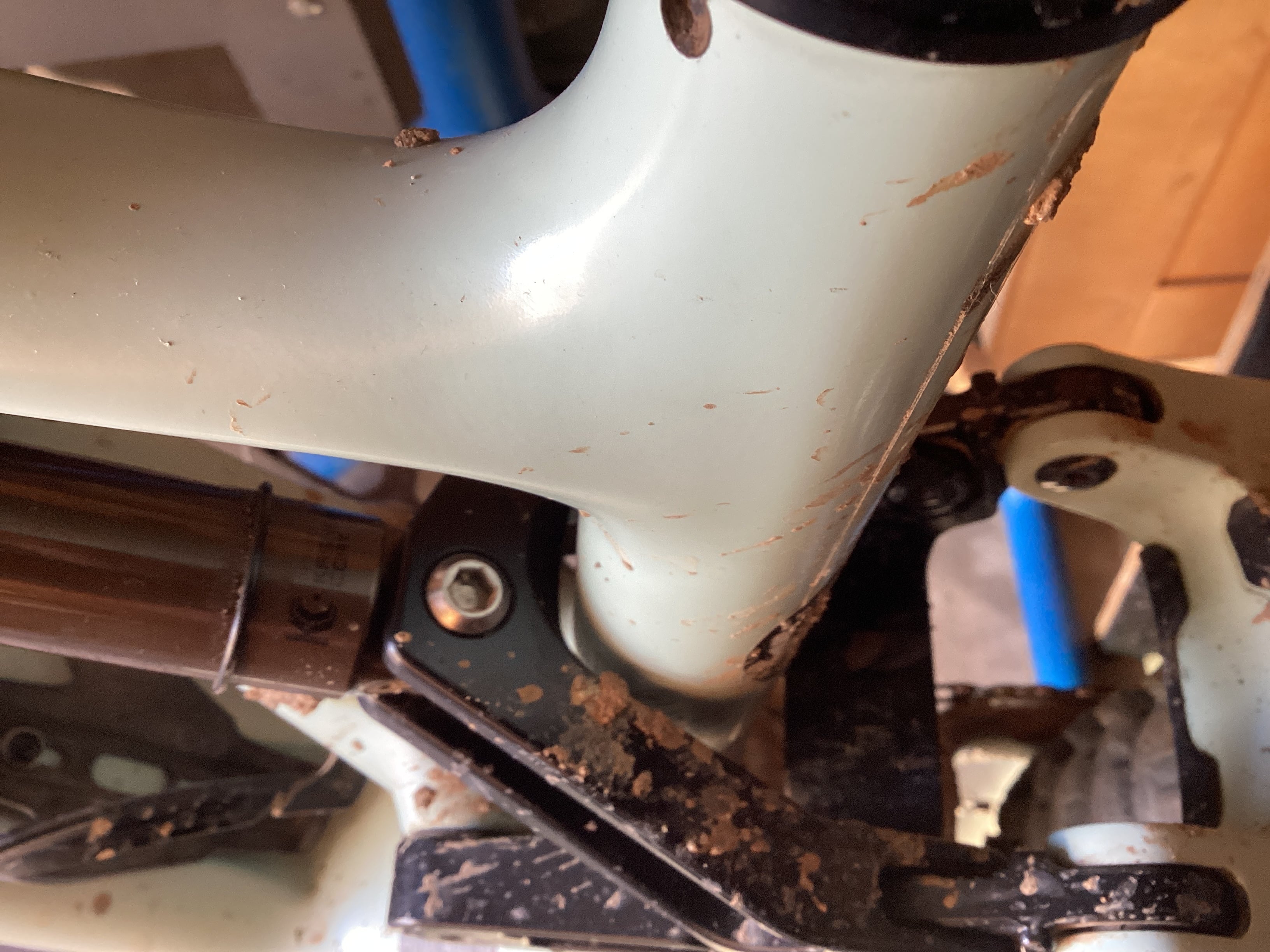

I guess if they were missing it would maybe make a difference but even then probably not as much as it seems your linkage is off.

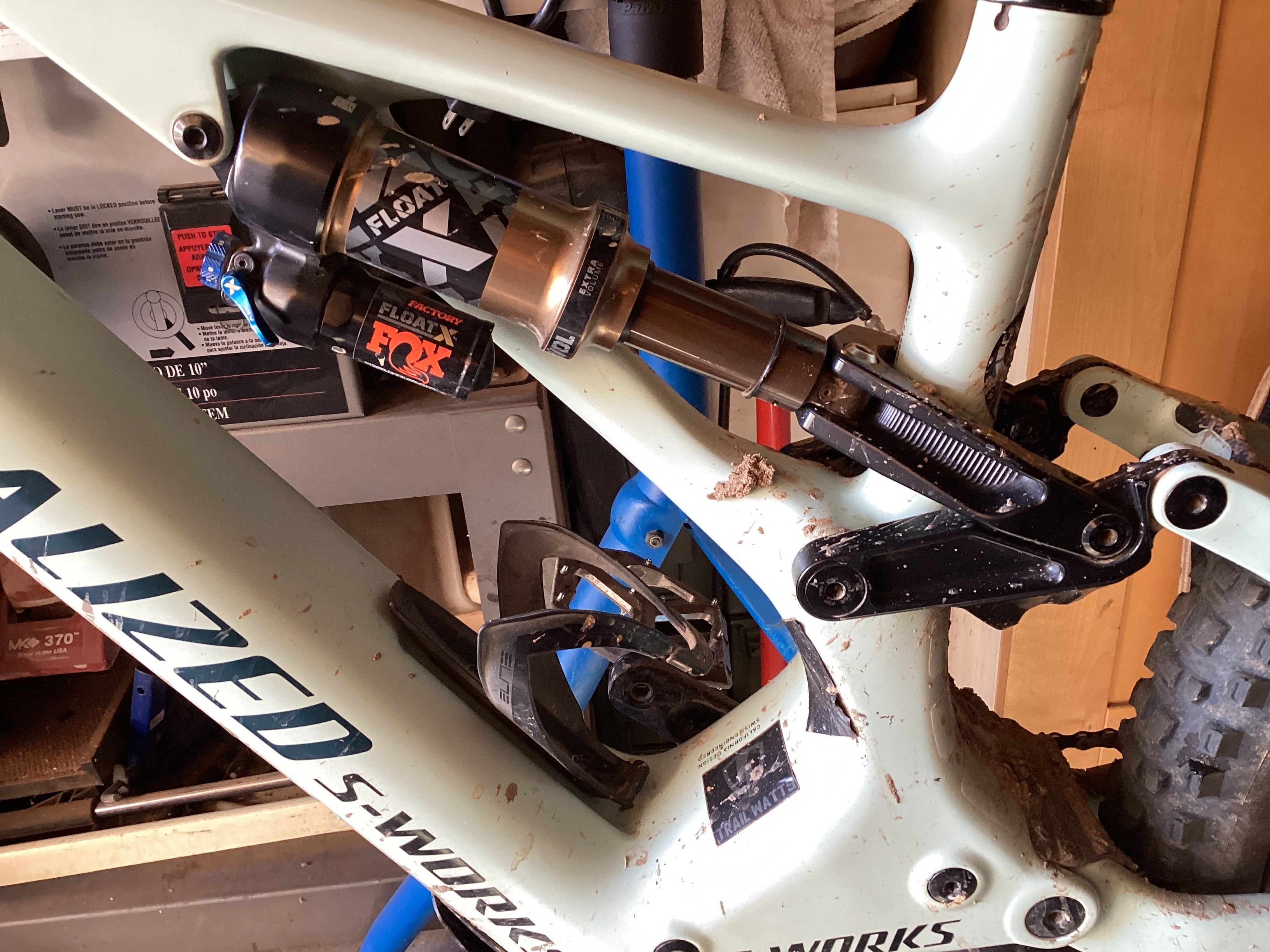

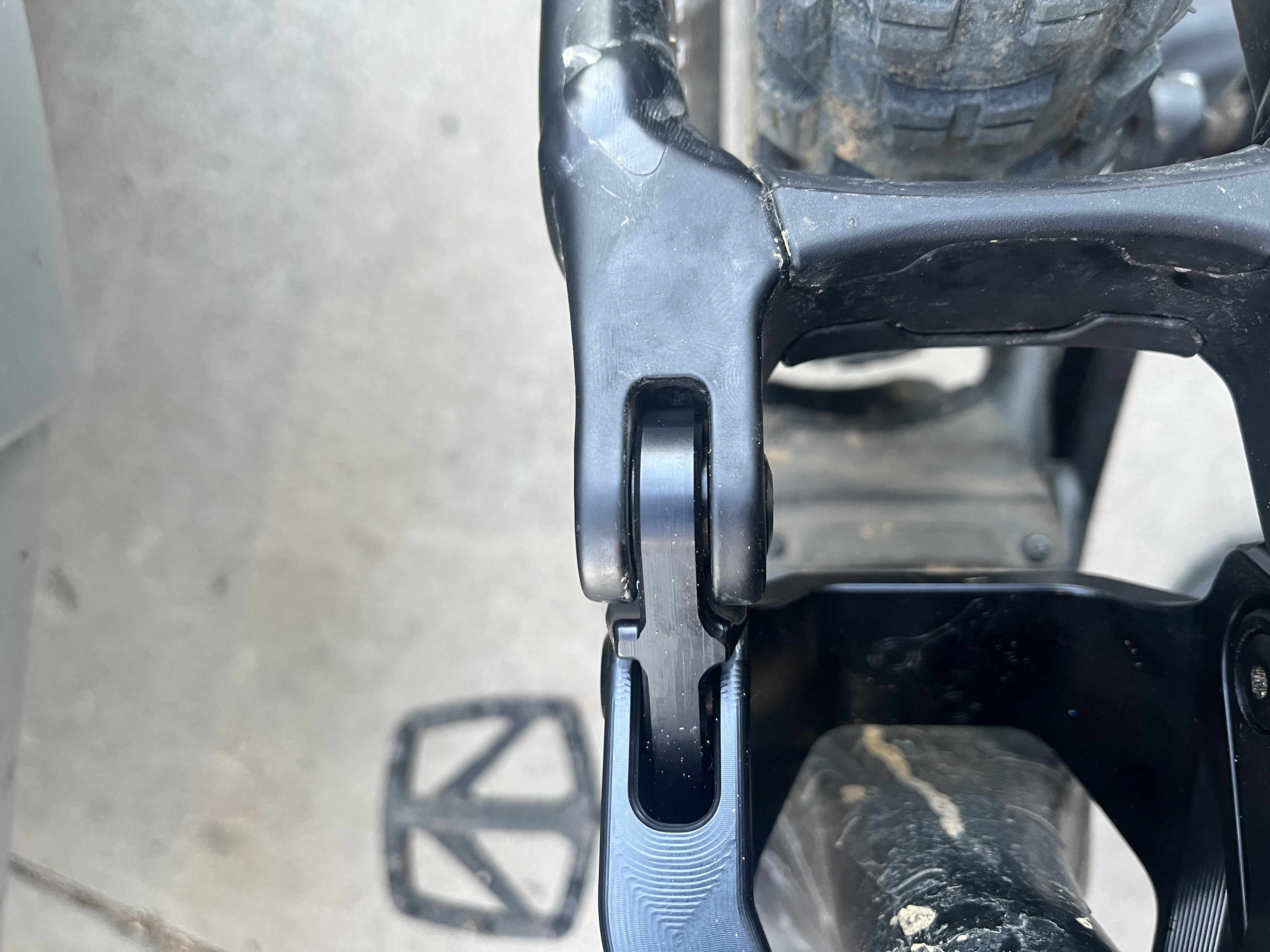

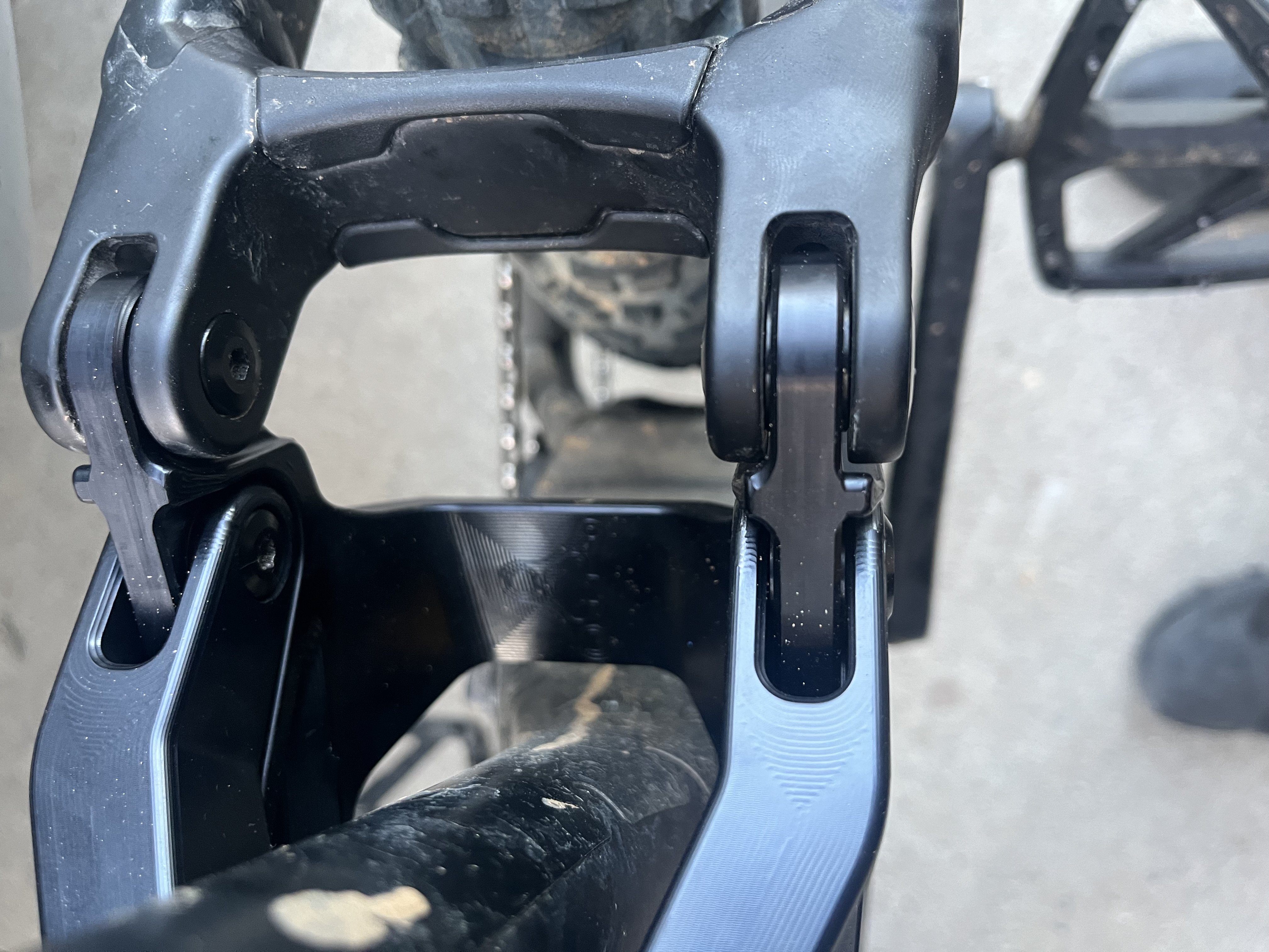

Just took these pics of my 2023 levo carbon with the long travel cascade link and my Fox x float 230 x 65 set-up and I have probably got 4mm of space between the frame and the link body. Also have the rear chainstay flip chip in the high position.

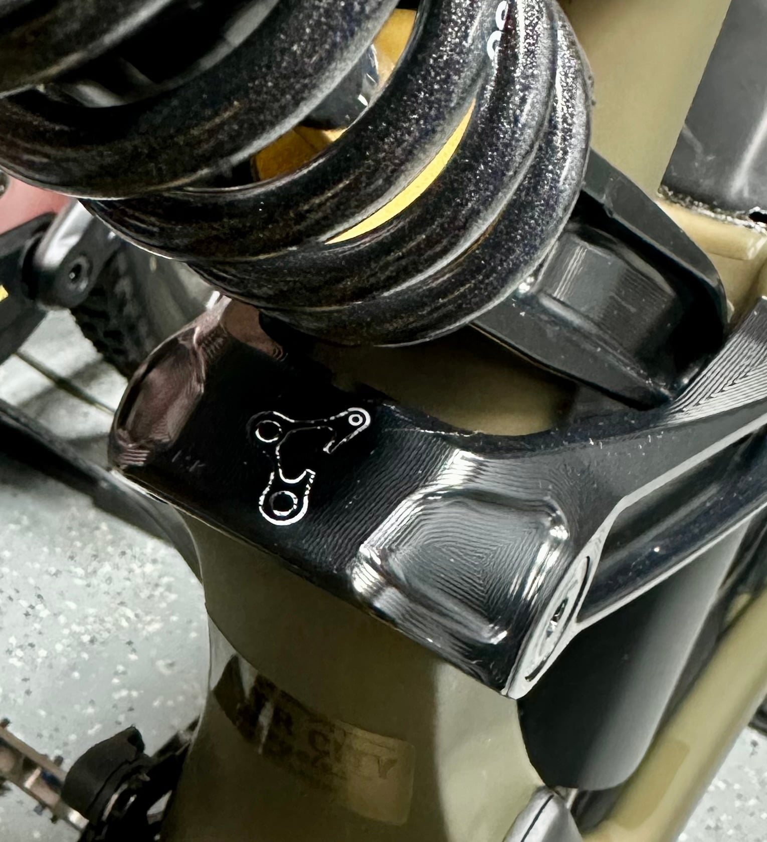

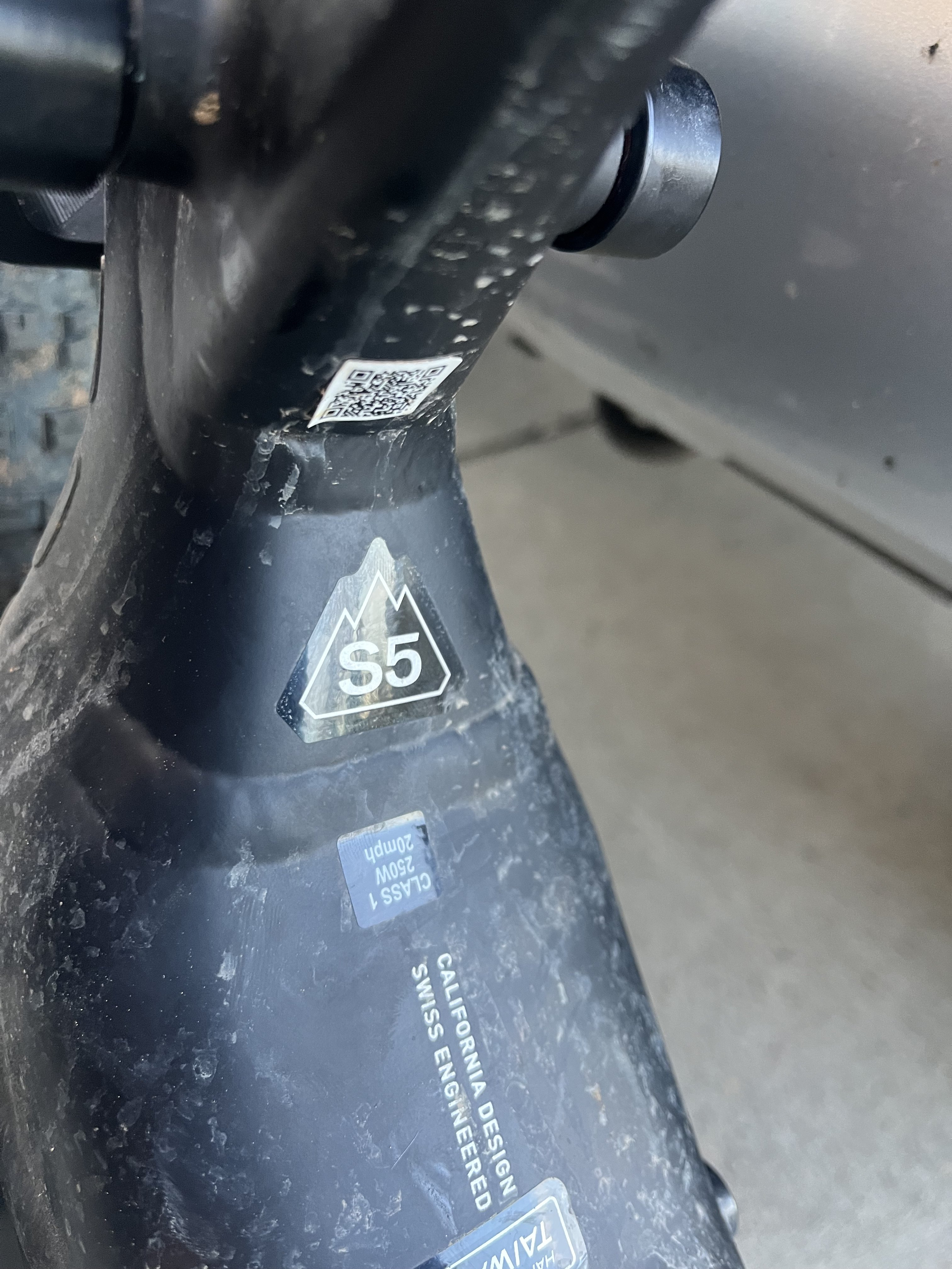

Yes STLA-0001 stamped underneath
Yours looks like a carbon frame. Most of the incompatibility issues I’ve seen online were with alloy frames. Could be confirmation bias though. I’m still wondering if I got a previous link version or not. I’ll just patiently wait for cascade to get back to me.

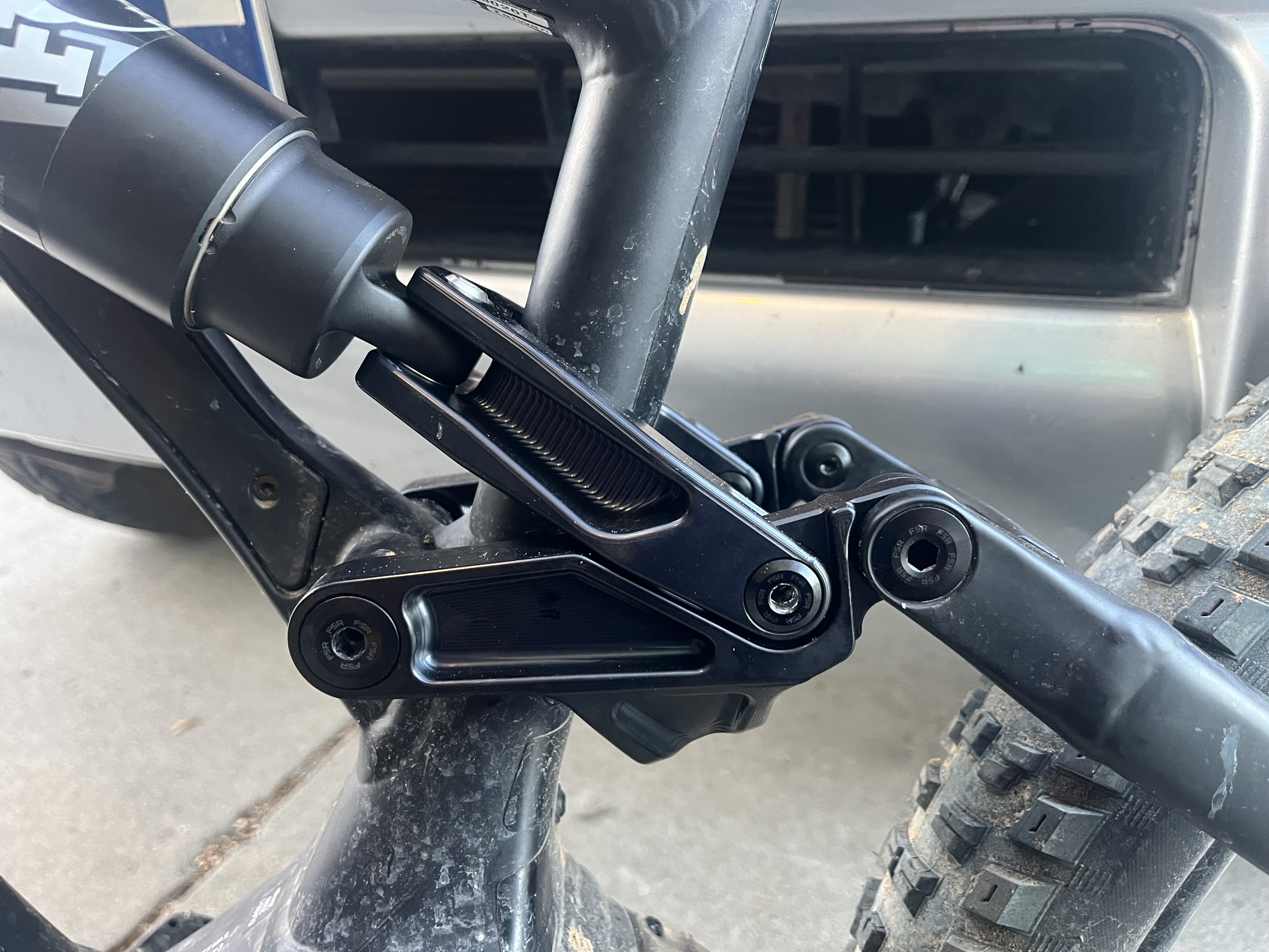

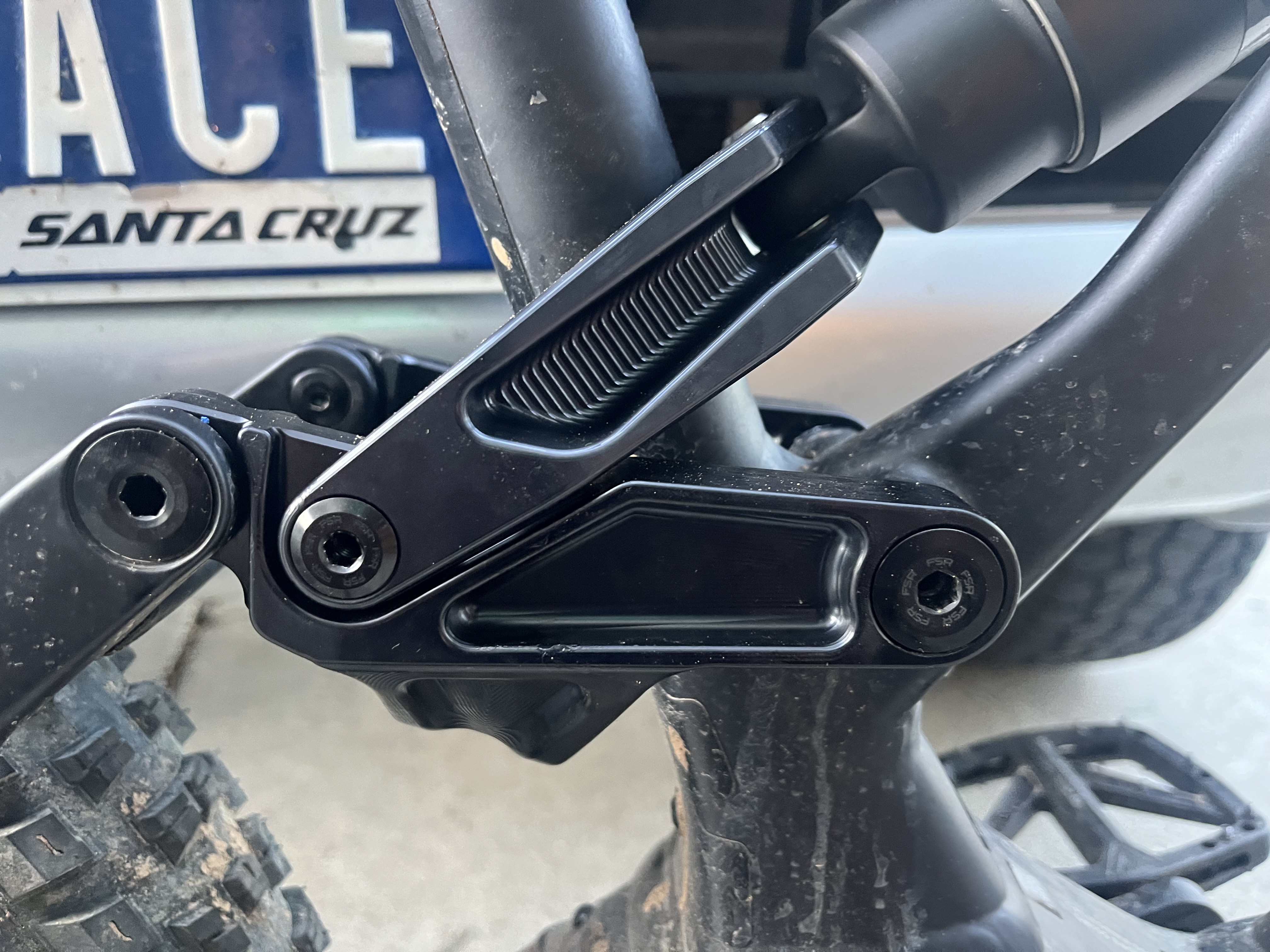

Reviving an old thread here. I bought a new 2023 alloy levo s5. First ebike! Love it! I bought the cascade long travel link. I followed this thread very closely. I don’t expect any issues even verified compatibility with cascade components and the alloy frame since there were 2 versions.

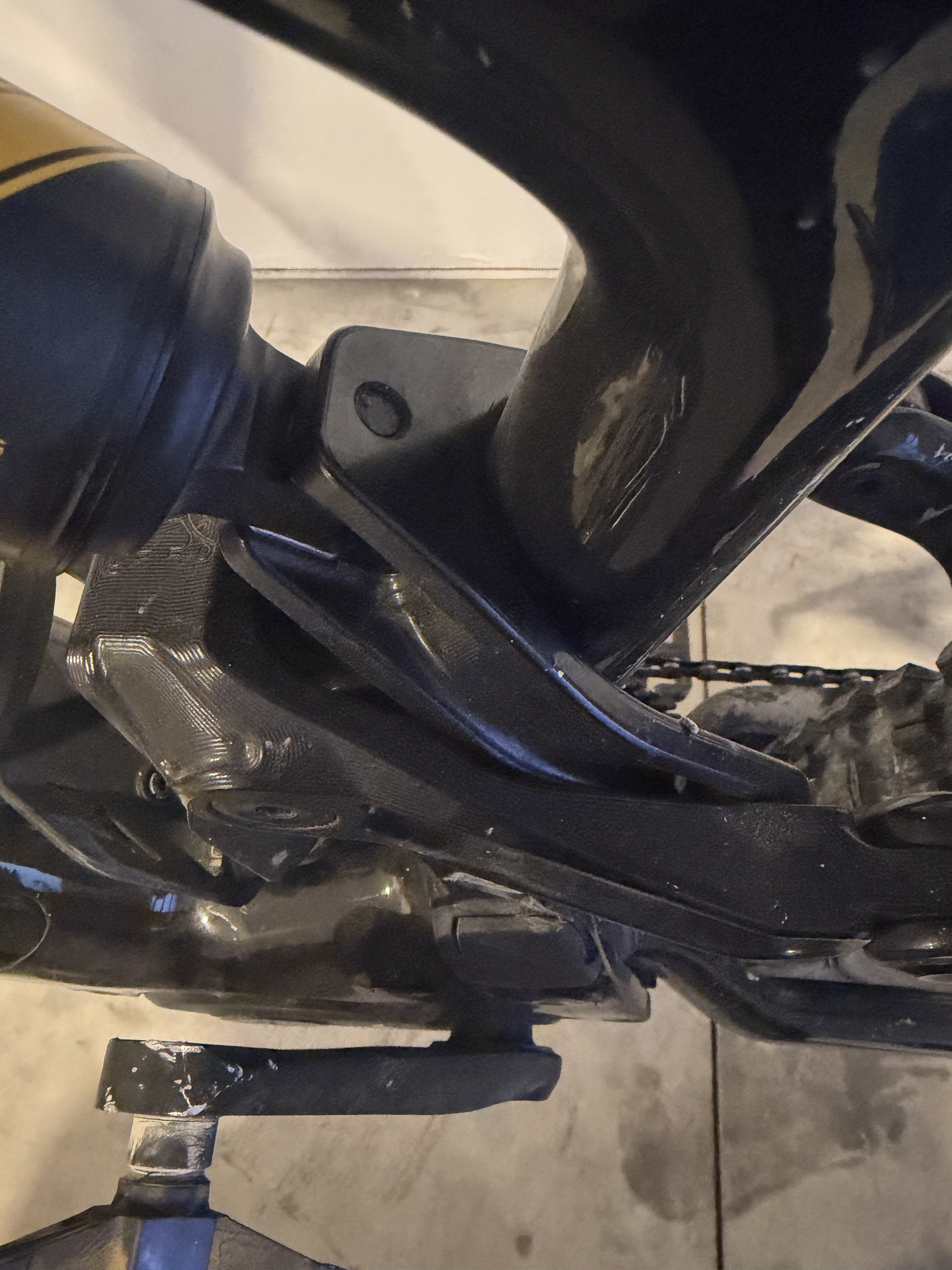

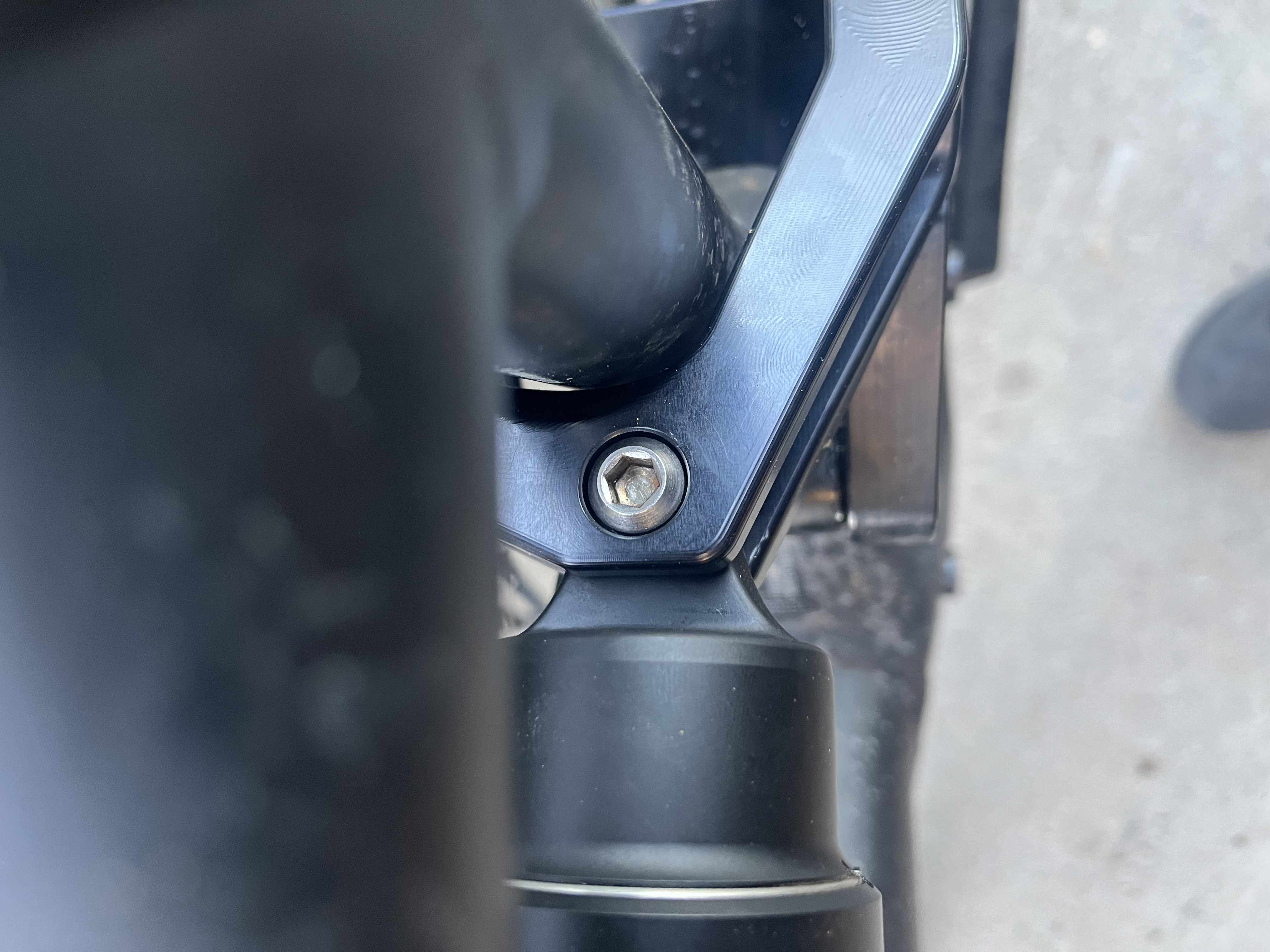

Installed the link, founds that link is fine upon full compression/ bottom out with a fox x2 however with full extension the link makes contact with the seat tube. Pics attached. Just a little confused as the bike is an s5. Wondering if I’m missing something
Happy holidays View attachment 171744

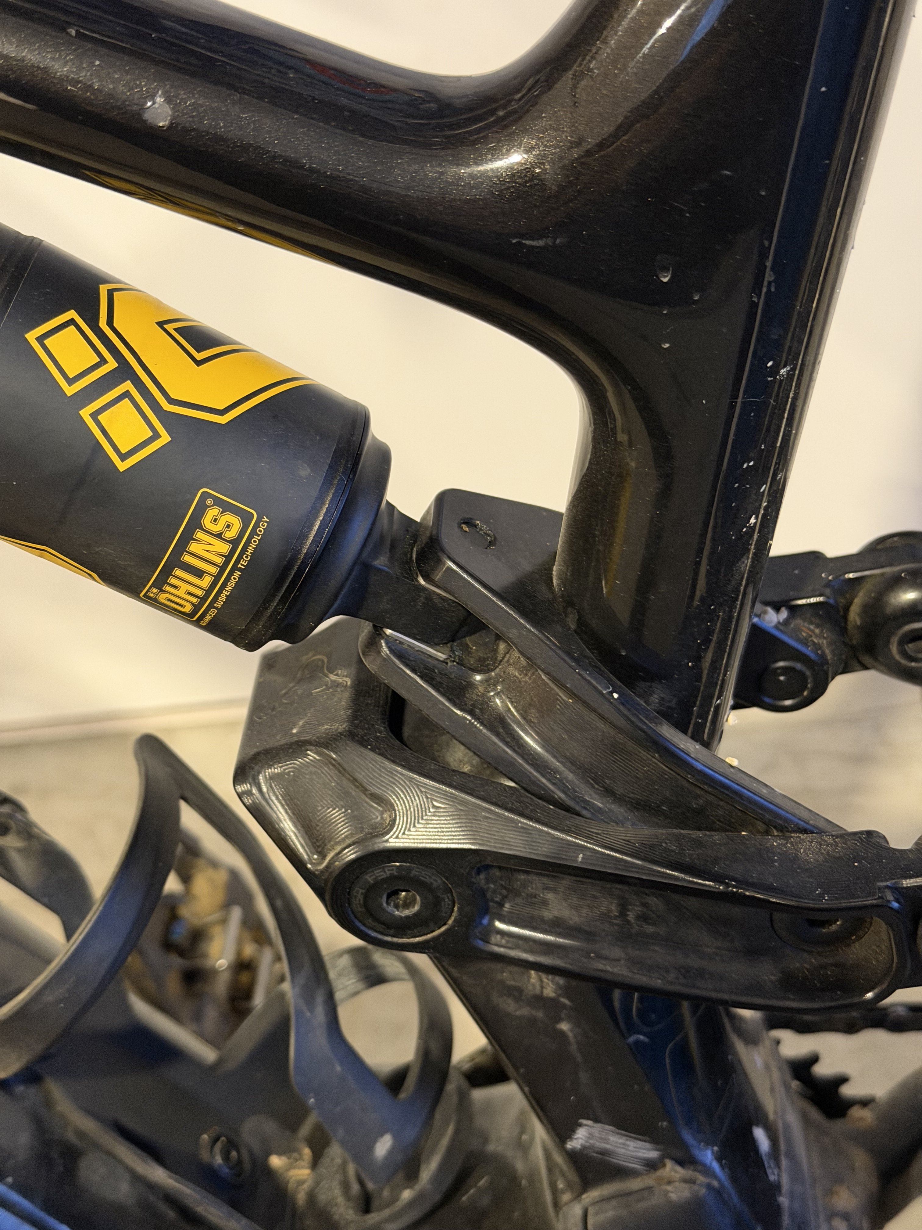

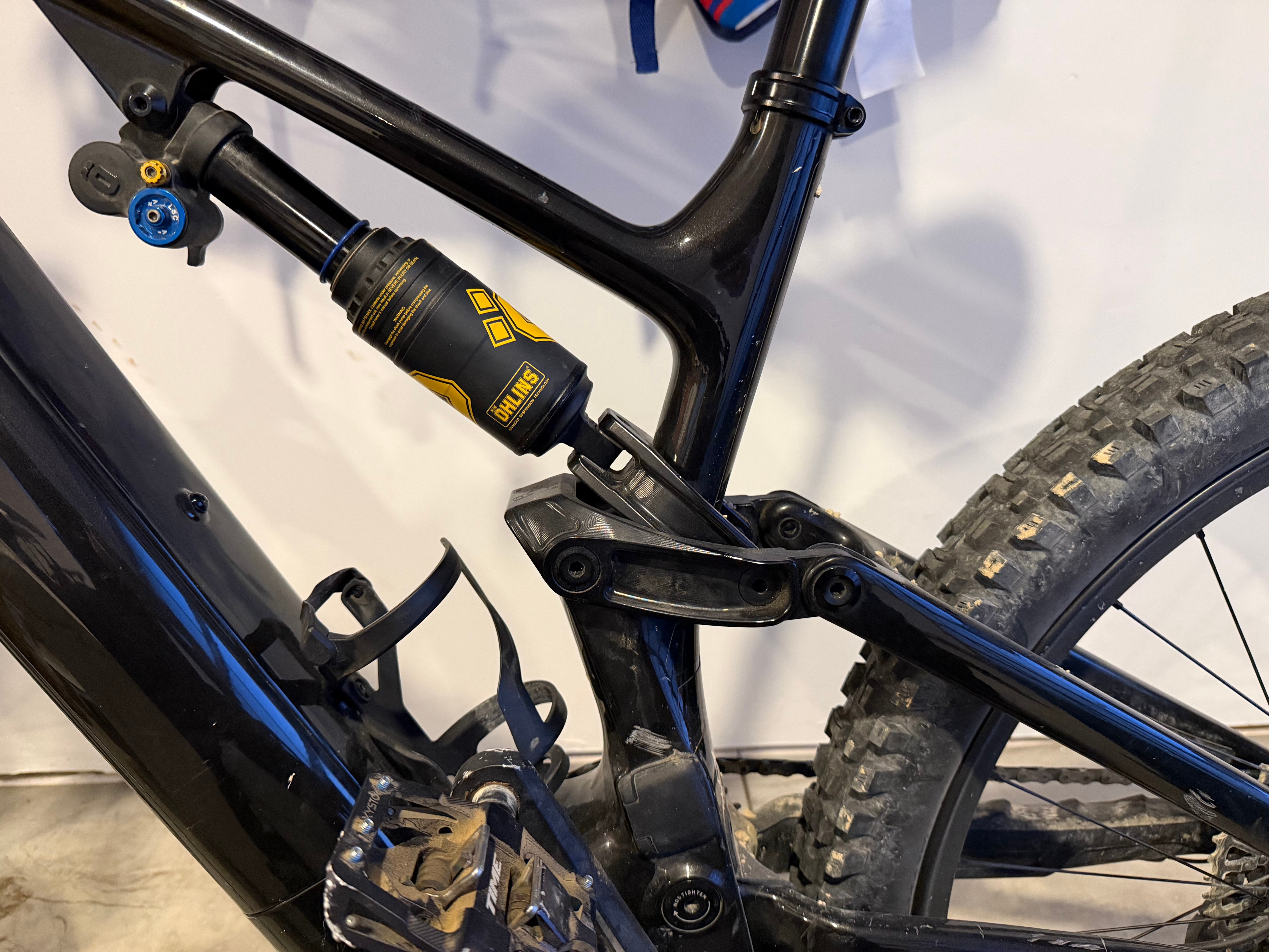

So I have a Levo 4 S4 with the long shock linkage and an Ohlins TTX2 230x65 shock and it sits as close to the frame as yours does. I don’t know if it’s actually hitting or not. I wondered if I did something wrong on install but it works perfectly other than where it sits at full extension. I’m snap some pics as well.
interesting Yeah looks just like mine as far as clearance. I rode it yesterday, doesn't seem to make contact with the frame consistently however I was riding some pretty gnarly stuff yesterday and undoubtedly heard it make contact with the seat tube once in a section with repeated hits. I did get a reply from cascade and the solution was that I need to use an offset bearing for it to have better clearance. So i bought one to see if it makes a difference. Somewhat disappointed with that being the solution. Also was told this issue is "rare" which is appearing to be a complete load of BS.

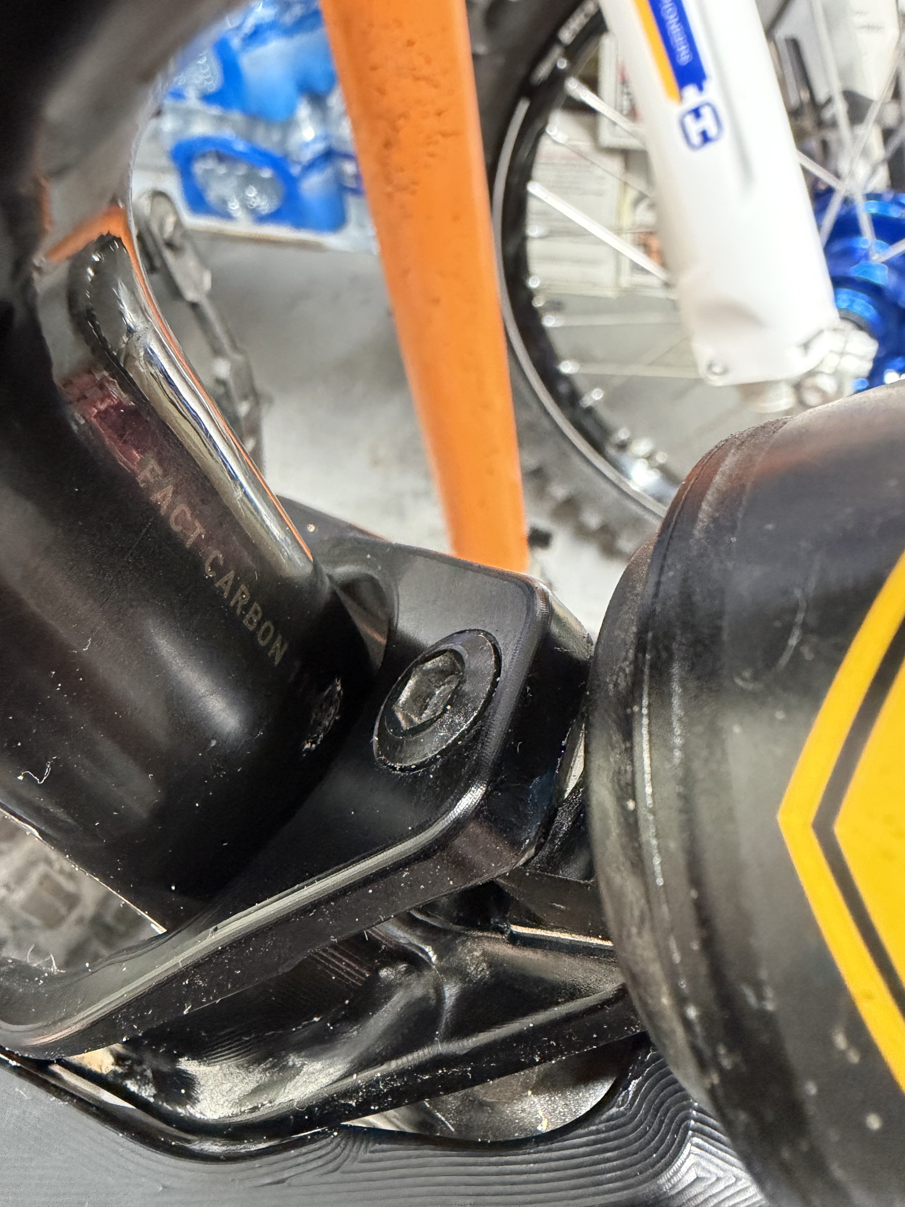

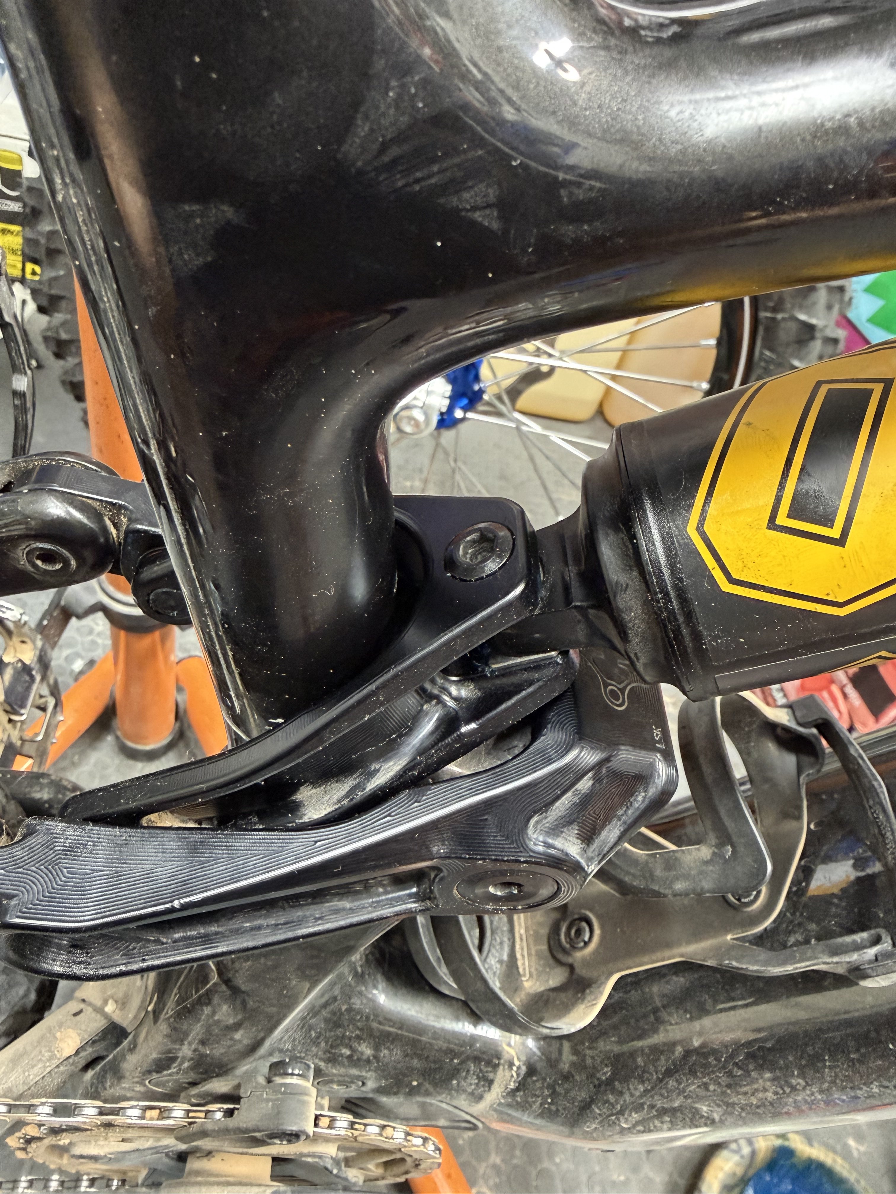

@Jroehlk106 I got a response from Cascade yesterday as well and they said to check and make sure the shock is actually a 230x65. There are some mfgs whose tolerances aren’t that tight and the shocks are actually longer than they are supposed to be. I’ll be checking the eye to eye length when I get back from this trip.
No mention of an offset bearing was made to me. Is that because we have different year bikes?
this is a possibility. However, I am not privy to buy a new shock just to see if it makes cascade's link more compatible with the bike. If I'm going to buy a new shock, I might as well just buy a coil for the original link. I have a float x2 that is older, and FOX's QC isnt the best so it very well could be the issue that there is some sort of extra travel even though it is a 230x65 shock

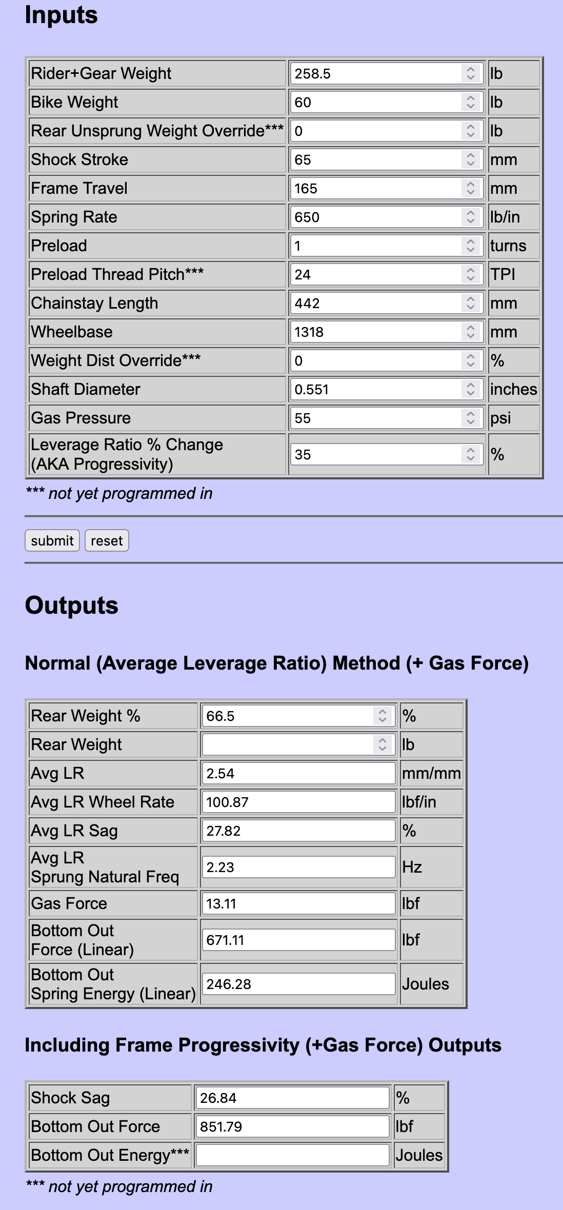

After much searching I’ve found that this is by far the most accurate “spring rate” calculator. It takes some work to get an accurate result and it’s a bit of a guessing game as it does not output the spring rate for you, but calculates the sag for a given rate. You need to put some time weighing things to get the best numbers. I got the weights for myself, my gear, my wheels and complete my bike to get this data. The screen shot below i
Includes figures for a S6 Levo with an E-storia shock.
