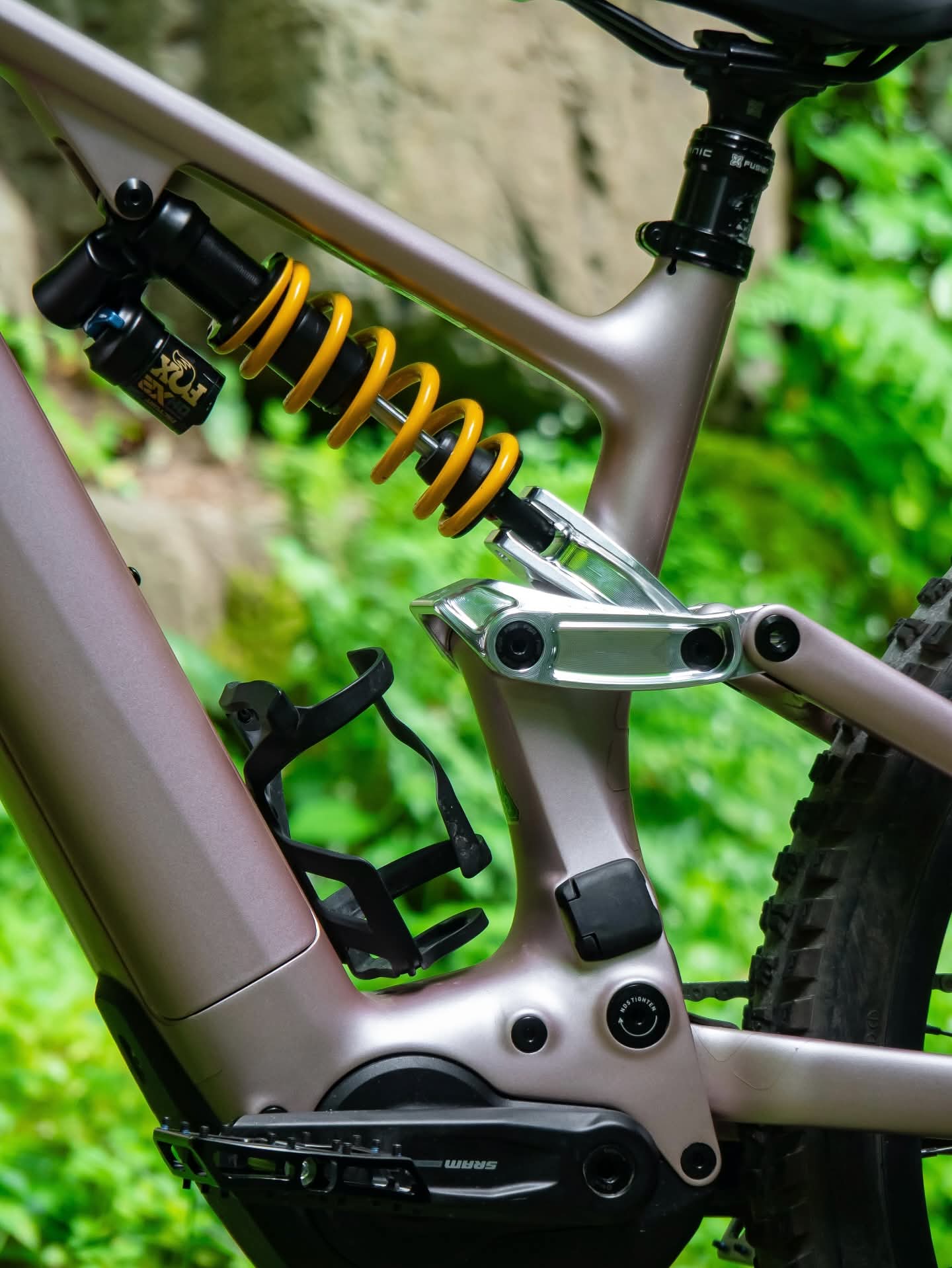

2025 Levo Long Shock Kit
230mm shock -> 170mm of travel
so you say this one fits also the Gen 4 Levo? What frame size are you running and what are your impresssions? Also running the gen 4 on a coil... how's that going?
Sorry for the confusion... The photo I shared is of an upcoming long link for the new Levo 2025, stolen from a Facebook post.

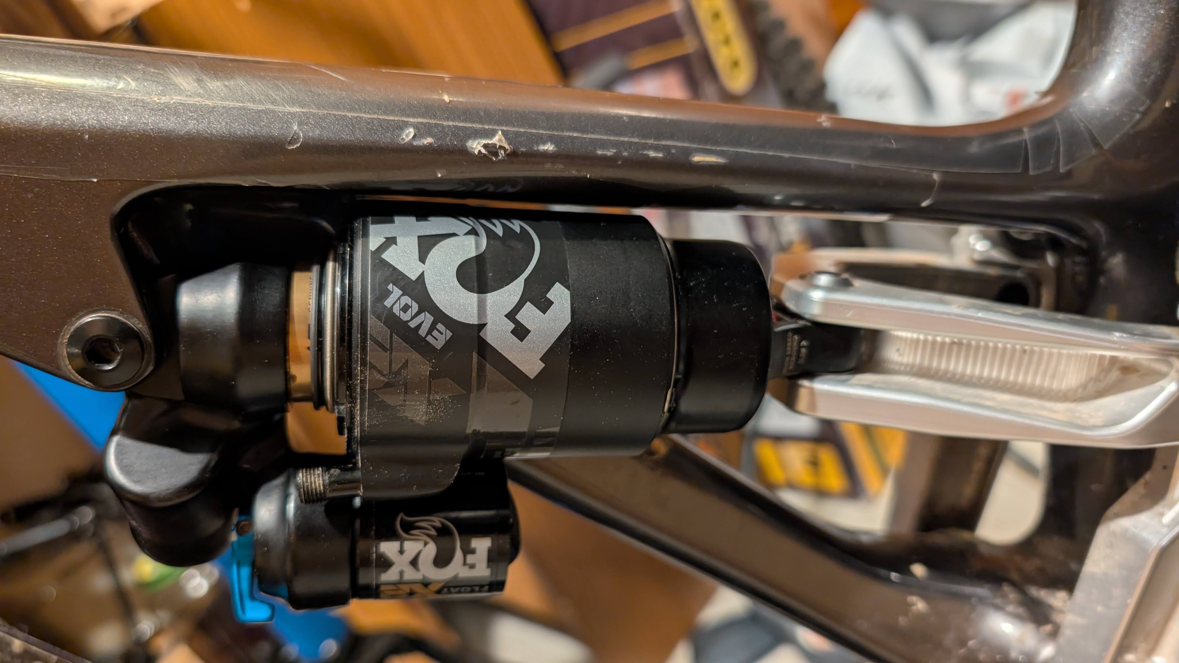

Am I stupid or is this 230/65 shock air can differently aligned in terms of the valve location compared to the stock shock and I can't align it how specialized aligns it on their bikes? Is this an issue or is the shock not properly assembled?

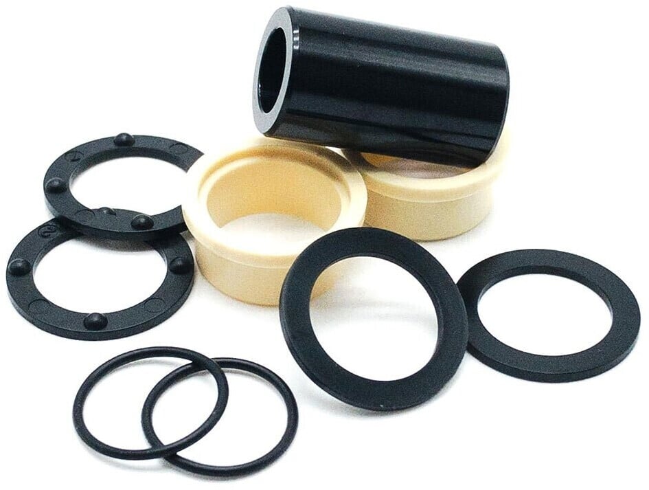

Did you use the fox bushings with the crush washers with the knobs or the silver rings provided by offsetbushings?

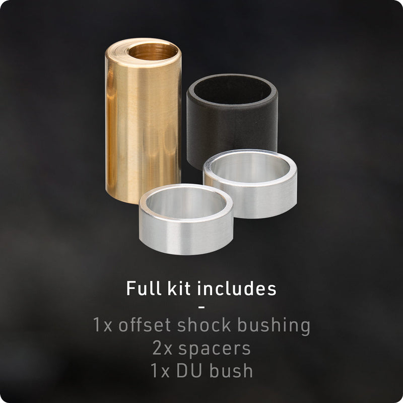

PS : Side question, which bushing kit do i need to install ? i get lost with all the dimension..

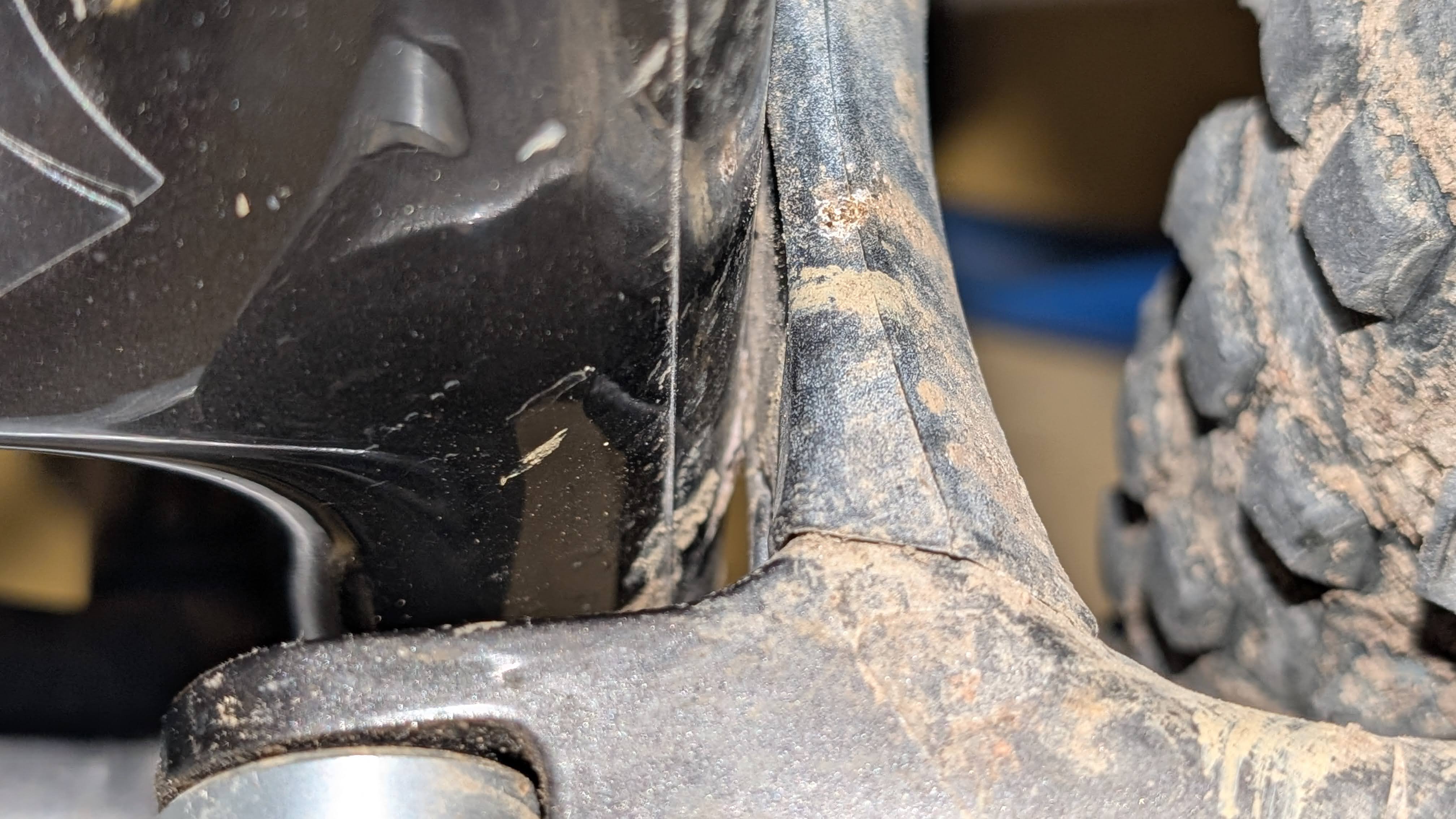

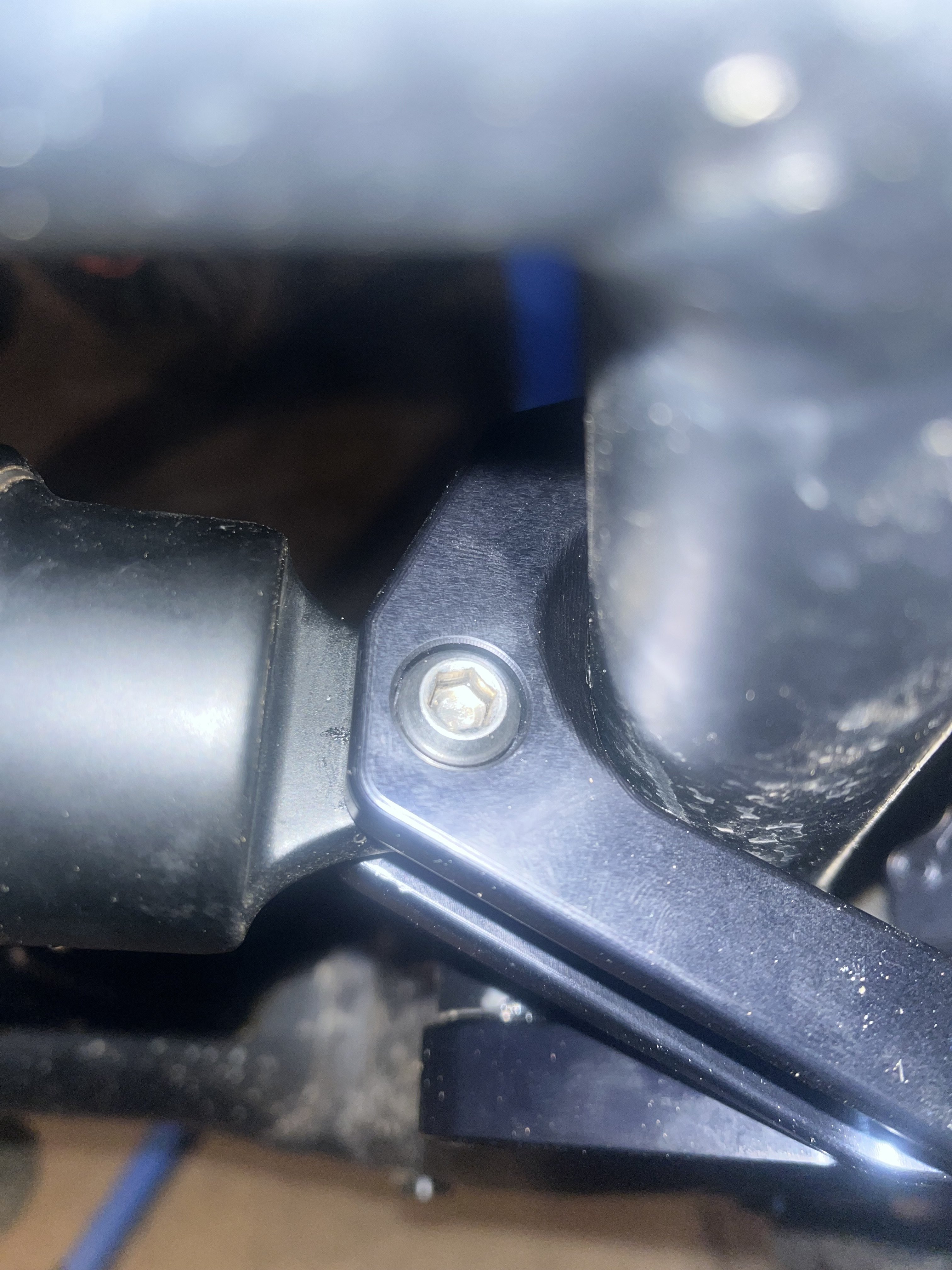

Reviving an old thread here. I bought a new 2023 alloy levo s5. First ebike! Love it! I bought the cascade long travel link. I followed this thread very closely. I don’t expect any issues even verified compatibility with cascade components and the alloy frame since there were 2 versions.
Installed the link, founds that link is fine upon full compression/ bottom out with a fox x2 however with full extension the link makes contact with the seat tube. Pics attached. Just a little confused as the bike is an s5. Wondering if I’m missing something

I assume the linkage is the correct way up?
Edit. Actually it looks correct.
I assume the shock is correct size.
I have an s5 too with a rockshox super deluxe ultimate coil. I don't have that issue.
Strange.

Thanks for the reply. Yeah the shock is 230 x 65. The more I think about it, the more I realize the stock linkage doesn't rest on the frame even with the stock shock out. So i'm perplexed as well. I will continue to tinker and report back
I assume the shock is bolted up on the front end yeah? And no offset bushings or anything weird.
Could you provide a picture from a wider view to get the whole thing in?
I cant imagine why it would hit frame on that. The only reasons I could think of are that:
Shock is somehow longer than 230,
Shock not bolted to frame
The plastic spacer/washer things that sit in the bearings (if I remember right) might be missing.
The wishbone part of the linkage is somehow machined too short.
I'm just thinking random stuff out loud here :D

Yea I was wondering the same, if somehow I got a previous version. I reached out to Cascade, but I don't expect to hear from them until next week. There can totally be some user/installer error here. I will post pictures ASAP another set of eyes is really appreciated
edit: I don't believe I missed any washers as everything was transferred over to the CC link as I disassembled the stock link and there was an equal number of parts. The shock I am pretty confident is the correct size. It says the size on the shock, and it was initially on my 23 megatower before I removed it to have it serviced. That bike will MAX take a 230x65 with a stock size of 230 x 62.5. This x2 was the longer travel upgrade i bought. I made to sure to have the DU bushing rear with the aluminum washers, and the front 8x20
