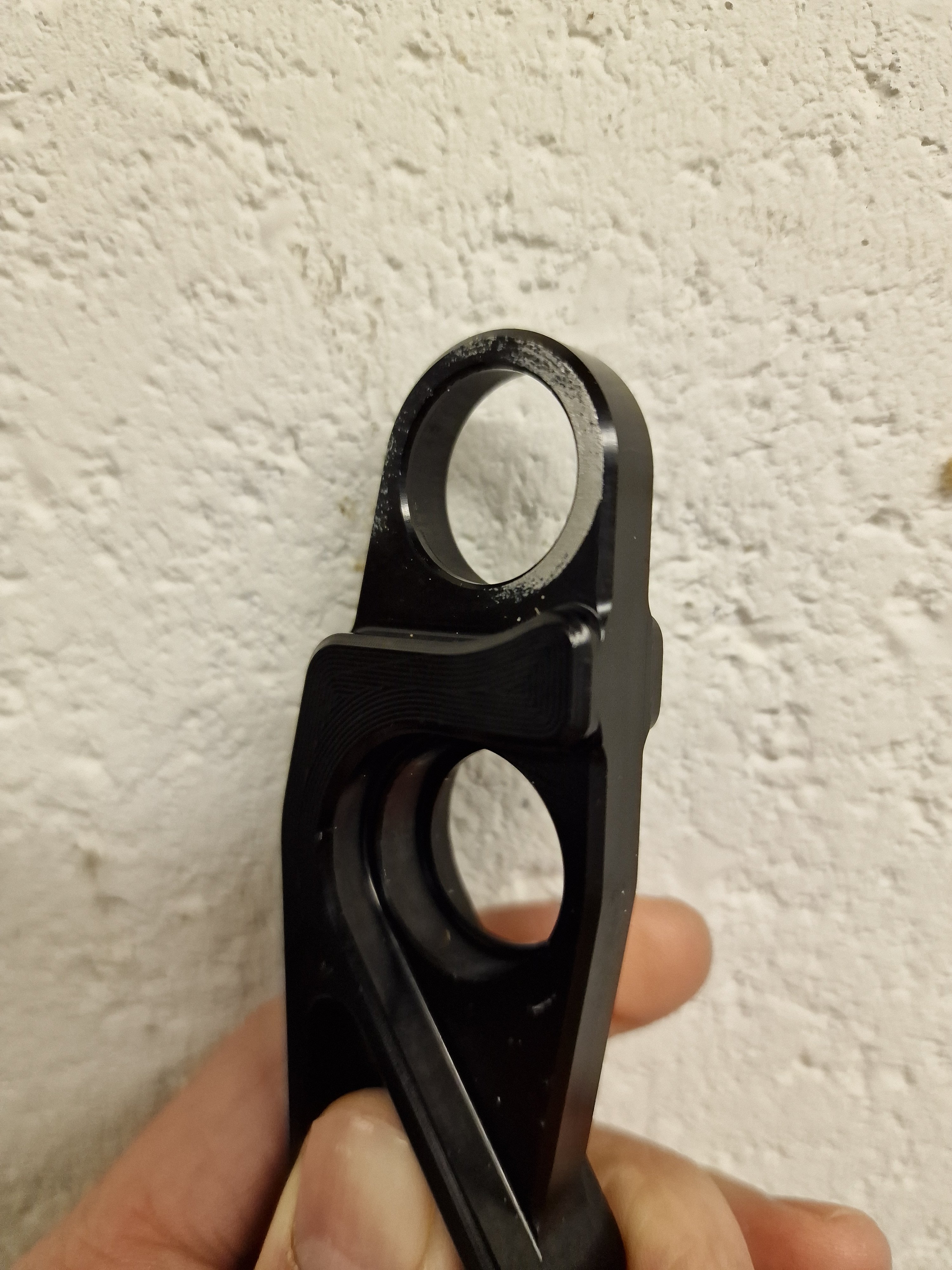

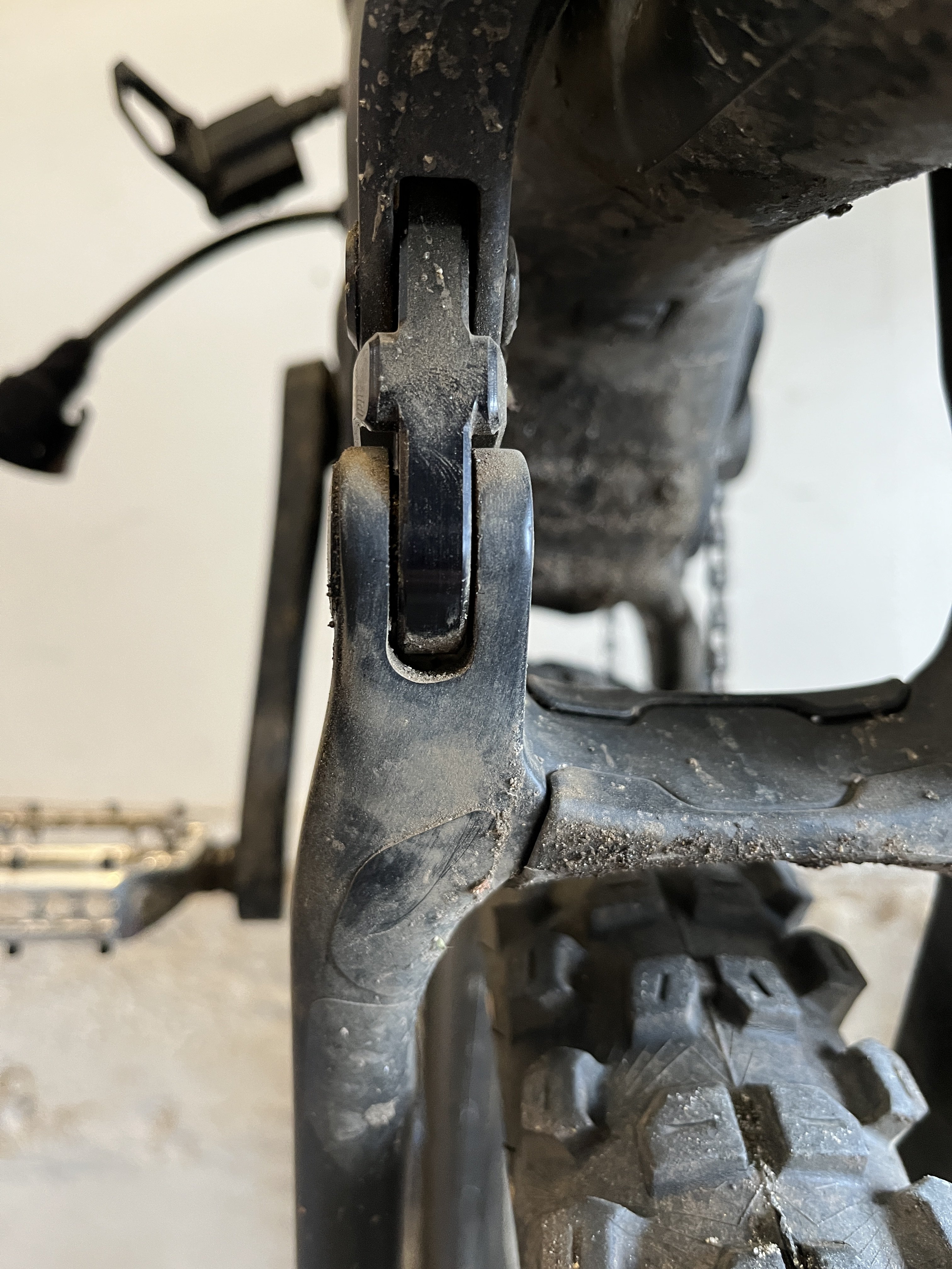

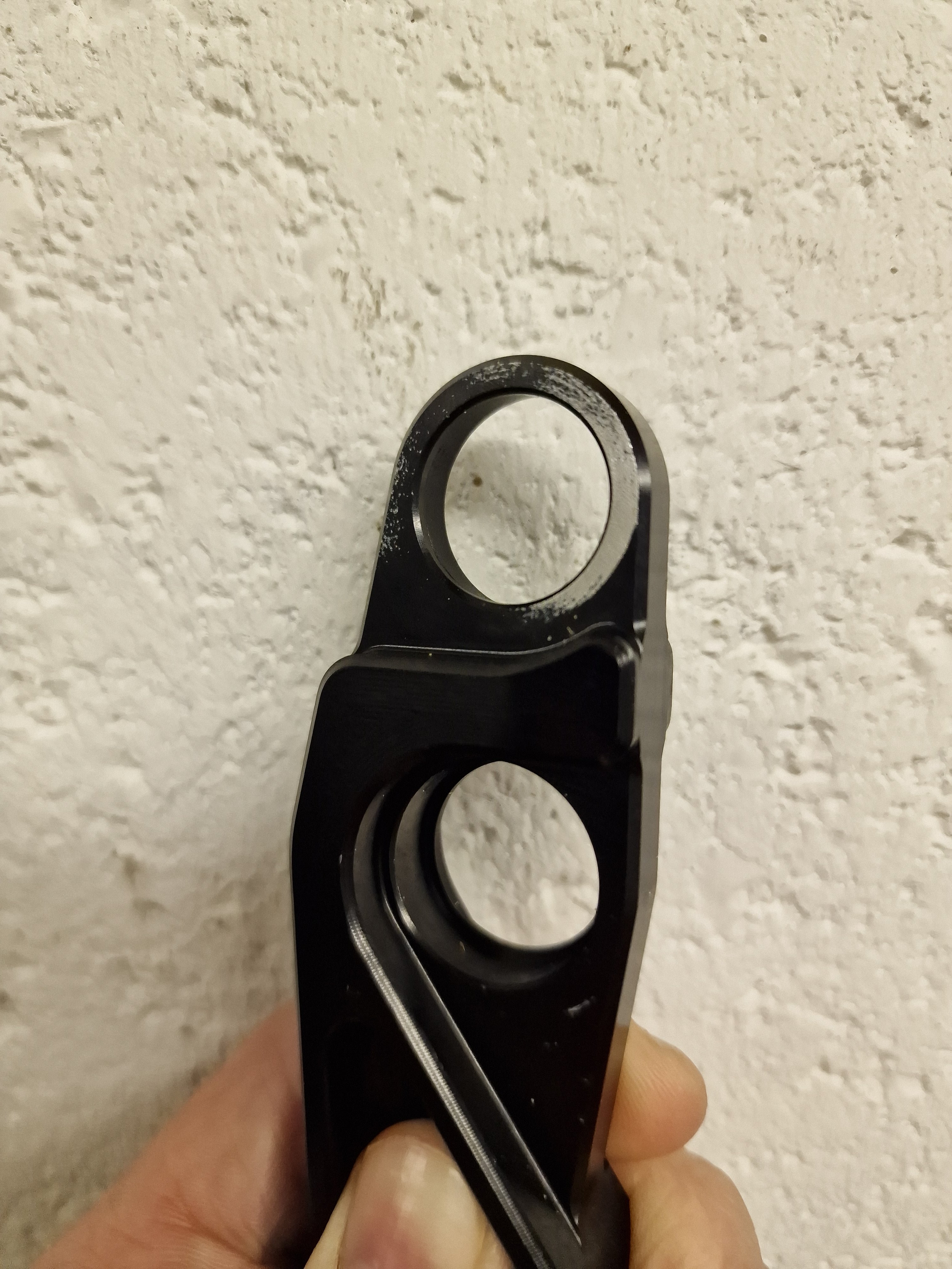

Anyone else having issues with the rearmost bearing in the link slipping so that it's not fully seated? I'm referring to the bearing where the link connects to the seatstay. It doesn't move much, maybe 0.1-0.2mm, but it's enough that the link then rubs on the seatstay, and makes noise on every compression over about 50% travel. I'm having this problem on both the stock link and the Cascade link. I've already tried using Loctite primer & bearing retention compound. Basically, I can get this bearing on the non-drive side to move within 1-2 rides of riding aggressively.
I looked at my buddy's Levo and his appears to have moved also, but he hasn't noticed the rub noise. I'm wondering if this is a common issue, and if there's a long term fix. I reached out to Cascade and they asked me to send the link back so they can check the bore tolerance for the bearing seat.

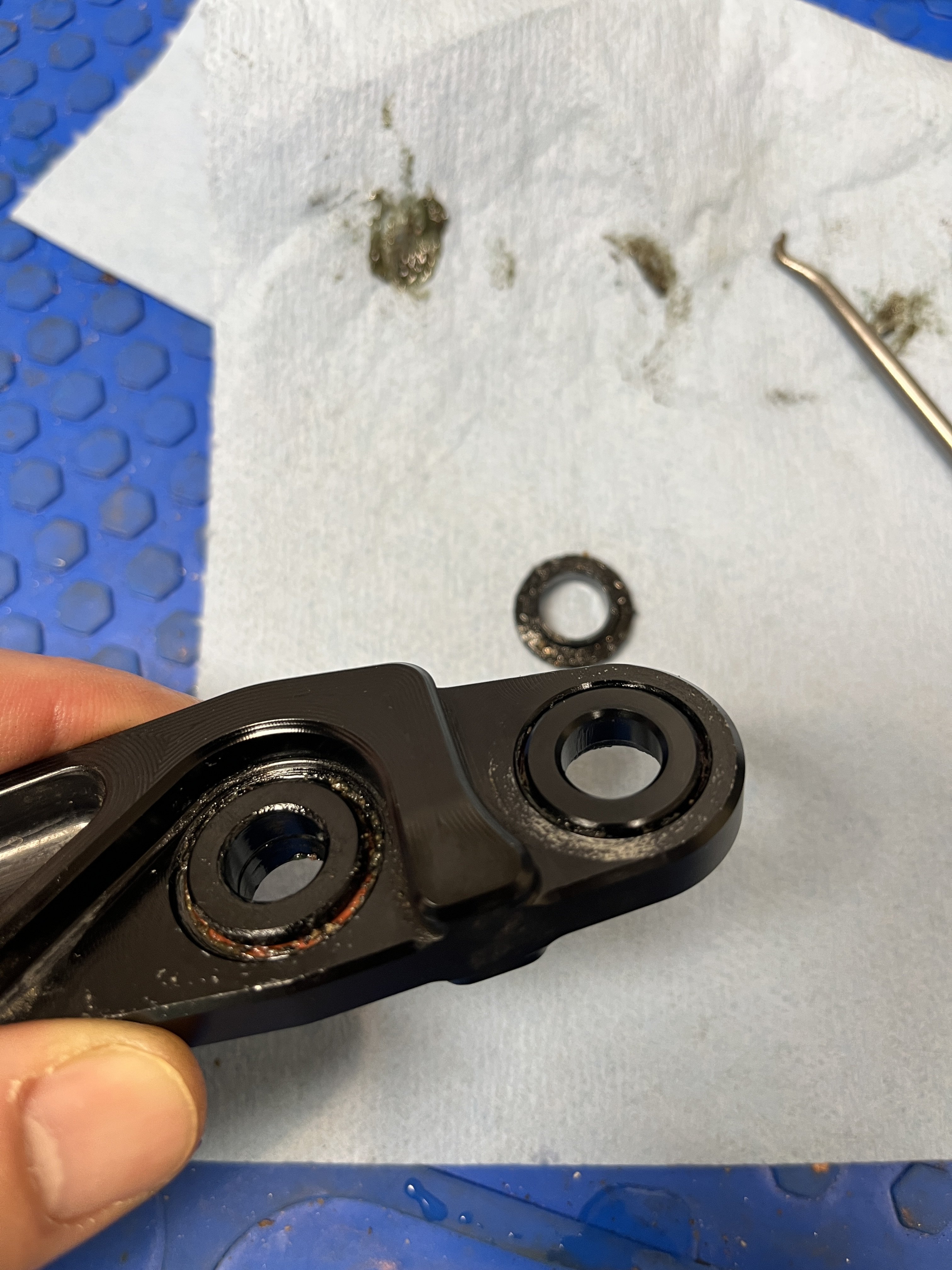

Came to contribute and say thanks as I've found this during a bearing replacement.
My cascade link has done the same, bearing was on an angle. I've used the retaining compound mentioned here. Will see if that helps. Bikes ridden poorly for a while so hoping this is why.

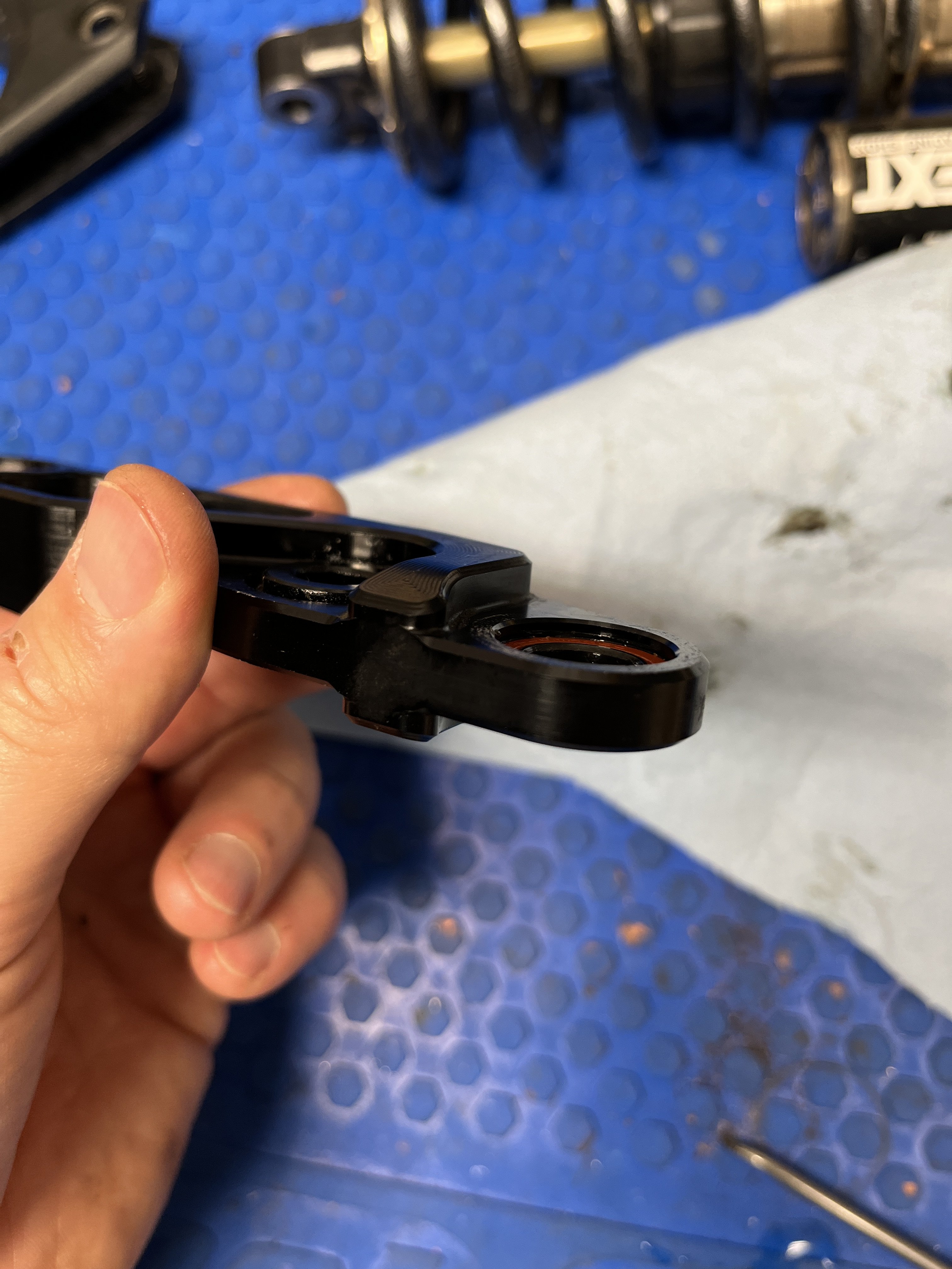

After second round of reinstalling using green high strength retaining compound, my bearing appears to to finally be holding in place. A few steps I think are probably key:
* thoroughly degrease the outside of the bearing and the bearing seat with isopropyl alcohol. I kept doing this until a shop towel stayed clean after rubbing it dry.
* prepare the outside race of both the bearing and the inside of the bearing seat with preparation compound
* liberal application of retaining compound in the bearing seat. wipe off excess after bearing installation
