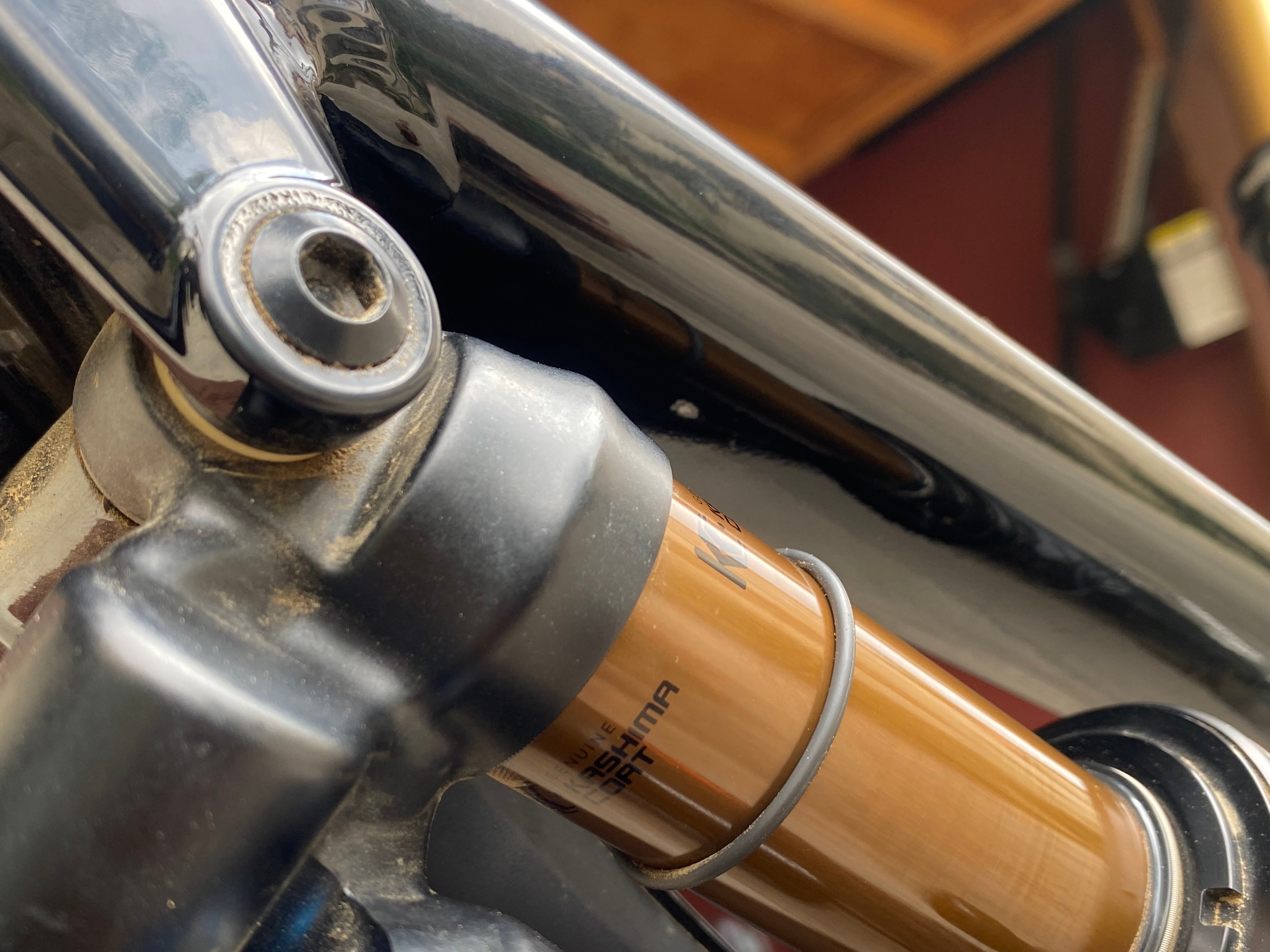

I haven’t installed my long link kit, it’s still in the box. Cascade put the disclaimer up about certain shocks hitting the frame so I’ve been debating on what shock I wanted to experiment with. I really wanted to try the EXT Aria but that’s an expensive investment for it not to work.

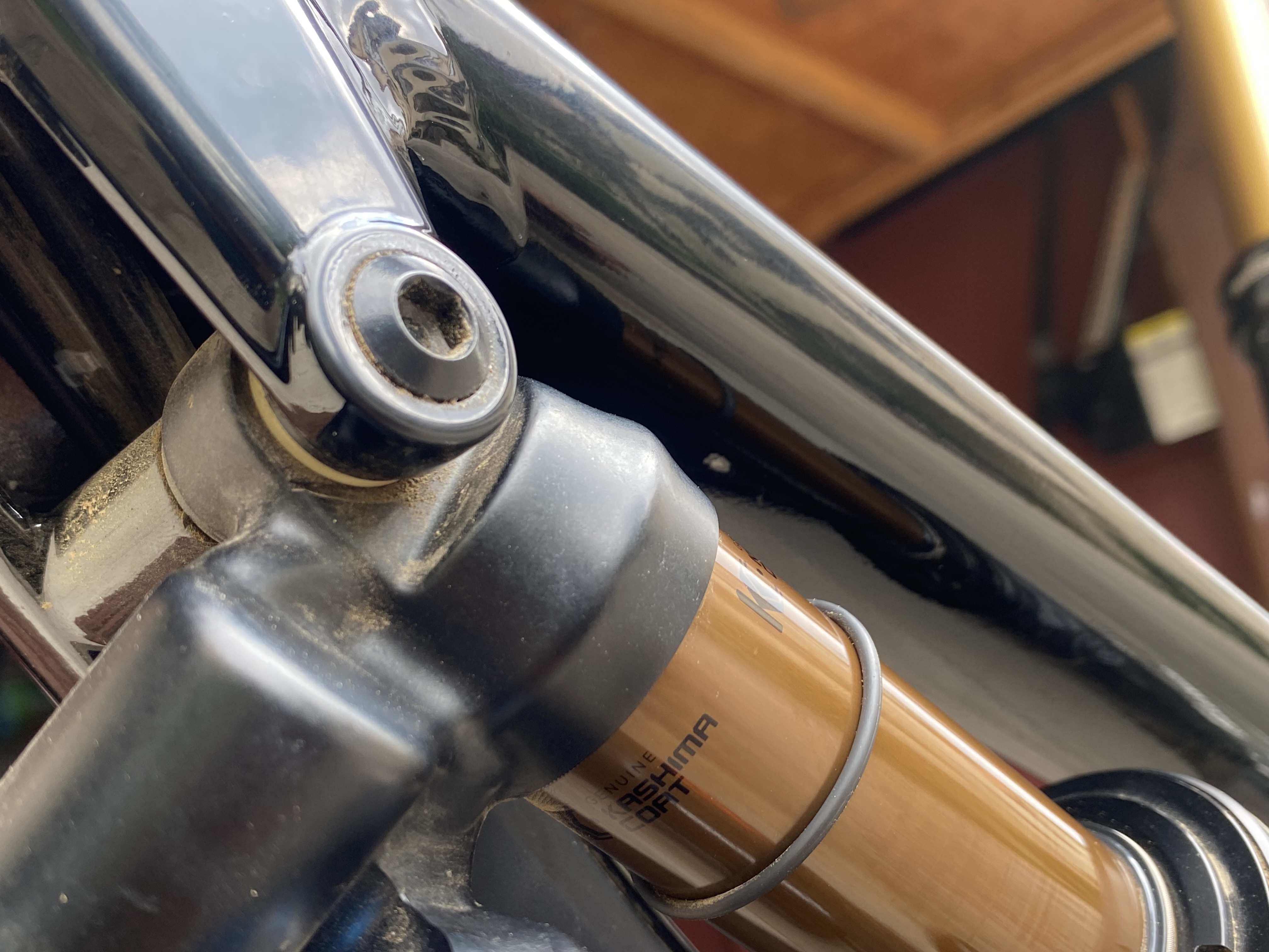

I thought the disclaimer was for S2 and smaller. I’m pretty frustrated at this point but the setup works so well that I’m inclined to keep messing with it until it’s right. It really is transformative the way the bike rides now. I had some issues with a CC link on my SB 150 so this is not totally new to me. I ended up making a custom spacer for my push 11/6 to shorten the stroke slightly. It works very well now.

Yeah, Cascade only listed the S2 but you’re the 5th person that I’ve heard of with an S3 that is having the rubbing issues. I’ve not heard of any S4/S5s having any, it seems to only affect the smaller sizes. I may give it a go, just hate to order a shock at full price then it not fit and have to sell it at a loss.

Hallo, I use a long link on Expert size S2, with a Ohlins ttx22 M2, without any problem, a friend has long link on s3 with EXT e-storia and also in his case he didn't encounter any interference problems with the frame.
If you really want the X2 then get a 230x62.5.....?
Or any shock for that matter in 62.5?
I didn’t think about that, @JacMc2112 have you tried reducing the stroke to 62.5? I wonder if that would solve your issues with the shock hitting the frame. I doubt you’d miss the 2.5mm of stroke.
I had an x2 230/65 with suitable shim for the Cascade Link to hand over, ridden 8 times. Works perfectly.
Certainly, open a support ticket with Cascade. They need to know about this problem. As mentioned, there are like 5 people here having this problem, and we aren't that big of a group.
I know when I talked to them this spring, they had mentioned they had some changes coming hence why they now have different colours. I personally suspect the link is slightly different in the last two months. Cascade tells me they think Specialized started making the shock hole in front a bit higher, but my Turbo Levo is a mid-2022 build date it isn't a 2023 or late 2022, so that doesn't make sense. But I do buy that Specialized might not always build each frame to the same specs within a couple mm.
So the wear marks on the X2 sticker indicate that 10mm of the shock come into contact with the frame. Reducing the stroke by 2.5 mm might help a little but I think it will still contact the frame on full compression. So at this point to avoid a cracked frame later I’m gonna go with a super deluxe coil or Ohlins. The Super Deluxe is 4mm smaller diameter at its widest point than the X2 which should be plenty. If you have an S3 or smaller I would avoid large volume air shocks like the X2 or Vivid. I’m not sure the width of the Aria.

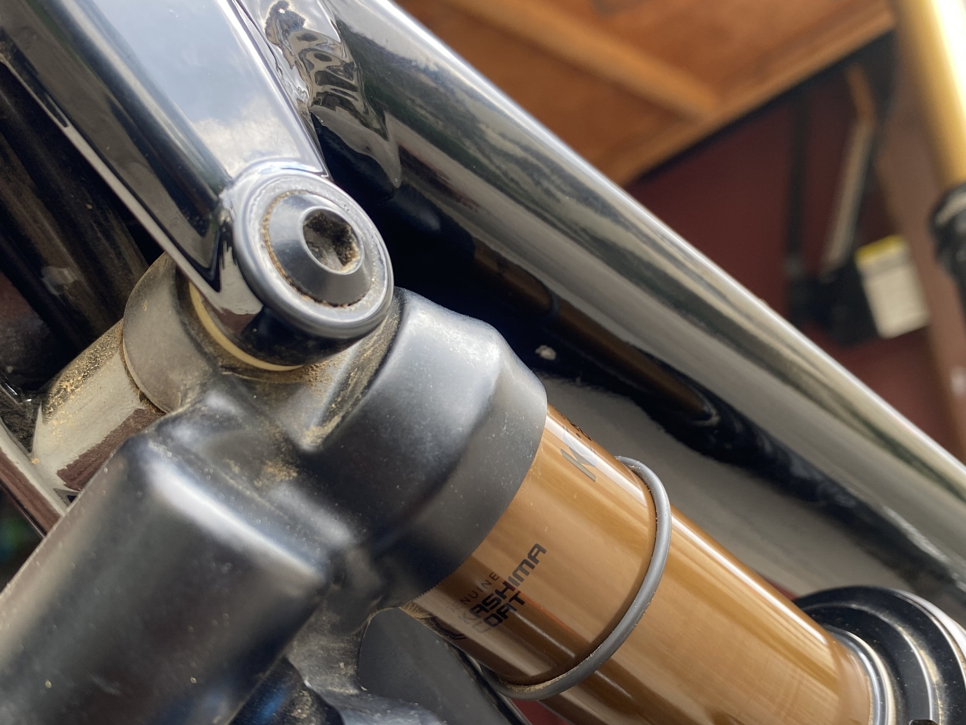

Hey everyone, I’m a newbie to this forum but been lurking for over a year. I finally pulled the trigger and bought a 2023 Specialized Levo comp alloy and bought the cascade long travel linkage as well as a Fox X2 shock to upgrade from the stock.
Long story short, after getting everything installed I noticed my shock is starting to rub on my frame. Has anyone else seen this before?
The eye to eye measurement is correct and everything is torqued to spec.
I’m running extra PSI to help compensate.
I’ve spoken with Max from cascade components but still haven’t gotten a solution then refunding the linkage.
Here’s some pic of the frame rub
See all the above posts of X2 owners reporting the same problem. Also, what size frame?
