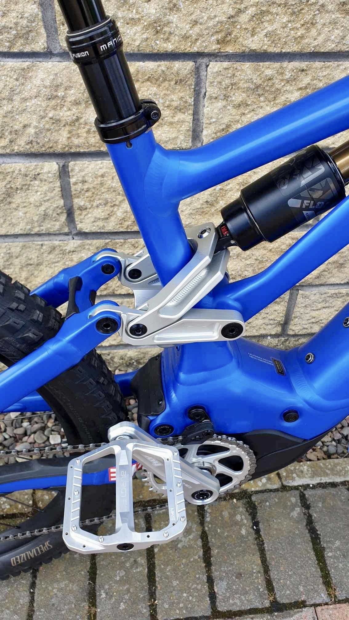

I should have my Nomad built up in about 2-3 weeks just need to finalize the wheels, can’t wait to test that beast
Cascade LT kit
165mm EXT E Storia
180mm Vorsprung Smashpot Fox 38
Headset in 0 degree and rear in low mode
SQLabs 35mm stem and 12 degree backsweep bar no spacers under stem.
I set the Smashpot to 180 assuming the bike would sag deep given the high weight of the bike.
Running great so far, very good steeps, endless travel and support on large doubles. BB is likely higher than usual until sagged.

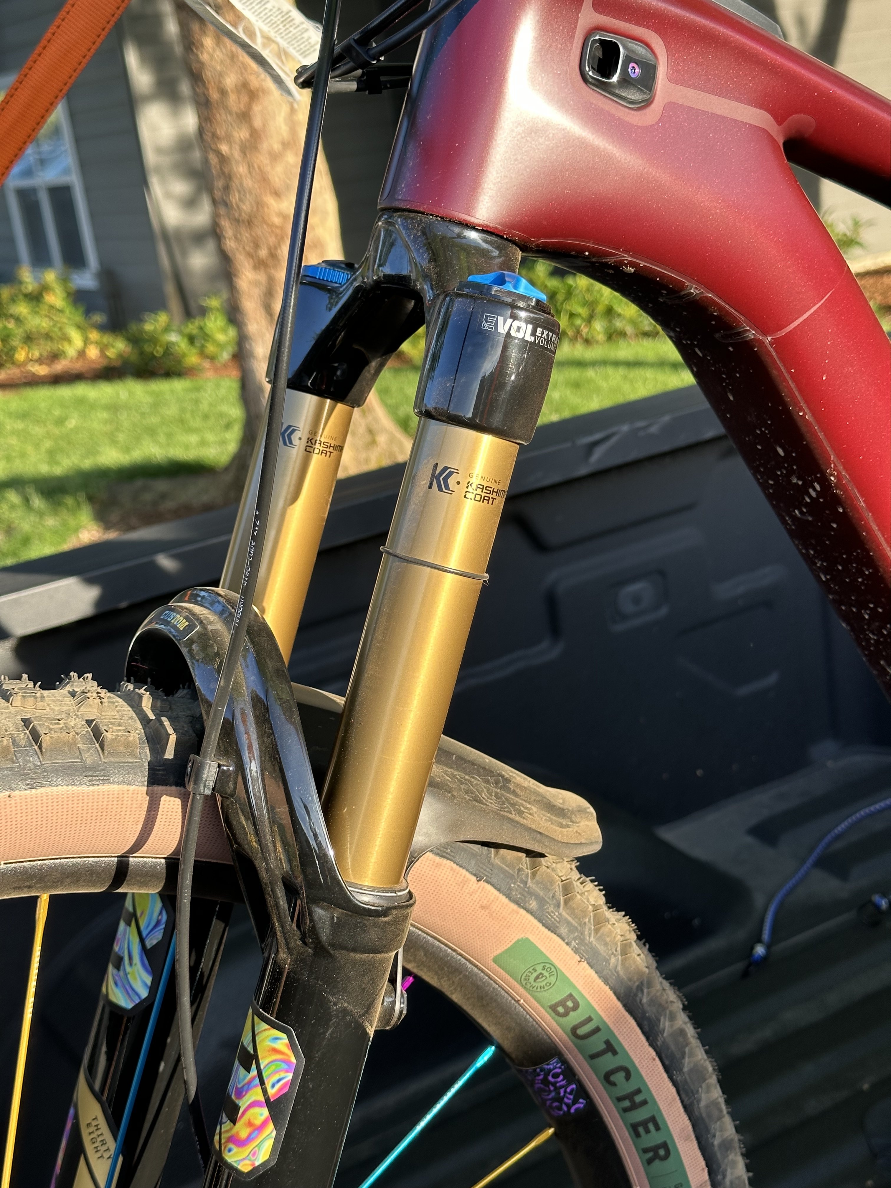

Today was the first time riding after a few changes, some listed above. I was not happy with the harsh feeling Fox 38. As recommended by some of you, I upped my pressure from 87 to 100psi, this brought be down to about 21% sag.
Yesterday I also took the lowers apart, disassembled the air spring and cleaned all the excess grease in the negative air chamber and reassembled.
The fork felt much better today on the same trail I had rode before but not perfect. At least to the point I can tweak it.
However, even with some steep chunky terrain and jumps to flat I have quite a bit of travel remaining. I wouldn’t expect to use 100% but this is a 170 fork not a 140 haha.
Now normally my first though would be to reduce pressure, but I had just literally increased it.
There are currently two tokens (from the factory) in the fork, I was thinking of removing one of them.
I’m only about 160lb with gear.
Any thoughts?

Keep the higher pressure and start removing tokens. I'd be surprised if you needed any tokens as you are quite light.

Do you have a suck down condition on the fork? It will sit a bit deeper in the stroke at rest than a normal bike due to the heavy weight of the levo but 38s are especially susceptible to getting sucked down.
Are you calling me fat? 😂😂 yeah I’ll try that, thankfully it’s super easy.
I’ll have to check, I’m guessing yes. I know it did before I took the fork apart by maybe 2-3mm. But that was also at the lower psi (87)

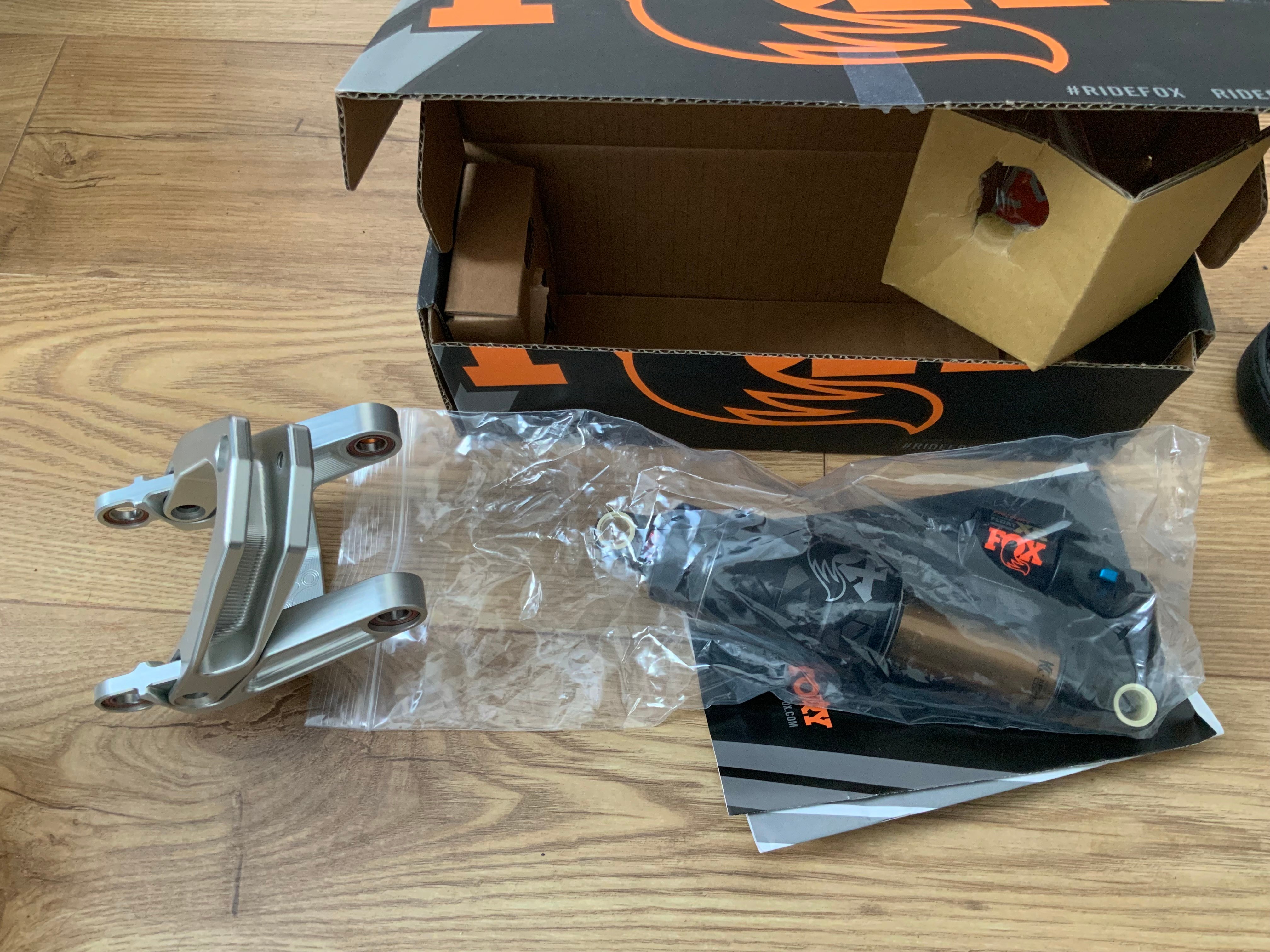

Have you guys needed to remove any chain links after installing the long shock kit?
I had the stock shock cascade linkage with my 11.6 and it was horrible, I did go up in spring rate. Went back to the stock X2 today and it was sooo much better
I now have the long shock link and a 230x65 X2 that I got from the Commencal website as that shock size is hard to find here in Australia at the moment
It’s tuned for a Clash DH bike, light compression and rebound tune, do you think it will be worthwhile getting it changed to a medium tune while the bike is at the shop getting the smashpot changed to 170mm?
Haven’t ridden the long linkage yet but don’t want to go back twice if avoidable
Thanks for any input.

I kept my chain the same length and it works fine with both set ups.
I'm currently running an X2 out of a Kenevo SL and that has a light tune. It works quite well and has just been rebuilt under warranty to 2023/24 specs so fingers crossed it lasts. I'll likely try the medium tune when I get it serviced again and take the 2.5mm spacer out too but the light tune isn't terrible. I'm still dialing it in so can't give a complete verdict just yet.

Went for my first proper ride on the new setup today. 170mm smashpot, long link with the Clash tuned X2, 155mm cranks, slack/low positions, 63 deg HTA measured.
Absolutely blown away, I think it does sit a bit higher as not even a hint of a pedal strike. And I used to get a lot with 160mm cranks in high position!
Handles and corners like an absolute dream, using every mm of travel front and back on large flat landings but feels bottomless.
Couldn’t imagine riding a better E-Enduro bike.

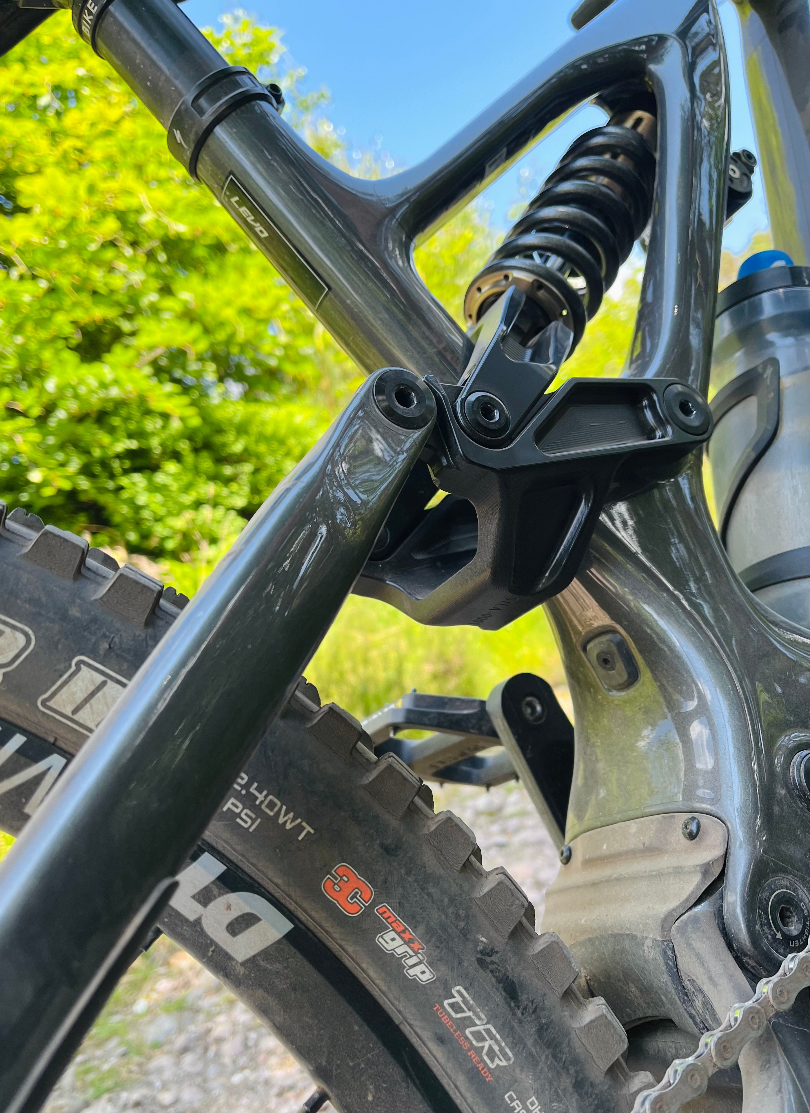

For anyone with the aluminum frame version of the LT link (the extra machined brace version), have you experienced any rocks or debris caught in the link bracing and hitting the seat tube?
If anyone needs a long travel cascade link in naked Alu (in the UK), I have one. Only used for around 2 or 3 rides.
