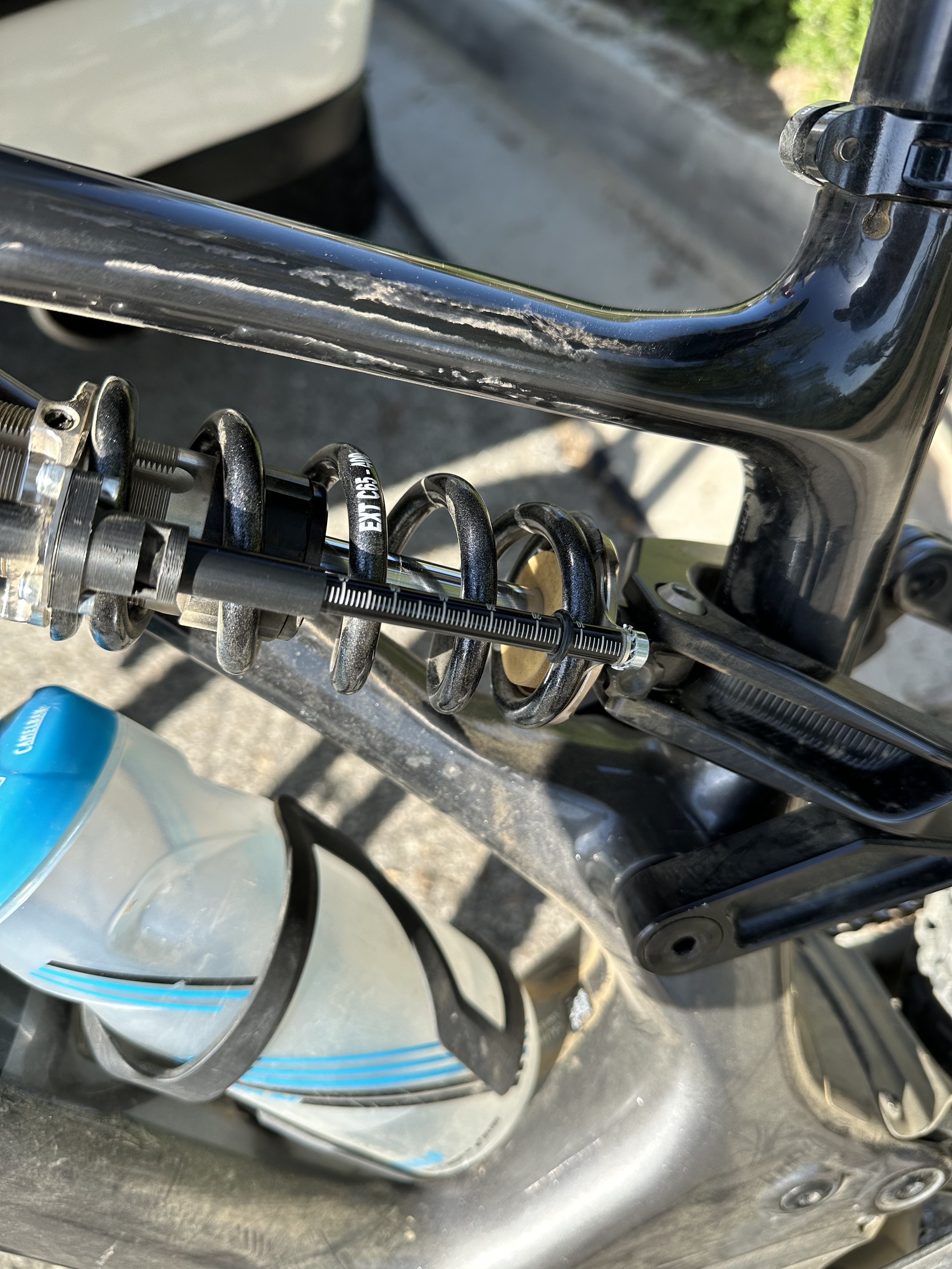

Levo Gen 3 Cascade Link 2022+ Levo Long Shock Kit
Rockshox says their 2023 shocks are compatible with all known bikes except the kenevo and Commencal Meta TR Power, even though the 230x65 shock uses an aluminum shaft.
That said, I doubt they’ve considered the gen3 levo with an aftermarket link when making that list.
Rockshox told me the 23 super deluxe ultimate rc2t coil is compatible with the stock gen3 levo.
Still waiting to hear back if they’ll give me the go-ahead on the 230x65 on a modified levo.
Source from Rockshox here:

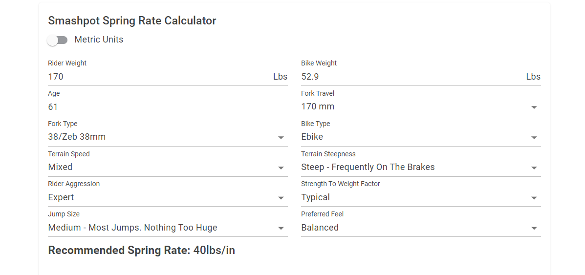

I'm 85 kg (187 lbs) and on my Fox 38 170 mm with Smashpot (40 lbs/in spring), HBO fully open, I cannot get last 30 mm of travel even while dropping to flat (see attached photo).

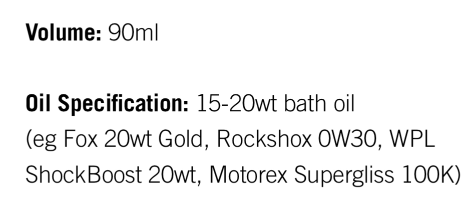

I will be moving 3 shims and switching to Motorex 10W (49.5 cSt @ 40°) from Fox Gold 20WT (100 cSt @ 40°). Hopefully this will help to get full travel out of my fork.

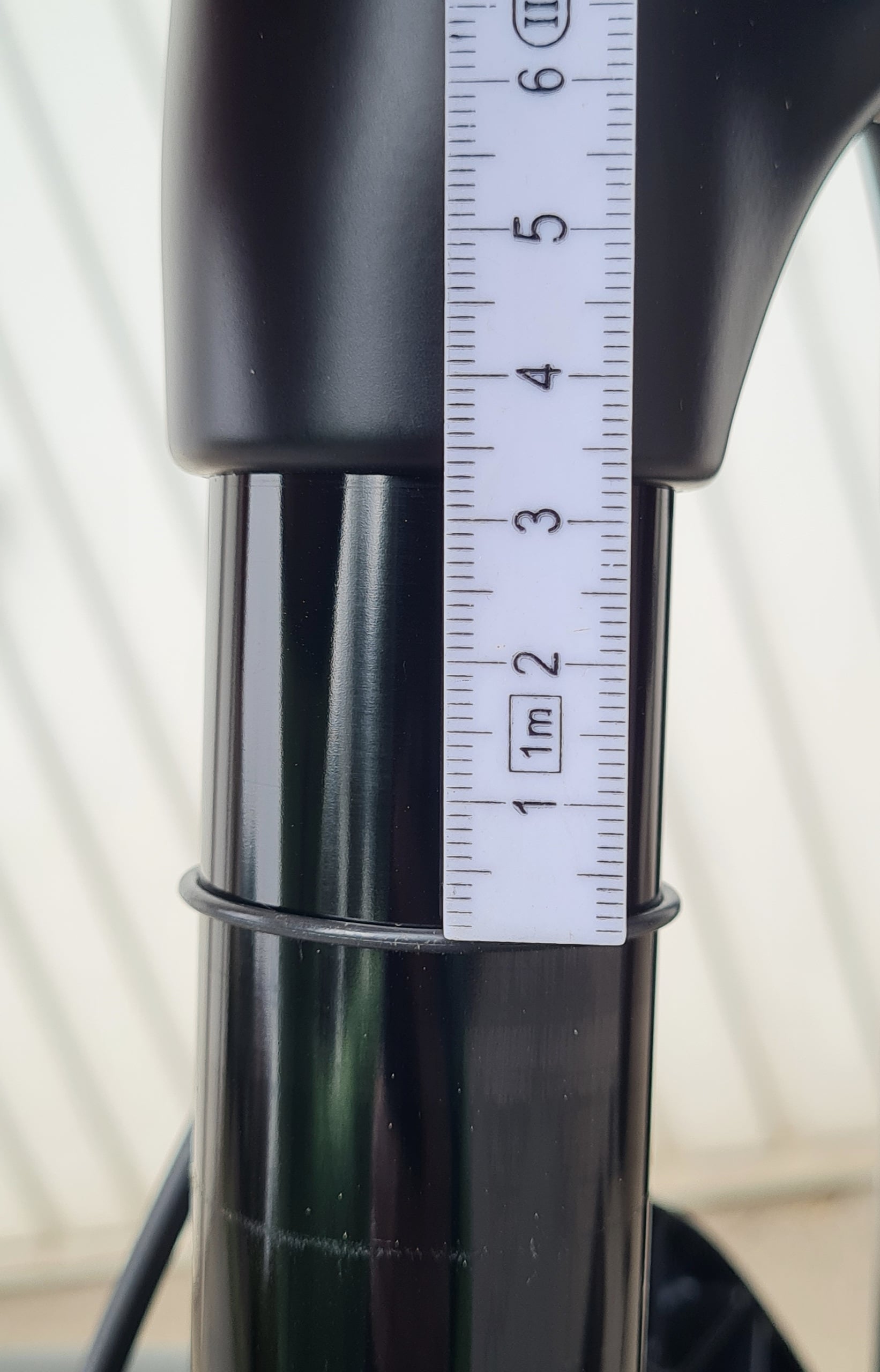

I still think FOX forks are over damped for riders under 200 lbs.
I think this will largely vary from rider to rider. I weigh 150 lbs and run a 45# spring in the 160mm 38 on my Levo with HBO 4 clicks out, and a 40# spring in the 170mm 38 on my Kenevo SL with HBO 12 clicks out. I use full travel on both, even with 120mL of Fox Gold oil for extra ramp up, and that's with the stock shim setup.
I agree though, that it takes a huge amount of force to bottom it out at 170mm - With that much travel, there's a ton of ramp up from the air compression (it's still a sealed chamber with air). When I say I use full travel, I don't mean all the time. I'm only using ~85-90% of my travel most of the time, but it's just a few particularly harsh huck to flat landings in my local park that I optimize bottom out support for, so I don't break my wrists.
Why did you use Fox gold and not use the oil (or one close to the specs) that Vorsprung recommend?

I decided to try a coil in the front so I order a smashpot with a 40# spring. Have been told the dampener may also need to be modified ?

Also just throwing this out there, since most guys don't weigh less than me - I weigh 150 lbs and run a 45# spring in the 160mm 38 on my Levo, and I run a 40# spring in the 170mm 38 on my KSL, and I for sure wouldn't want any softer. I'm right on the verge of going the next spring rate up.
Yes I am a little worried about a 40# spring but that's where the Vorsprung calculator ended up. Have you
Have you tried the calculator? is the calculator correct?
I think the Smashpot spring calculator starts to suggest softer spring rates as your age increases. I guess older people don’t charge as hard as the younger riders!
I did use their calculator, which put me on the spring rates I mentioned above, but I'm right on the border, as the recommended spring rate changes, if I alter my body weight by just a couple pounds.
I've also tried a 50# spring on my 160mm Levo, which feels good, but only when totally charging at 100%. Otherwise, it's a bit stiff when I'm not fully on the gas. With the spring rates I currently use, I just ended up adding a bit more compression, and it feels great.
I'd probably order the 45# spring as well if I were you, since it's nice to be able to give both a try and see what feels best.
To note though, I was running the 160mm 38 with 100psi and 3 tokens, so if you were running your stock configuration any softer than that, maybe the 40# would feel good.
Your right being old did lower the spring rate. I agree with also ordering the 45# spring. I do like the idea of be able to dialing in some compression compared to having to run it wide open.
Thanks for the input.
