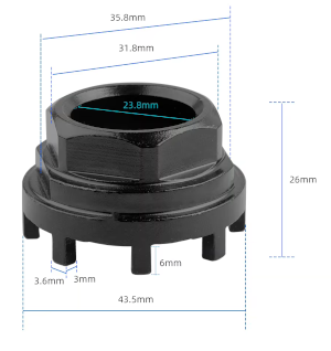

From what I read the only special tool needed other than torx drivers and a mallet is a lockring tool like this one:
8 Teeth Chainring Lockring Removal Sleeve Eight Notch Tool for Install e-Bike Bicycle Drive-side Bottom Bracket ISIS B.B. Cups - AliExpress 18
Yup it’s a tool for removing lockring. I have that already so I should be fine.
