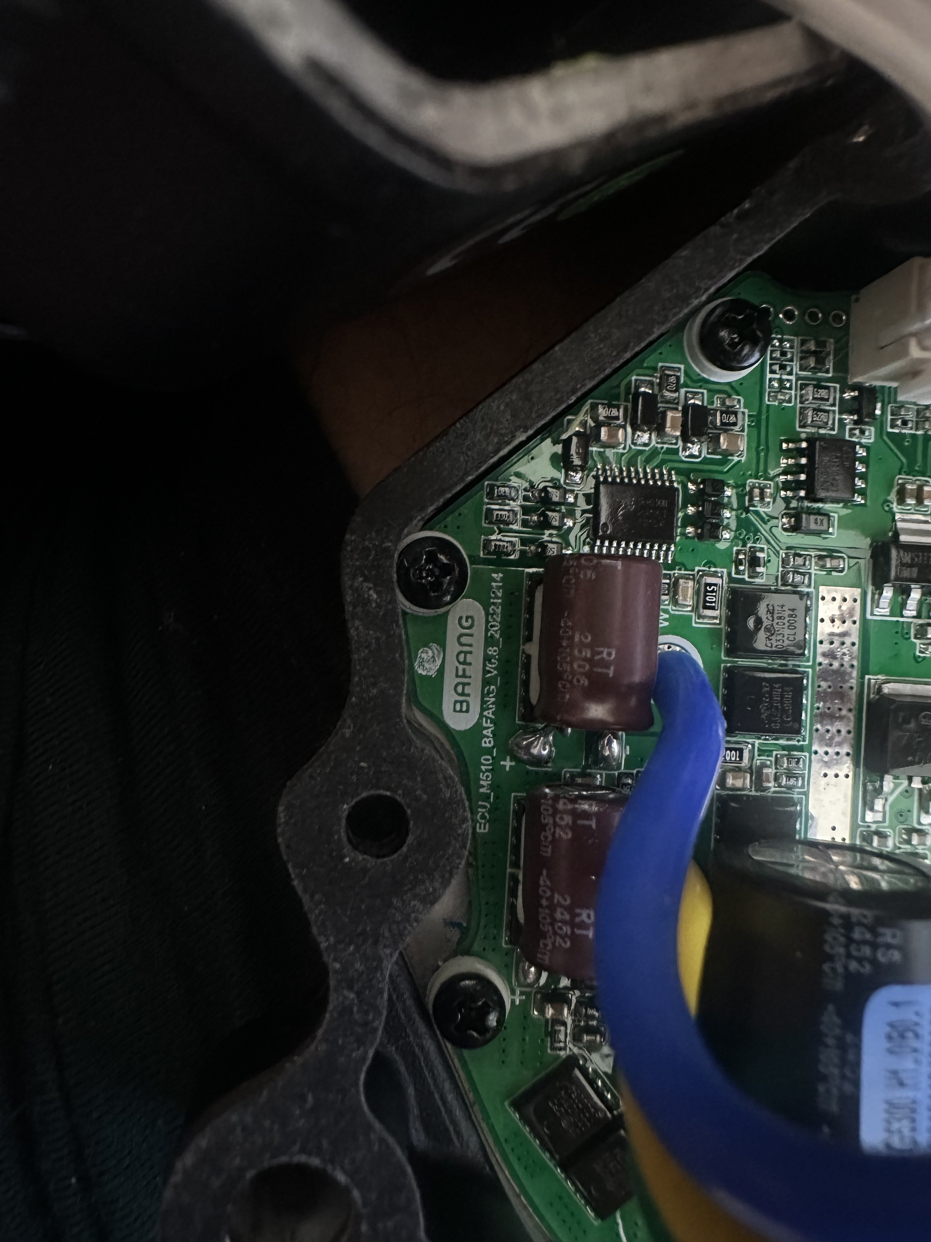

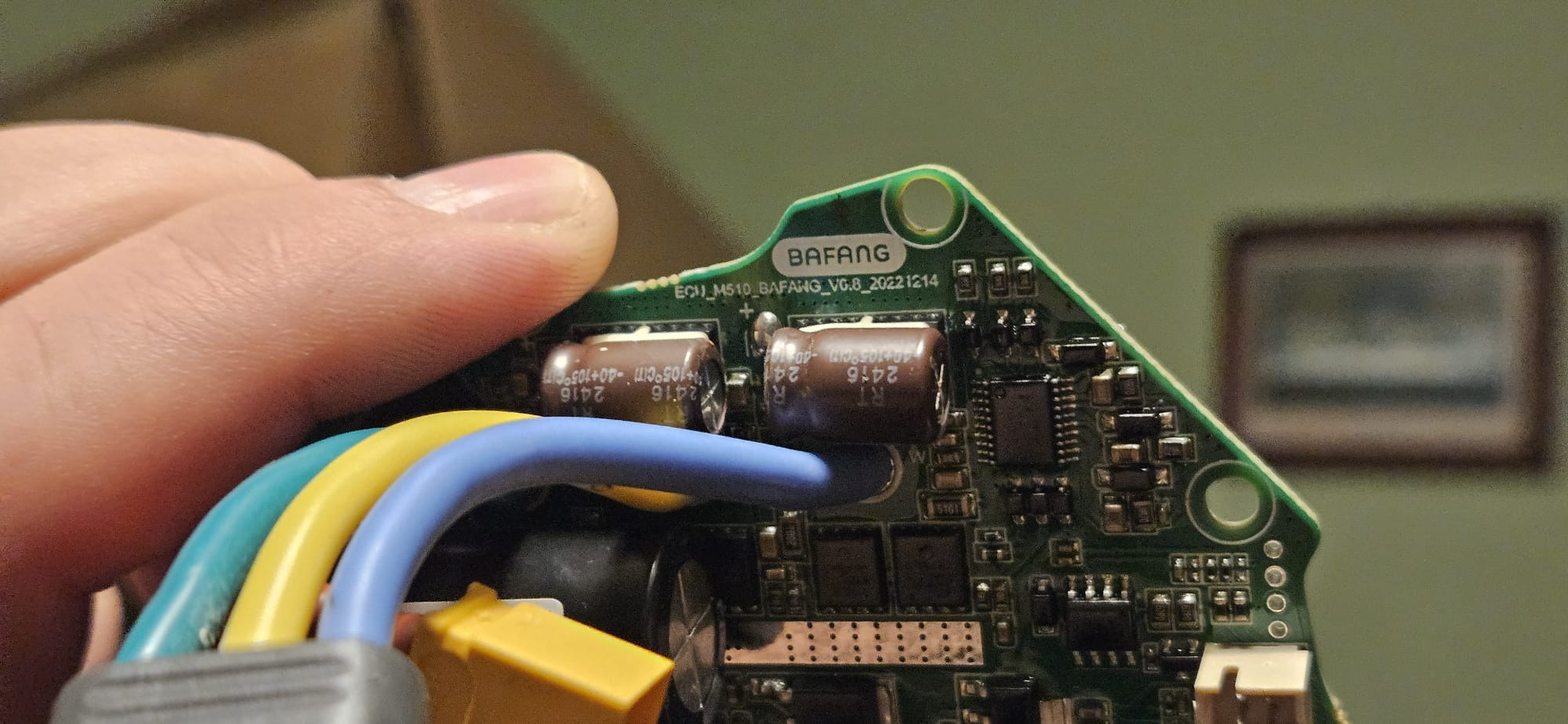

look what my friend found inside m560 delivered with frame from alibaba . spot the detail...
m560 has a bigger motor no doubt . for me only thing is that m510 should take 58v no problem if controller is the same ...

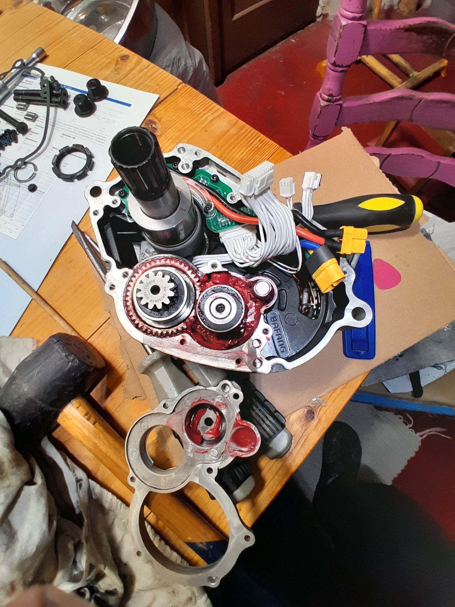

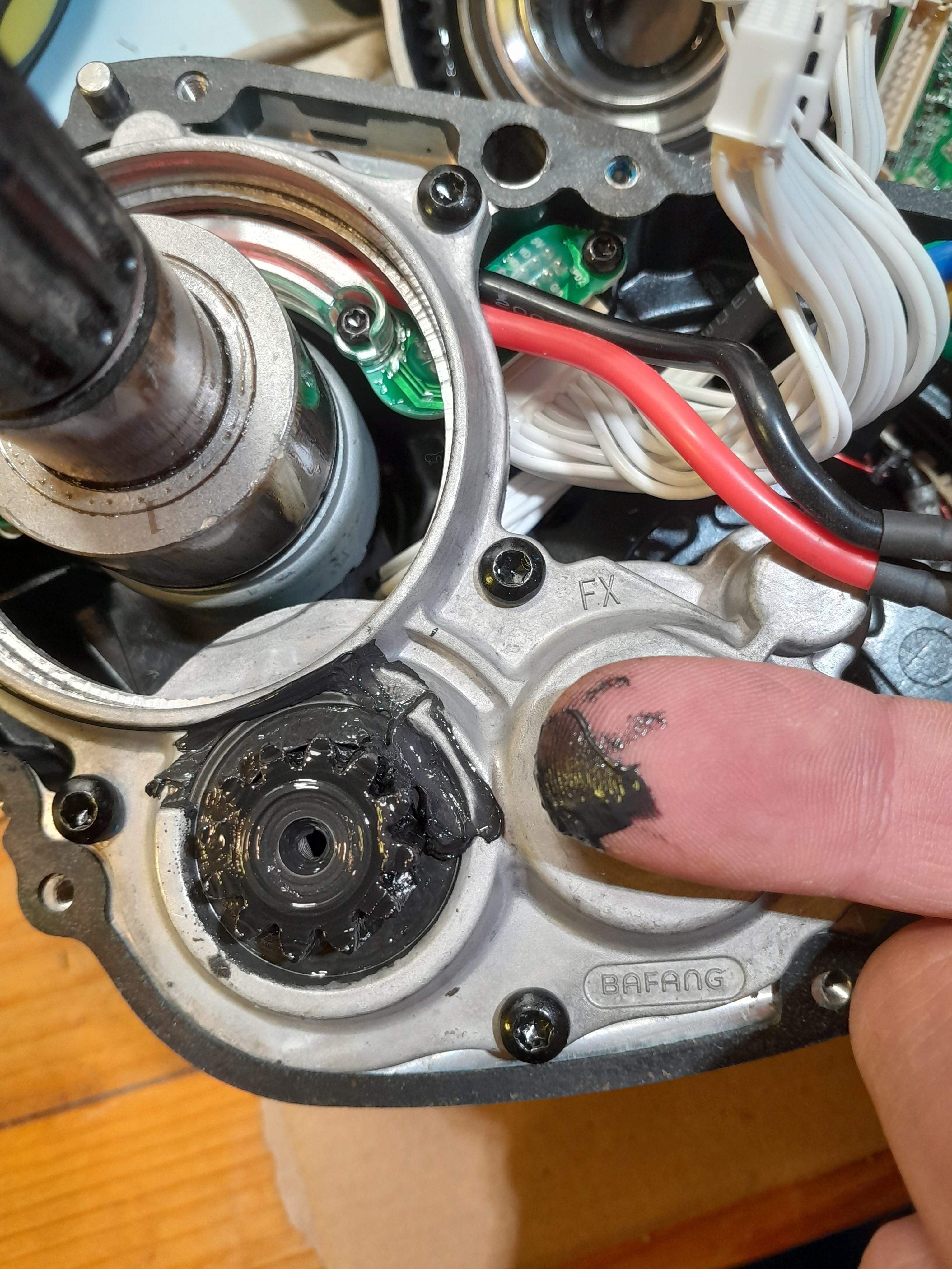

Opened up my M560 today, ODO at 1500 km. The factory grease was plenty but quite dirty and thin, approx. the consistency of ketchup.
Here is the controller version:
Removed the old grease best I could using paper towels and a toothbrush and filled it up with Mobilith SHC 100 (thanks for the recommendation @Sayonara):
Sadly the new grease did not reduce the motor noise at all but it's good to know that re-greasing is possible at home and only a couple hours work.
Hi gsoros ,
I open my motor as it delivered with 0km and look like the same, it is not dirt grease, it is like graphite grease for gears.
Next I open it on 2000km - nothing changed =)
Haha, graphite, that explains it! I thought it was steel dust from the gears wearing in. Oh well.

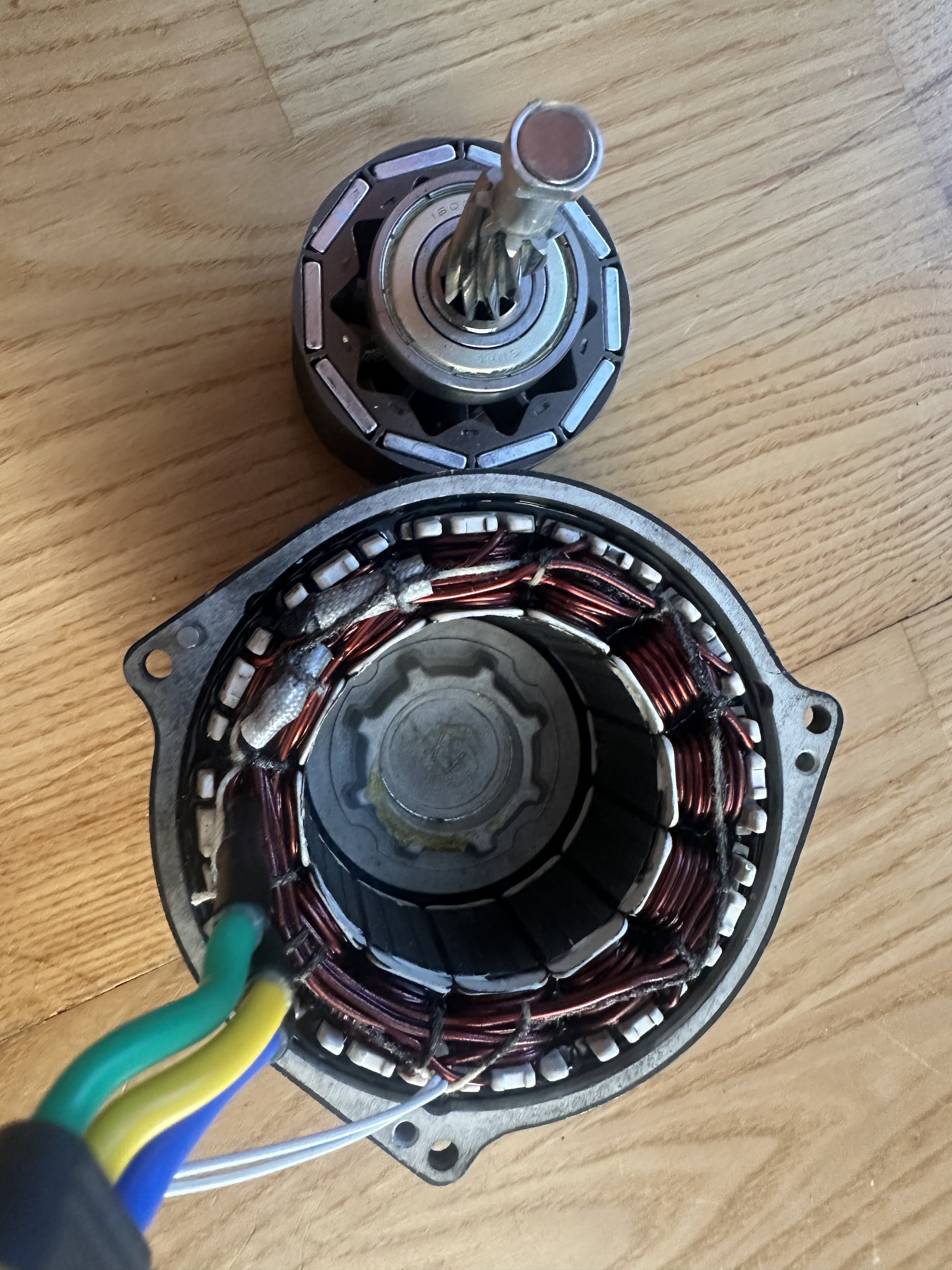

It’s because the noise is not from gears but from stator/rotor assembly. Bafang tolerances are poor and slightest deviation causes rotor hits something. Some people claims their m560 is silent, others says is noisy. Mine is noisy as well. Very noisy. Check here. So I’ve opened it up completely and found that smaller gear rotates very hard and making crazy noise. Have a look at this video - does your gear makes this noise? You need to push it hard in forward direction (backwards it’s running smooth and easy). Check if it is making this noise. I think it’s not normal so I put some thin ptfe grease on rotor a stator surfaces. I don’t care about some power reduction but that noise is killing me. Also I’ve put lot of parktool bearings grease into lower bearing, upper unfortunately can not be opened. I haven’t tested it yet but now when I turn the gear it is not making noise at all so I have some little hope for test. Check this video if its noisy like that on your motor.
BTW, mine 560 did not had any black grease when new, even after 150km no black grease whatsoever so I doubt it's graphite grease. Nevertheless, I've lubed everything well with some rockshox dynamic grease, didn't have anything else at hand :)
I will update later after test ride.

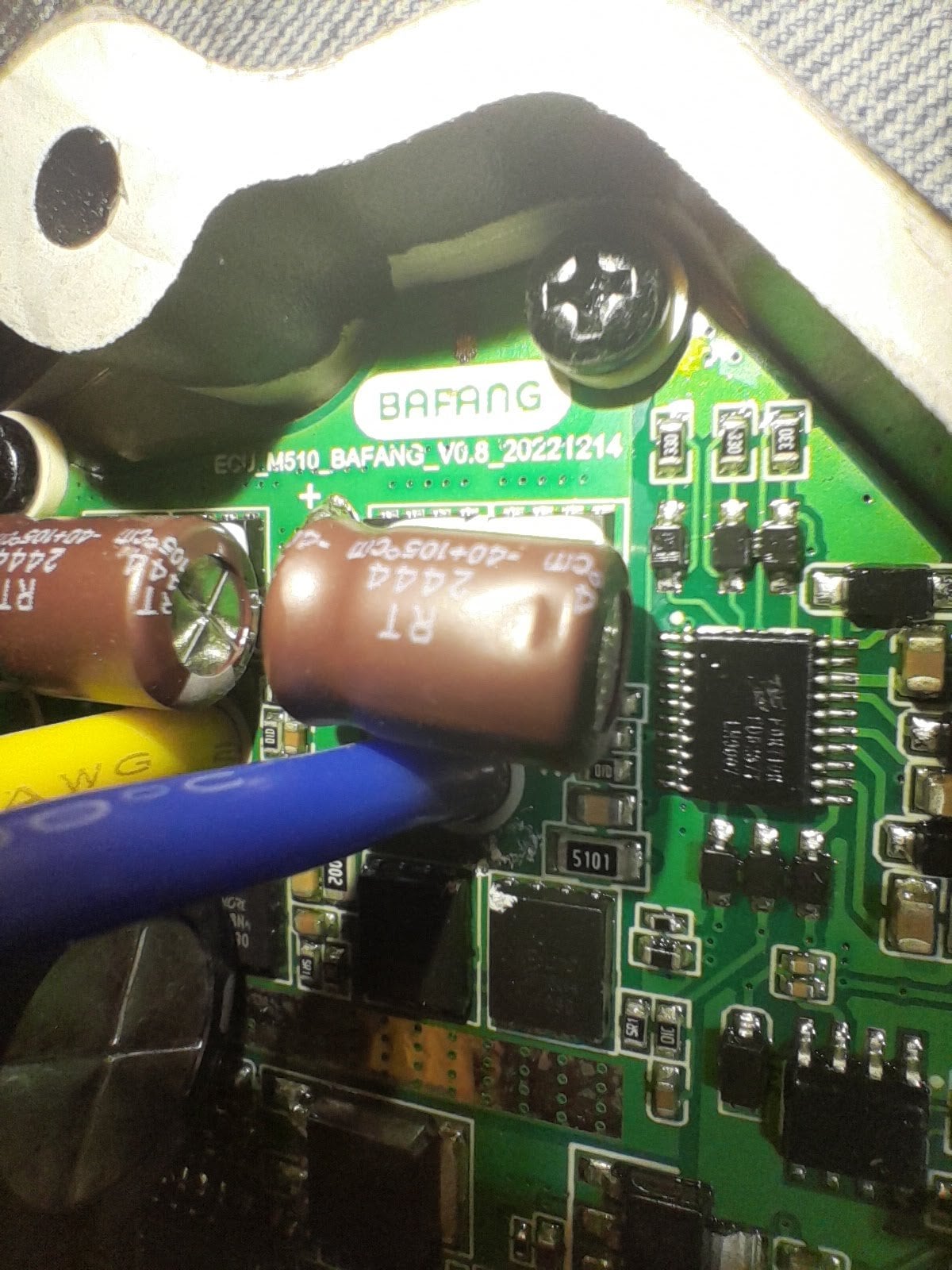

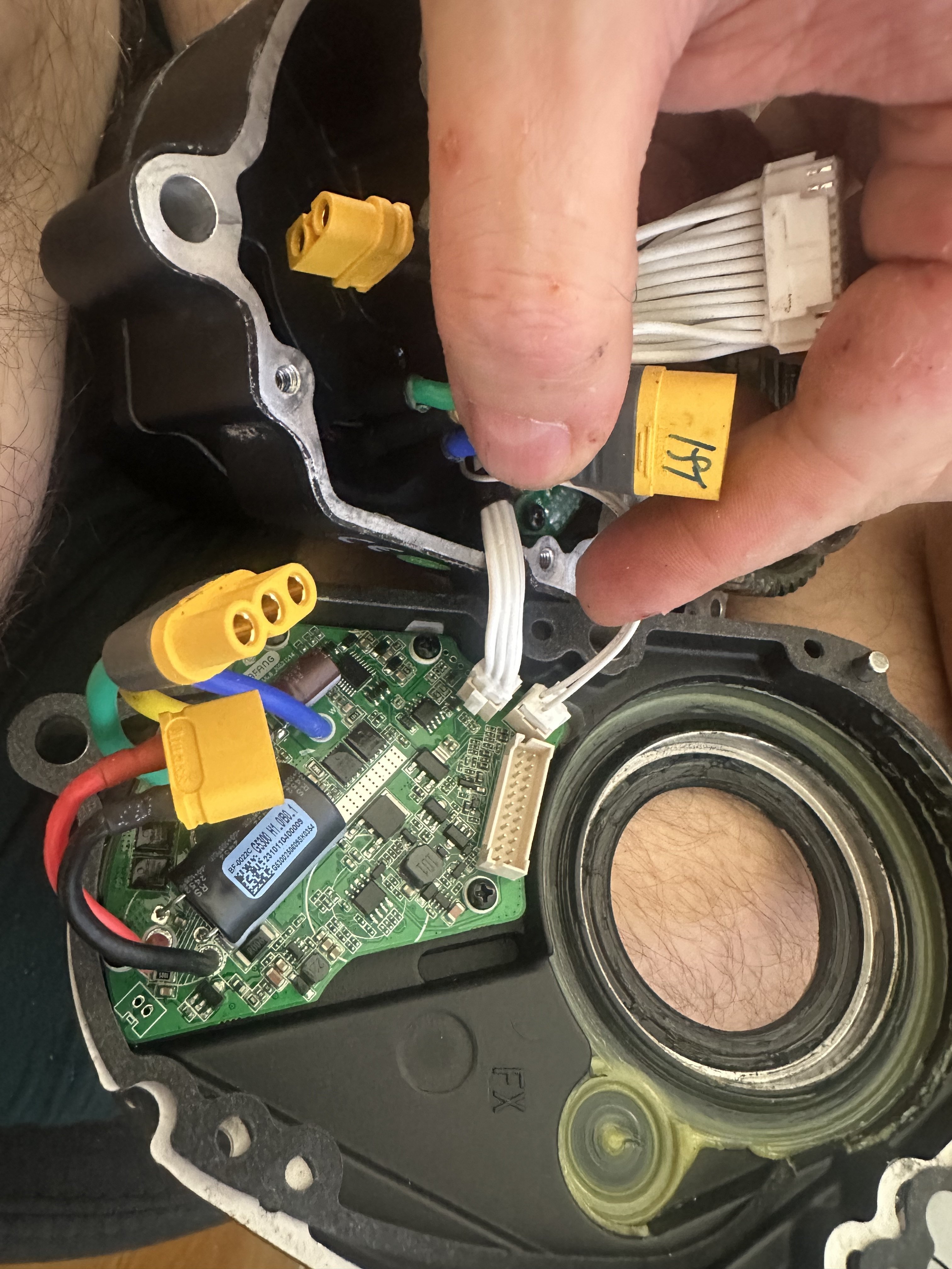

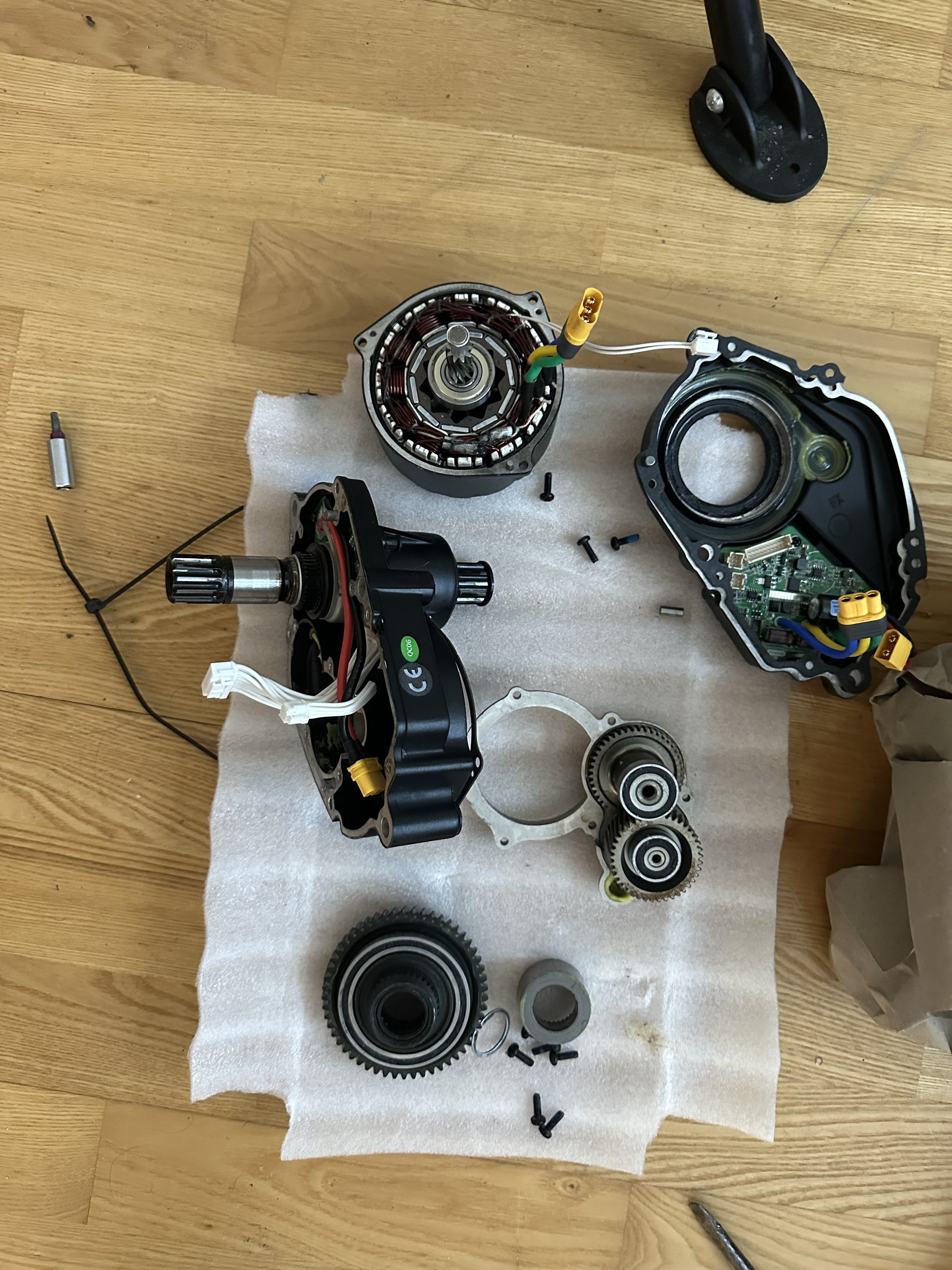

Hi guys, is this the new version of M560 motor or old version. Received it a week ago but upon dismantling I can see it has m510 controller. I saw on this forum that someone got board with M560
controller and also they’ve used black grease. Mine is classic yellowish grease.
