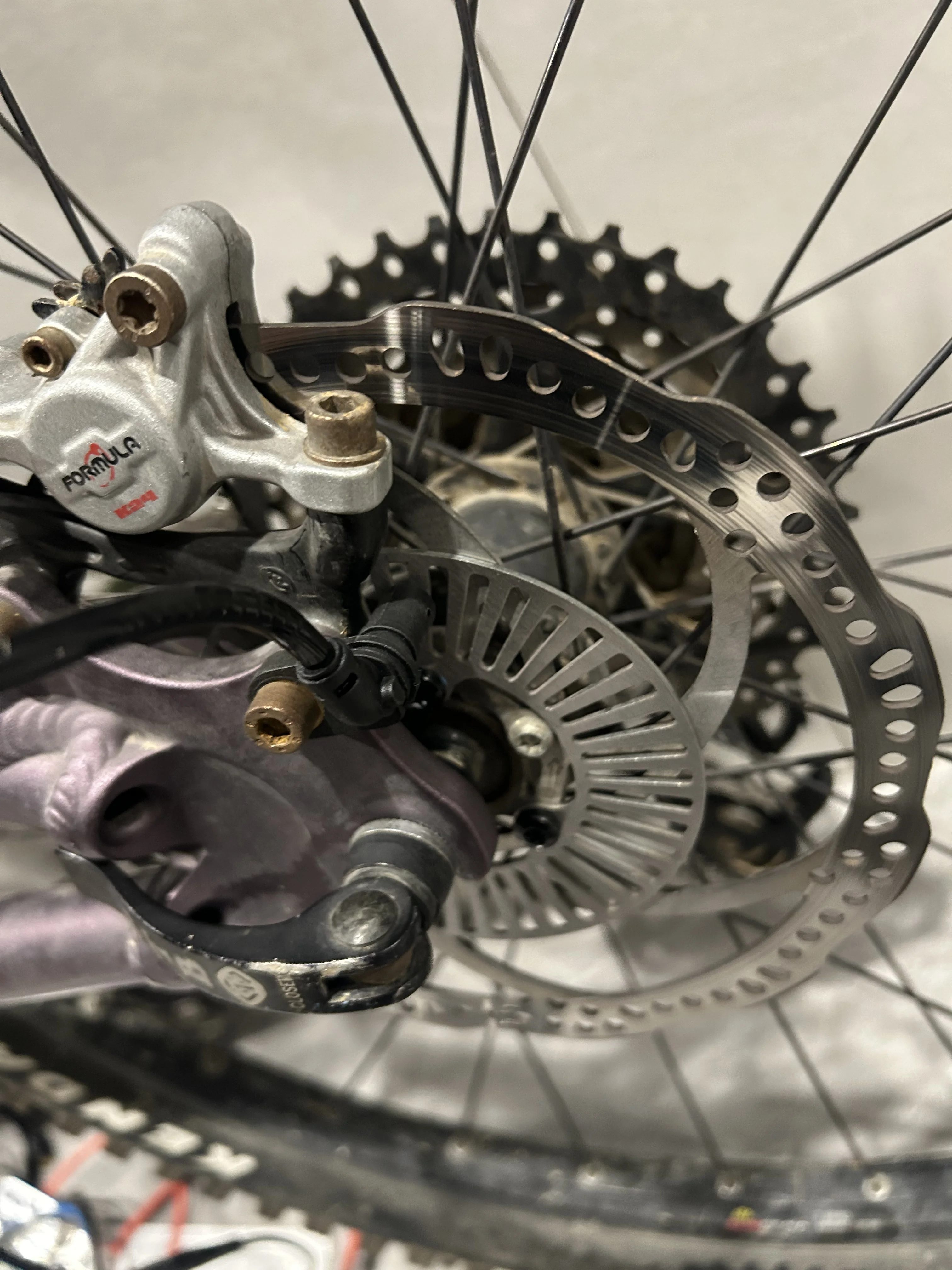

There is something, is year old now. Also 19A for new "ABS like" speed sensor disc.
Is this firmware for the new speed sensor ?
I flashed this firmware,but
Speed Sensor Magnets=1,And the quantity cannot be modified.
This one should be for new speed sensor.
This firmware runs fine with 42T wheel speed sensor. But the motor isn't working well.

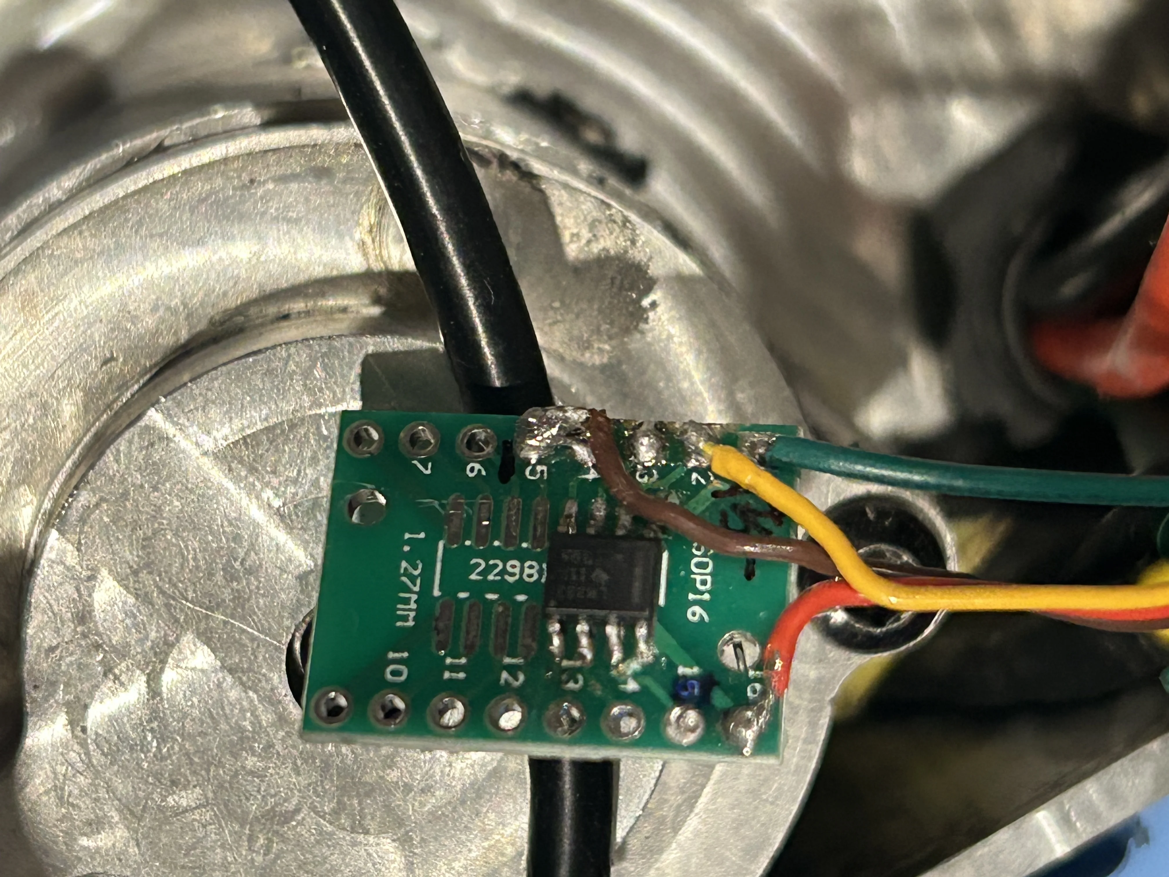

Whats that small PCB? Have you opened small box which is in front of speed sensor?
This new speed sensor is bringing just problems. And no real advantage from this.
This wheel speed sensor is homemade by me. That little PCB board turns current signals into voltage signals and sends them to the controller.
Mate, I wont do anything with that firmware behaviour. :(
I have tried to load RS firmware into normal M560, but there was a problems, throttle and speed sensor was not working then.
This works on the same principle as a motorcycle’s ABS sensor. The bafang small box is likely also converting the signal, because the controller can only recognize voltage signals (using a single magnet wheel speed sensor).
Ah. This way. :)
Yes, that bafang box was just workaround. I think will be integrated on a controller in next RS models.
If you dont want problems just go spoke magnet (or magnet on a disc.)
