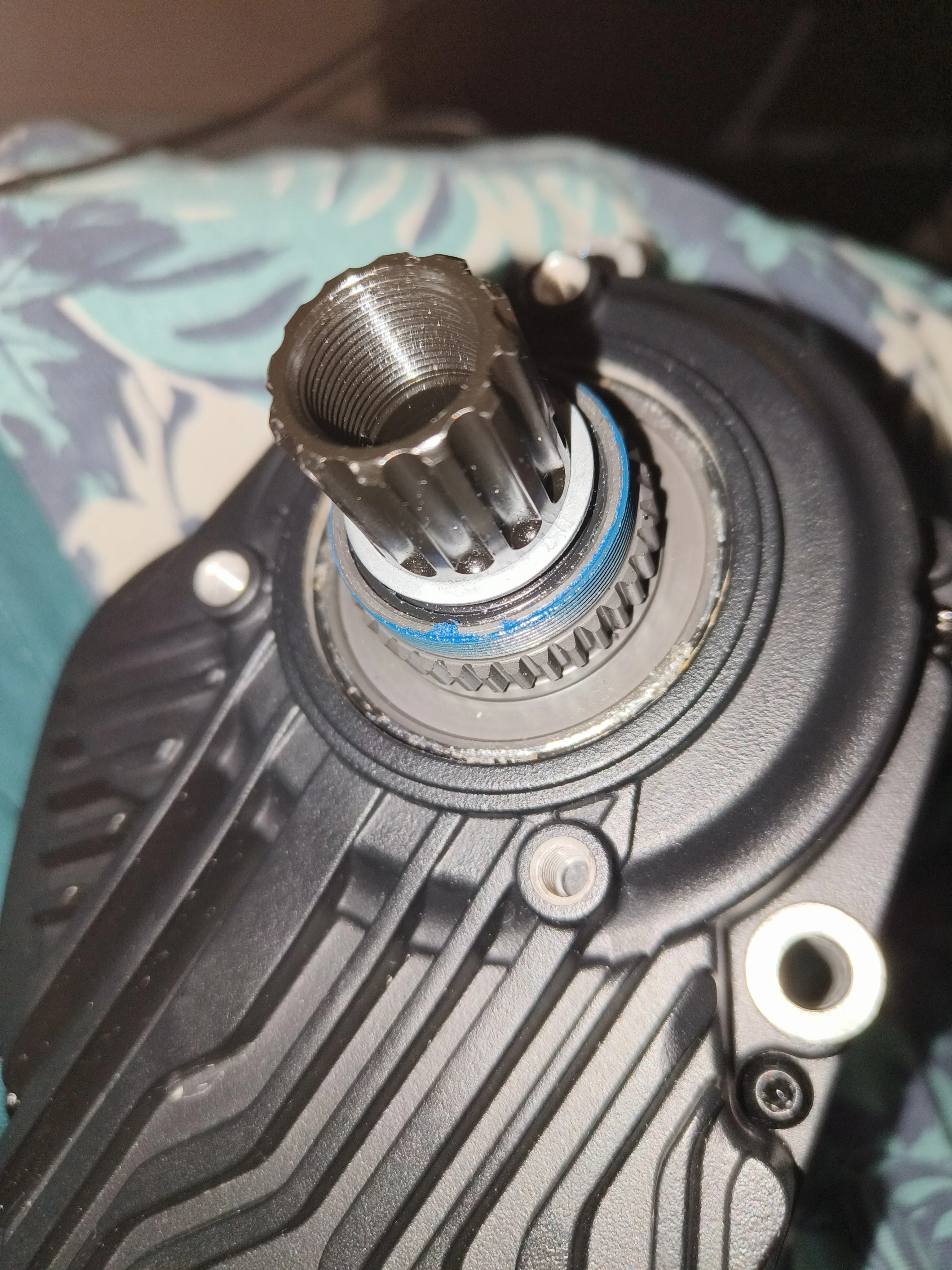

Is my motor missing a seal on this side, is there supposed to be a gasket here? Just looks like theres something missing but maybe im off.
where do you see it miss a seal ?
It may look it is missing but the seal sits just behind the Aluminium surrounding the crank. It’s tiny about 4mm thick and the same in depth.
That seal is the problem so many of us get water ingress into the motor as I think the factory inserts it the wrong way around. It’s set to prevent grease from the motor getting out not water getting into the motor. The M820 motor actually faces that seal the other way around.
Check but I think if you look on your spider that it sits about 0.3mm from that engine face. There is also a circular ridge that runs about 25mm radius out but just inside the spider. I’ve been filling that void with water proof grease to stop water getting to the seal. My plan is to every 500km or so refill with new grease just like you would on a boat propellor shaft. It’s a plan but as yet I haven’t done enough mileage to validate this theory. Maybe a tiny bit of extra drag but I’m doing a motor every winter here riding in our mud and slop.
okay this makes more sense, thanks i was considering adding grease there aswell

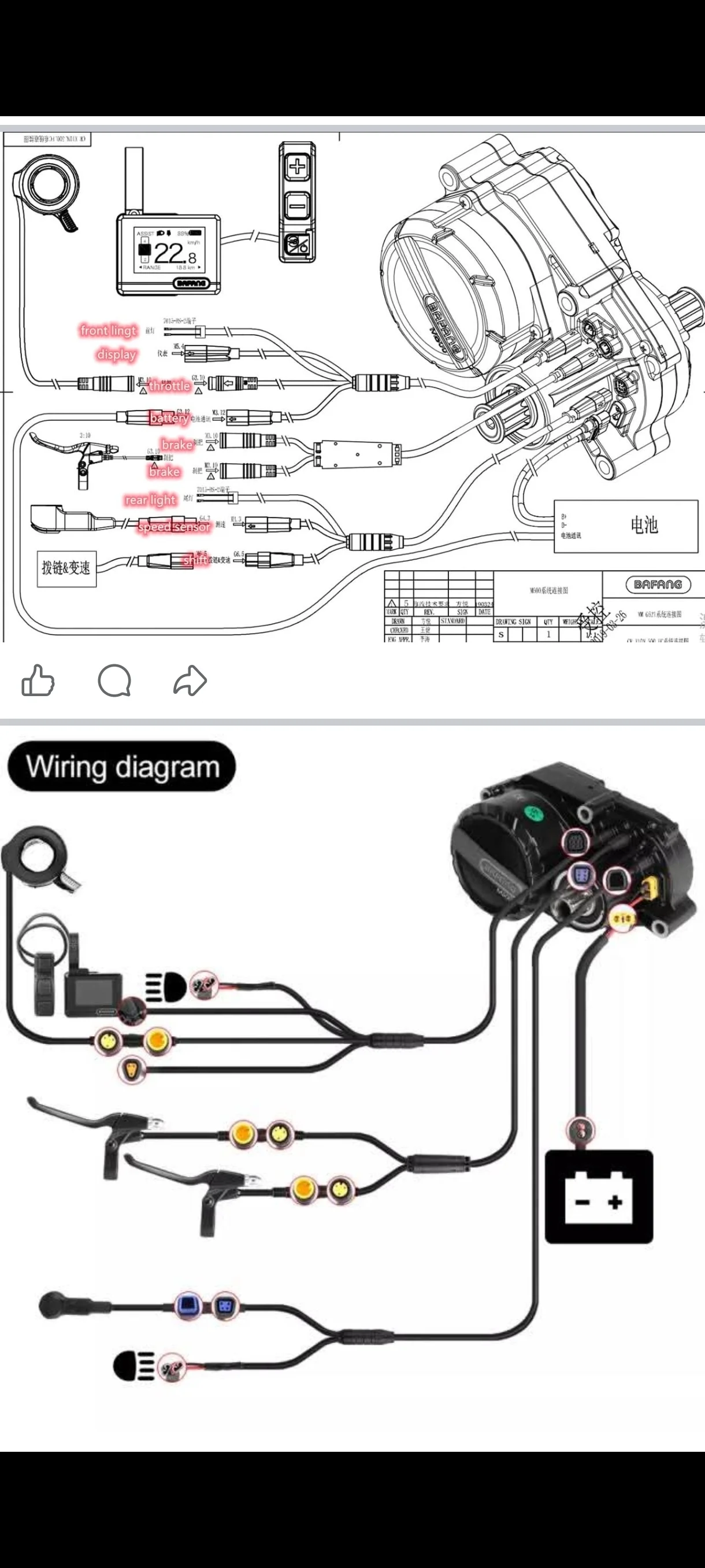

An Y cable for 3rd motor connector. And you cable then speed sensor and shift sensor here.
I’ve never seen anyone incorporate one of these with the M series motors, but there’s nothing specific to the motor it works with, it would connect in the same way one of the brake sensors would. They operate in the same manner simply opening/closing a circuit when the brake is pulled or shift wire is moving.
I use this shift sensor and its exactly like how u described it, I actually got rid of it after using it for 800km's because I started finding it annoying that the power would just cut off completely. I was never reaching continously 1250w or 500w for example.
Once I shifted late and there was an obstacle coming the motor power would cut off and that 0.5 second cutoff would be enough to get me to a stop, due to being in the wrong gear at the wrong time. Def a skill issue tho.
For now I won't use it but later on I might re add it to just have less wear on everything.
