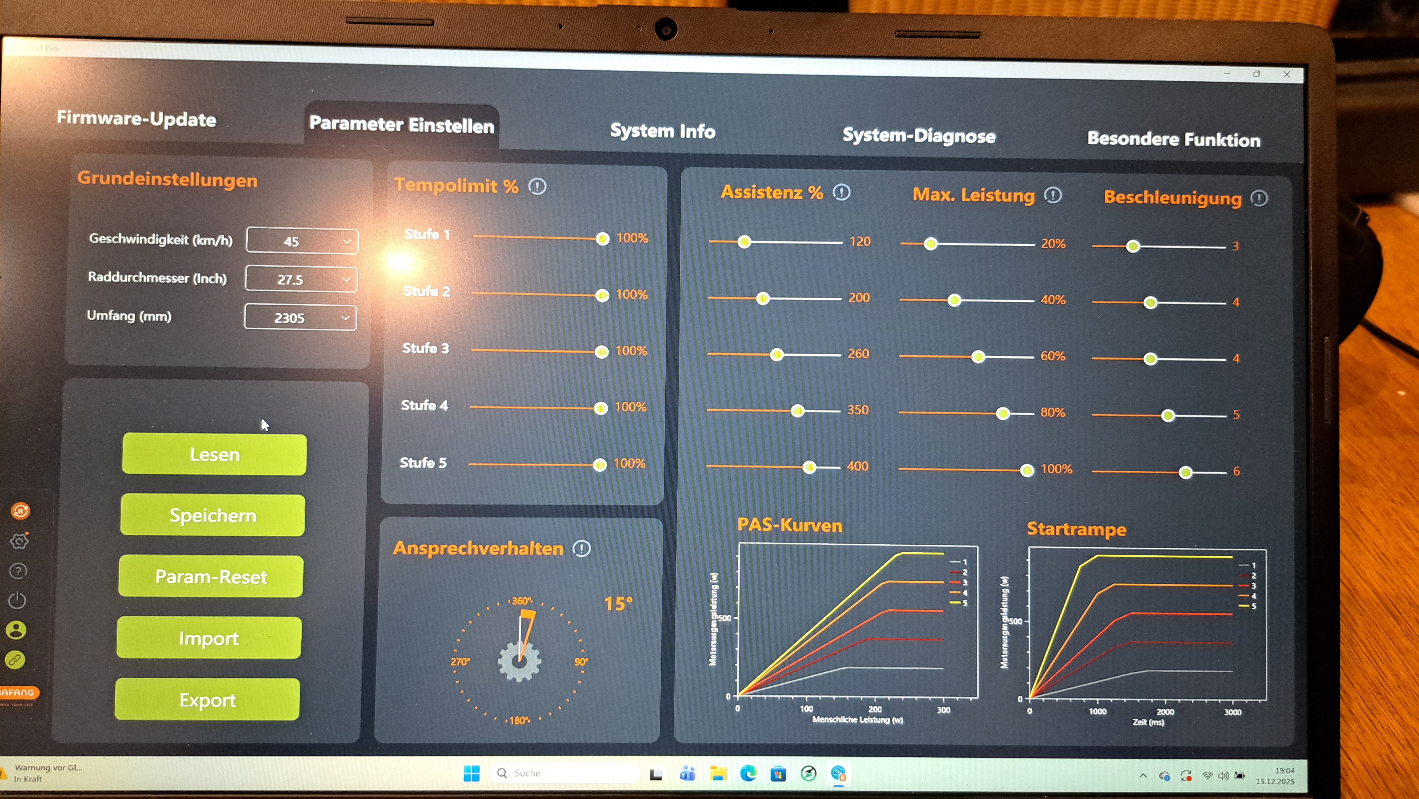

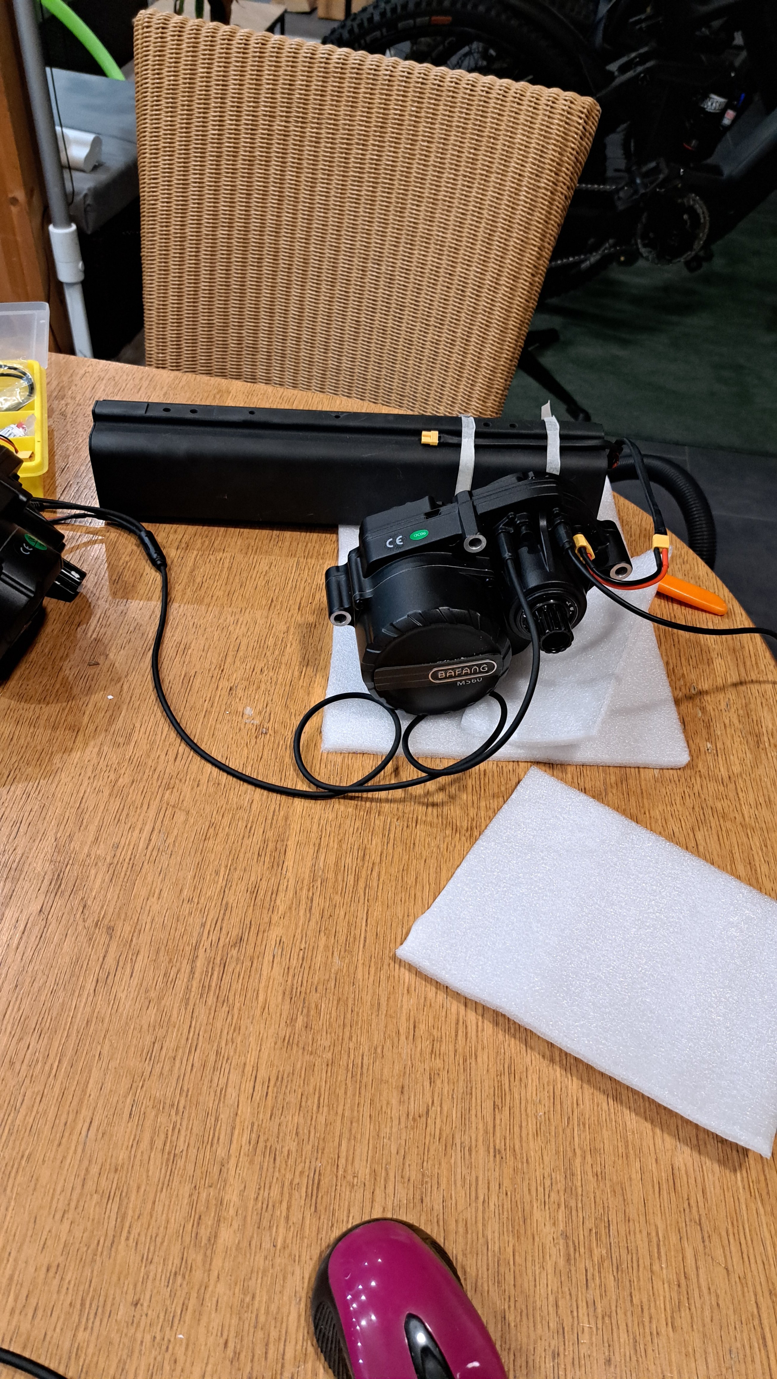

Ich lade einmal die Datei Bilder hoch!

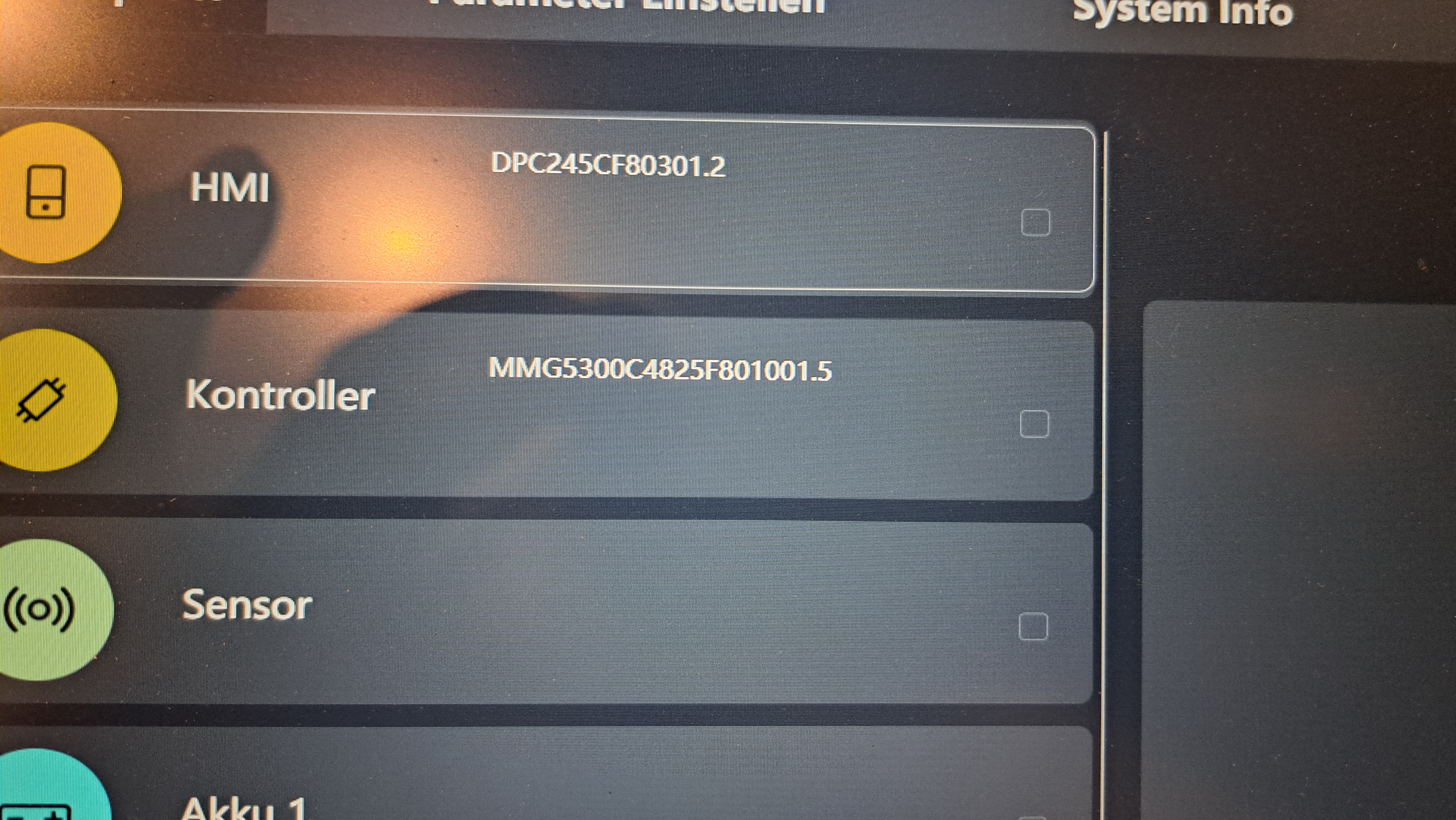

Got new revision of M560. Is with new firmware v1.6
But, it seems to me it has much much less noise! Like M510. Woohooo. New gears? Or "nylon" gear?
Do you have the tools to extract and share it? :) Would be a huge win for the community 🙏🏻
