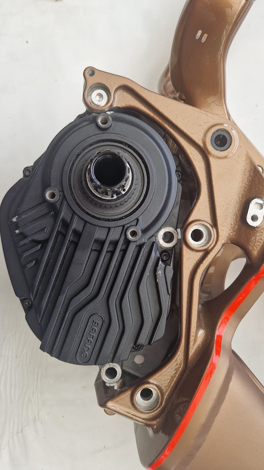

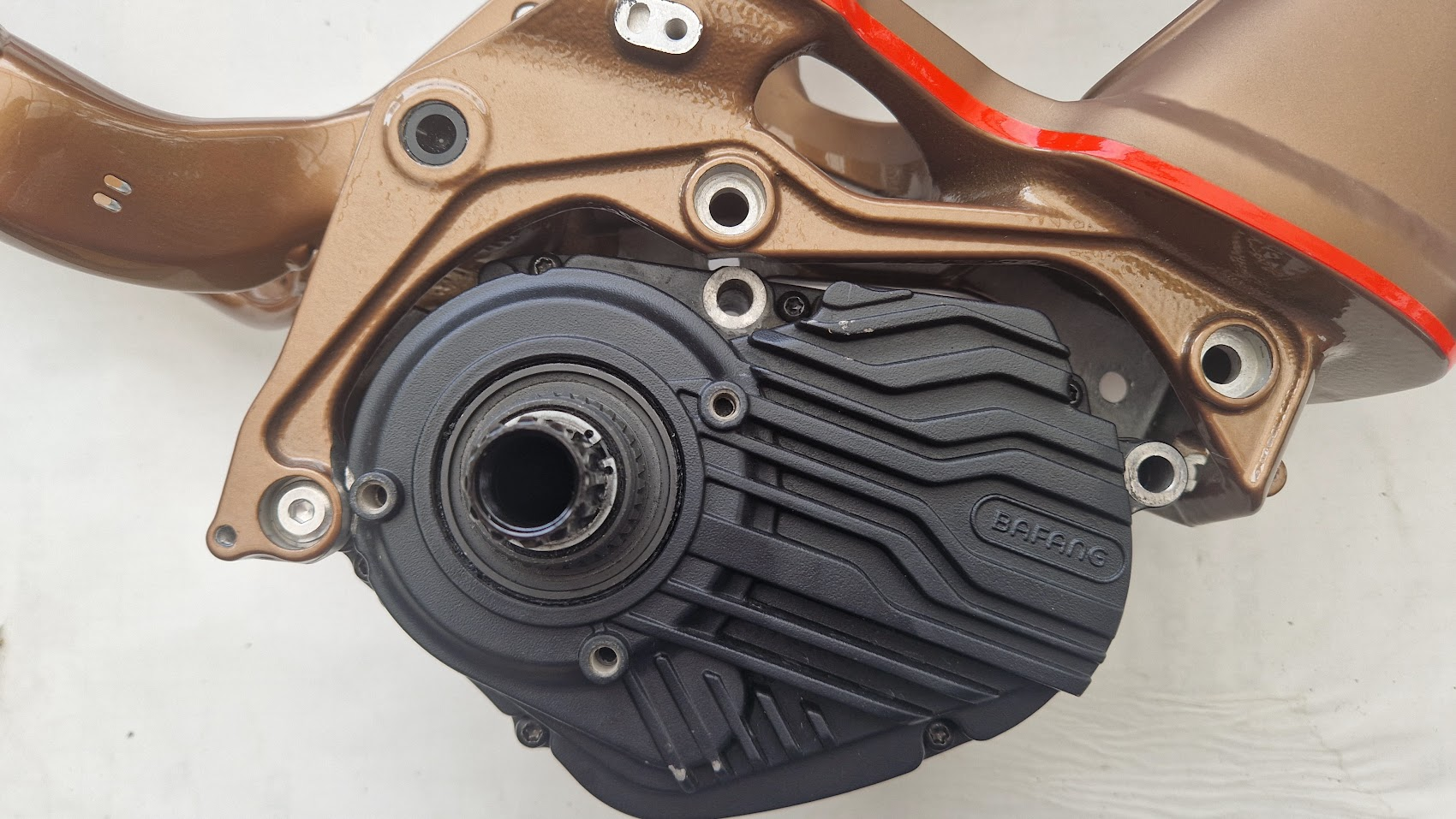

Vice versa possible ? :) e.g brose, shimano, bosch motors in bafang frame?
easy . bbshd in shimano frame ?
i've fitted yamaha , bosch . u name it

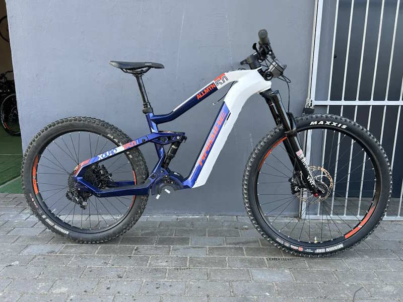

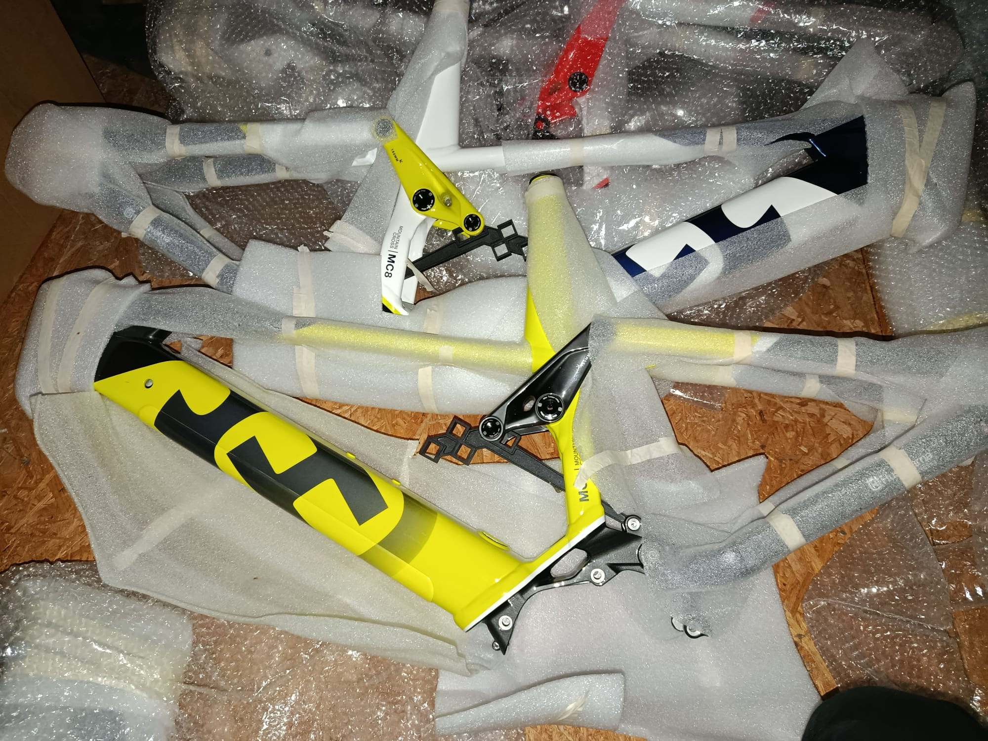

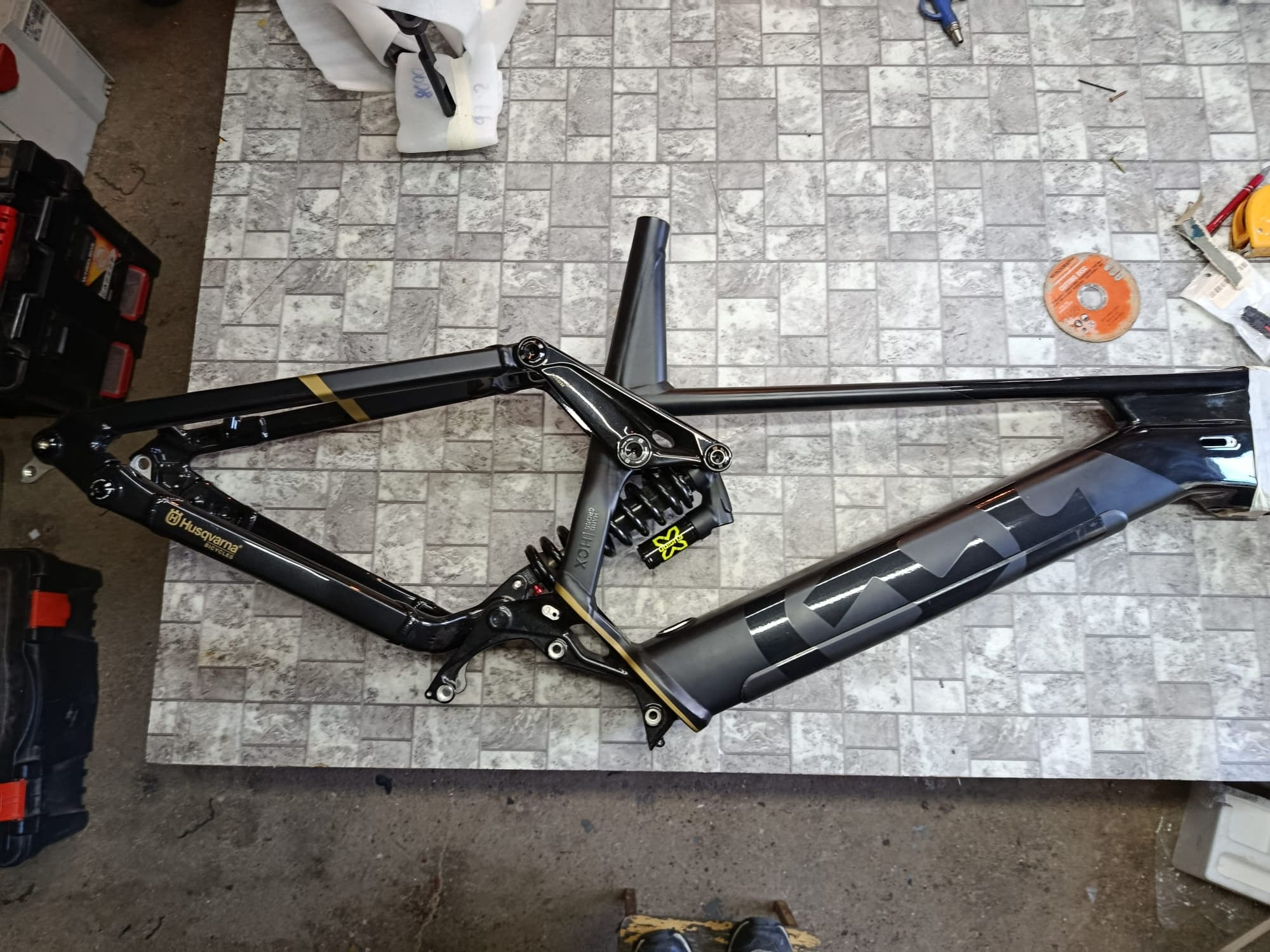

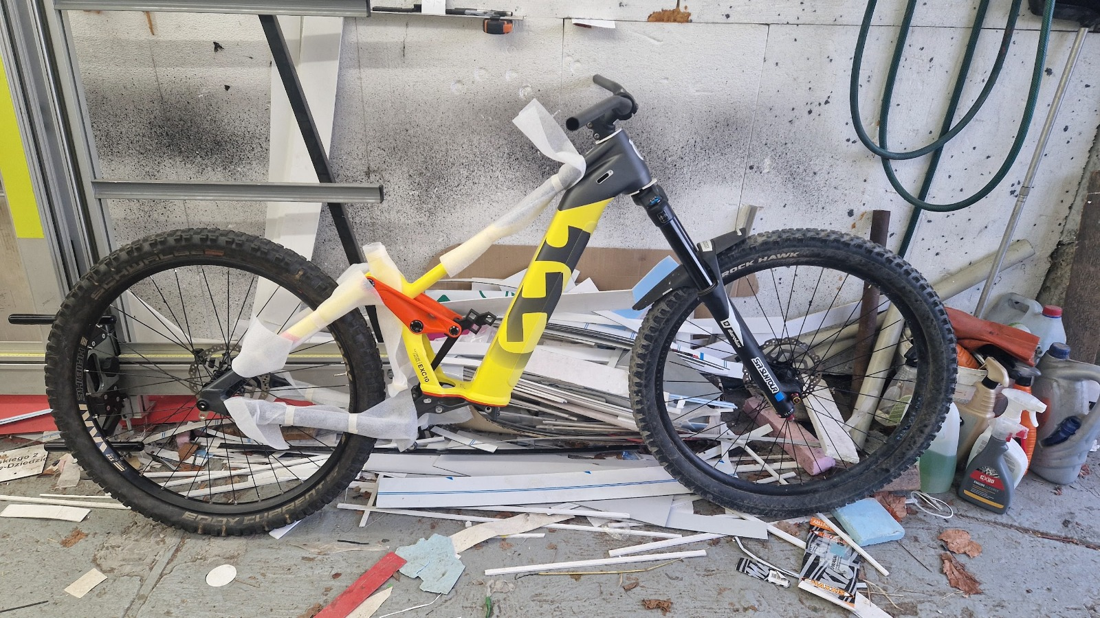

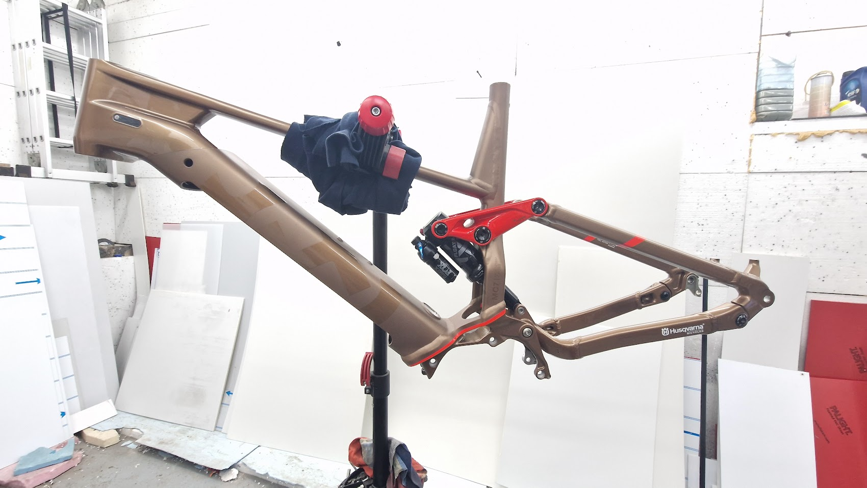

guy is selling brand new husqvarna frames for 300eur

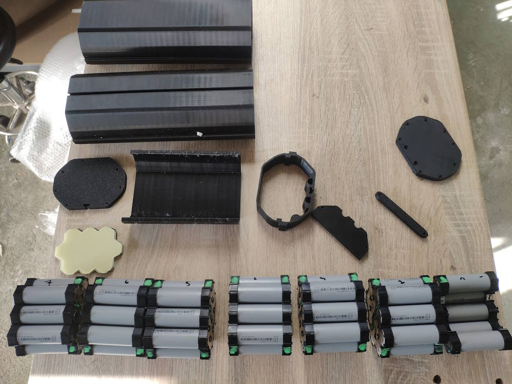

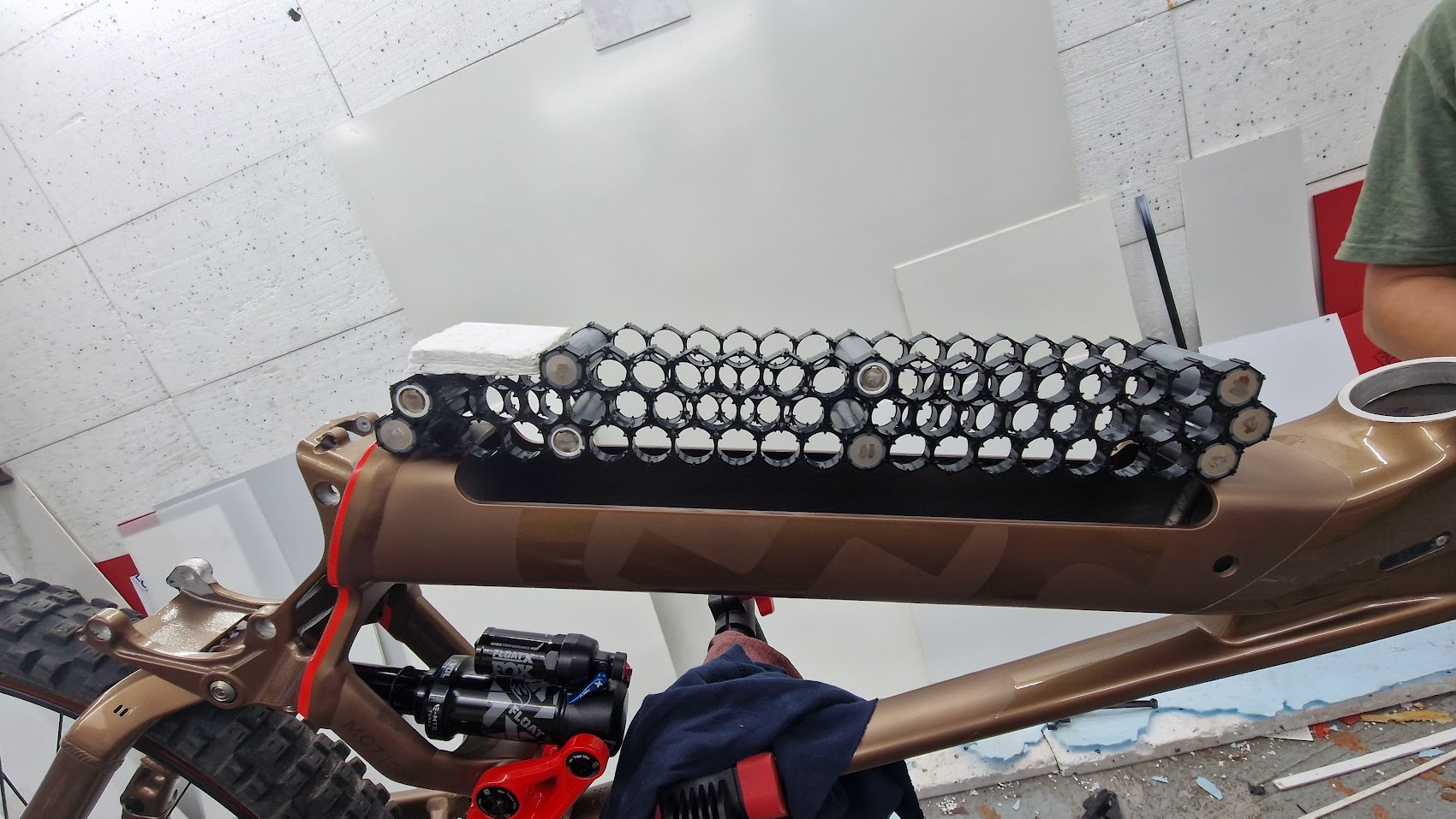

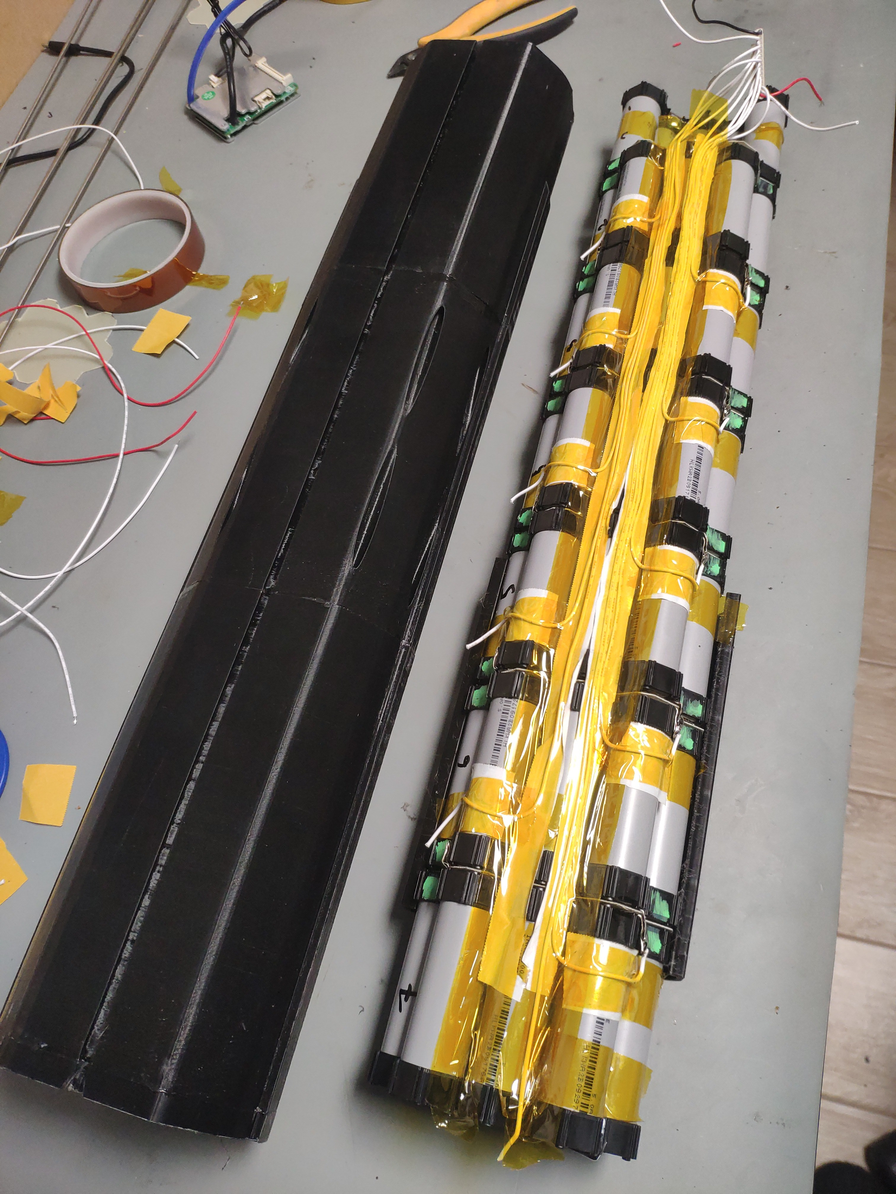

1200wh battery ? easy ...

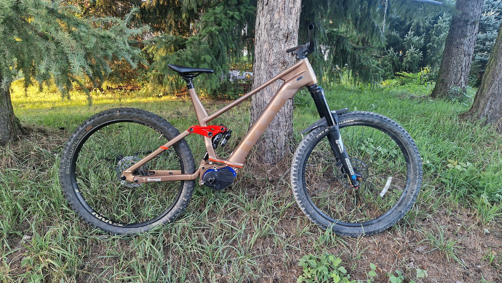

almost all frames can be adapted to bafang with simple adapter. sometimes they are very cheap . I have currently two shimano frames with m560 fitted . and I'm in the process of building huskvarna ebikes also with bafang and 1200wh batteries

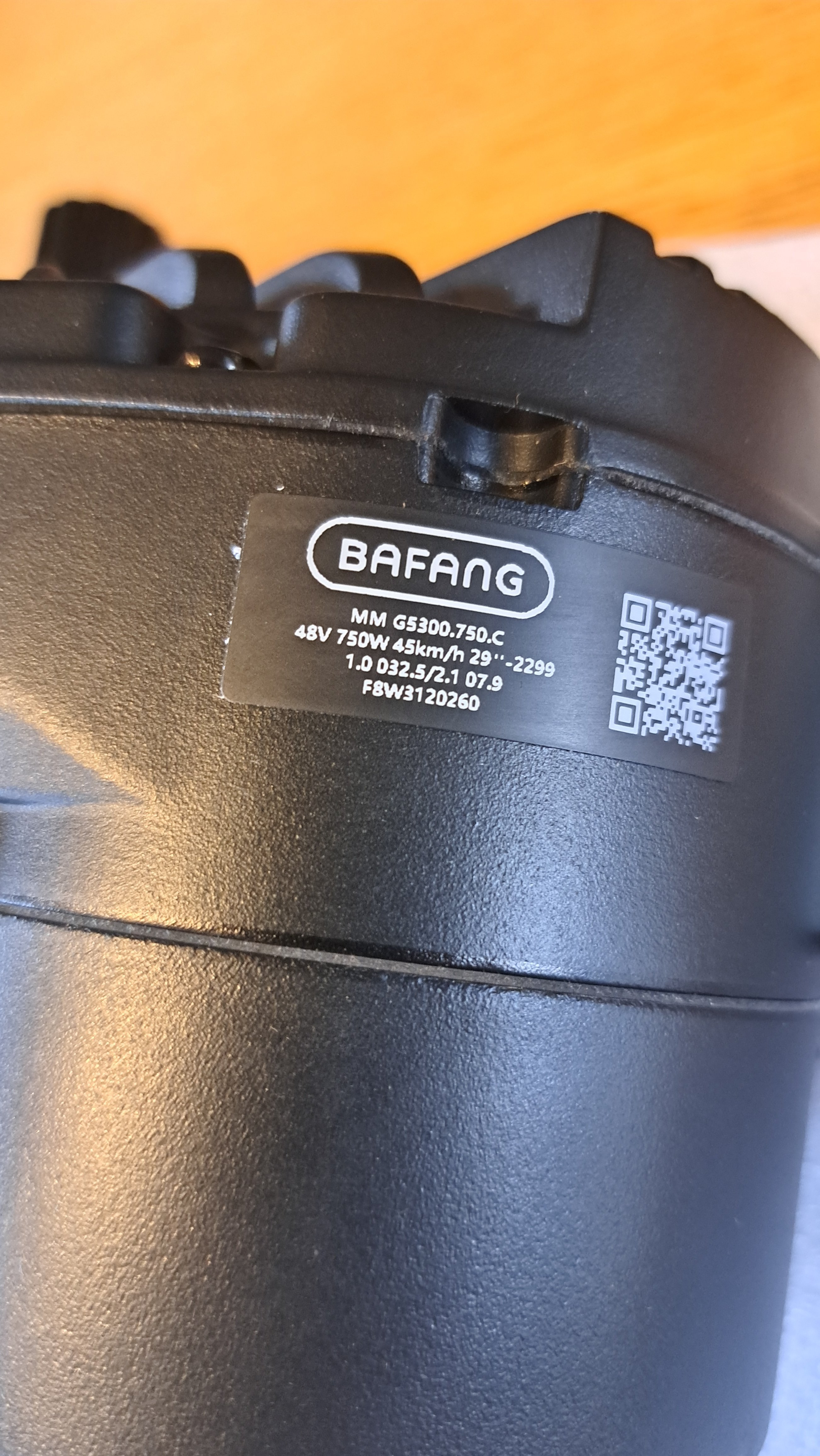

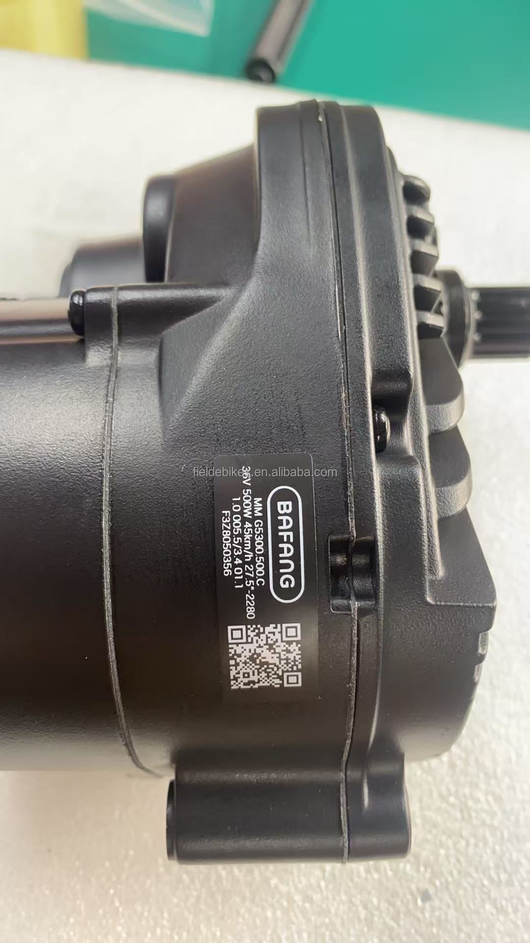

I got my new m560 750w motor from Chili. Noise level is the Sane as my older m560 was.
However.. apparently Bafang has upgraded the torque sensor to the 3.0 version. The same as m560 RS motor.
You can see the 3.4 marking on it. My old one had 2.1 in it.

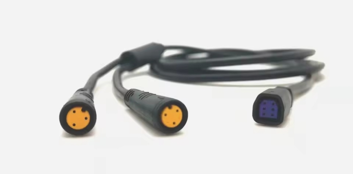

Second follow-up, the two light connectors, are those still 6V 0.5A each or do they have higher current/voltage specs on the current models? I see bafangs website says 12V 6W, but I'm worried they are doing something weird about adding the 2 connectors together. Trying to confirm if each light is 12V or 6V?

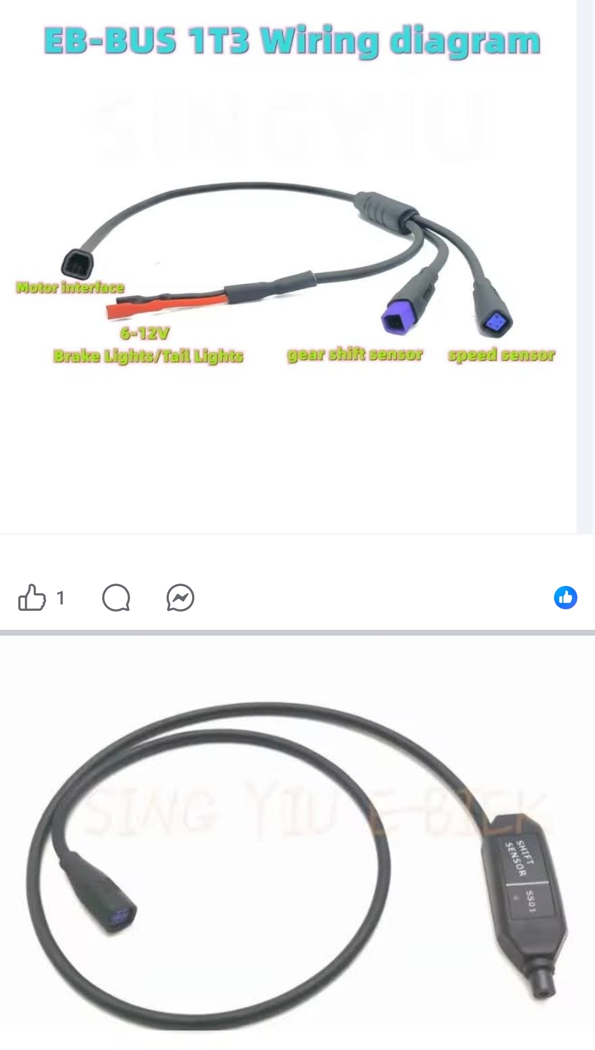

Has anyone managed to correctly connect a gear-shift sensor to the M560?
I connected everything as in the diagram below and the engine does not respond when changing gears.
Or should it be connected differently? Maybe use the sensor with the yellow plug and different wiring?
