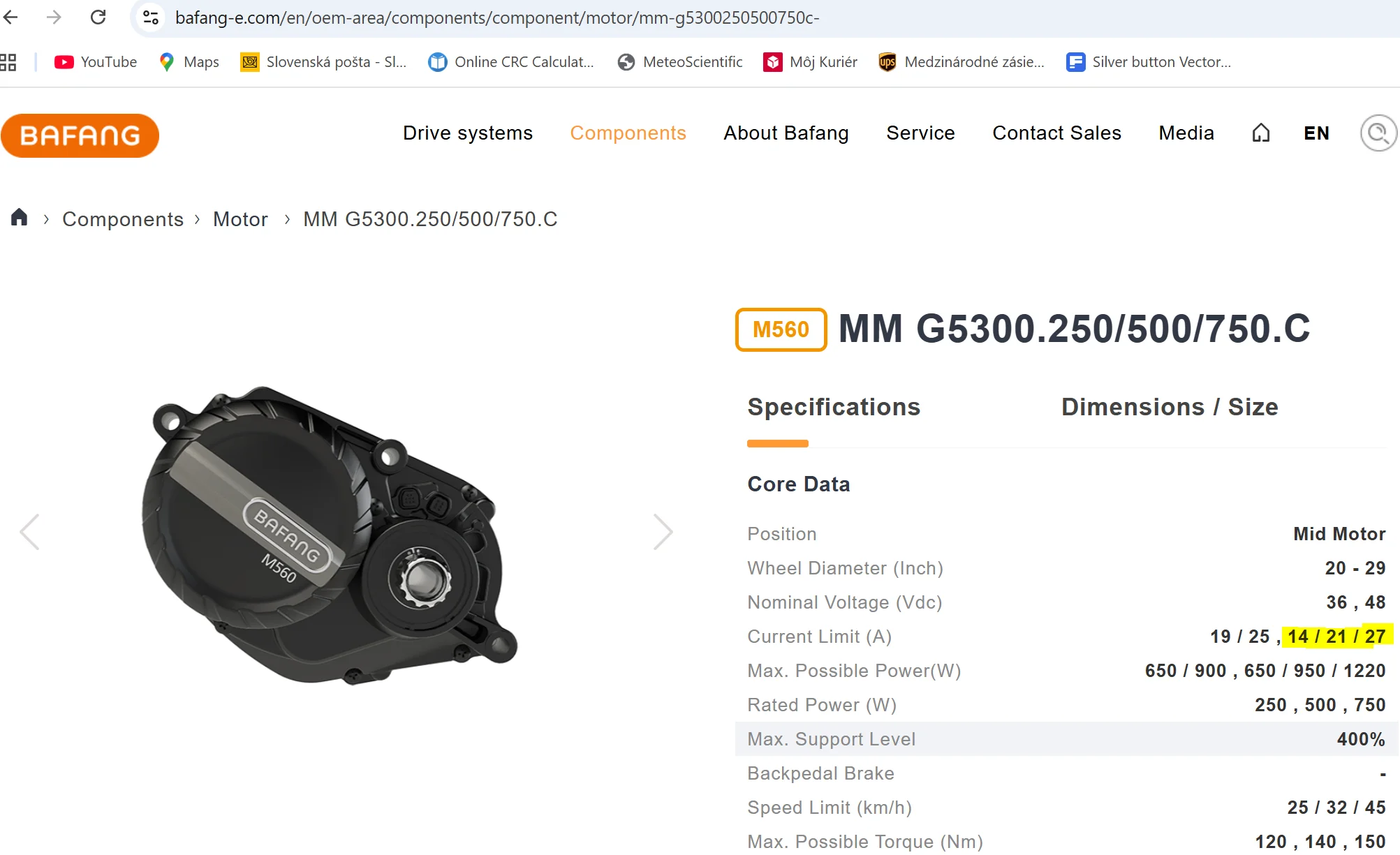

Guys, what the hell is this again? Bafang just renumbering on a webpage?
Have somebody seen M560 with official 27A firmware? There was so far only 20 and 25A.
Also assistance is up to 500% and with RS even up to 1000%

27A will be peaking 1340W electrical (cca 1080W on a wheel).

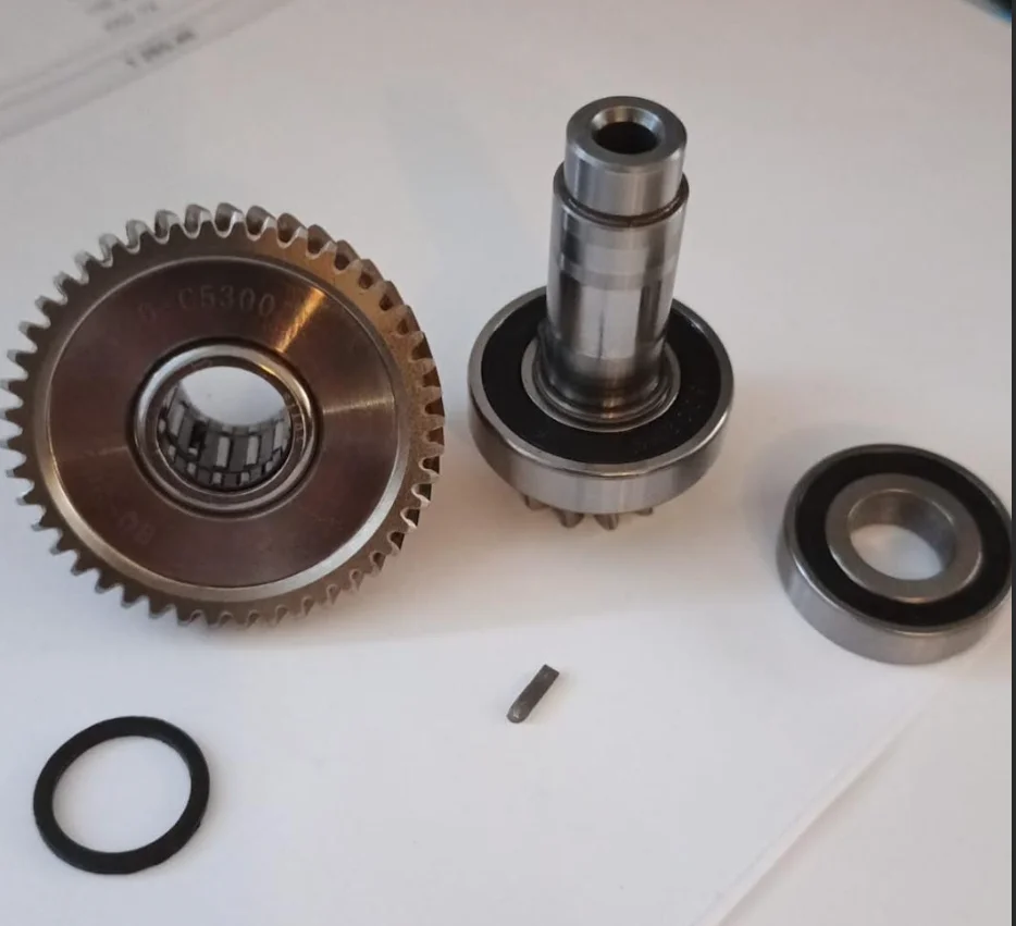

My motor broke again. Last time at 3k km and new motor broke at 2.1k kms. Exactly the same way. This time it's under a warranty and will be sent to Bafang center in Poland
What have failed?
I managed in 800km. ;) But spare gear 30 Eur, so it is fine.
What have failed?
No clue yet. I guess the stator side has a nylon gear somewhere and it failed. I sent the motor to Bafang in Poland. Takes about week to get there.
No nylon in M560. No assistance? Or you hear rotor going when pedalling?
Then I guess it's the one way bearing.
Same problem as I stated with my previous motor. However this time it got worse. When I use the pedal assist or thumb throttle I can hear the motor spin but nothing happens.
Yes, same as me. That one way bearing can not hold that power.

Try ask Chili about that gear.
Broken roller and cage.

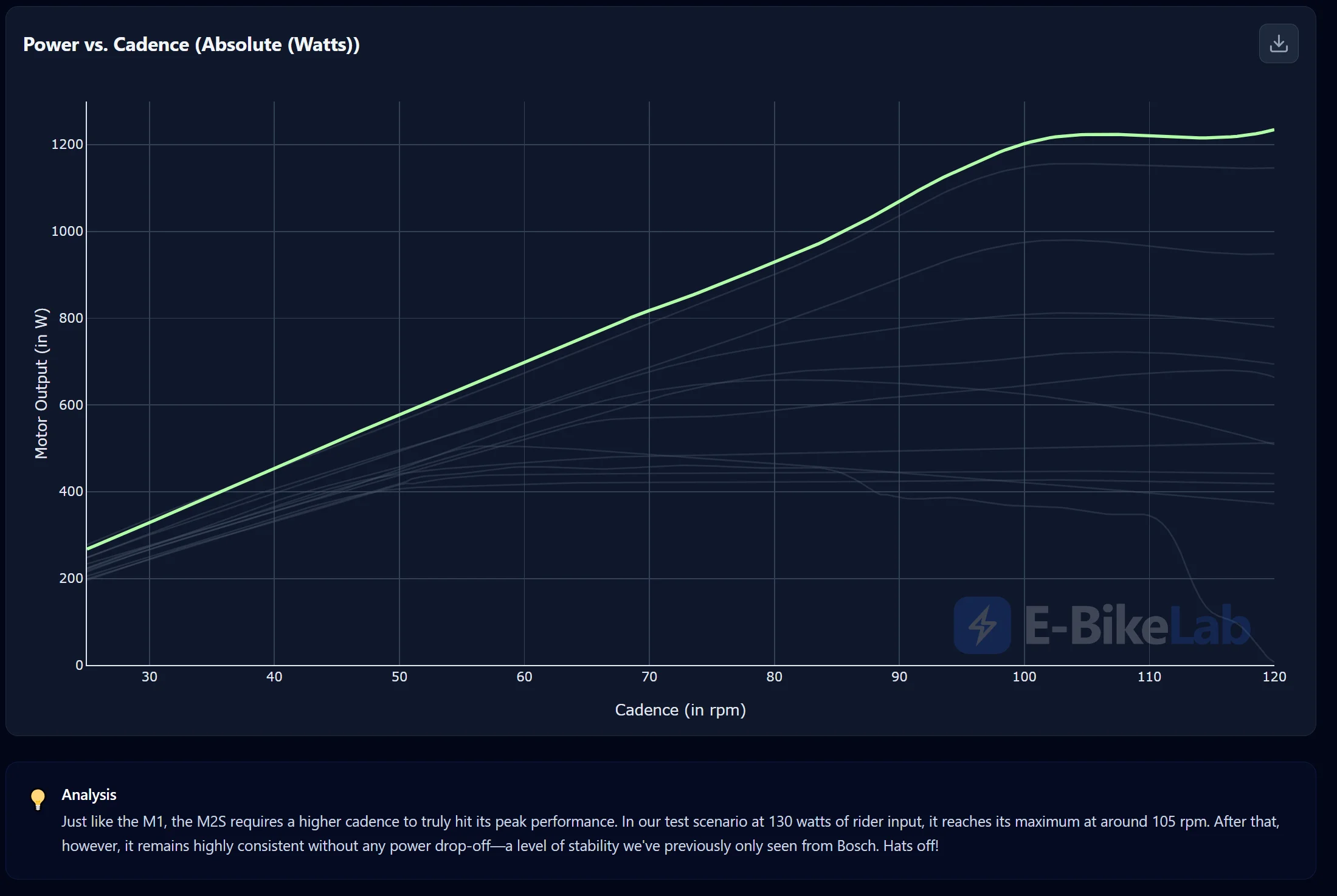

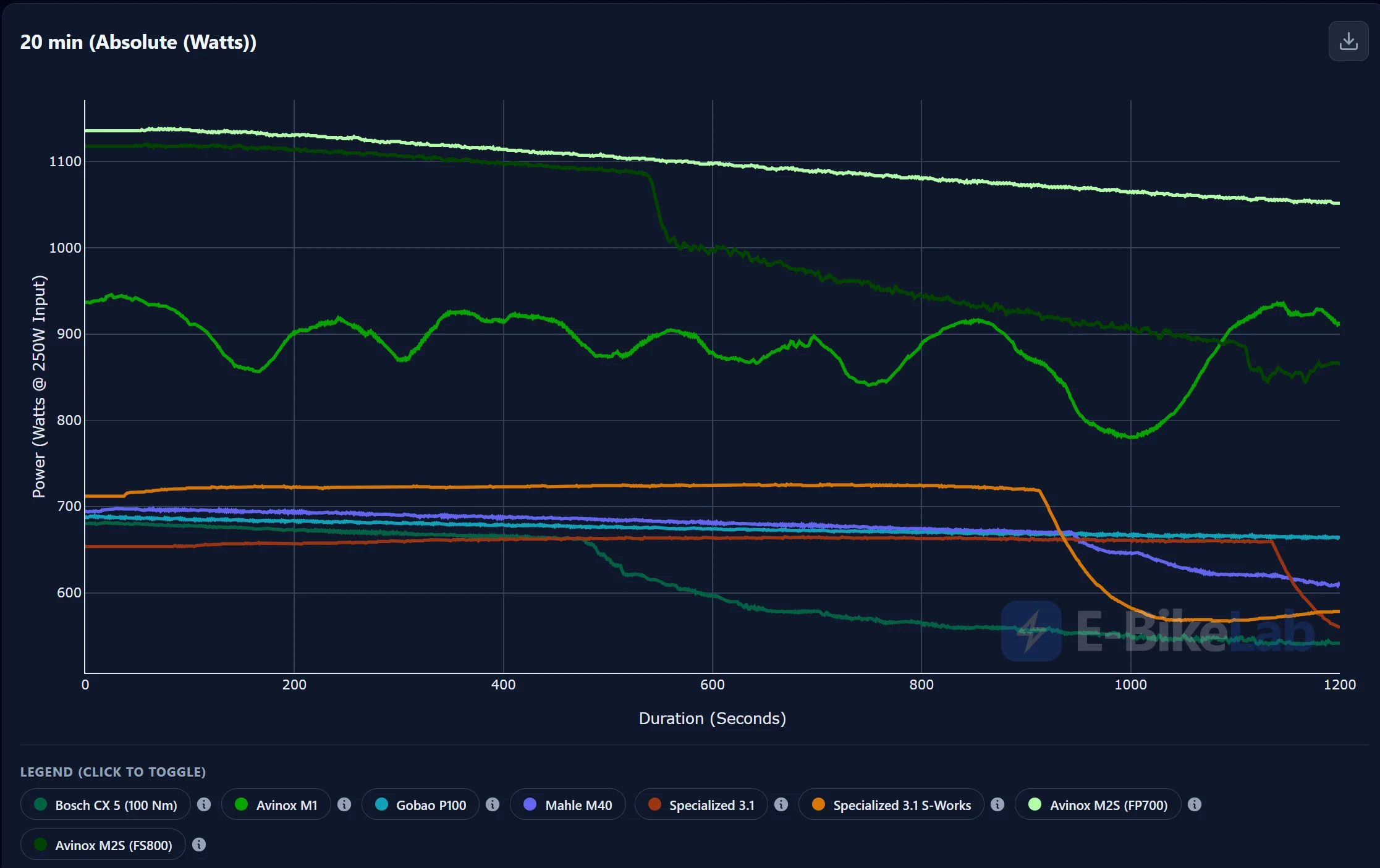

Guys, little off topic. But is interesting.
Check this page, there is alreay M2S. E-Bike Motor Power Test - Who is the strongest? | E-Bike Lab
Looks like it is peaking 1200W, which is really great for such a small motor. Thats exactly power of M620!
Edit: It has really 1500W peak at 100 rpms, more power than standard M620. Unbelievable.

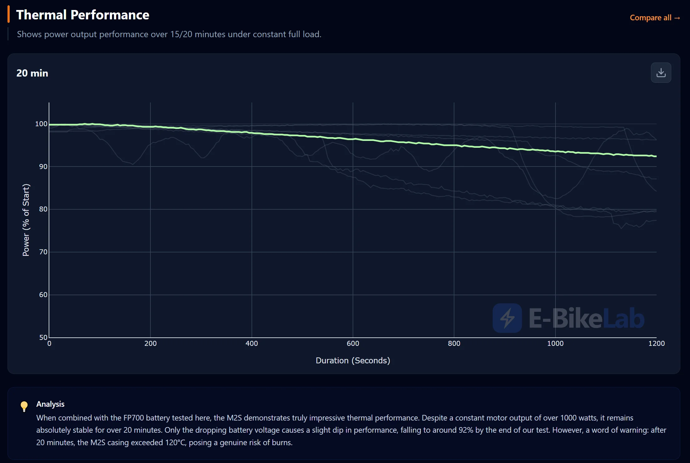

And this even more interesting. The trick how they reached it. They going to quite high temperatures - 120 degre C according notes. Thats really high temperature. And as he stated you can have a burn (also happend to one customer with M600 rev.B - it went even higher, but I think that was failed thermal management with this motor).
And what is remarkable from this graph, it looks like motor did not even started to limit power at Turbo! Wow. Decreas of power is caused by lower battery voltage after 20mins.
Specialized motors are going to const. power, so can hold the curve flat.
Would be great to measure also input current and voltage, to calculate efficiency of motors. And to stick a thermistor on the rotor casing to have also temperature in a graph. I like graphs. :) Good job DJI!
Battery temperature can be a limiting factor with old FS800 batt. Quite quick reached thermal limit. But thats normal with enclosed cells without cooling. Unbelievable jump of power comparing to concurence.

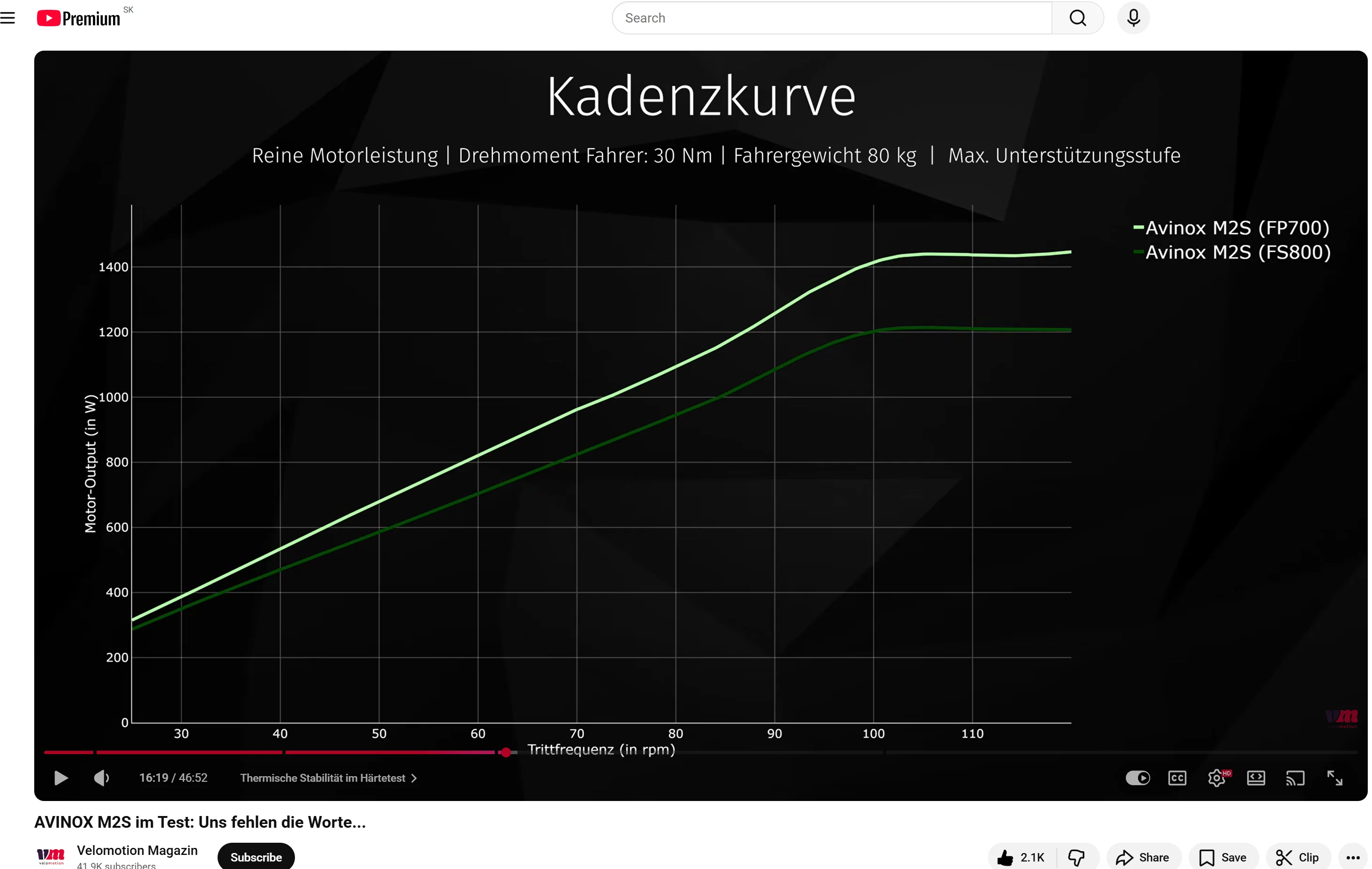

Of course I couldnt sleep and been thinking about new Avinox. ;)

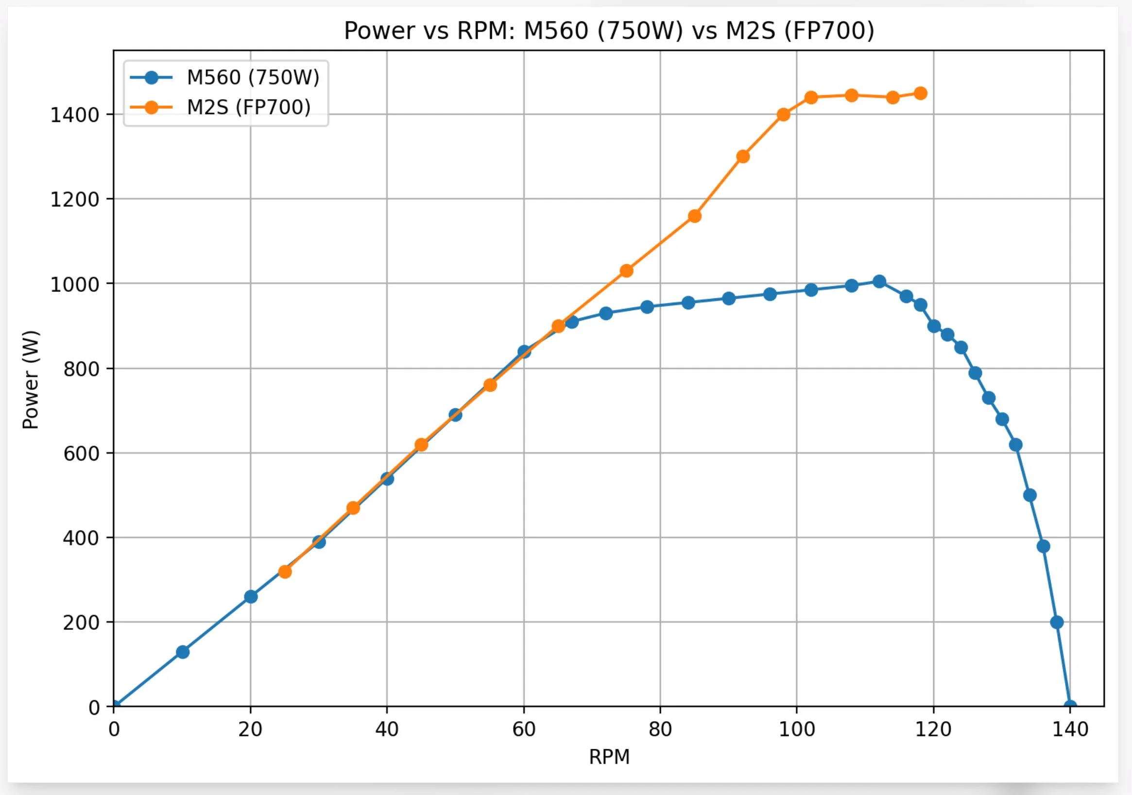

Found a german YT channel and M2S really has 1500W peak. Measured 1450W on a wheel at caddence 100 rpms. Thats out of this World!

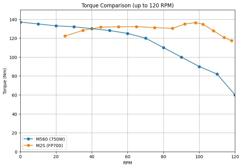

So I combined power characteristics. And what an interesting outcome. (and also LLMs are magical, I just put two jpgs and it combined it for me in 2 prompts. Magic. And went over Python!)

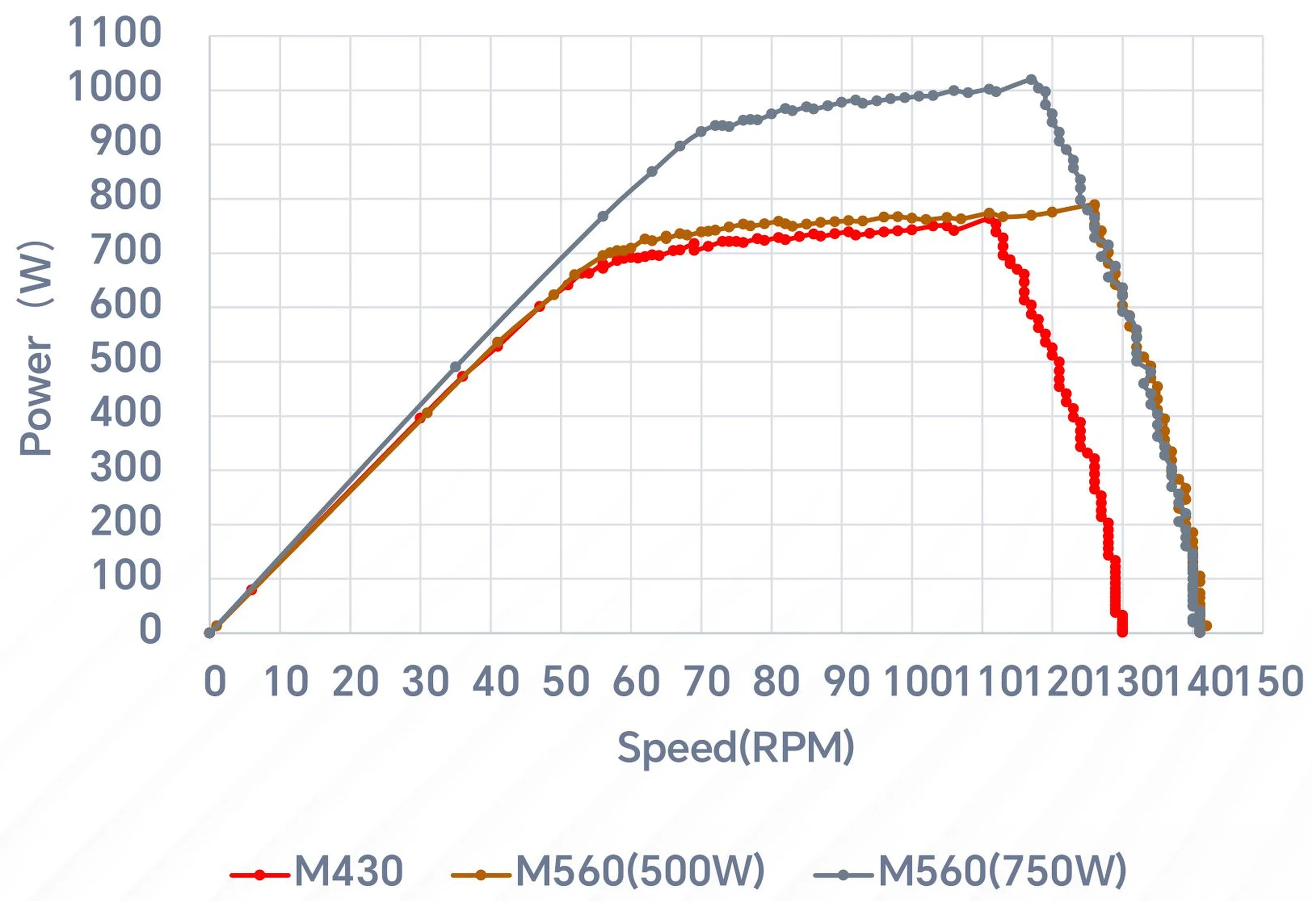

What a coincident, that curves are exactly matching till 65 rpms. Then Bafang is limiting (25A max) at that 1000W mechanical.
Adding also sources:
Bafang dyno curves. From Bafang M430 catalog.
That is peak 45 Amps at 36V DJI battery! Wow.
We will need 30A into M560 to catch up. ;)
