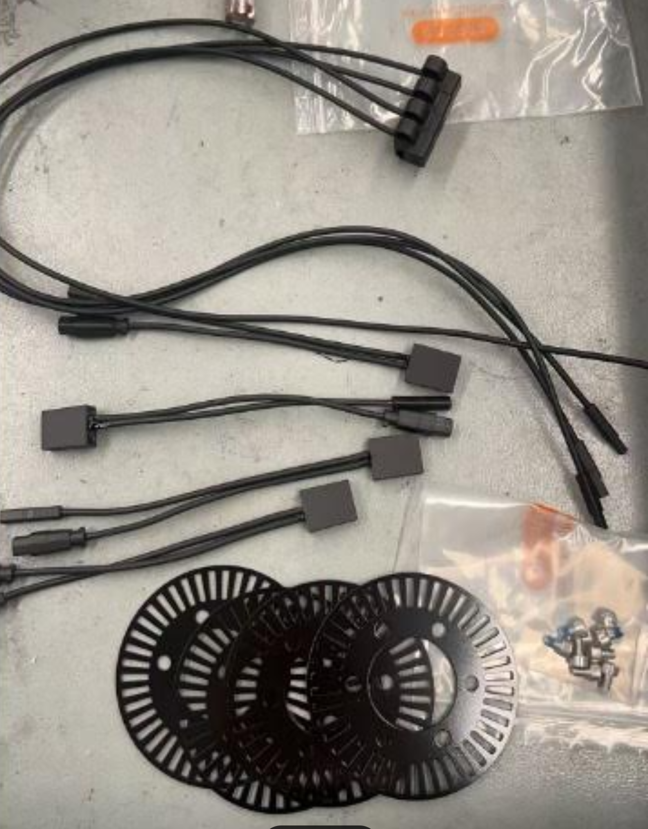

And comes with new speed disc sensor. Is again some funny Bafang solution. Look at that small box, which looks like speed chip. So u would need somehow glue the sensor to frame, if you dont have good rear frame.

So far seems so. Just different speed sensor so make sure it fits the frame. Chili shen is selling both motors for the same price.

Some ziptie holders atleast would be welcome but it can be fixed with gluing a plate with holes to achieve it

Updated sensors as well. It’ll have the new disc style speed sensor with more points per revolution like was shown with the M510RS
